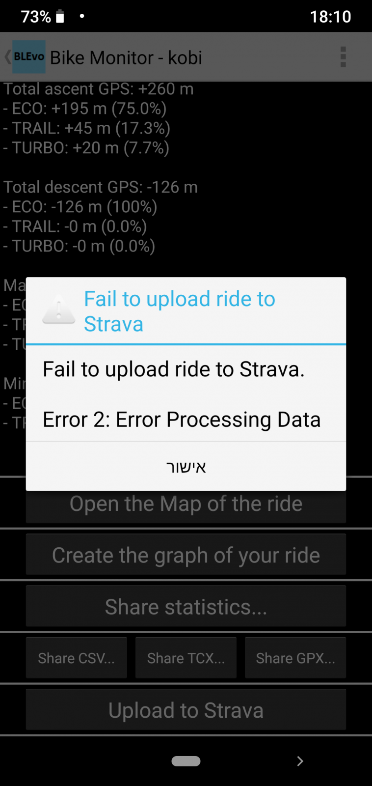

Hello ,
Been trying to upload a ride to Strava and i'm getting this error . tried with 4g and Wifi connection.
Also , tried to upload the TCX / GPX file manually but Strava was showing only part of the ride , while the file itself containes the complete ride details .
Please your advice .
Thank you View attachment 11666
Send to me the tcx file.. I will check.. thanks..

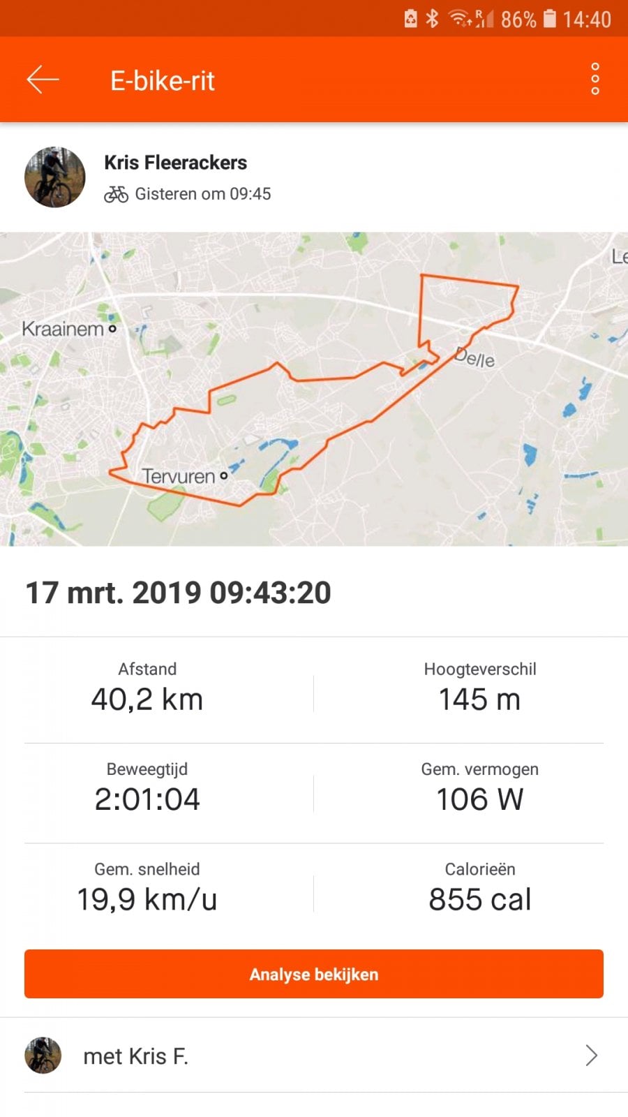

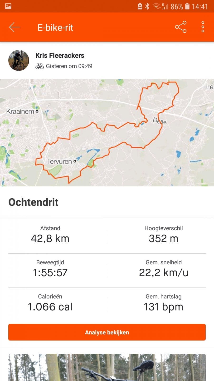

@PaoloBLEvo I had my first ride with the TurboLevo and with Blevo yesterday. As I first did read all 50some pages of this thread, I had high expectations, but there are no words to describe the app...??.
I have changed a few times the settings whilst always pausing the ride and continuing. And I see that Blevo did not track my movement..
I cannot find what I have done wrong...below the difference between Blevo and my Mio. Screenshot_20190318-144043_Strava.jpgScreenshot_20190318-144108_Strava.jpg
I cannot find what I have done wrong...below the difference between Blevo and my Mio.View attachment 12005View attachment 12006
Ios or Android?
Where you put the phone? Bag, pocket or handlebar?

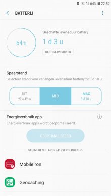

Ok.. have you removed the battery optimization for BLEvo in Android battery configuration?
I might have found it: based on previous posts, I went into the Blevo settings under apps and made sure the optimisation is off.
But when you say now battery optimization, I believe it is somewhere else....see below.
I have now selected that BLEvo can use as much energy as it needs.
Will test this.
Screenshot_20190318-225250_Device maintenance.jpgScreenshot_20190318-225306_Device maintenance.jpg
