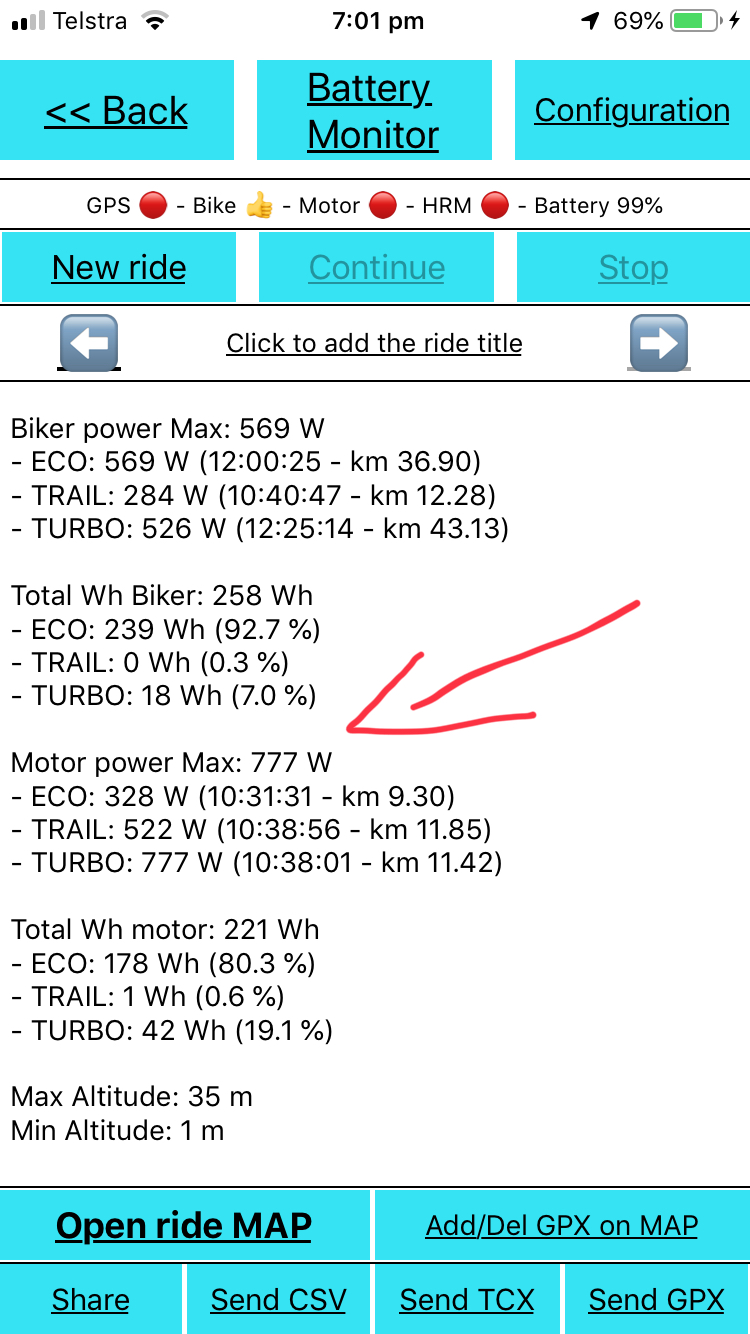

What's the 'official' max power? I've twice seen 788 on mine, both times on quite flat, open trails.

I’m 778 - or I was in my last ride.
Motor power Max: 778 W
- TRAIL: 644 W (09:17:26 - mi 0.79)
- TURBO: 778 W (09:29:50 - mi 6.07)
The “Official” max power is only like 570 odd.
But the real max power on some bikes is 700+
This was my first ride after the update and only on 85% assistance, 100% peak power.
Be interested to see how much I can get out of it in the near future. I’ve gained 200+ watts after the update, and pretty happy with that. The bike also feels way more responsive, through the entire range. ?

Just went out and maxed it out at 788w
It’s riding nicer than it ever has.
Now I just want 150mm out of the rear and 160mm our of the front and i’ll Be happy as.
