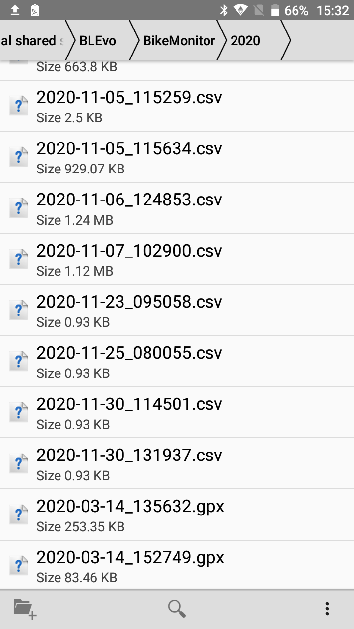

I just noticed that my last three rides show the graph as empty and if I attempt to open the ride map I get an error that says "No data found in the CSV file". I tried sharing the csv to my email and sure enough the attached file is only 1K in size and only has the header row. I've looked through all the settings and don't see anything obvious that would enable/disable the csv files. My current version is 3.8.0.479. The last ride that worked was on Nov 7th. I took a break due to weather and my next ride on Nov 23 has the problem. It looks like it is still creating the csv files, but the last 4 have no data (see attached). Does anyone have any idea what might have happened to cause it to stop writing the csv data?
Why you have the test version?
There was a bug in the CSV creation..
It is solved in the 480 version.. but this version is released only for test..

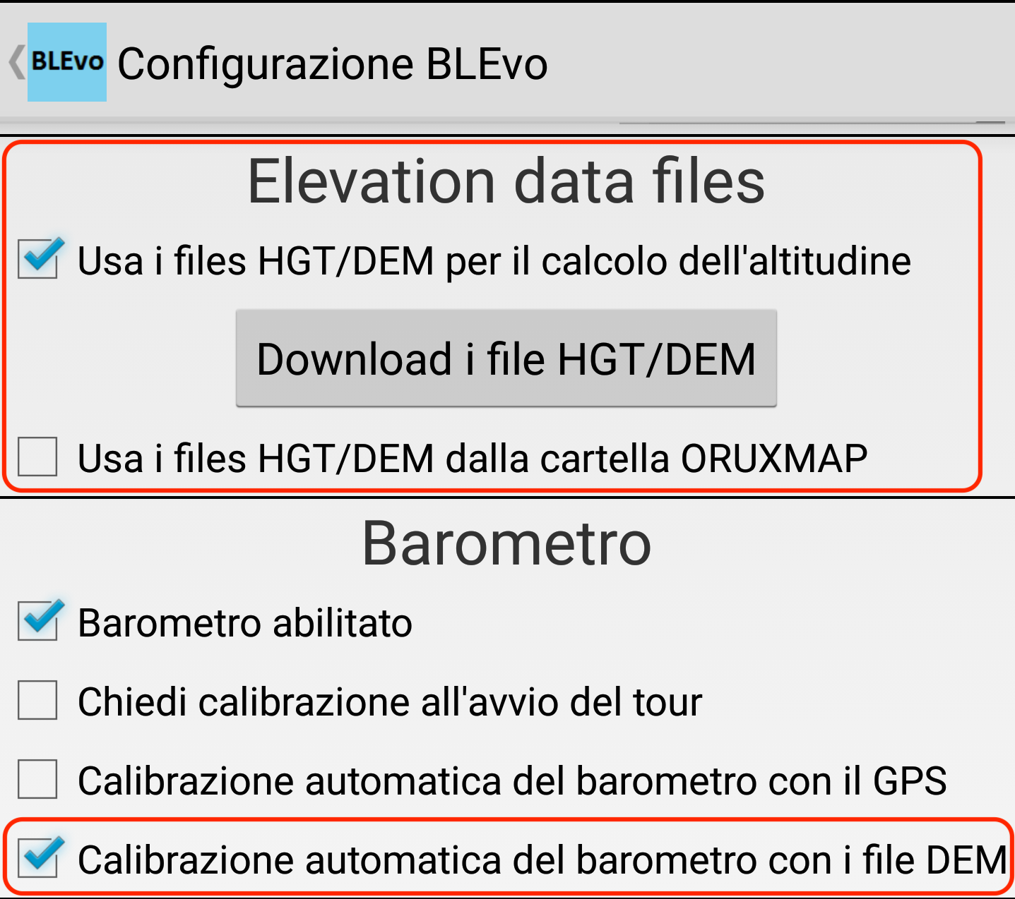

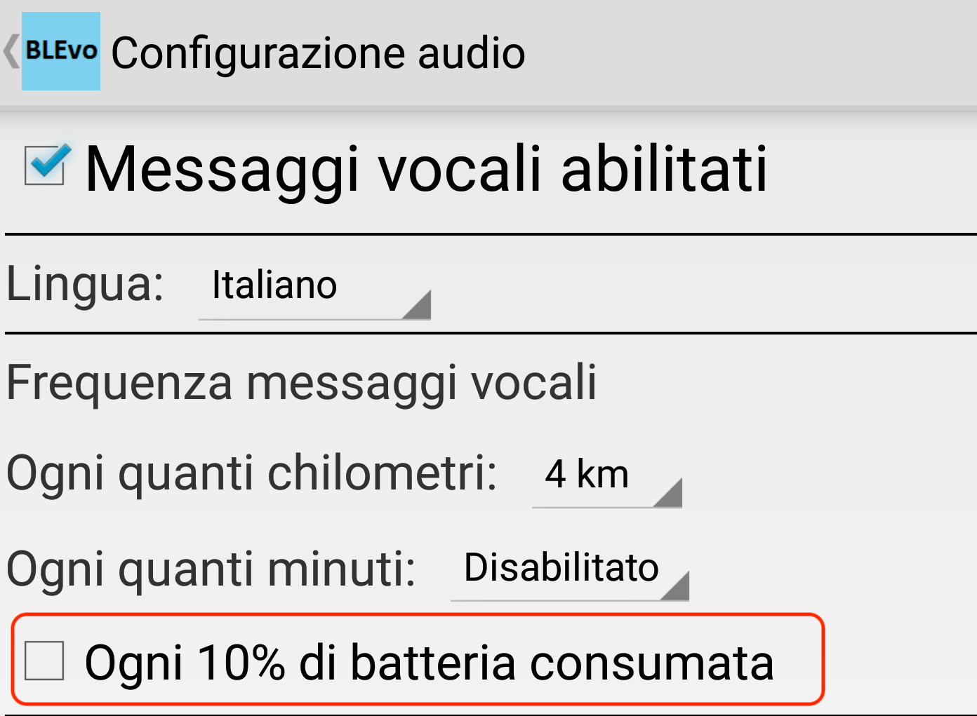

I just released BLEvo version 3.8.0 for Android.

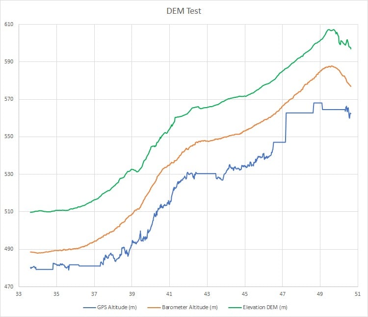

I have added 2 important features. One is the management of DEM files of which I am attaching a video that explains how it works (sorry, it is in Italian but I hope the subtitles can help you).

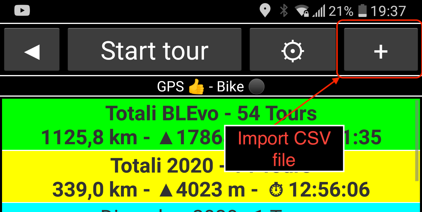

The other is the ability to import a BLEvo CSV file recorded with another phone or with an iOS phone.
Here are all changes:
- Added DEM file management for altitude calculation
- CSV import (also from ios)
- Changed lock / unlock map icon
- Added voice message of battery status every 10%
- Action from remote control to turn the display on and off
- Bugfix: GPS and Bluetooth management when the tour is paused (now it stays on if there is automatic start)
- Bugfix: SL battery voltage calculation in CSV
- Bugfix: Calculation of battery consumed with SL
- Bugfix: GPX closure
Enjoy your ride with BLEvo.

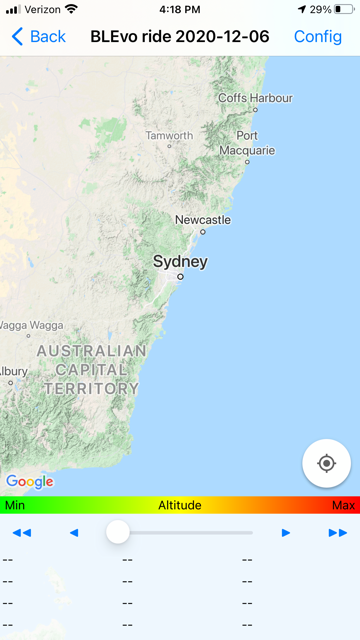

The map feature used to work fine. Now it always think I'm in Sidney, Australia. (I'm in Golden, Colorado, USA.) Why is it doing this?

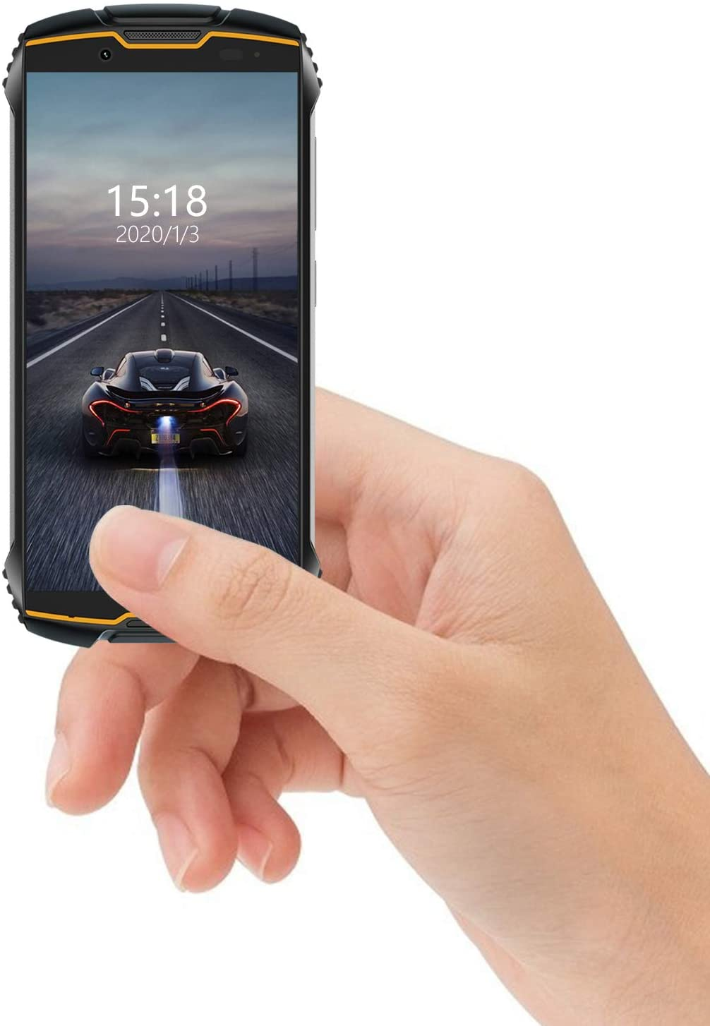

In order to put a rugged phone on the handlebar that doesn't look like a TV, I adopted this 4-inch.
It costs less than 100 euros, it is a rugged and fits perfectly, the dimensions to be clear are those of a garmin device.
The battery is only 2000 mAh but if you do not use a sim card, you only run Blevo and you do not keep the display at 100% brightness it's sufficient, otherwise there are cigar-style power banks that can be fitted and hidden under the handlebar.
This device does not have a barometer (for what it costs) and therefore the recording of the altitude and ascent data would suffer a little, however the problem is solved by loading and using the DEM data, the new feature added in the last Blevo version.
The elevation is highly accurate and the ascent calculation is comparable to a Garmin device, or a smartphone with barometer. Try to believe.
The only problem encountered is in situations where the GPS reads wrong horizontal coordinates, and the track is along points where a few meters makes the difference because for example you are riding in a "funnel".
In normal situations, however, that's fine and you don't miss the presence of a barometer (who shall also be calibrated before your ride).
