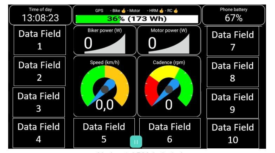

I looked through the posts here and also in the manual but haven't found what the color of the "motor power" graph indicates (the one above the cadence gauge in the pic below). It doesn't seem to be related to the numerical value. Any pointers to what it means or where I could find that information would be appreciated.

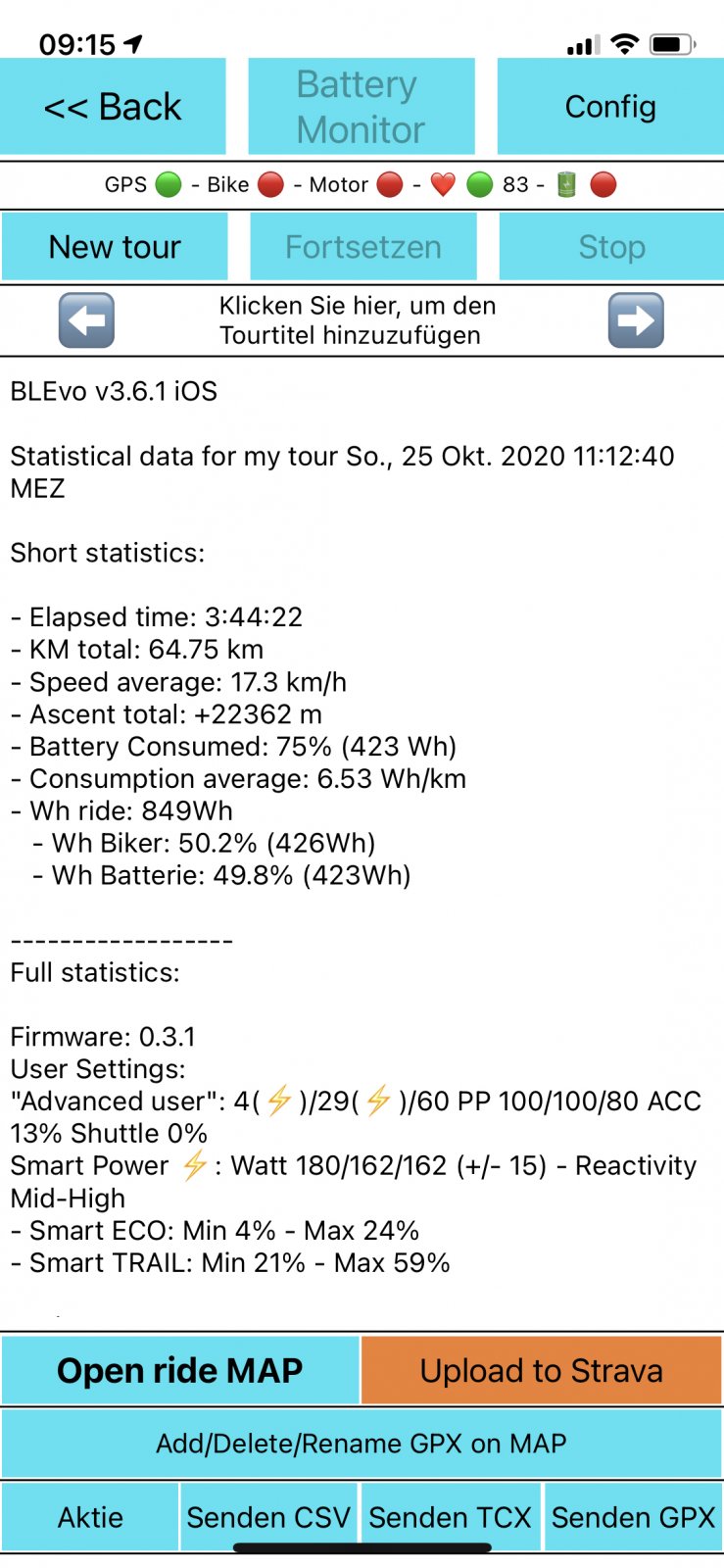

I am a bit confused about the "Distance ridden" value on the Battery Monitor page in Blevo for iOS. Is it supposed to show a corrected value (depending on the wheel size/speed settings) or just the uncorrected raw value (i.e. the same as in the Mession Control app)?
The color of "motor power" is not documented sorry but it is:
- Green when the motor power is lower than biker power
- Orange when the motor power is between biker power and the double of biker power
- Red when the motor power is over the double of biker power..
It is the distance stored in the motor..
So if your wheel size is fake, also this value will be fake..

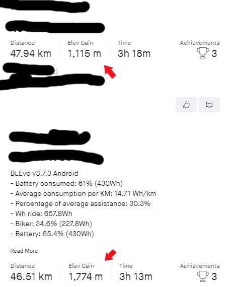

@PaoloBLEvo , still having same problem (see here- The Official BLEvo Thread - EMTB Forums) with the app transferring wrong total ascend data to strava, (1000m climb recorded in the BLEvo app, showing 1500m in STRAVA).
Android v.3.7.5.
I do enjoy the admiration on my strava followers for big climbs, but still - better to have this fixed :)

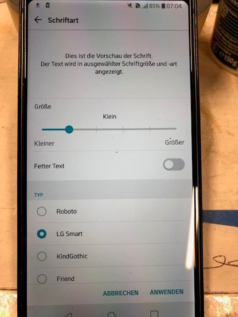

First of all THANK you for this awesome app. In an earlier post someone wrote a problem with
that the font is displayed too large. I have the same . Have a look at the attached picture.
I own an LG G6 like it was prefered here.
And I set the font size on the LG to small anyway.
But it is still to big.
An idea what I can do to solve this?
Kind regards

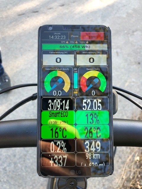

Kind regards

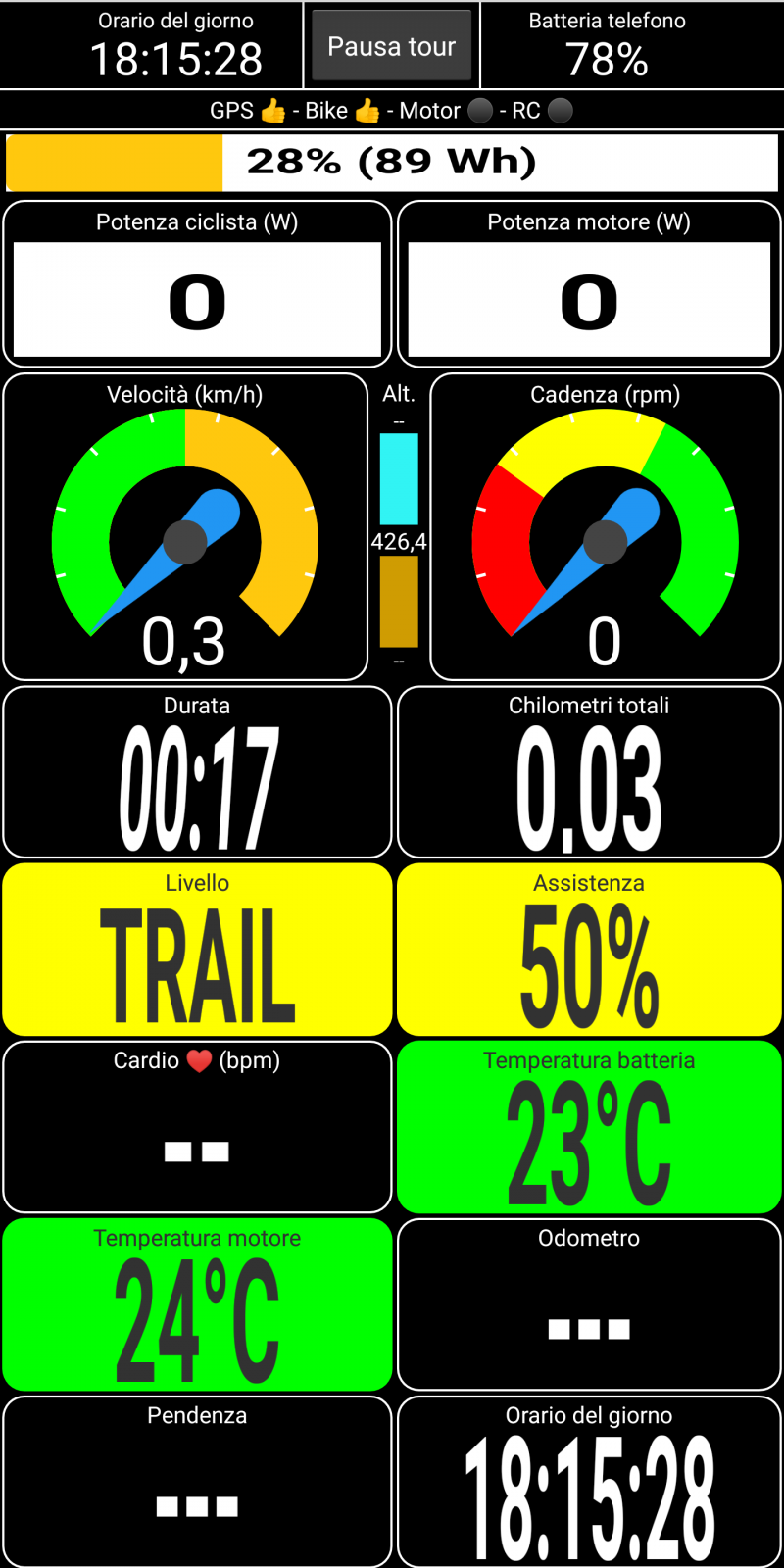

Which BLEvo version you have? I have the same LG G6 and this is my screenshot...

@PaoloBLEvo - Samsung Galaxy S8 (SM-G950F).
I now see this problem started in BLEvo v.3.7.3.
See below a typical difference - both recordings of the same ride, upper recorded by strava, lower with BLEvo.
Sorry but the issue is in Strava o BLEvo..
Also BLEvo says so different descent values?
What is the right value?
