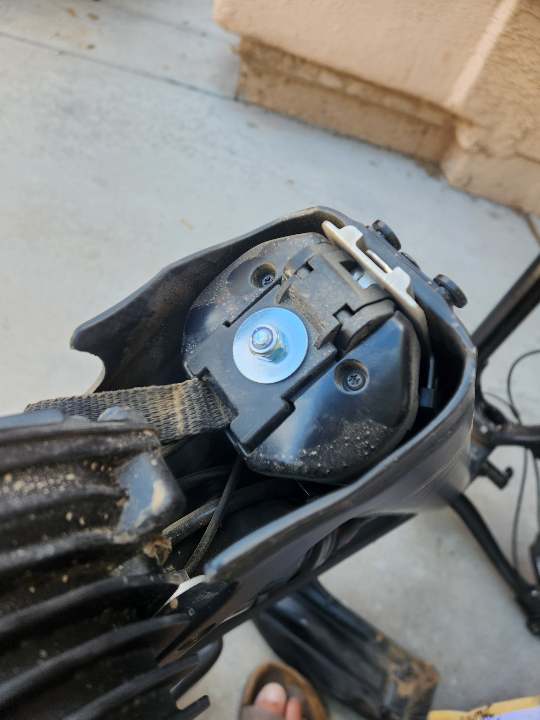

I also had the dreaded battery latch disconnect issue. and I solved it with a small rebuild kit from a buddy on FB.
Works like a charm, super easy and no more issues!

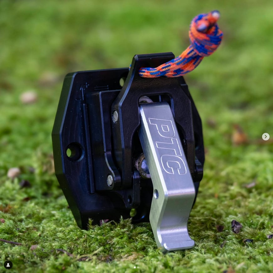

I think (I haven't tried it yet) that Cascade Components' solution looks pretty good to finally get the problem under control (you probably lose the warranty with it too, but Cascade Components have been testing this solution for about half a year, and I've been waiting for that). I guess they wouldn't come up with this solution if the issues would still exist. Otherwise, if @Mario Antony finally tells us his solution (he also tests it extensively), I think his solution will certainly be very promising too.

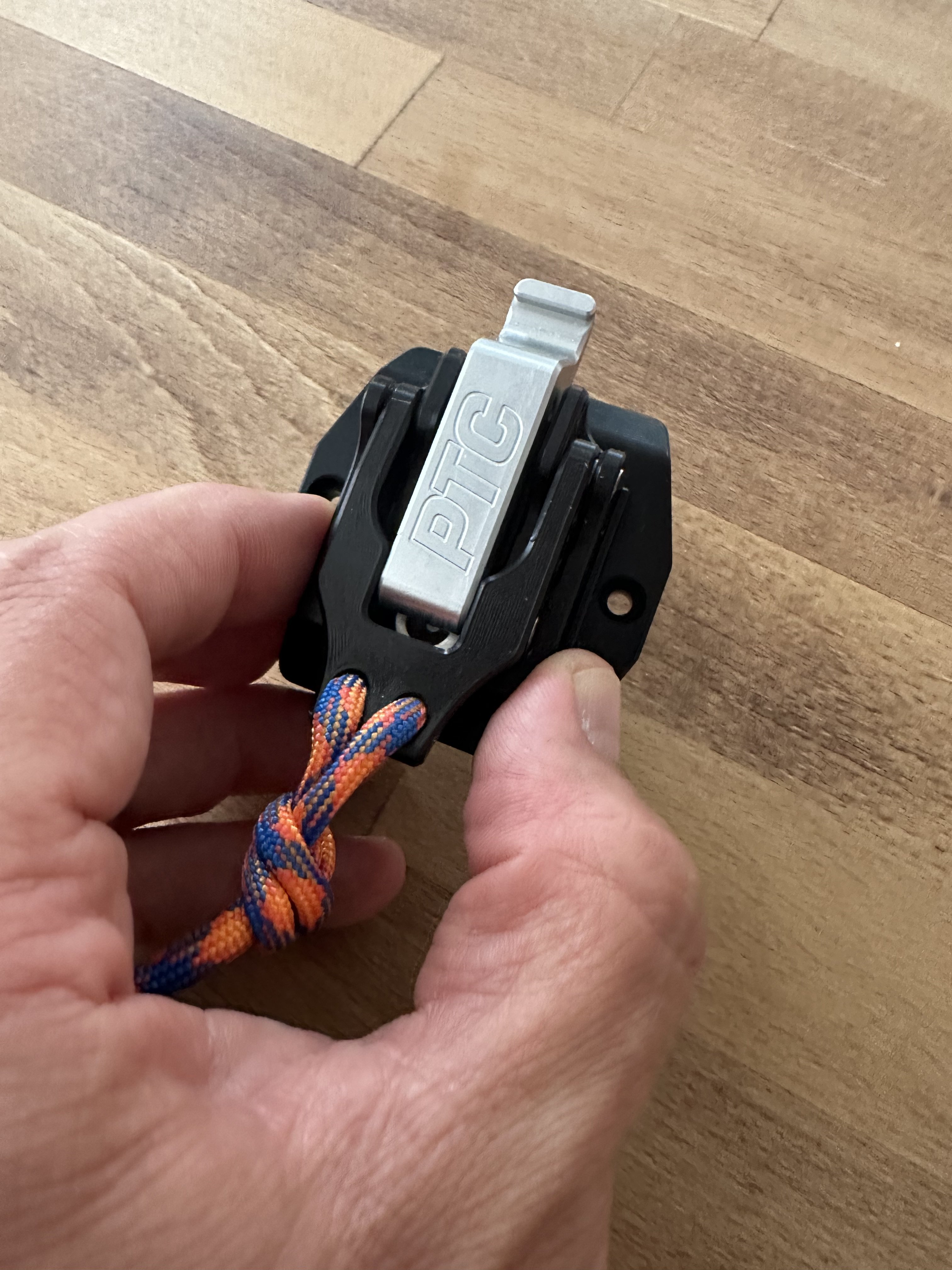

I have now also ordered the Bosch Power Latch from Cascade Link and hope that this part will finally calm my bike down on the downhill.

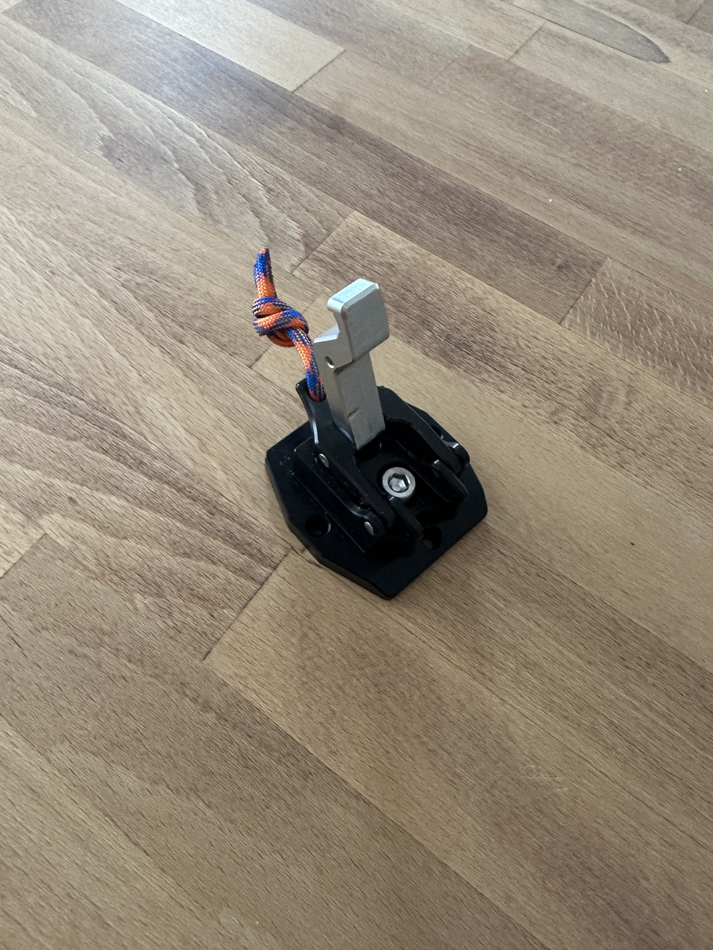

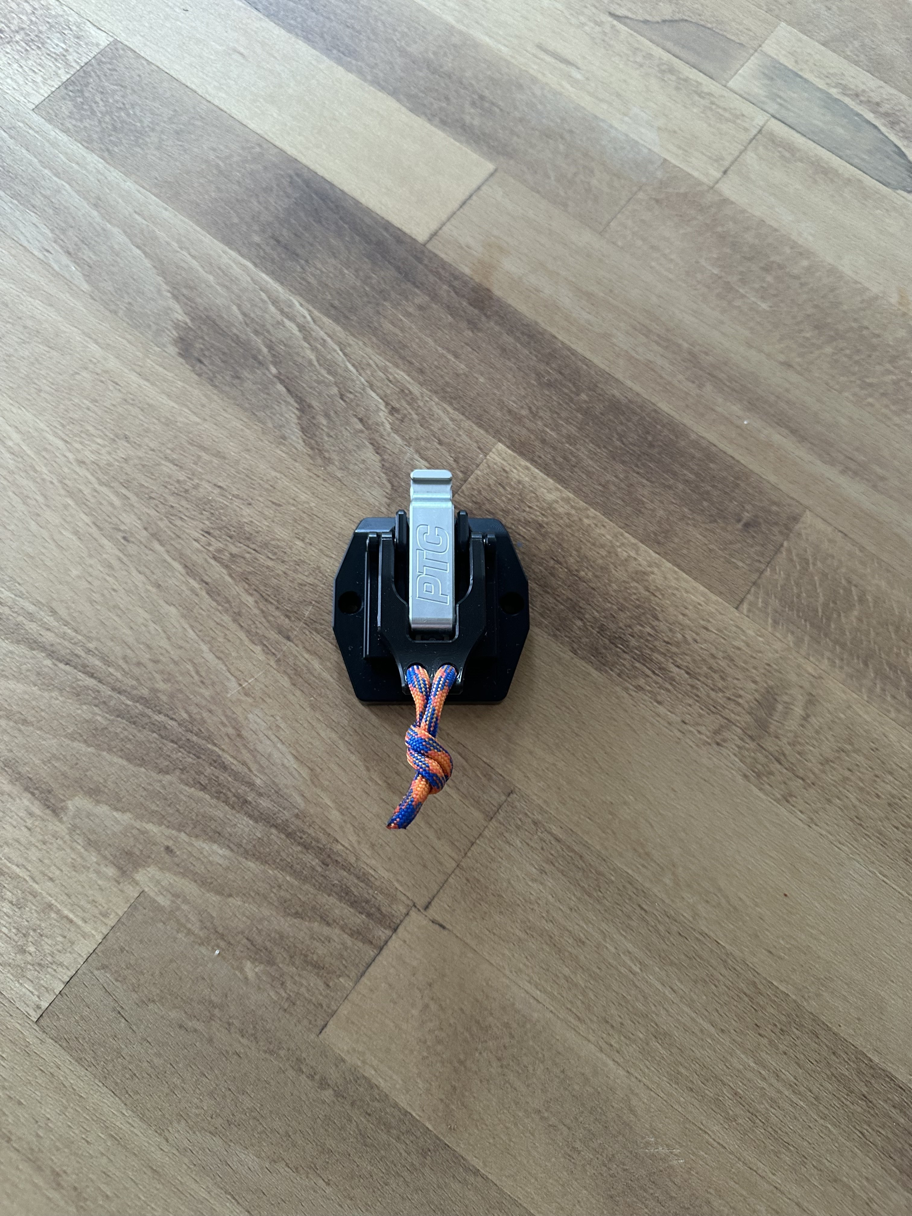

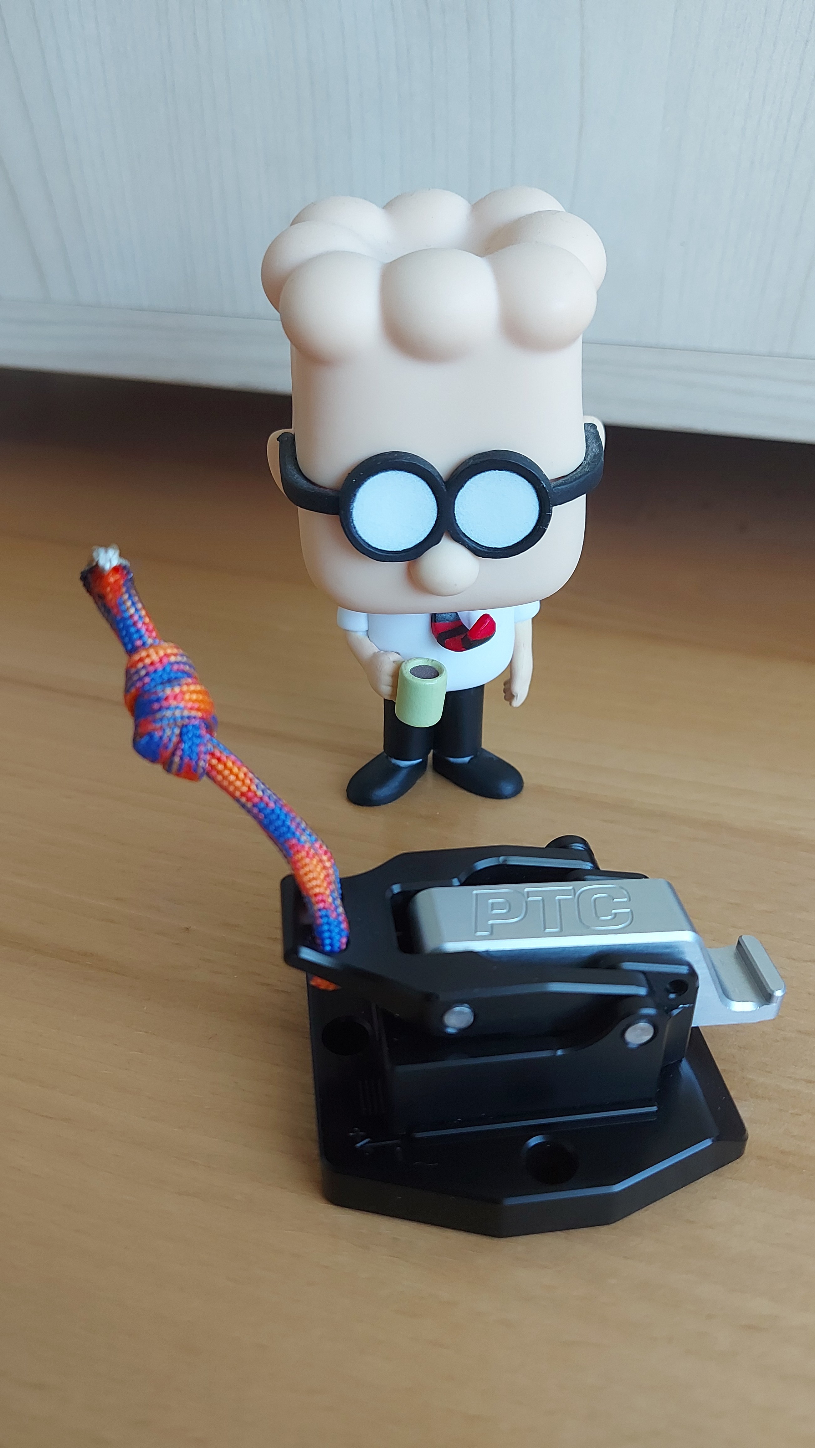

I finally got it. It got stuck at customs for a bit... well, Swiss customs... Of course with the four screws for the battery (in case anyone is worried about that). Looks good and the quality is OK, as expected. Dilbert also took a look at it and thinks it's great. I'll keep you updated on how it holds up in tough use.

That's what I'm saying too. The Canyon Strive:On has an extremely unfortunate (to put it mildly) design when it comes to the battery mount. The 750Wh battery from Bosch weighs 4.3 kg. Hanging it not on the rail provided for it, but only on the latch, is something that no reasonably experienced engineer would even think of. I just don't know what the Canyon people were thinking and why Bosch approved something like that???
The Cascade Components Latch is a (expensive) workaround and my only hope is that Cascade Components has tested it long enough and under real-world conditions to sell it for this price. I expect a flawless product that solves the problem, even if the latch is not the (sole) cause of the problem.
