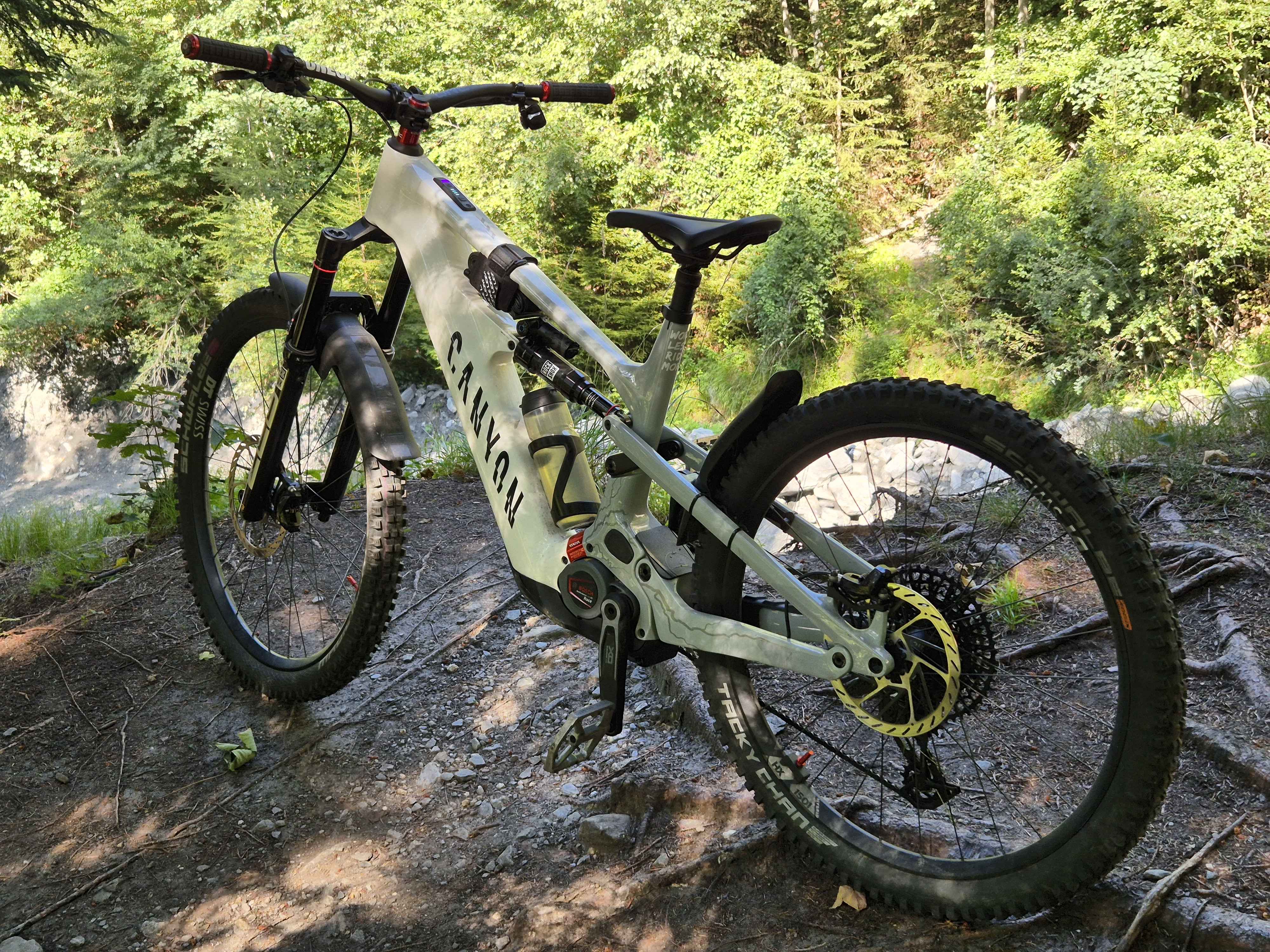

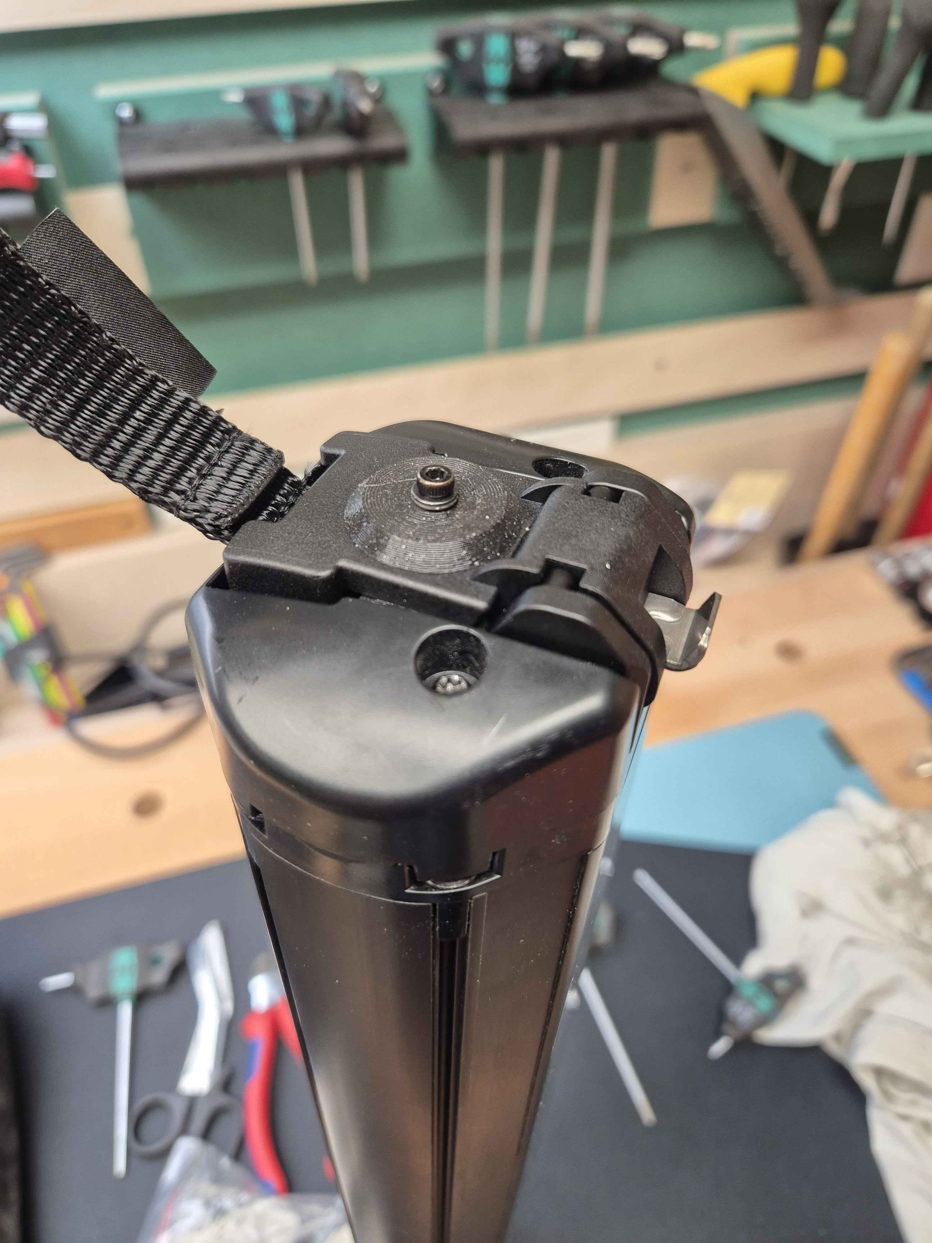

The updated replacement latch arrived within two days (quite incredible). I've installed this 3D printed spacer as a precaution as well.

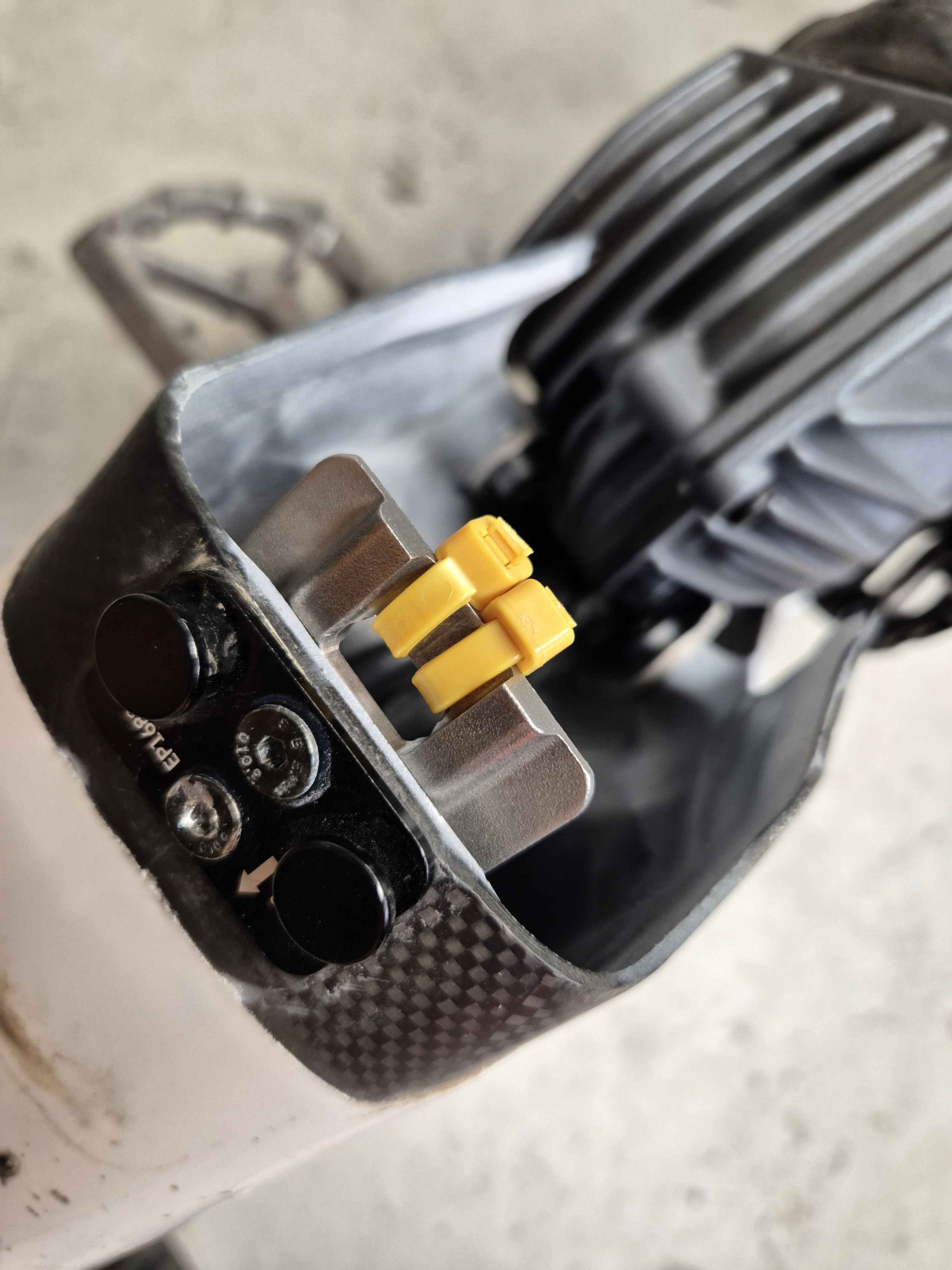

I've also added these two zip ties as someone suggested, since without them, I had some side-by-side battery movement going on:
With this new latch, the 3D printed spacer and the zip ties, I have ZERO battery movement and have yet to encounter any cut-offs. It's been riding incredible, and I'm now one happy Strive:ON owner again!
Here's a pic from today:

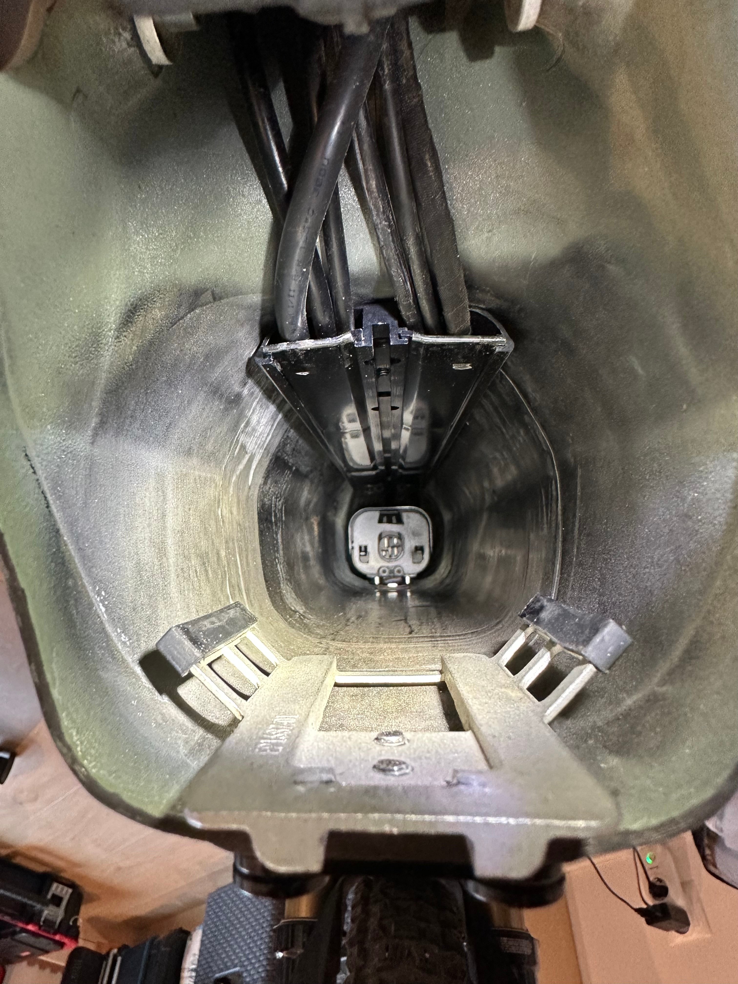

Haha 🤣, please read the post from @Mario Antony.... It should be enough if you have slim and long forearms and can grip the upper battery holder with the contacts. The screws for loosening are on the outside of the down tube (the two silver screws at the top of the down tube that face to the bottom if the bike stands on it's wheels) . It's not the most pleasant job, but afterwards you can be sure that everything is secure. Because it's not just the latch that is responsible for the battery movement!
Then you should take out the entire battery holder and apply threadlocker to all the screws and tighten them firmly. Then reinstall the whole thing. Don't forget to pull out the cover plates of the cable duct (this should be easy) so that you can take out the battery holder. And secure the three cables on each side with zip ties so that you can put them back into the same cable duct later.

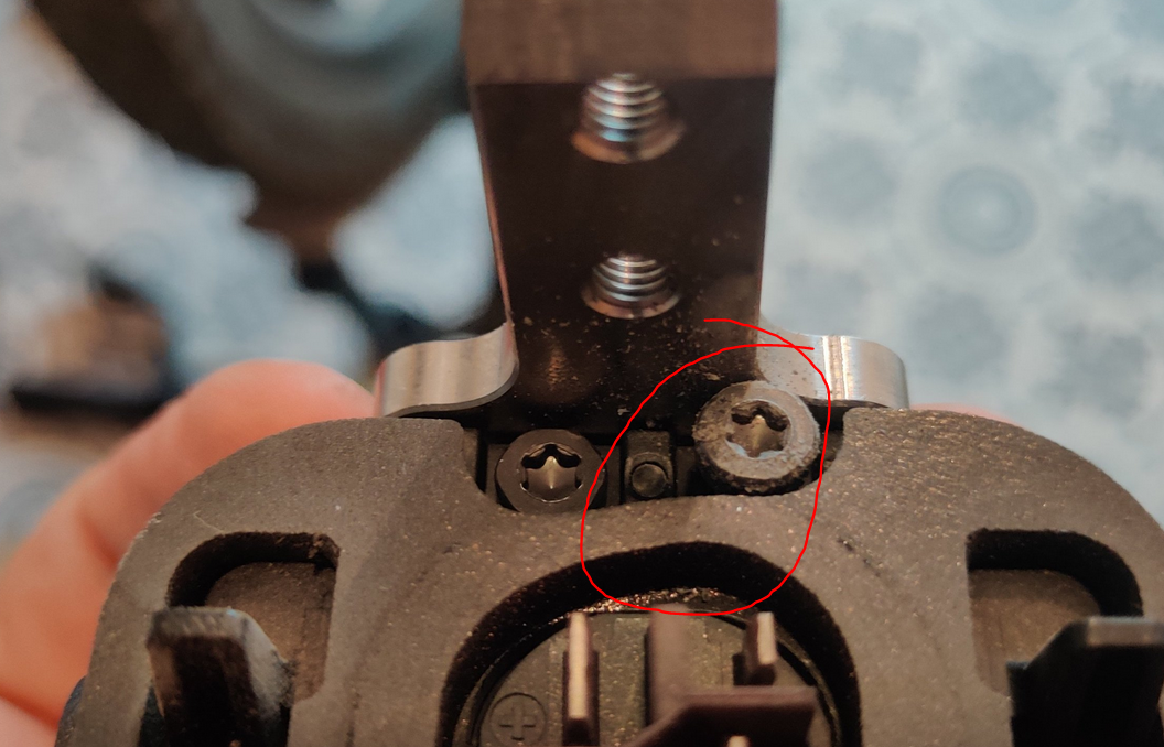

what are the torx size for the 2 bolts to be loctited ?
is there other bolt to unscrew before reaching these 2 torx ?
if yes what are these bolt ? allen or torx ?
is 300mm screwdriver enough to reach these bolts ?

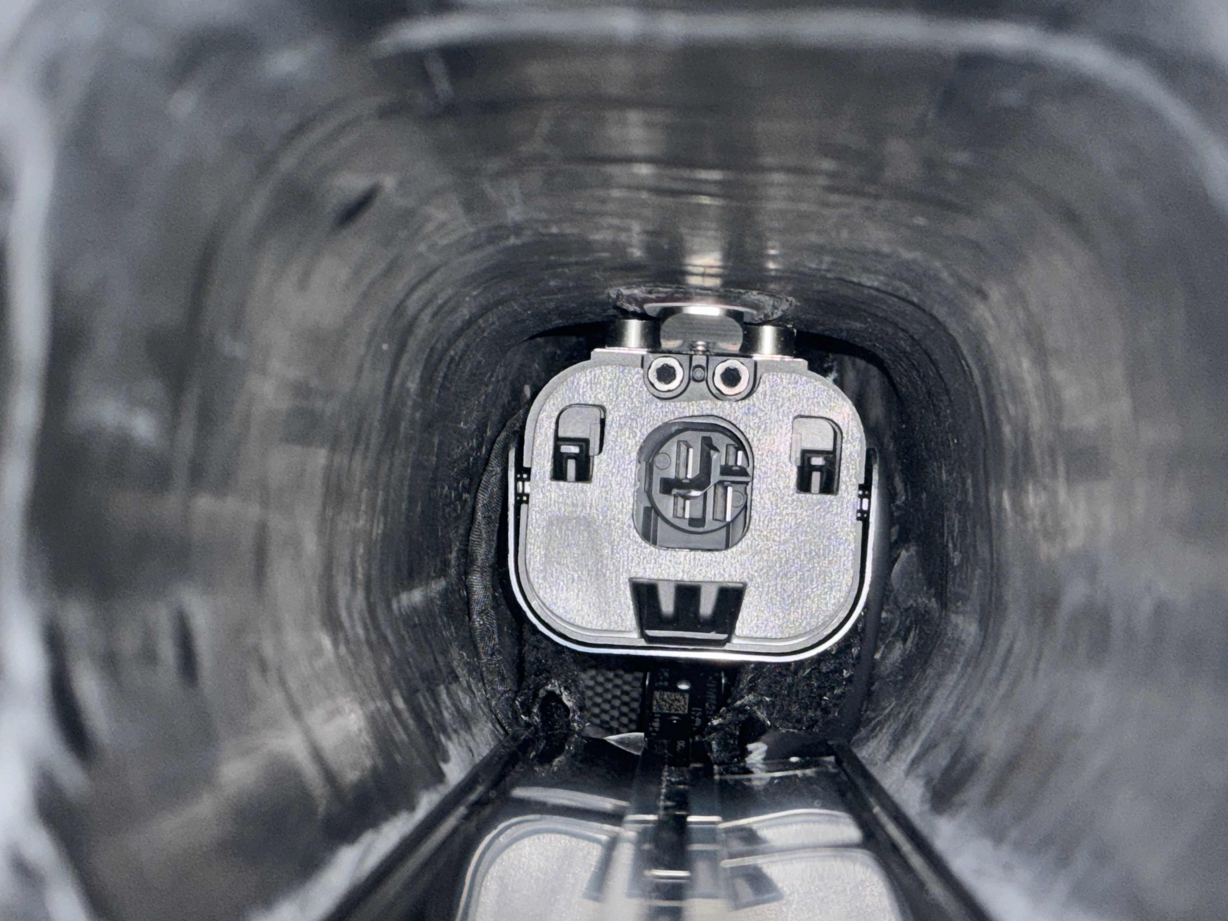

images I found on thread

As far as I remember it is T25, but I'm not sure anymore, @Mario Antony, can you help?
There are in total 6 bolts at the upper battery bracket, please have a look here: 2024 Strive:ON (from the famous(!) @Mario Antony thread lock mod).
You cannot acces the screws number 1 in the Mario Antony post above, if you don't remove the entire upper battery bracket! Also I would not try to unscrew the two bolts you see from the open end of the downtube (just to put threadlocker on it). It is very unlikely that you will be able to put it back together properly afterwards, because you cannot (or at least hardly) see what you are doing. It is much better, as Mario Antony described, to remove the entire upper battery bracket and apply threadlocker to all(!) screws. Although this is obviously a lot more work, it is certainly the better method.
All the inner screws are torx!
I didn't measure it, but I don't think a 300mm screwdriver is long enough (the 750wh battery is already 480mm, without latch...). You have to take into account that you can still put your arm into the down tube, but then you won't be able to see what you're doing. And you should also be able to tighten the screws with a reasonable torque. I think it's really only possible to do this properly if you remove the entire upper battery bracket.

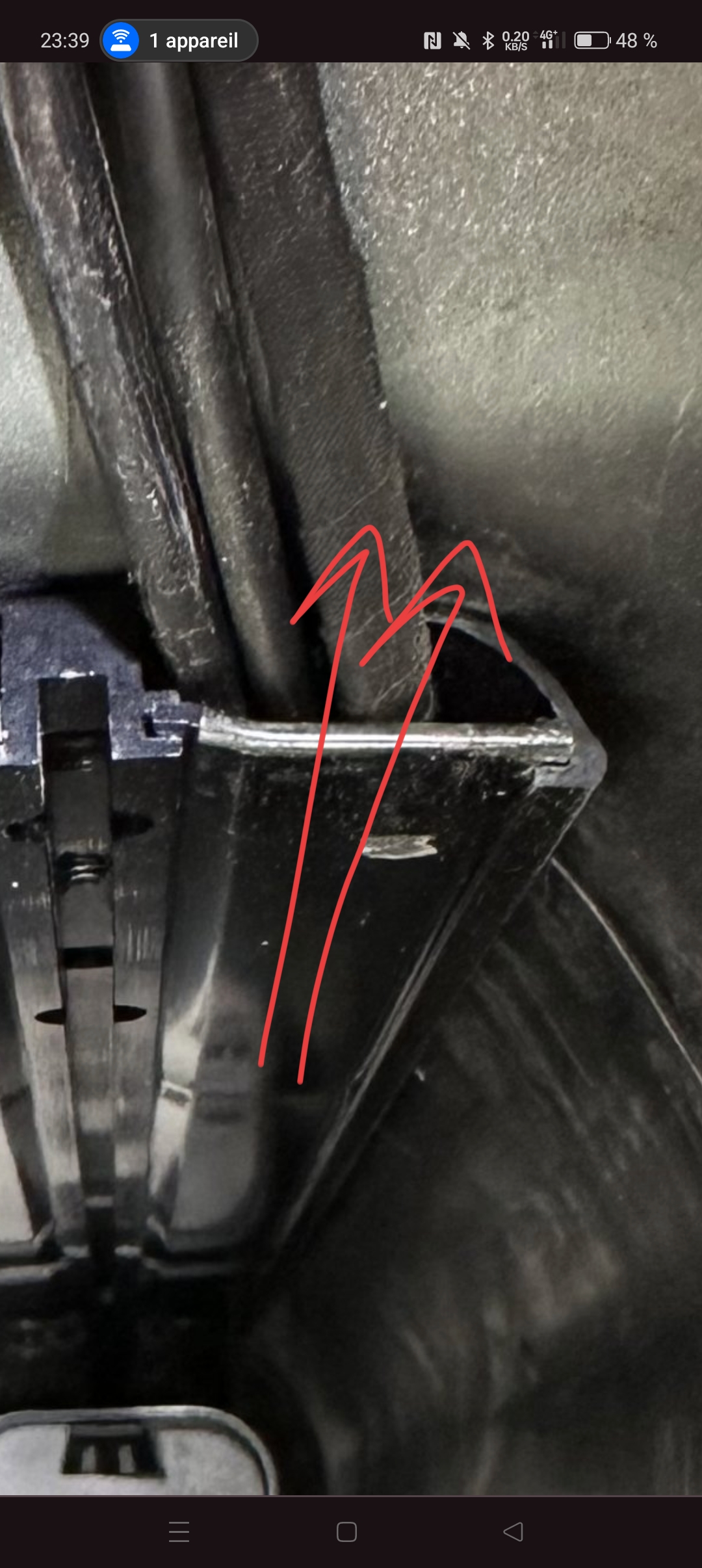

but wonder how you but the upper bracket back , full arm can go inside without too much problem ? and you can hold the bracket temporarly to align 1st hole with 1st bolt ? easy task ?! any cables that are plugged and stop the upper bracket to fall ?

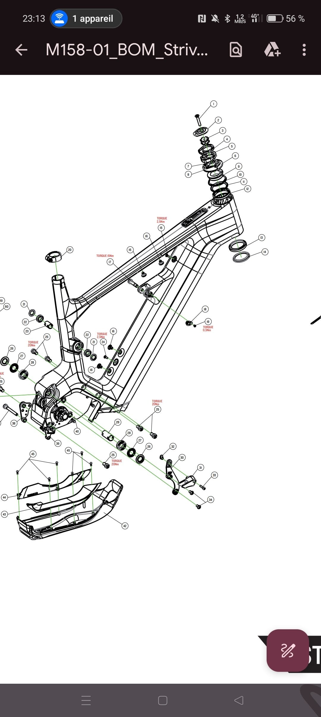

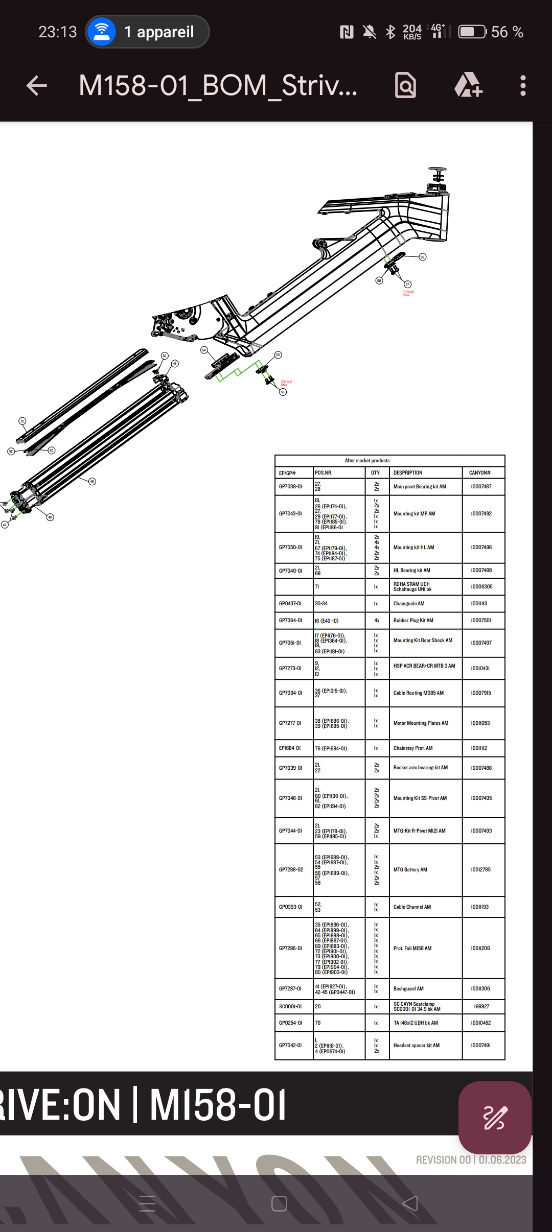

On the Canyon web page you can find the exploded view of the Strive:On. They don't show the Bosch parts, but at least you can see where and how the upper battery bracket is mounted...

exploded view is not well detailed indeed ...
i cannot see if there are some cable that retain the upper bracket
got a pic of global view of the upper bracket outside the frame ?
Screenshot_2024-08-10-23-13-25-59_e2d5b3f32b79de1d45acd1fad96fbb0f.jpg Screenshot_2024-08-10-23-13-33-89_e2d5b3f32b79de1d45acd1fad96fbb0f.jpg
I've no pic at hand now, but there are some in this forum or in the Strive:On forum.
As I said: they don't show the bosch parts on the exploded view.
The cables are in the cable channel that you can see under the battery. There are 6 cables (three on each side of the channel) from the motor side. Since the motor and the external charging socket are at the bottom, the cables from the upper battery bracket go down through the cable channel. (If you remove the battery bracket, you must also open the two covers of the cable channel first (simply pull it out upwards)). So you definitely can't lose the battery bracket in the down tube, because you can still pull it out again (carefully) using the cables. Also, the down tube isn't much deeper...
