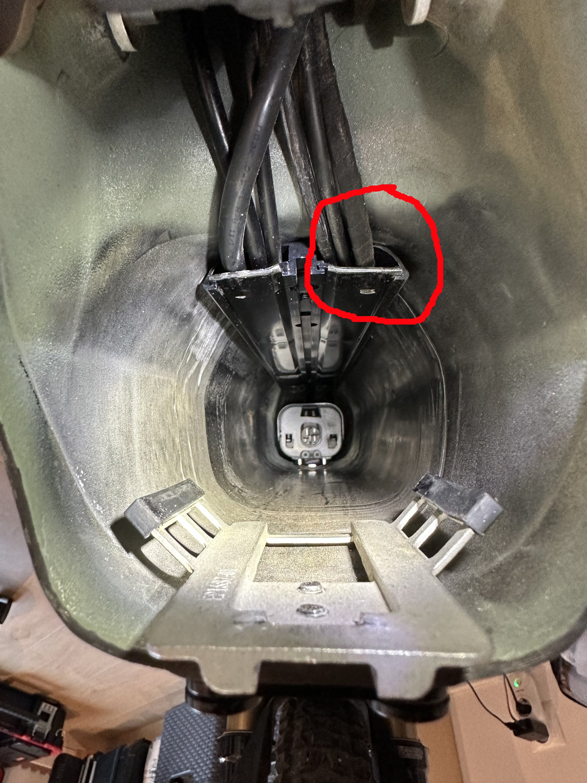

how many cables are attached to the upper bracket ? if more than 1 , are they from the same cover plate ? ( because 2 cables from under EACH cover increase difficulty lol )
i suppose i have to put back the upper bracket first and pray for align hole with bolt
then the plate will slide easier as my 2 hands will be free , one for taking the cables in place in the "rail" as flat as possible a'd the 2nd hand to slide it at the same time
Yes, right. And take care of the cables the ends of the plates (covers) are sharp.
Sorry, I didn't answer to this question.
If I'm not mistaken, it's enough to open the right side of the cable duct (see your picture below). On the left side there is the brake line, the shift cable and the seat post. But I have no idea if this is the same for every bike...

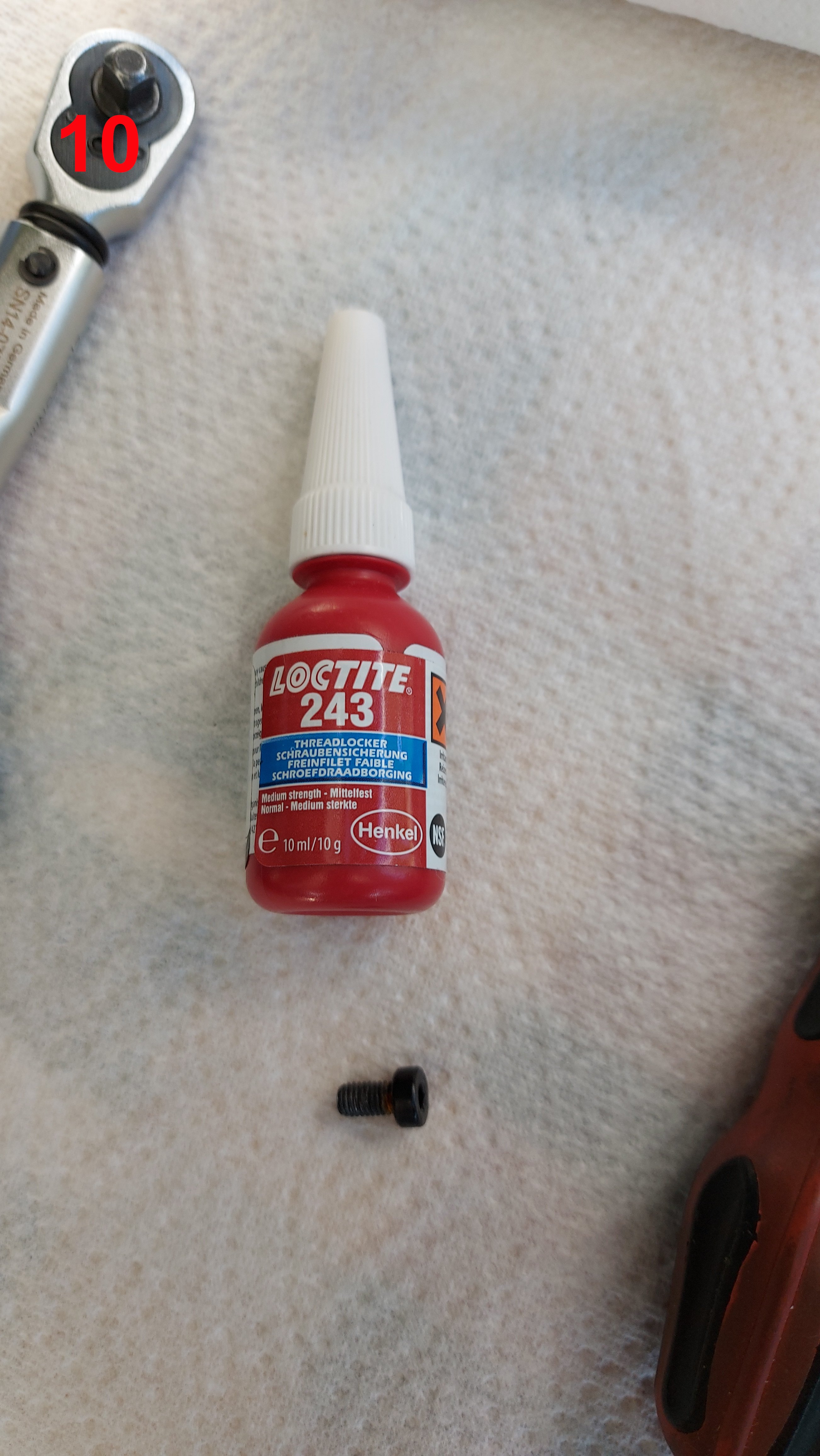

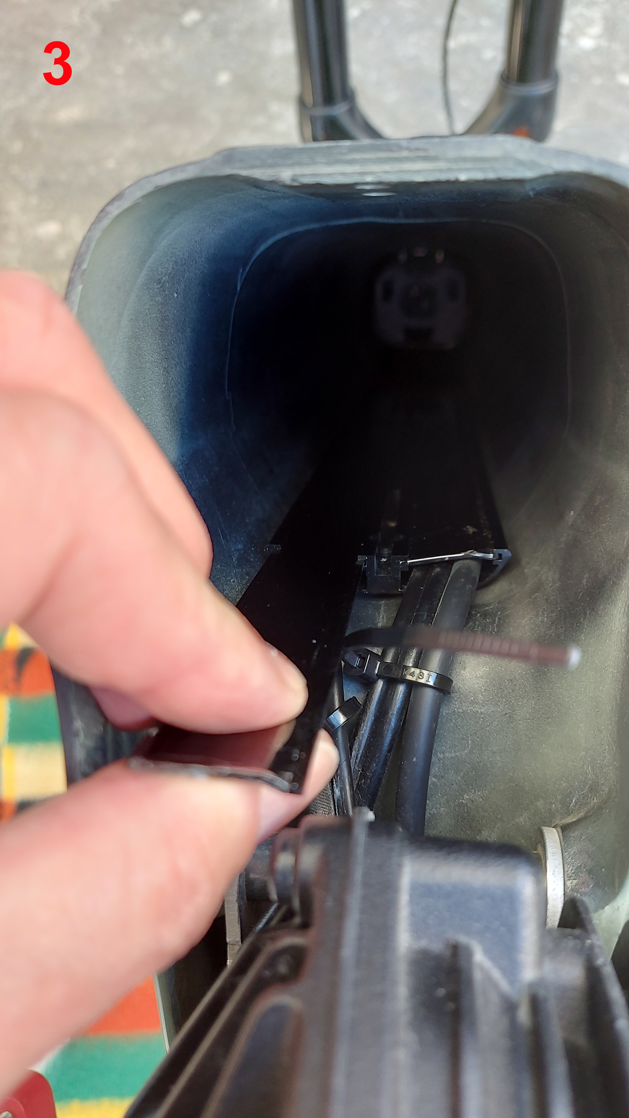

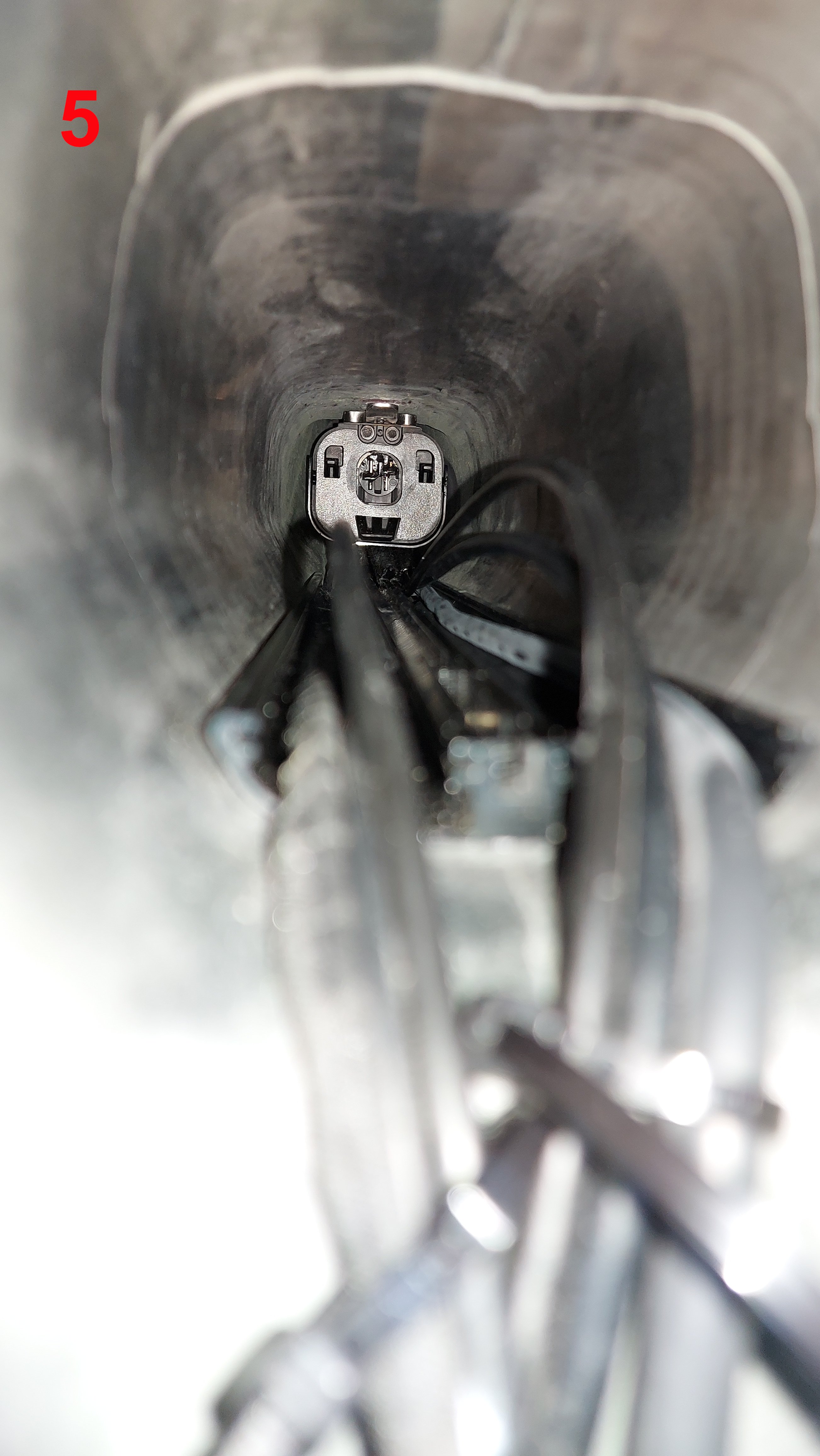

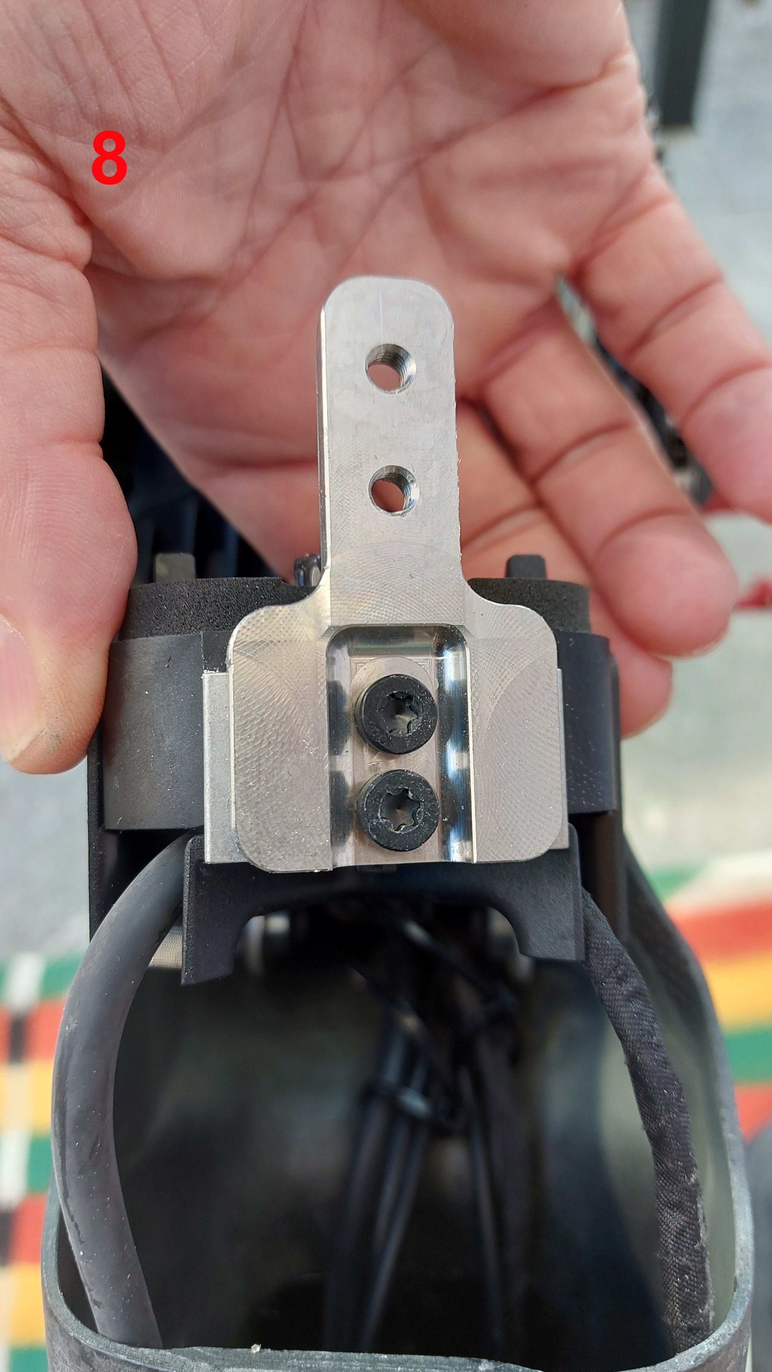

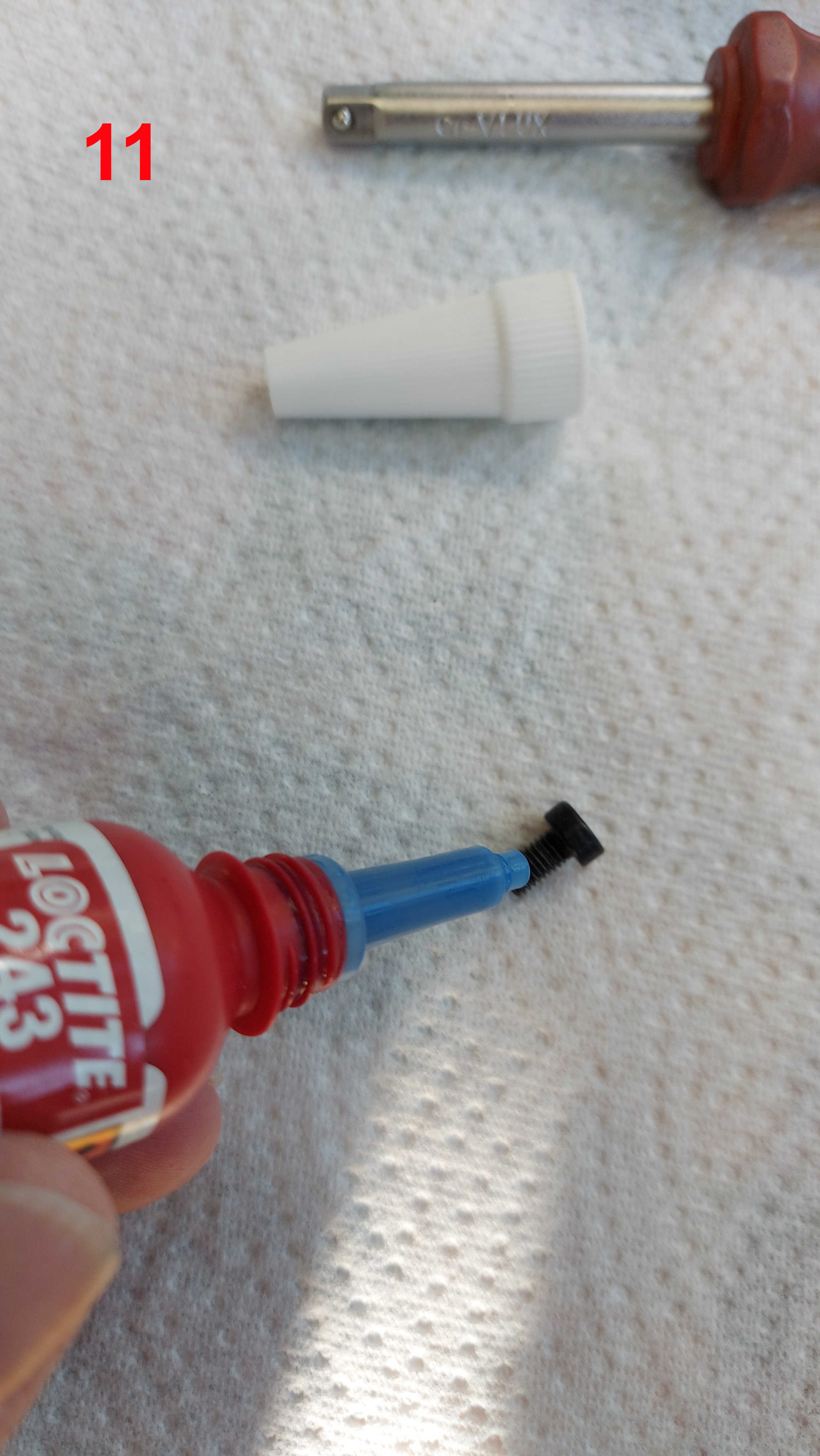

So, now here is it, not as video but as photo-story, the famous @Mario Antony threadlock mod:
Before: Remove battery

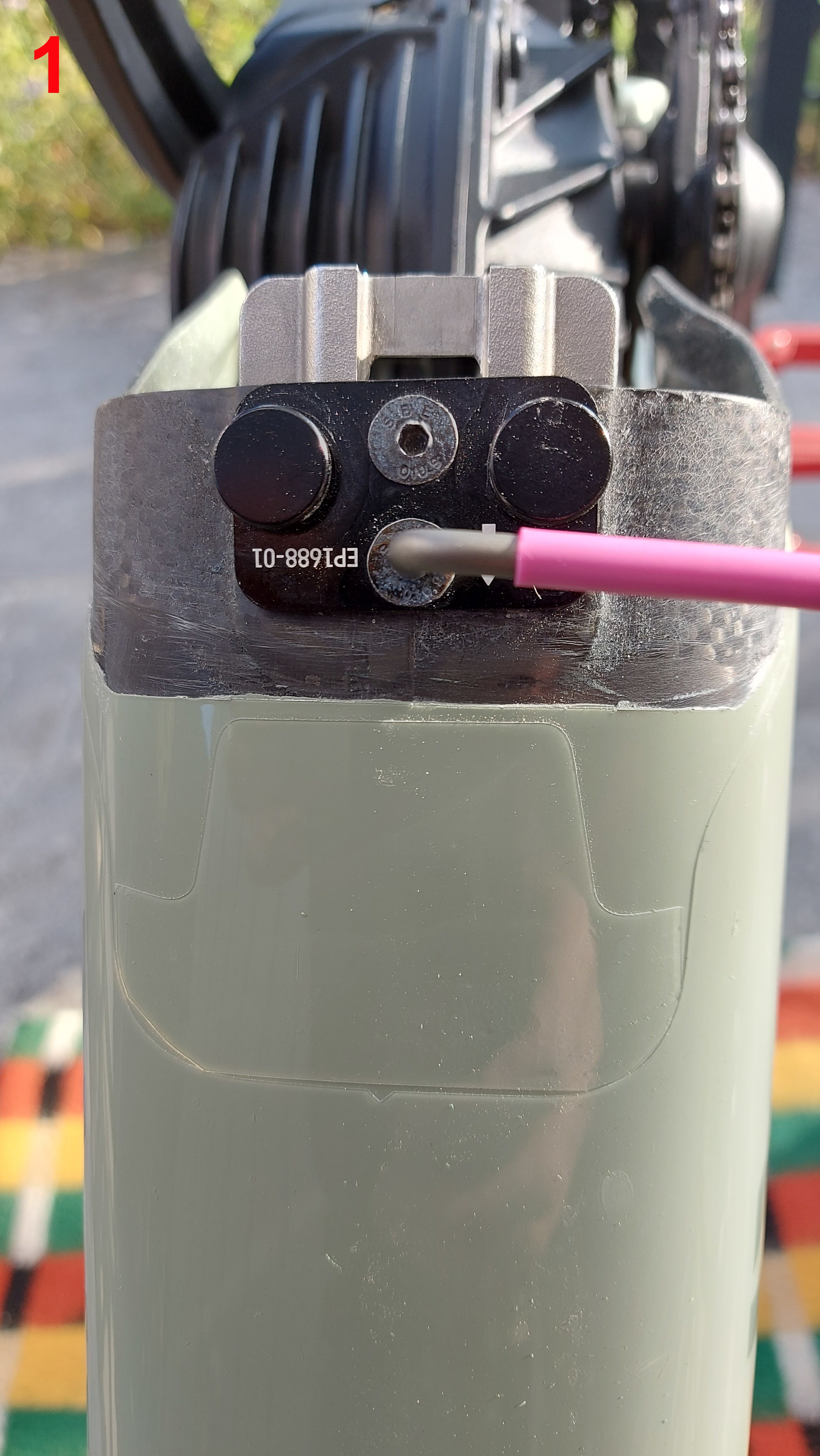

1: Disassemble lower bracket (to slip in with your arm more easly)

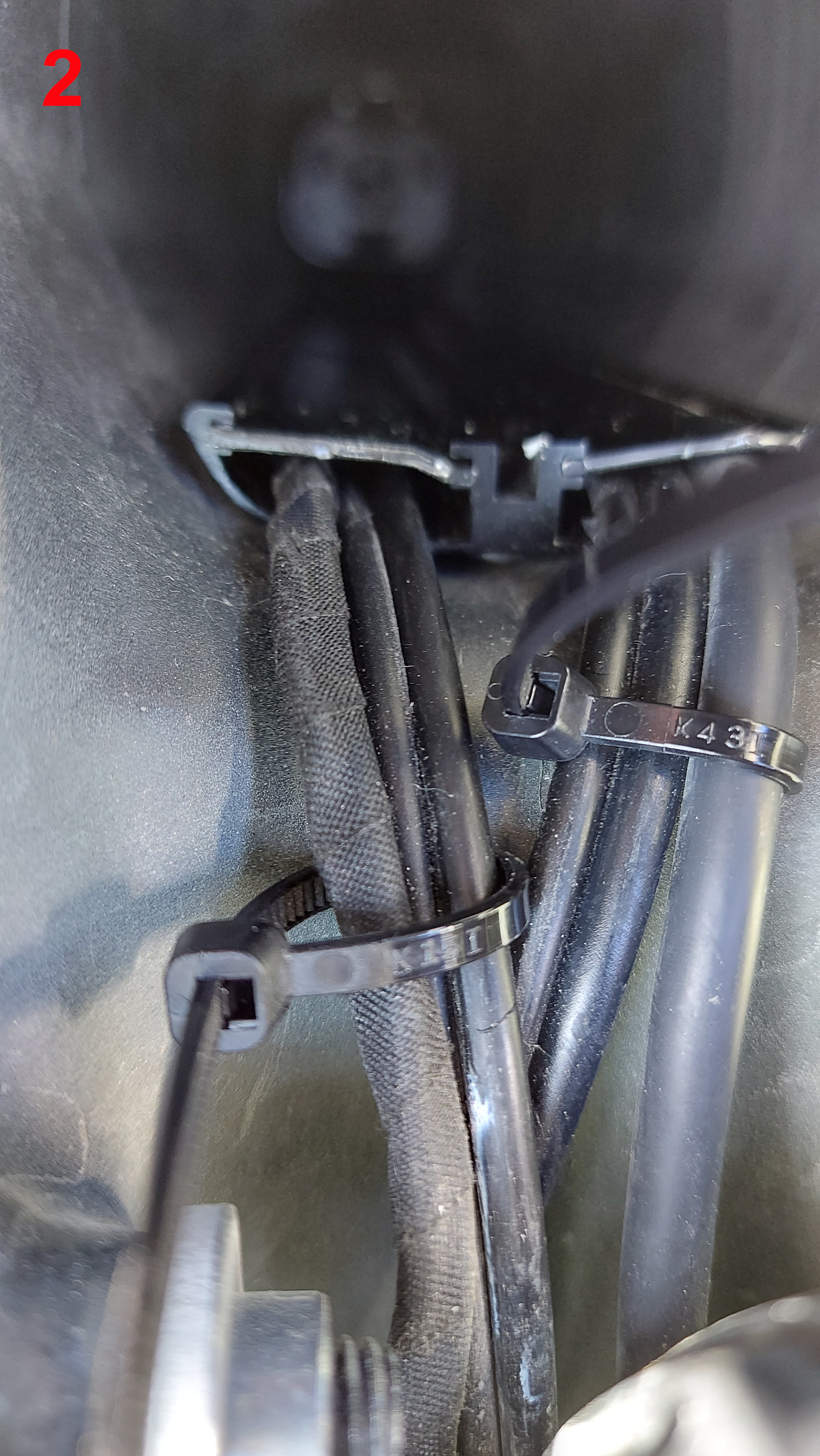

2: Zip tie the cables (2 groups, left and right cable duct)
3: Remove the metal strips that protect the cables (just pull out by hand, no tools needed)

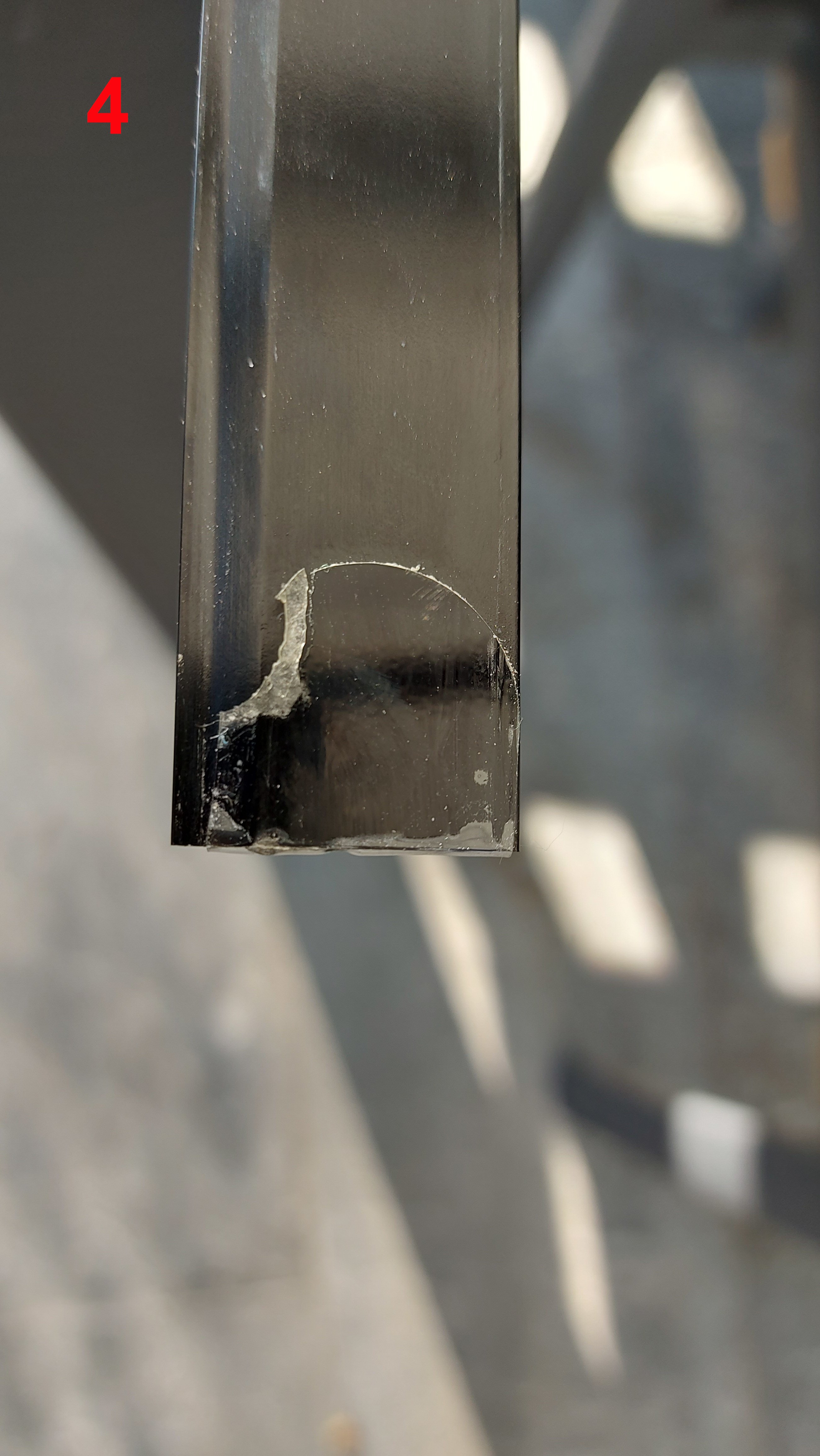

4: I didn't notice before but the ends of the metal strips are covered with tape, so no danger to damage the cables
5: Should look like this then

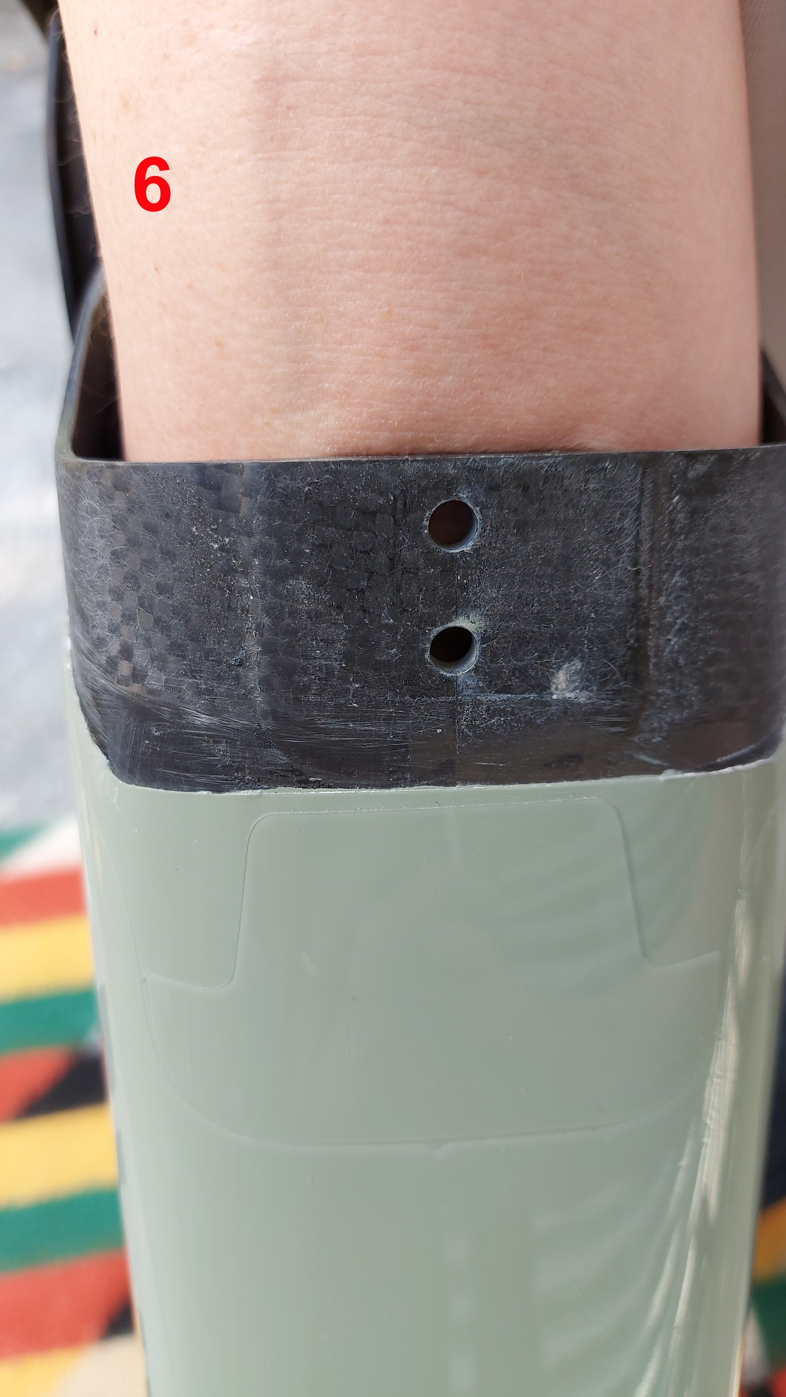

6: Put in your hand and grab the upper battery holder

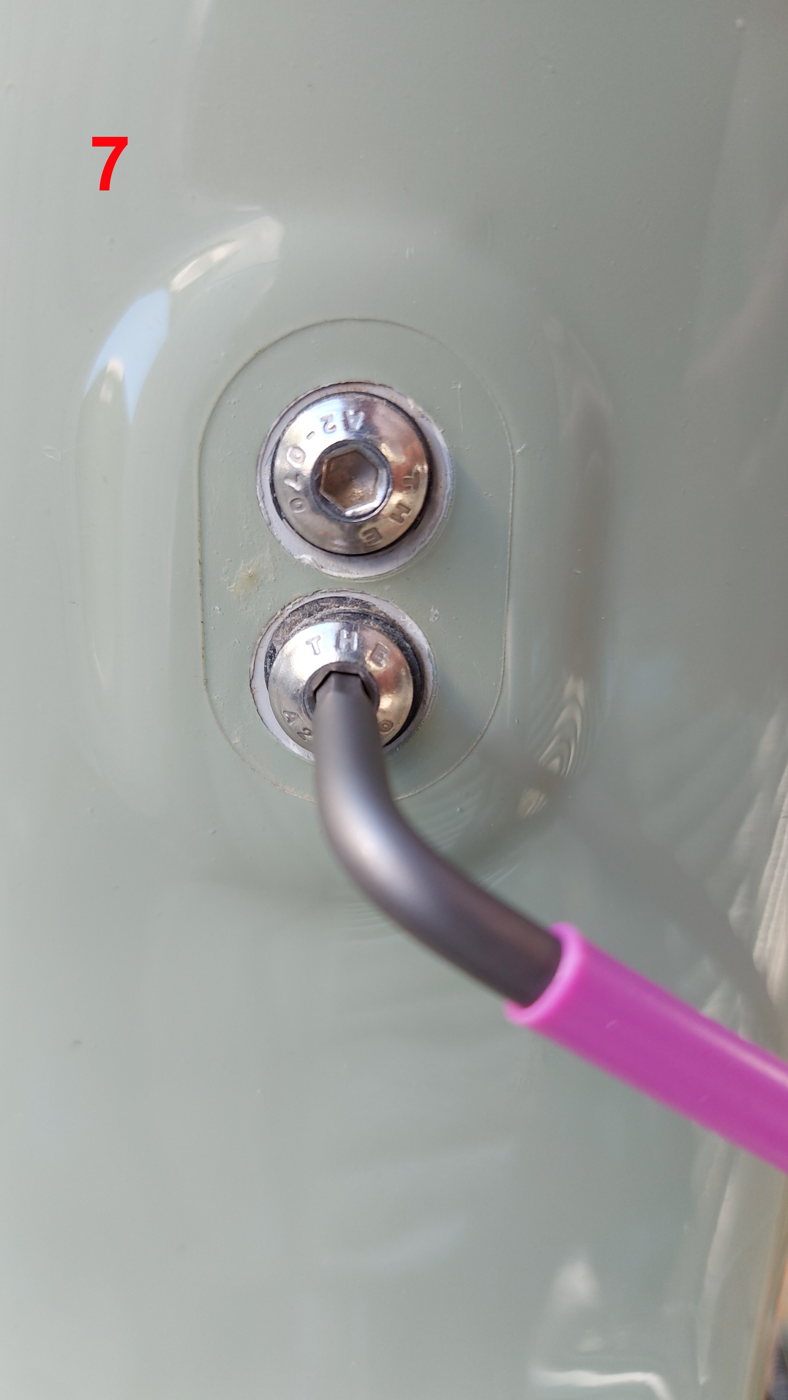

7: Loosen the screws on the outside of the downtube
8: Pull the upper battery holder out (no worries it cannot fall back into the frame)

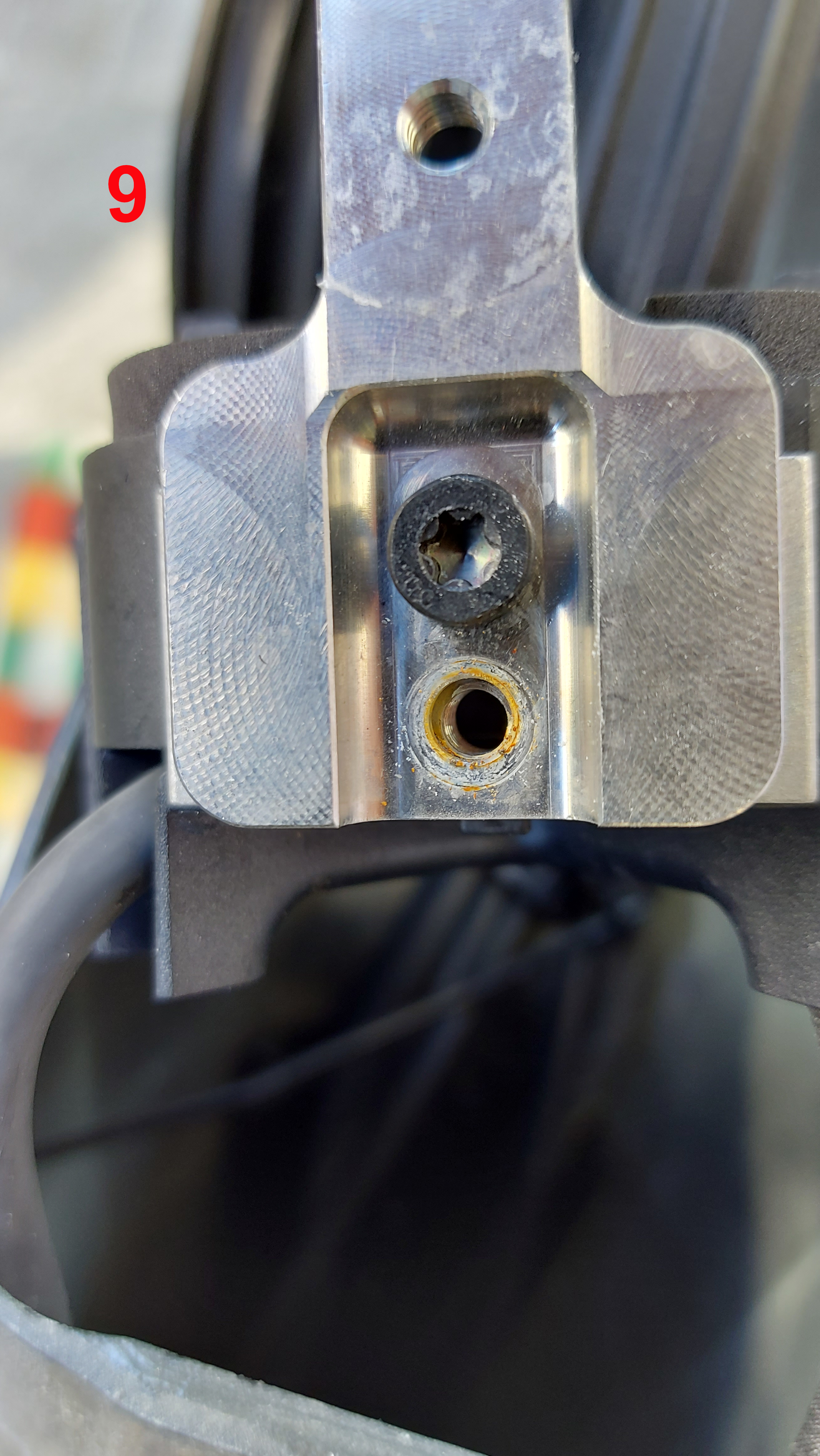

9: Loosen screws (Torx 25) (one by one)
10: Buy Loctite 243 (better do it before you start)
11: Apply Loctite to the screws and fasten to 5 Nm
12: Do the same with the other two srews (T20) and fasten to about 3 to 4 Nm

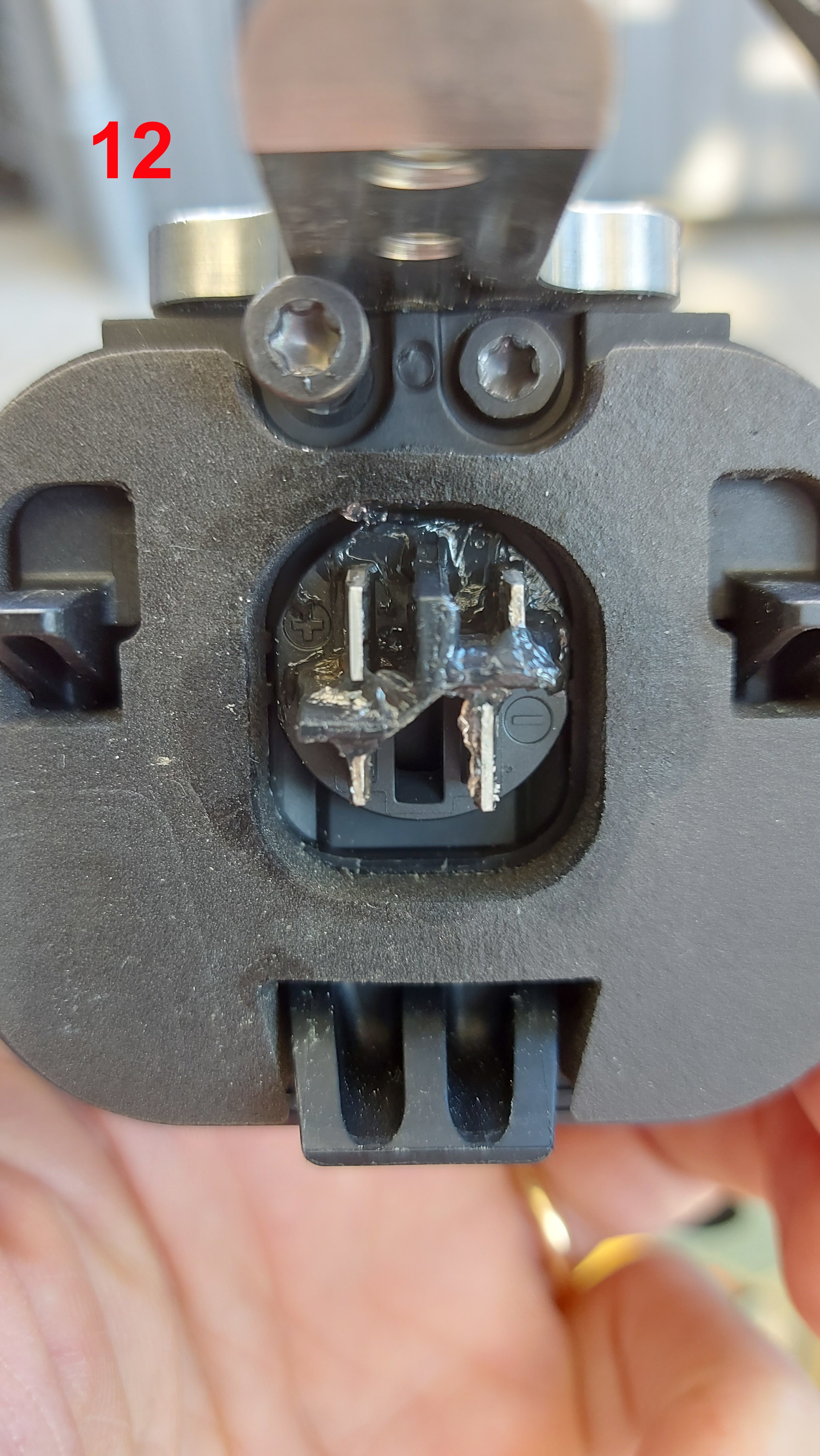

By the way: the grease you see on the battery terminals is pole grease. It helps prevent corrosion of the terminal pins.
Now comes the tricky part (better get someone with thin forearms to help you). Push the upper battery bracket back into the frame. Try to hit the two holes, when you've found one: put the screw in and... you've won, the other one is easy. Now do the remaining steps backwards and you're done. Cable ducts are easy. Half an hour all in all... Big peace of mind afterwards!! Have fun.

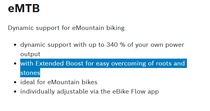

hahaha, thanks guys... regarding the turbo mode...
actually my "red" mode is EMTB with everything maxed BECAUSE you have a longer overboost as in turbo ;) (not sure why bosch did this but yeah... they even say EMTB mode have a longer overboost but i was surprised turbo hasnt the same one during my tests... e.g. you will see that at normal speed a pedal kick will follow with at least one more spin from the drive unit... during downhill you will also notice that in compression where you have the normal pedal kickback, the drive unit gives you more pushs)
my purple is auto, this is a good one for uphills

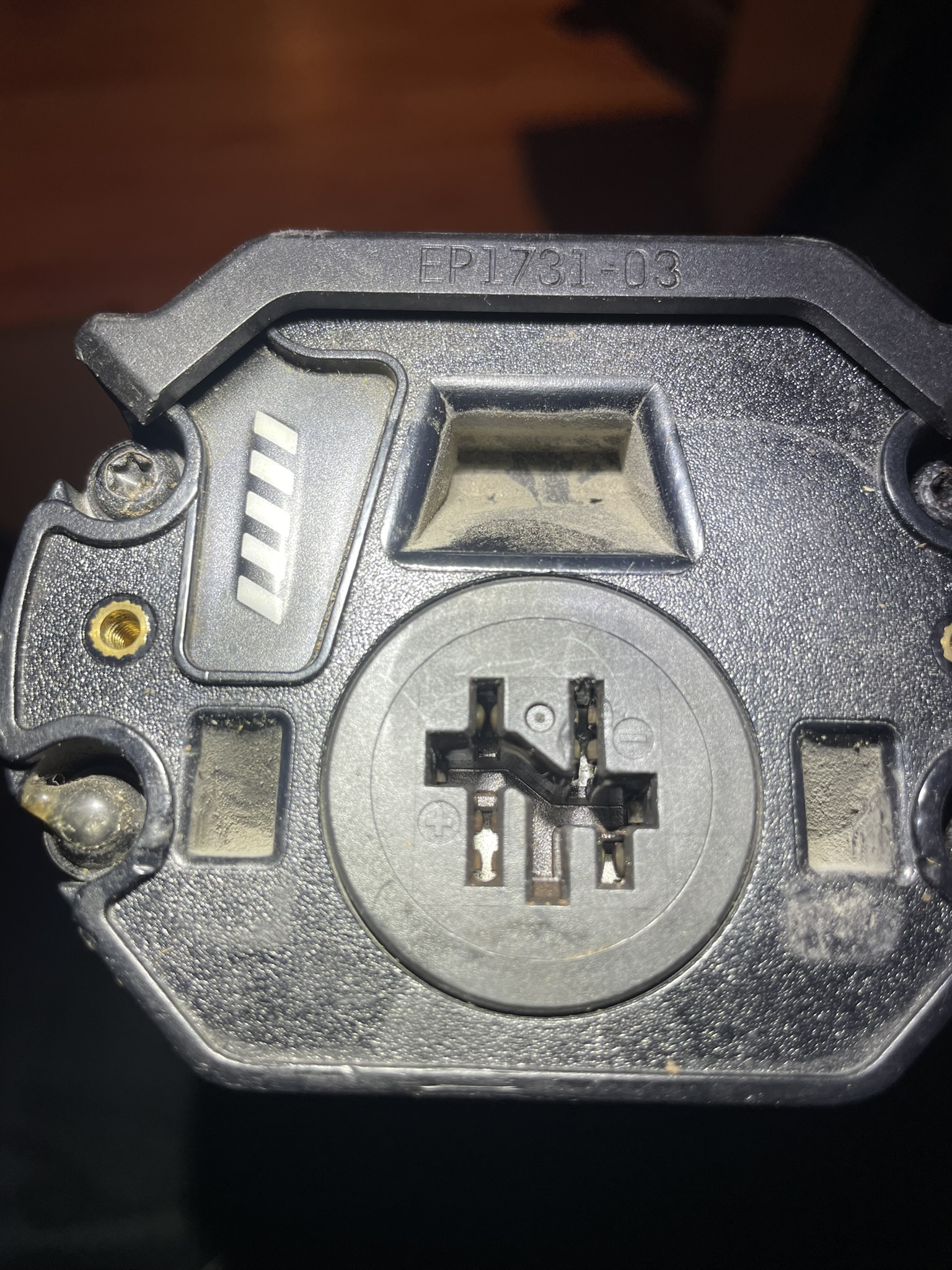

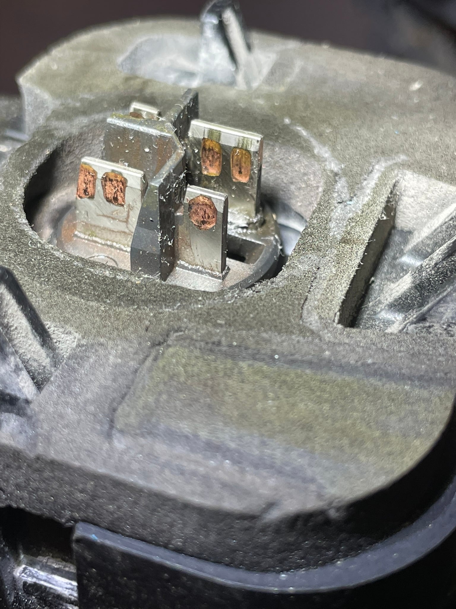

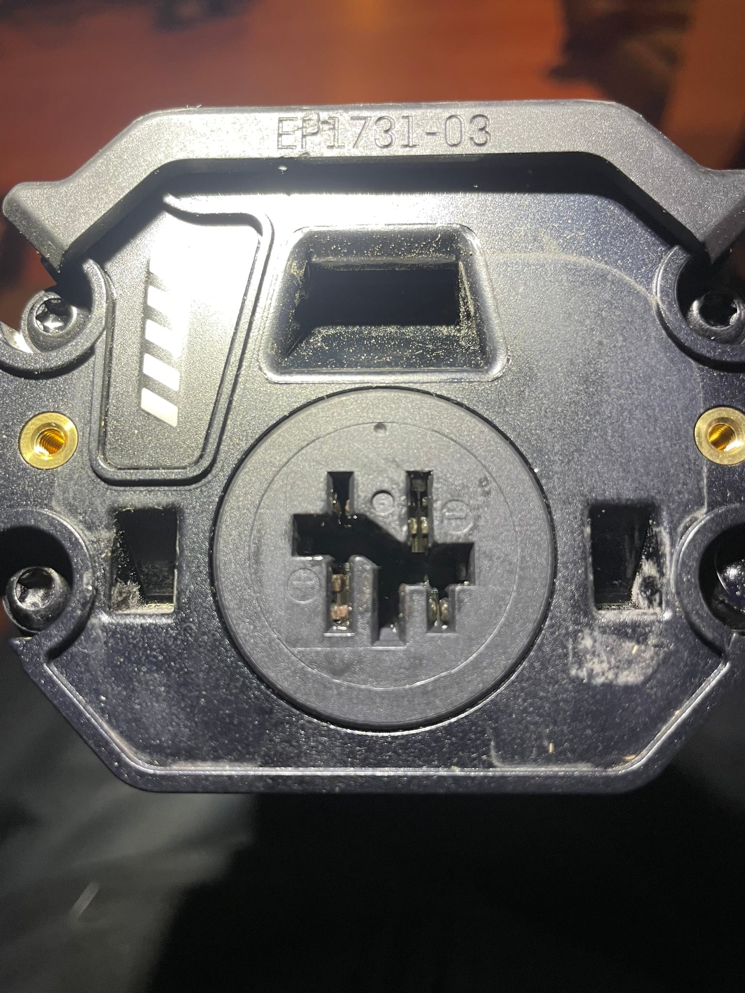

Coming back to my power cuts… Connector screws are still tight and no movement… cables looking okay from what I can see in this side of the connection… only thing I have notice is very visible wear of the connectors… you can also feel it when moving over them… not sure if this can lead to this but my 1 year old battery has more power cuts than my new replaced one… the pins inside the batteries have clearly a difference in space…
old battery, connector is barely visible
new battery, connector is good visible
Good chance that's probably it, I reckon.
I wonder if replacing the bike side of the connector would fix it?
Coming back to my power cuts… Connector screws are still tight and no movement… cables looking okay from what I can see in this side of the connection… only thing I have notice is very visible wear of the connectors… you can also feel it when moving over them… not sure if this can lead to this but my 1 year old battery has more power cuts than my new replaced one… the pins inside the batteries have clearly a difference in space…View attachment 150303
not sure the materials make up of the connector pins but looks like they are/were copper with a harder surface material. That surface material has worn away probably due to arcing. It needs to be replaced because it will not provide a secure connection to the female battery connectors.
