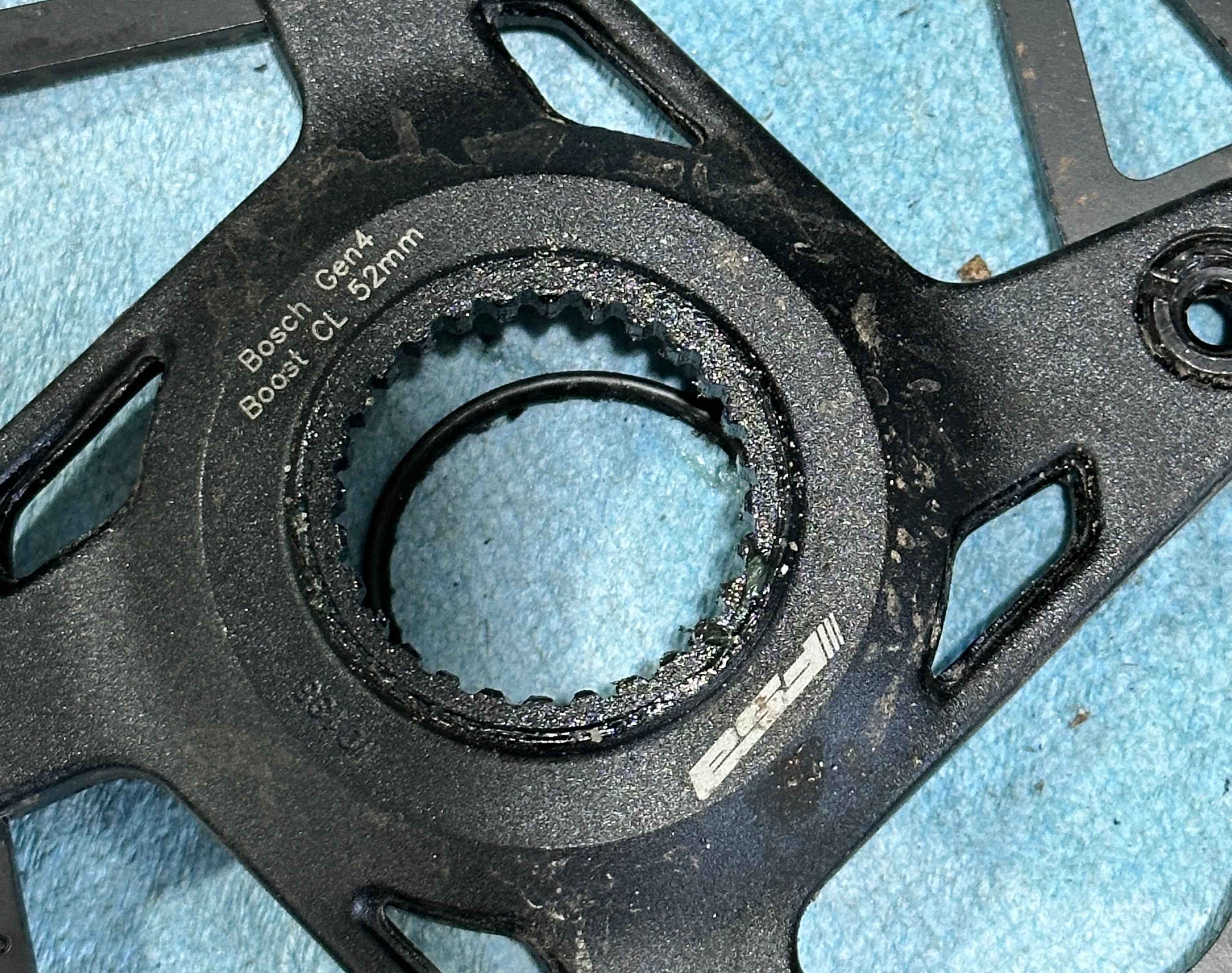

Yup. 52mm spider. Idiots. I’m so pissed. Brand new bike!!! 😡😡😡
WOW! I am wondering if I have this same problem. My wife and I both have Strive ON's, hers is a small and mine a medium. Here chainring isn't rubbing but it is very very close, and looks quite a bit closer to the frame than mine. I will have to check!

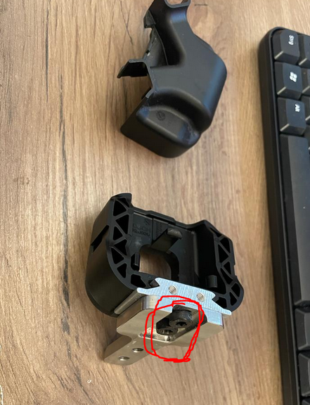

The upper Battery bracket is supported in total by 6 bolts (if I'm not wrong... didn't take any pictures!)
So there is 2 holding the backet to the frame, acessible by the outside.
And then there are 2 more:
2 in front (if you look inside the downtube)
2 underneath (if I recall correctly) --> these were the ones I found unbolted, and connect the bracket itself to the stainless steel adaptart that than it's connected to the bike throught the bolts you see outside on the downtube.
I found this picture hope it helps.
The highlighted bolts were found ½ and ¼ unbolted.
After all being assembled with lockthread (btw - only the outside bolts have from factory!), and assembled with a simple solution I've made and still testing, everything is working better than new!
No noise from the battery, no disconnections, nothing! Well... at least ±200km after I've made this.
