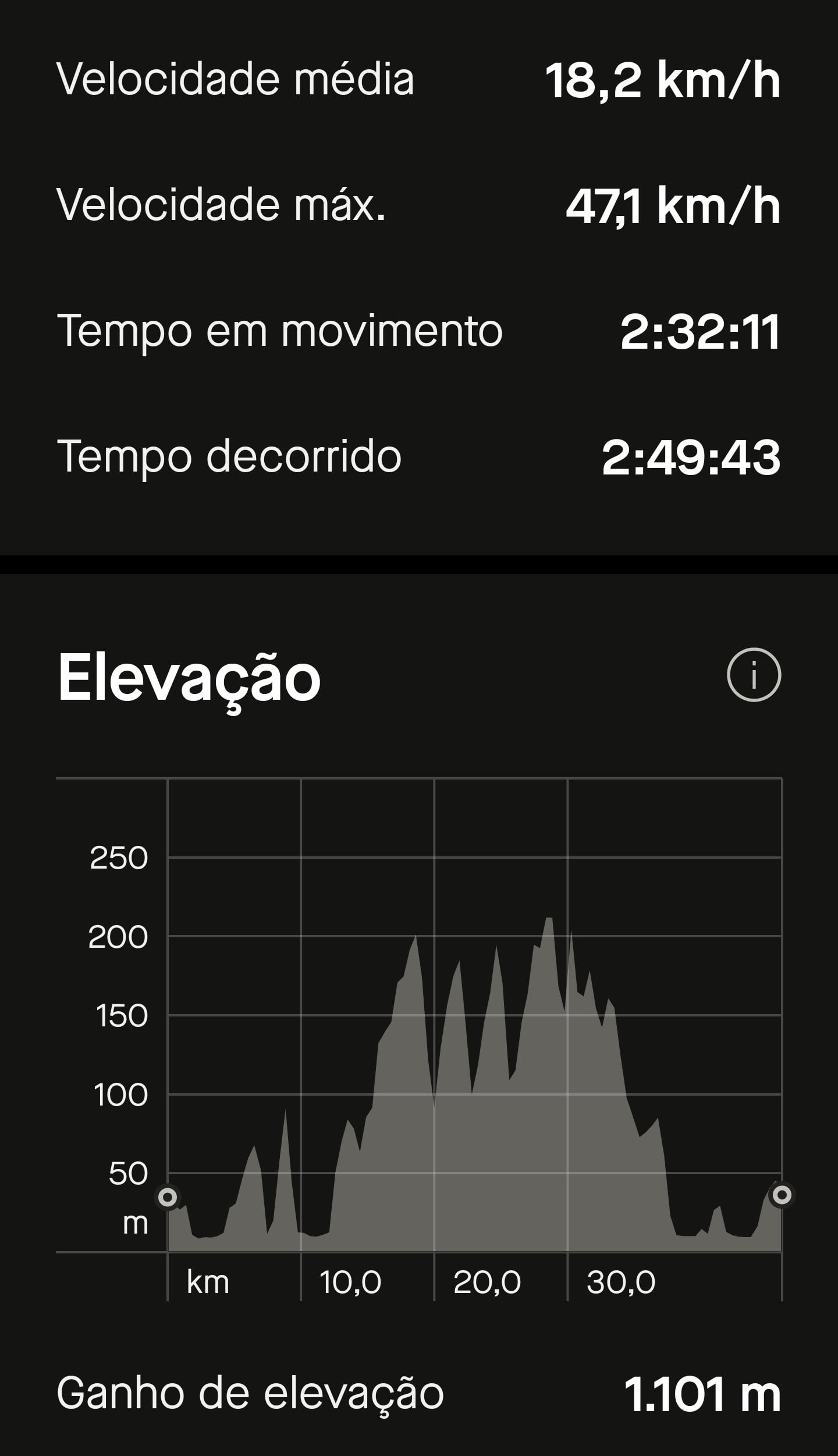

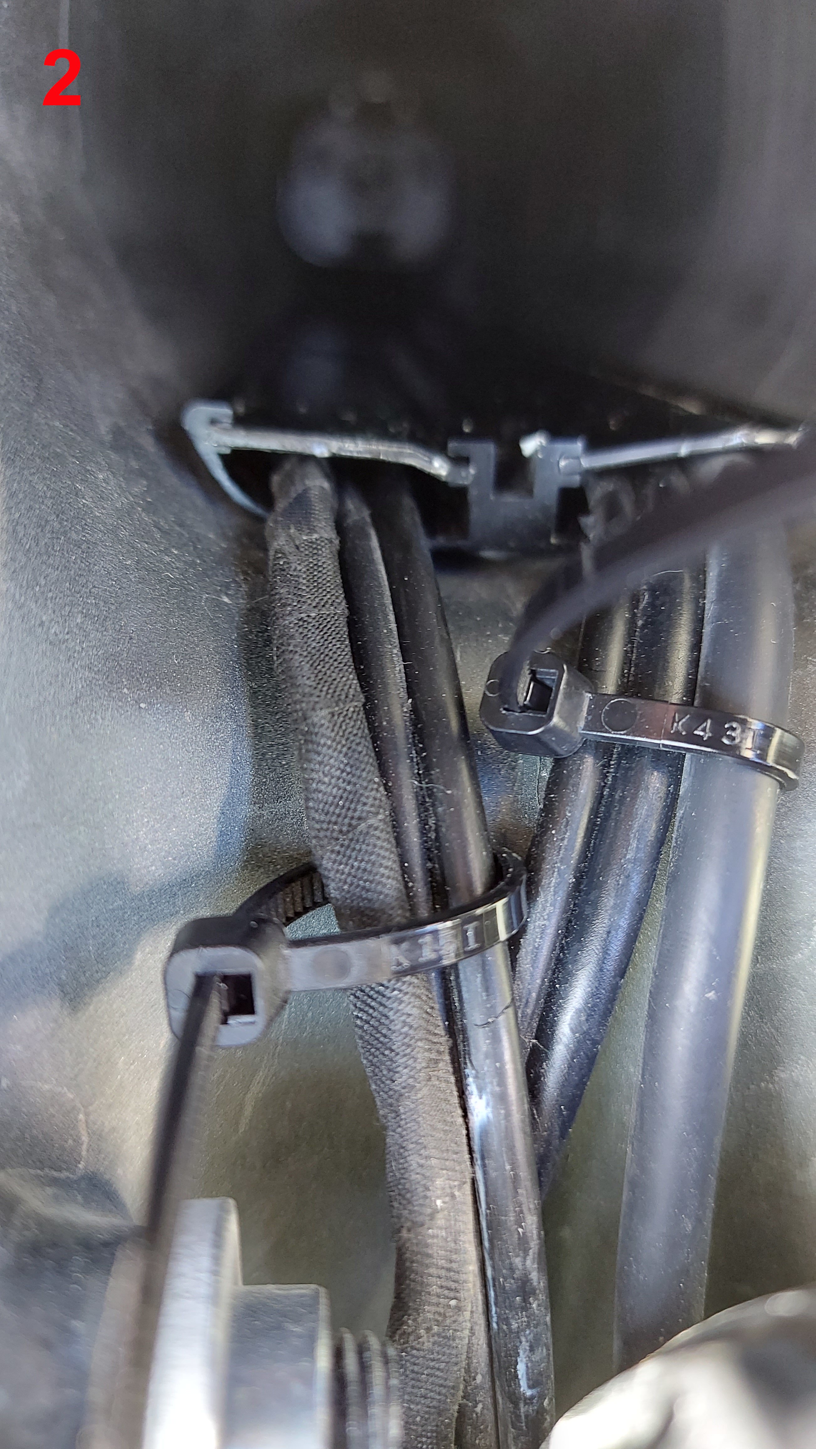

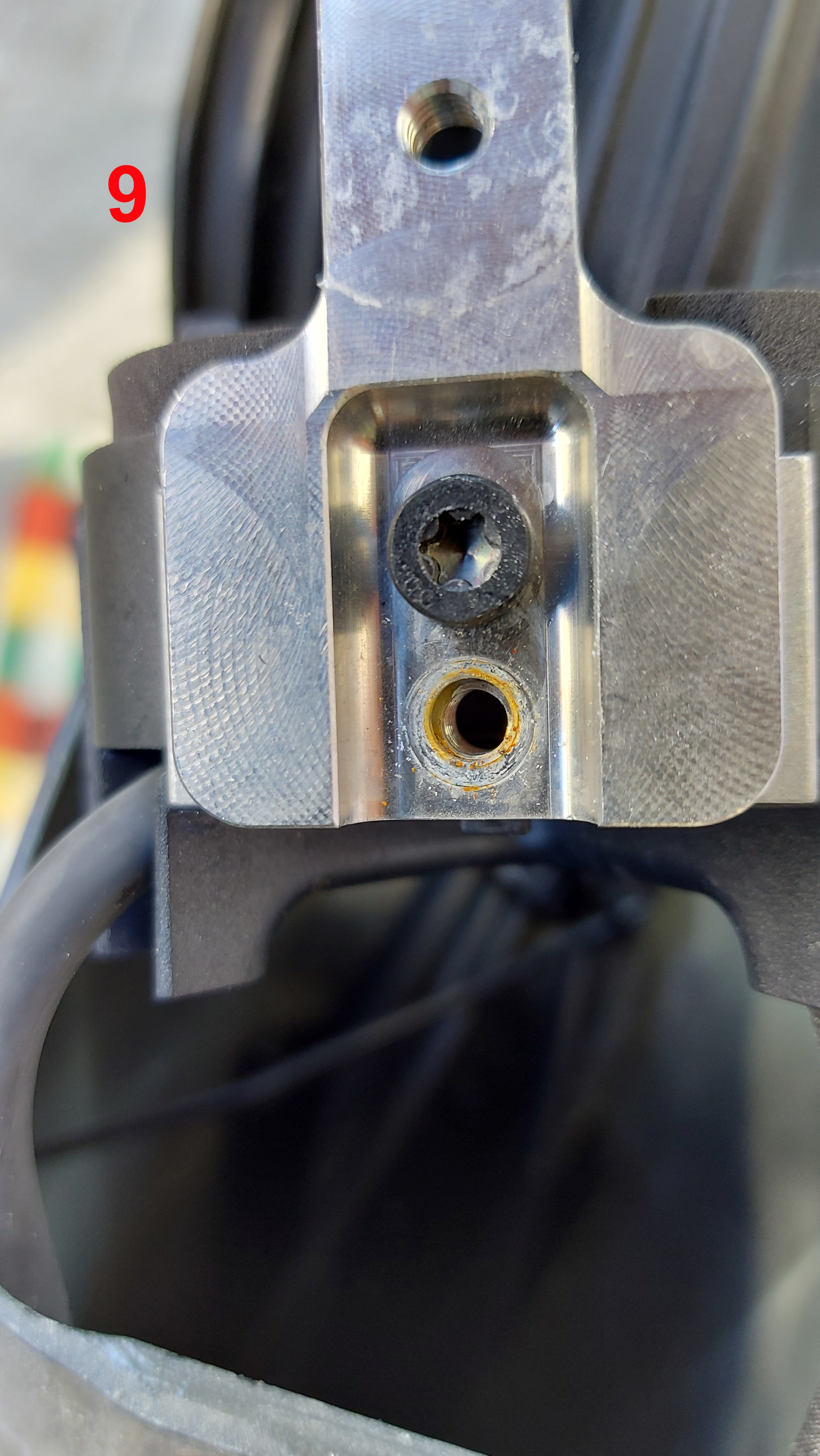

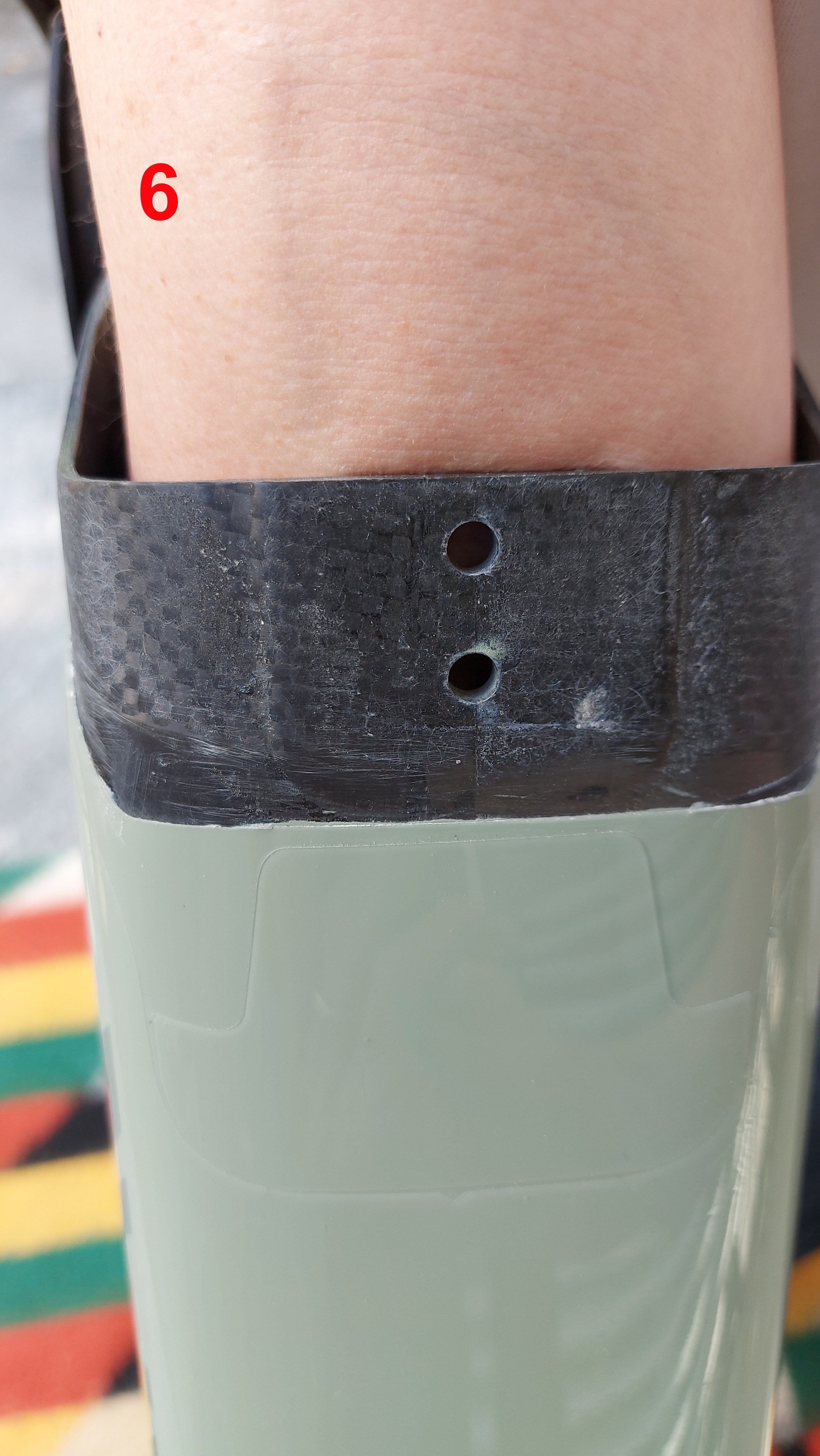

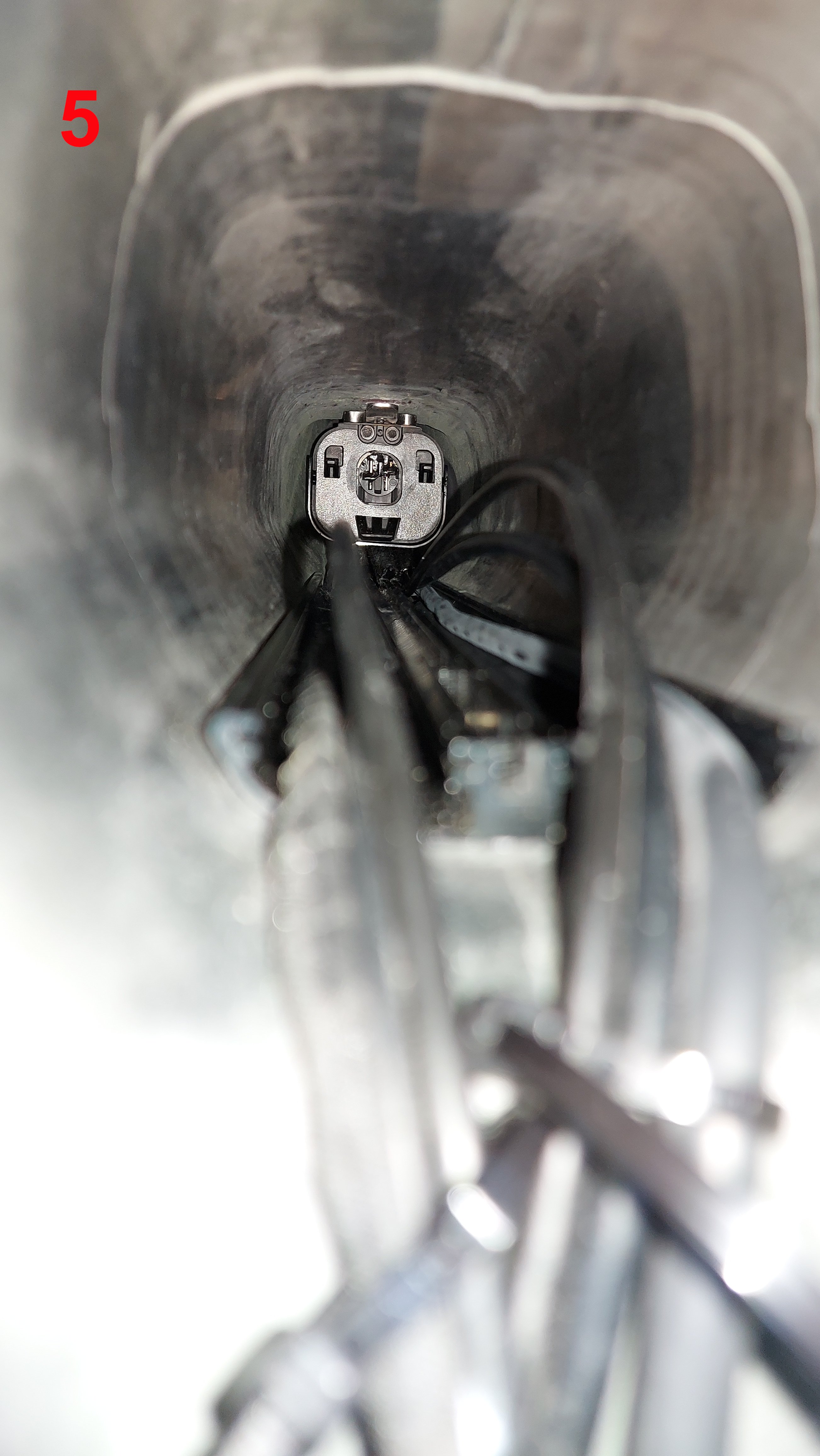

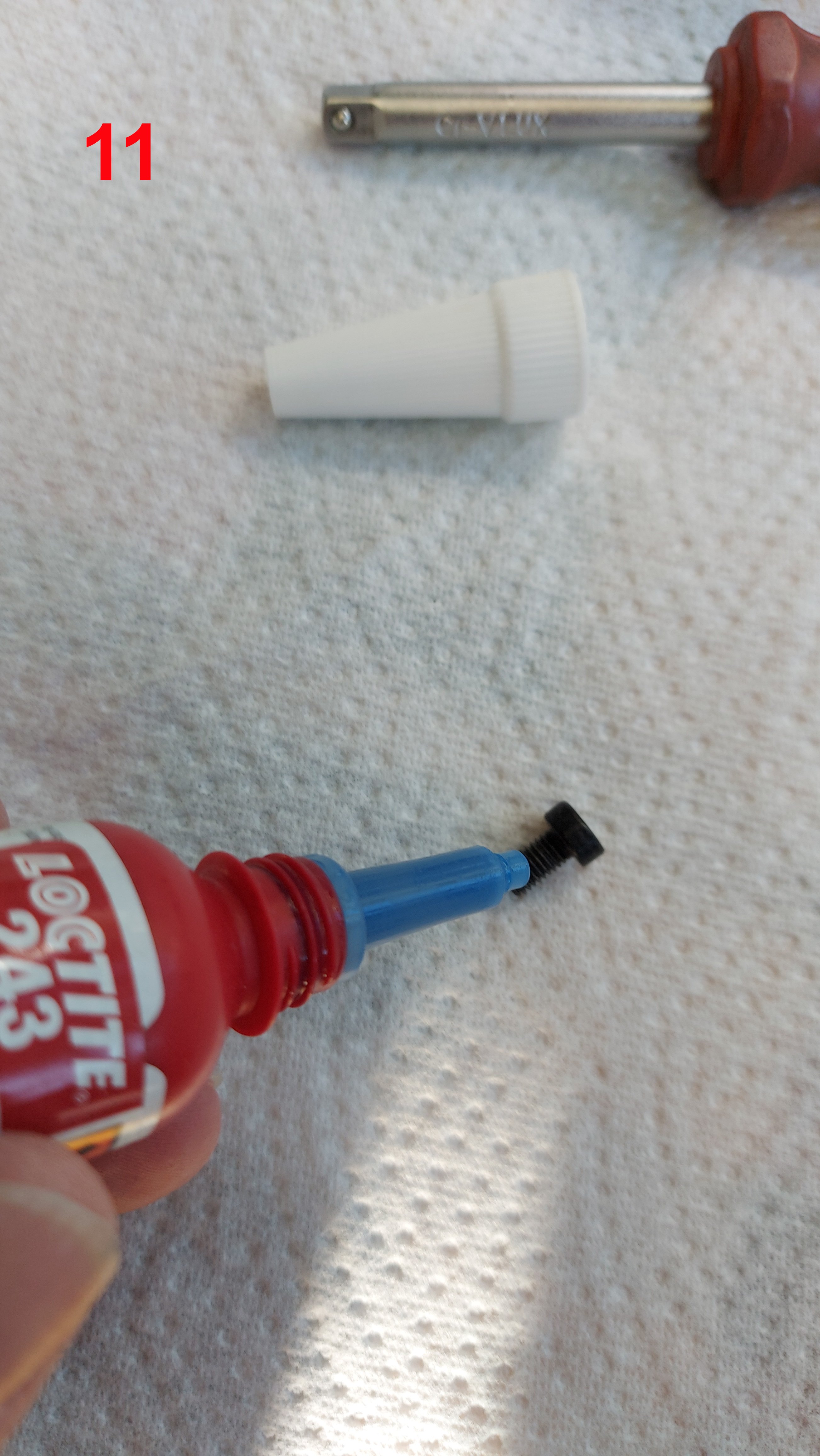

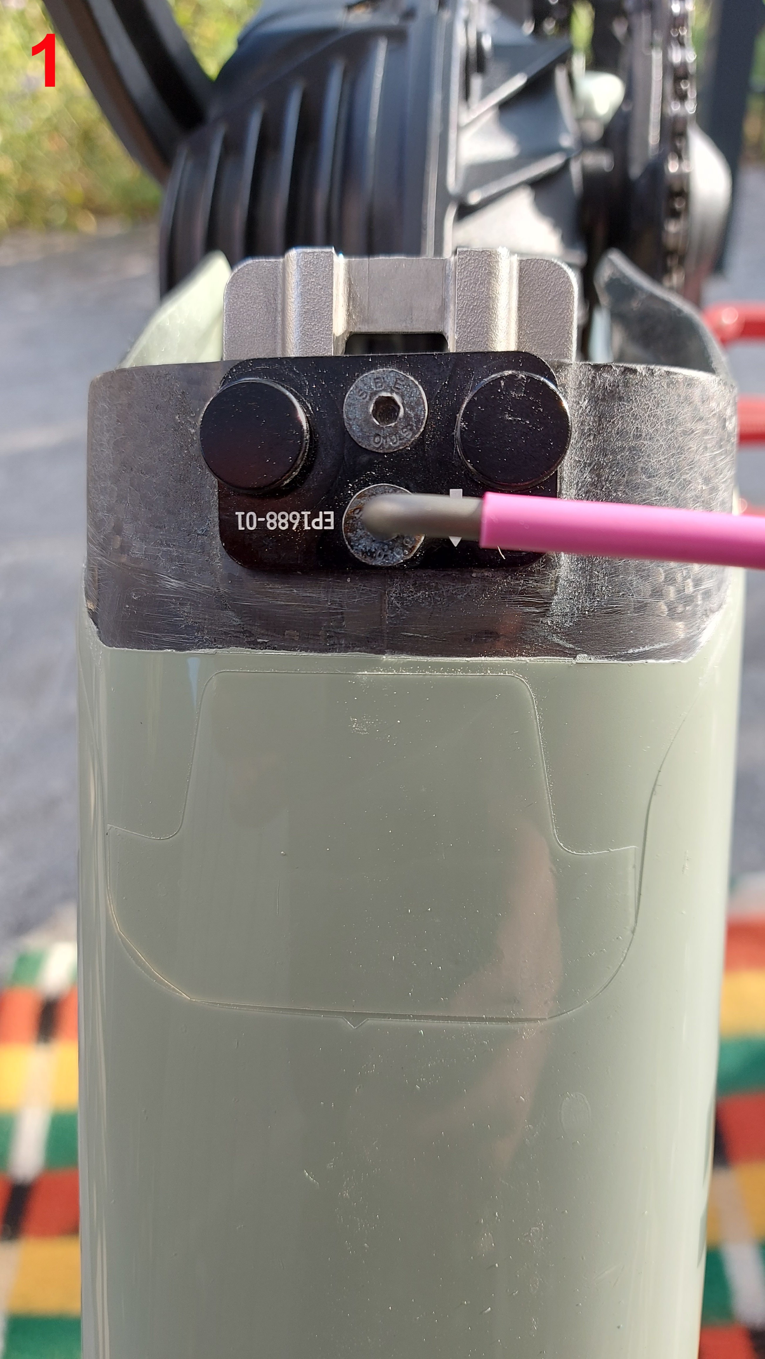

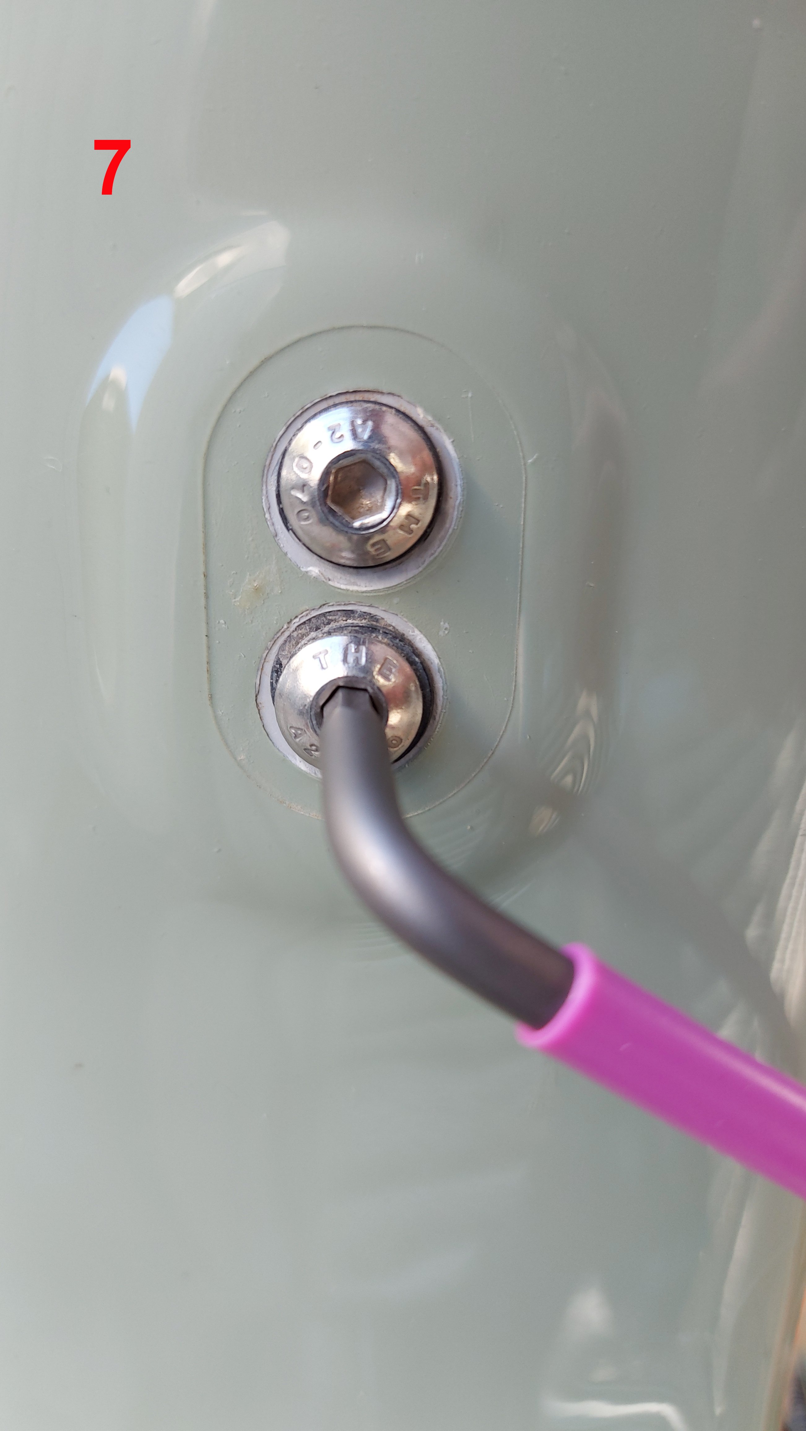

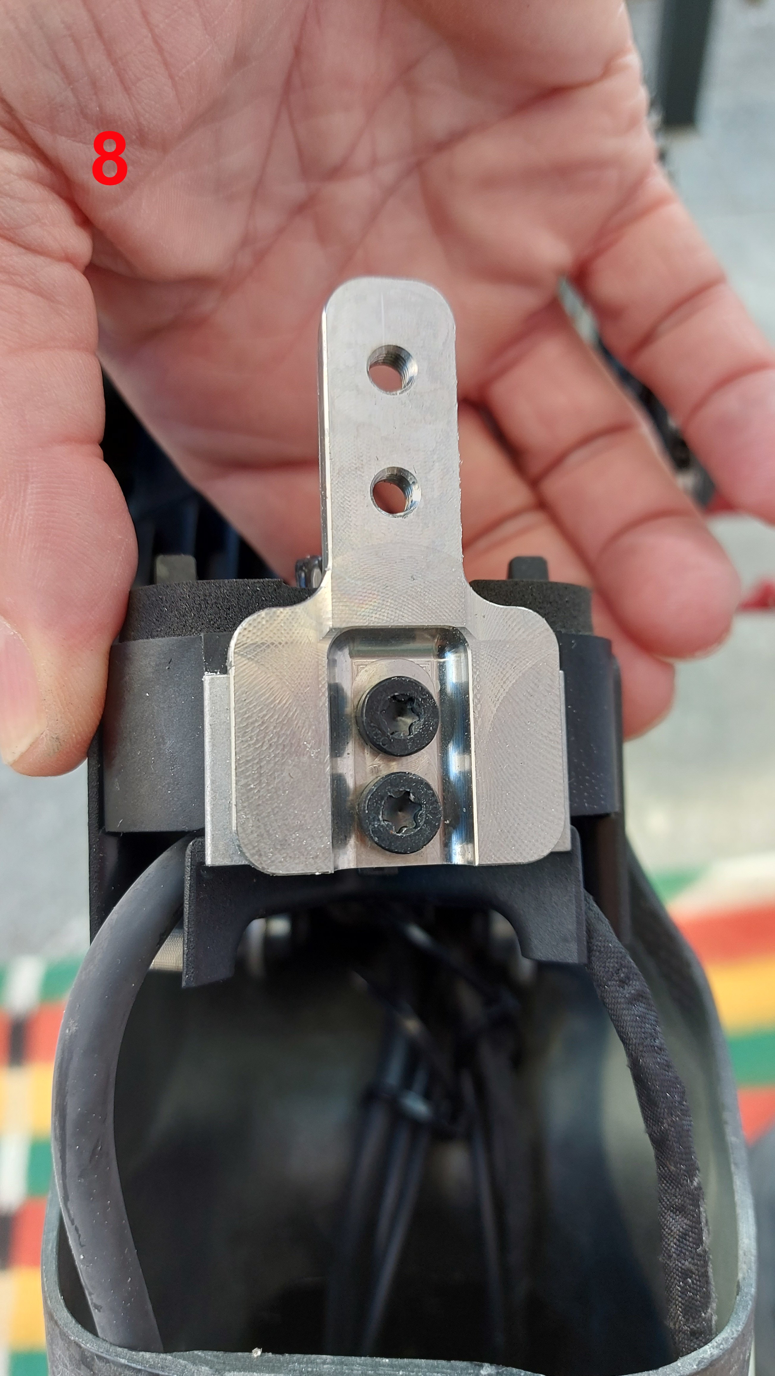

So, now here is it, not as video but as photo-story, the famous @Mario Antony threadlock mod:
Before: Remove battery
1: Disassemble lower bracket (to slip in with your arm more easly)

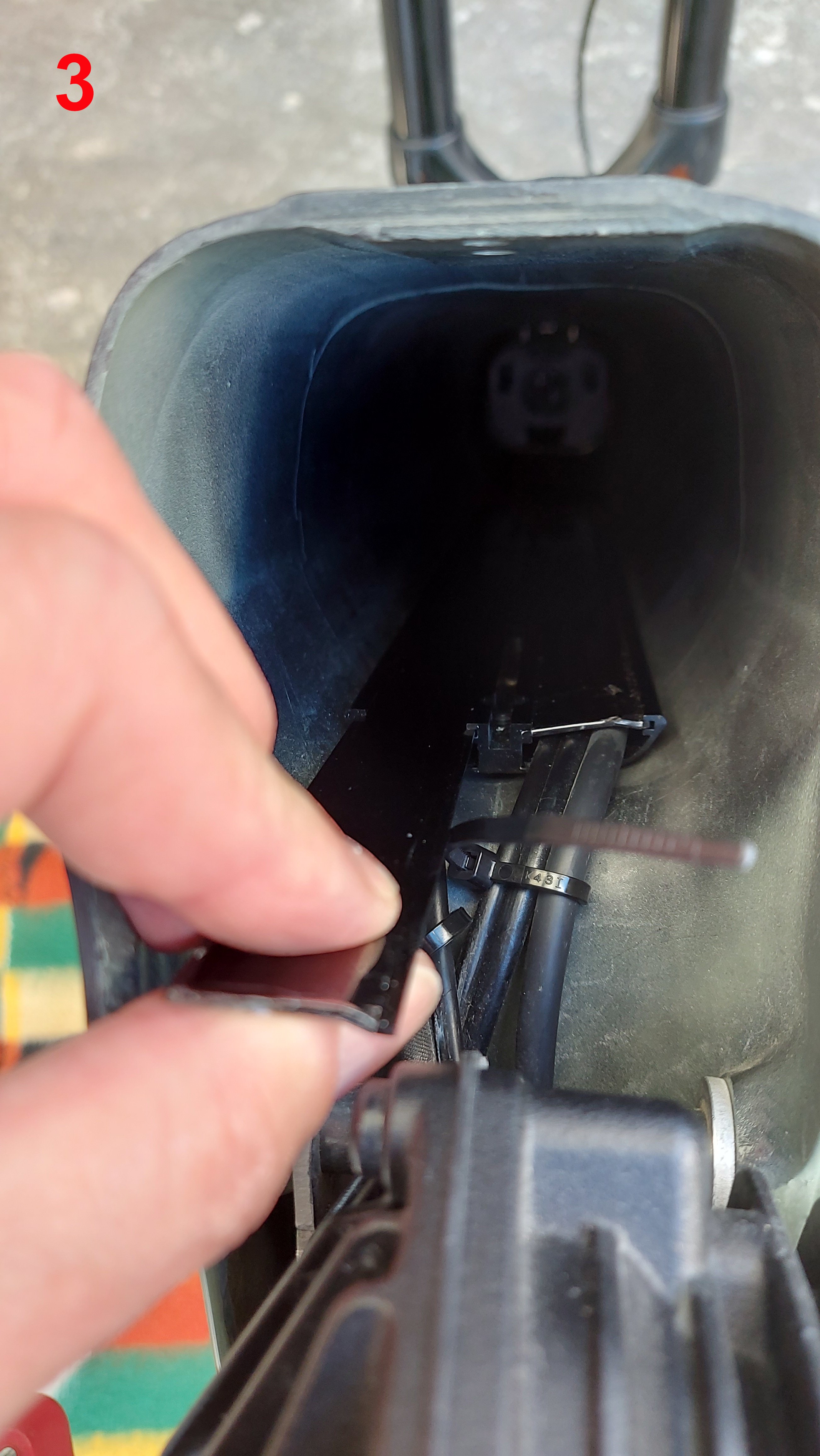

2: Zip tie the cables (2 groups, left and right cable duct)
3: Remove the metal strips that protect the cables (just pull out by hand, no tools needed)

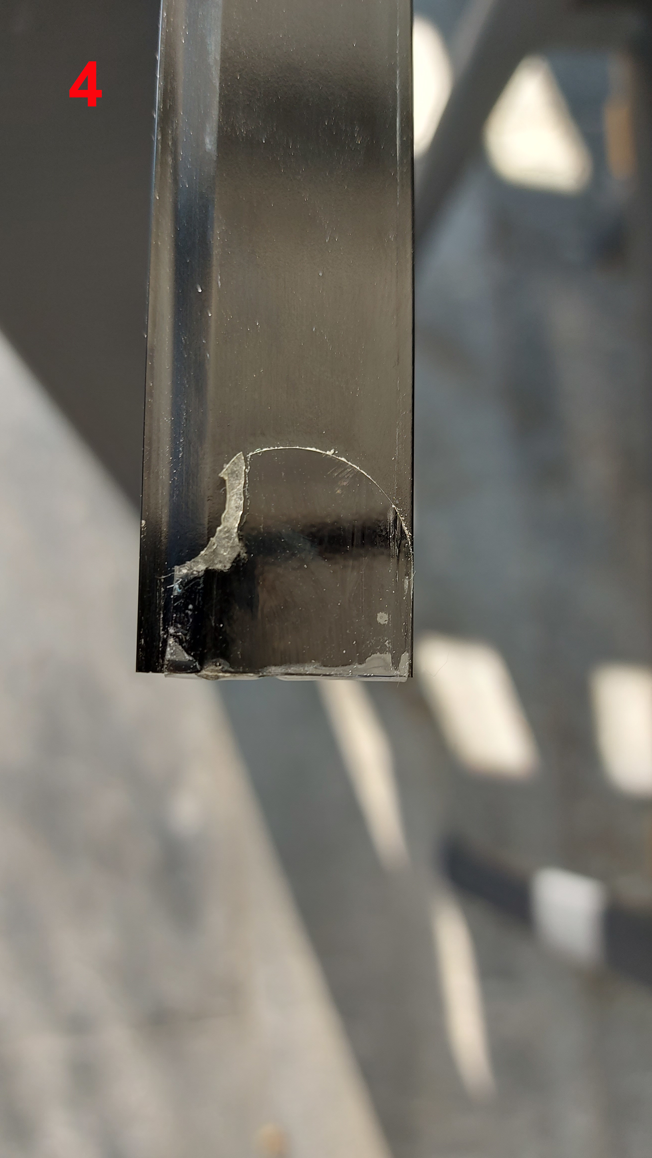

4: I didn't notice before but the ends of the metal strips are covered with tape, so no danger to damage the cables
5: Should look like this then
6: Put in your hand and grab the upper battery holder
7: Loosen the screws on the outside of the downtube
8: Pull the upper battery holder out (no worries it cannot fall back into the frame)
9: Loosen screws (Torx 25) (one by one)

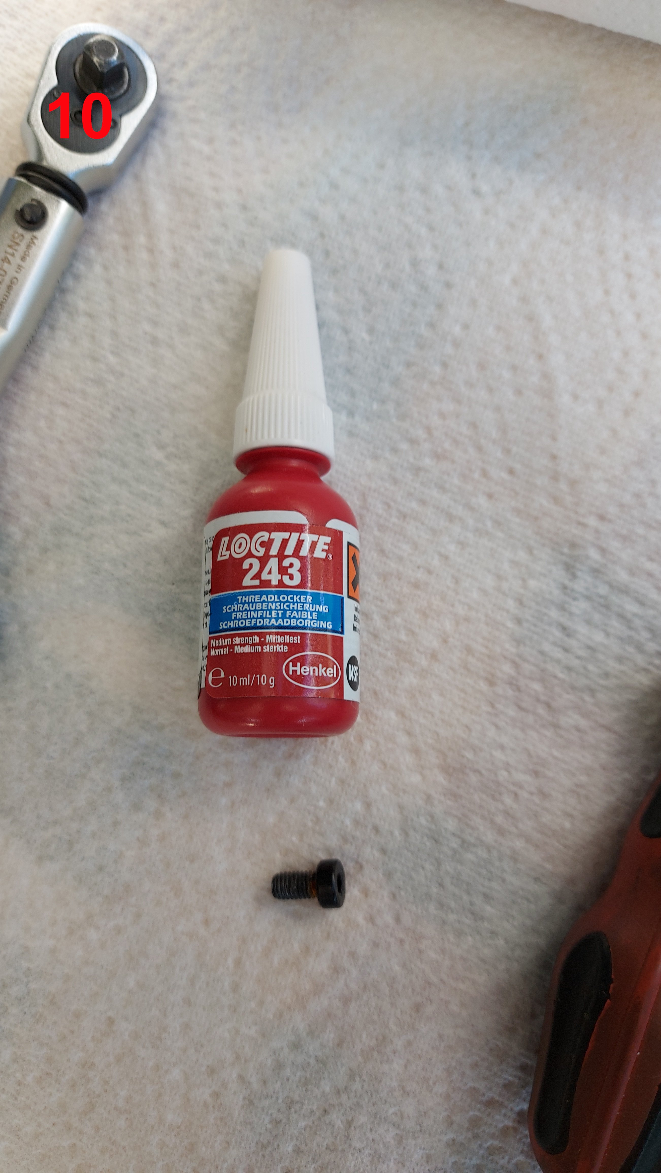

10: Buy Loctite 243 (better do it before you start)
11: Apply Loctite to the screws and fasten to 5 Nm
12: Do the same with the other two srews (T20) and fasten to about 3 to 4 Nm

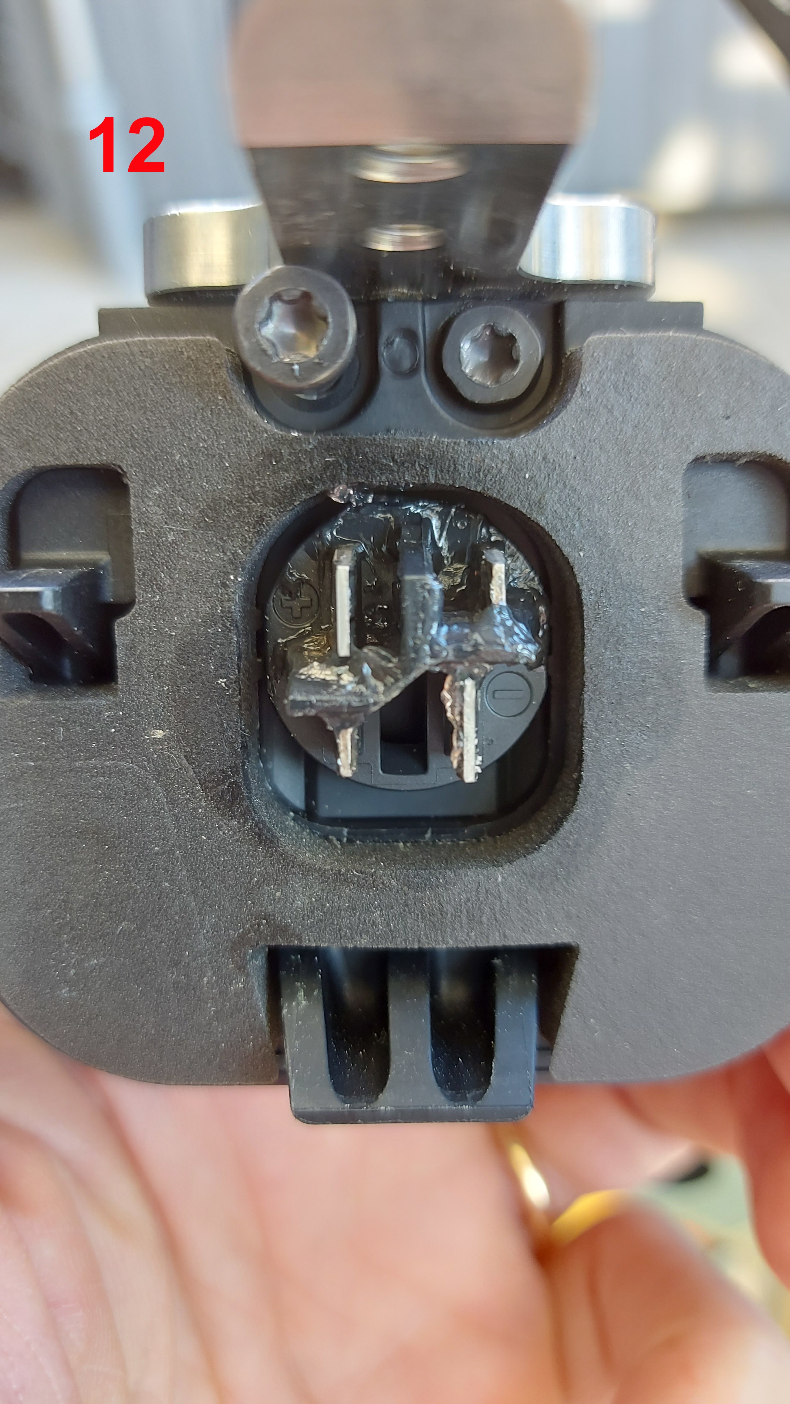

By the way: the grease you see on the battery terminals is pole grease. It helps prevent corrosion of the terminal pins.
Now comes the tricky part (better get someone with thin forearms to help you). Push the upper battery bracket back into the frame. Try to hit the two holes, when you've found one: put the screw in and... you've won, the other one is easy. Now do the remaining steps backwards and you're done. Cable ducts are easy. Half an hour all in all... Big peace of mind afterwards!! Have fun.
View attachment 145933View attachment 145934View attachment 145935View attachment 145936View attachment 145937View attachment 145938View attachment 145939View attachment 145940View attachment 145941View attachment 145942View attachment 145943View attachment 145944
Just did this today. All my bolts were tight but I consider it a bit of preventative maintenance and happy I did it. The pictures really helped.
One further tip for everyone. Take a photo of the order that your cables lay inside the tracks and I had one swap over and it was easier to get the slider in with the cables in the same layout as originally. Could’ve just been me mind you but hey if it helps someone else….

Hi @jxrx, good to know that the pictures helped.
Concerning the cable order: A photo is for sure good, but that's why I suggested to zip-tie the cables. With that there's also no doubt to find the right cable duct again... ;)
