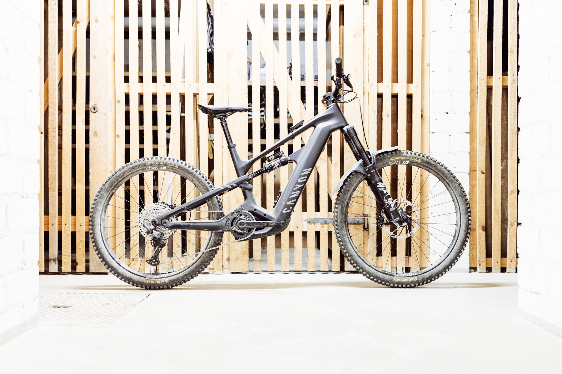

Nearly two years with my Underdog. Still very happy. I made some small changes which makes the bike even more fun to ride:
- Trickstuff brake pads and HS2 discs
- e13 155mm cranks
- Title bar with 50mm rise
- ochain "chainring"
- Conti tires with DH casing (supersoft front)

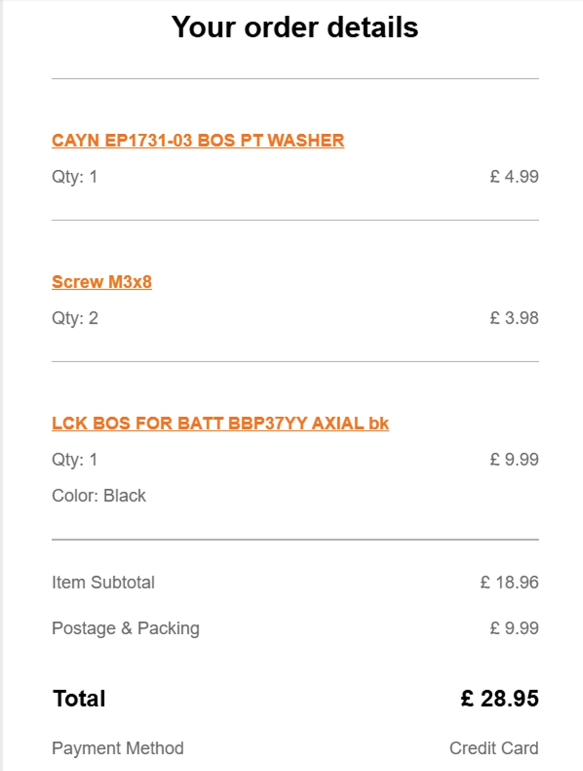

Hey. I'm about to buy a second hand PowerTube 750 battery, but need help sourcing what I need to get it to work in the Strive:ON.
I believe I need:
What I can't figure out is:
  • What screws do I need for the spacer?
  • Is that latch the revised version that prevents the battery disconnection issues?
Thanks :)
EDIT: I spoke with Canyon and they're going to send me everything I need. The screws are M3 x 8mm (I assume they're flat head) but they charge £4 for 2 screws which is bonkers. The latch itself is very well priced though at £10.
