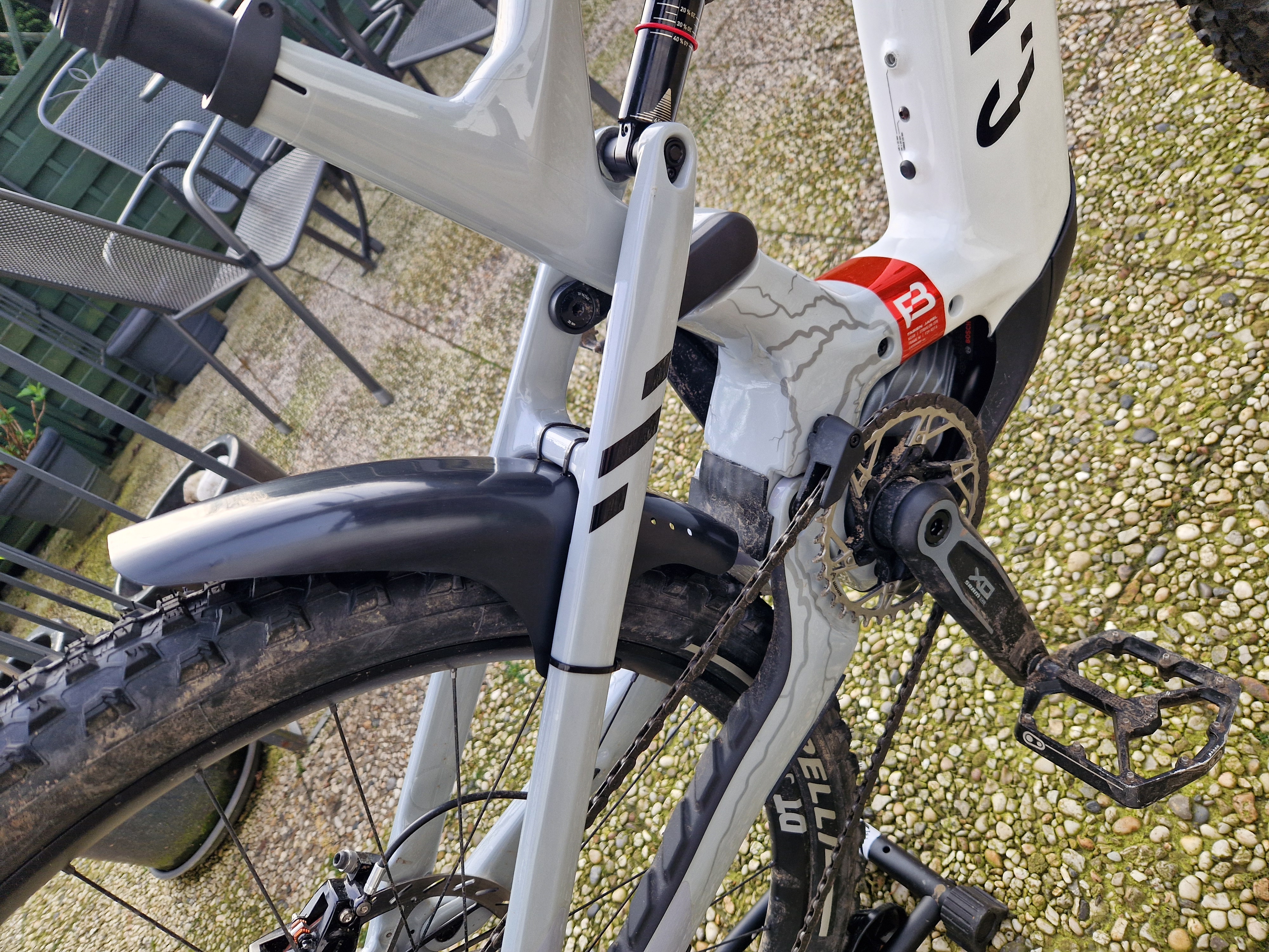

I am looking for a rear mud guard and can't seem to find anything that's bolt on. Are you happy with the one you got?
Do you have a link to where I can buy the same?

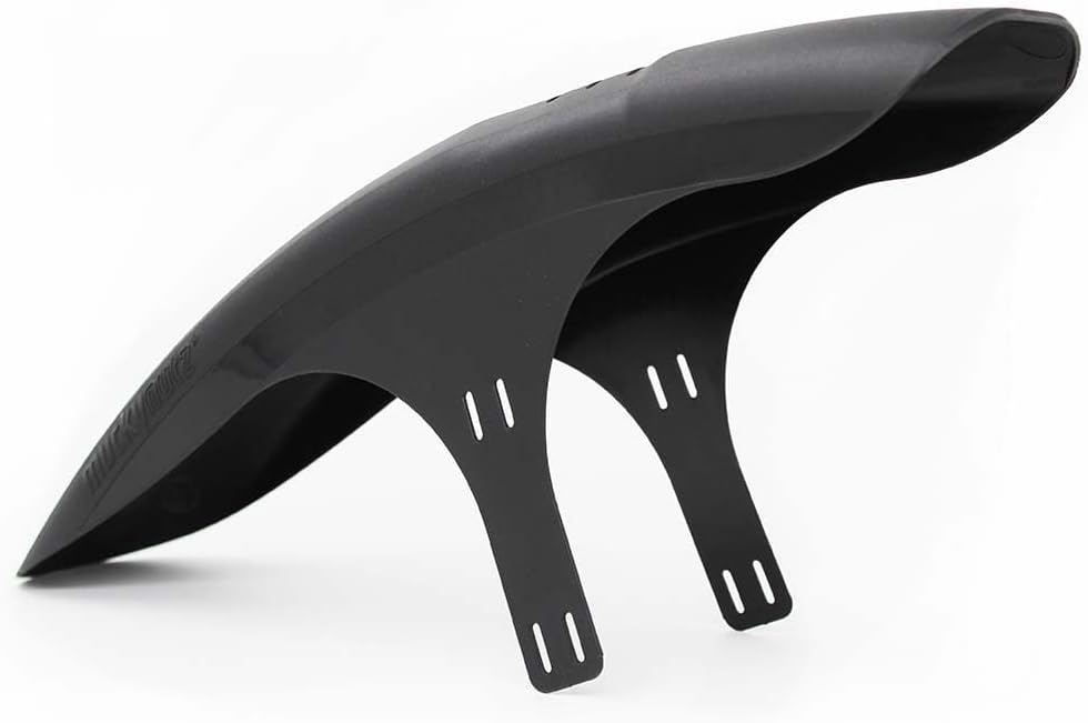

I've got this one which looks very similar to the one in the post above.
Thanks! Looks tight though. Does it work well?
It's not tight and it works really well at keeping crap away from the bearings at the back of the bike.
It doesn't stop me getting a wet arse and back, I think a longer Mudhugger style guard is needed for that but they don't look too good and can hit the floor if you're moving your bike around on the back wheel.

sorry just saw this. Its a mucky nutz short guard. You have to make a small hole on the top to tie it to the seatstay brace, and trim away a small section so the chain doesn't rub, but the plastic is soft so its pretty easy. Fit is perfect and I like the way it looks.
