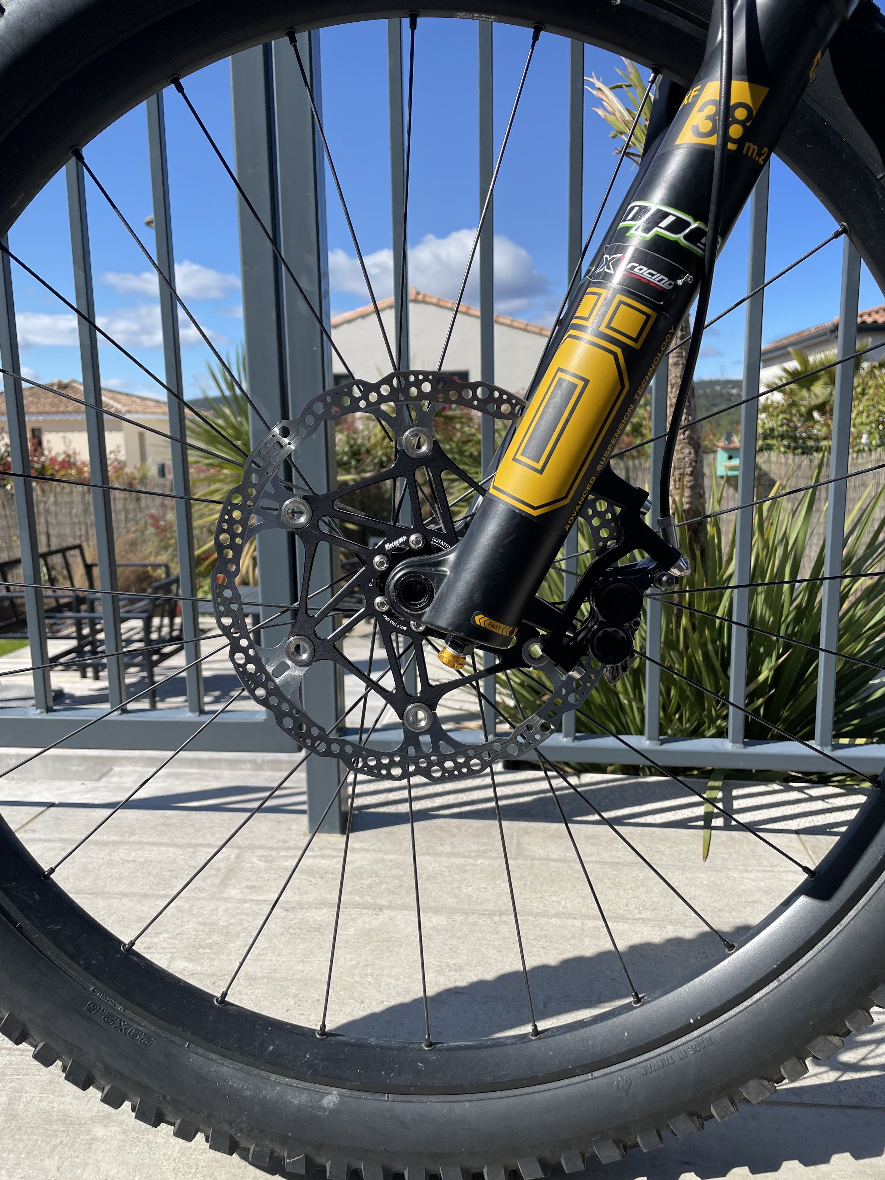

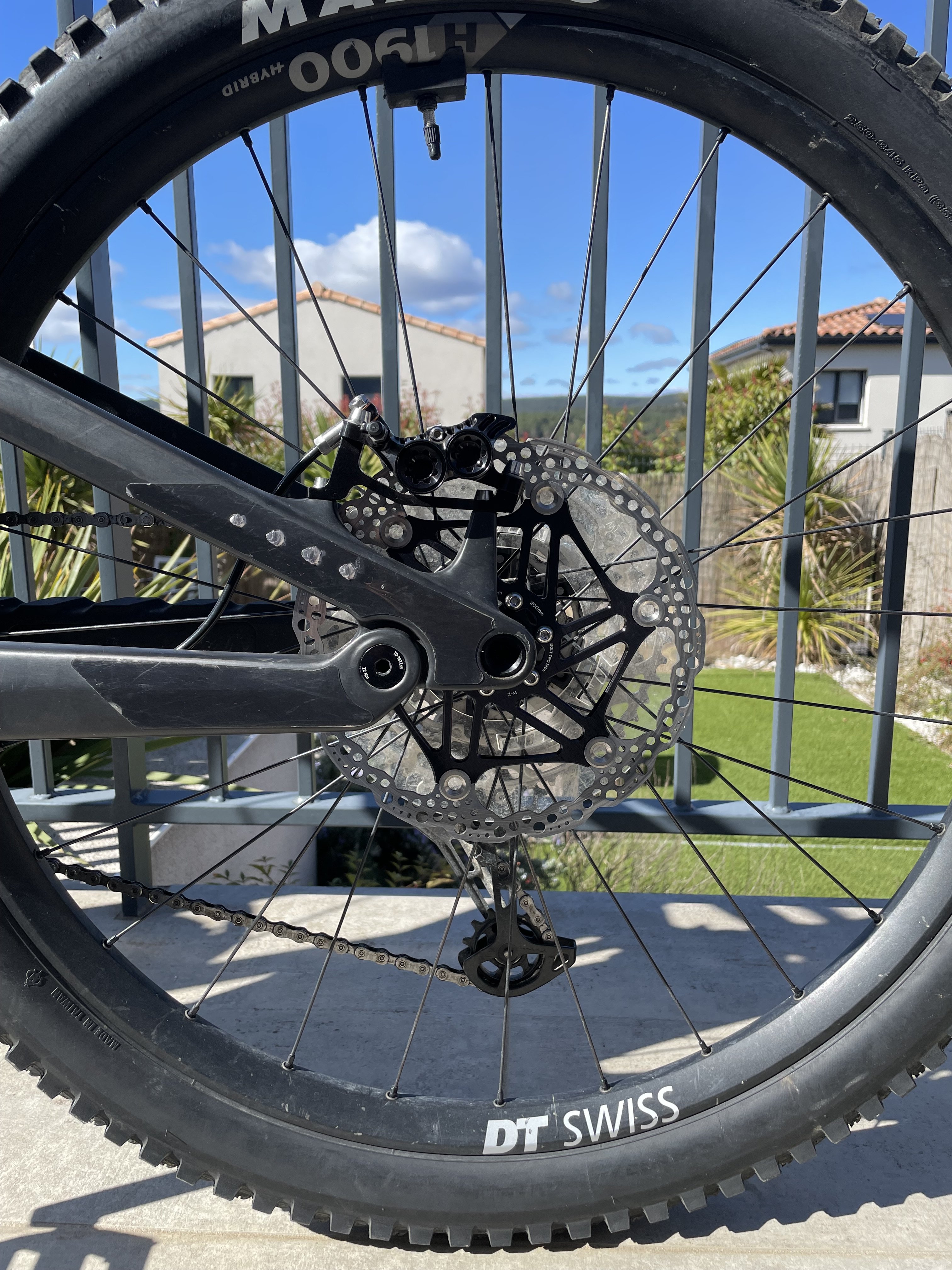

Galfer adapters will also work with Hope brakes if they're easier to get hold of.
They're what I've used with my E4s.
Thanks @Stephan-Qc and @S1mmo :) Do you perhaps have a link to the adapters you used? There are SO many options and I don't know what to order.
Hello @thewanted
What size rotors will you be using front / rear?
You need to size the adapter for the rotor.
For example, I have a 223mm rotor on the front so I bought a +43mm Galfer adapter as the standard fox fork size is 180mm.
For hope with 220mm in front and 200 in rear ( with Fox Forks and 44 mm offset )
P and M adaptator

Hey. I've ordered a 220mm rotor for the front, and 203mm for the rear.
Sorry (again). I just noticed that the CFR includes 220/203mm rotors so do I actually need Hope adapters if I’m replacing the Shimano rotors with the same size from Hope?
I may be wrong but I don't think that Hope calipers work too well with Shimano adapters as they're a different design.
Someone else might have got this set-up to work and may be able to offer a solution.
Sorry, I just re-read your post.
If you're just replacing the rotors it should work, if you're swapping to Hope calipers, probably not.
Ah okay, thanks. I’m replacing the Shimano calipers and rotors with products from Hope, so it sounds like I do need the adapters.
I think you may be able to modify / bodge the Shimano adapters to get them to work with Hope brakes but if you're getting new Hope calipers and rotors I'd just spend that bit extra to get the correct Hope compatible adapters.
