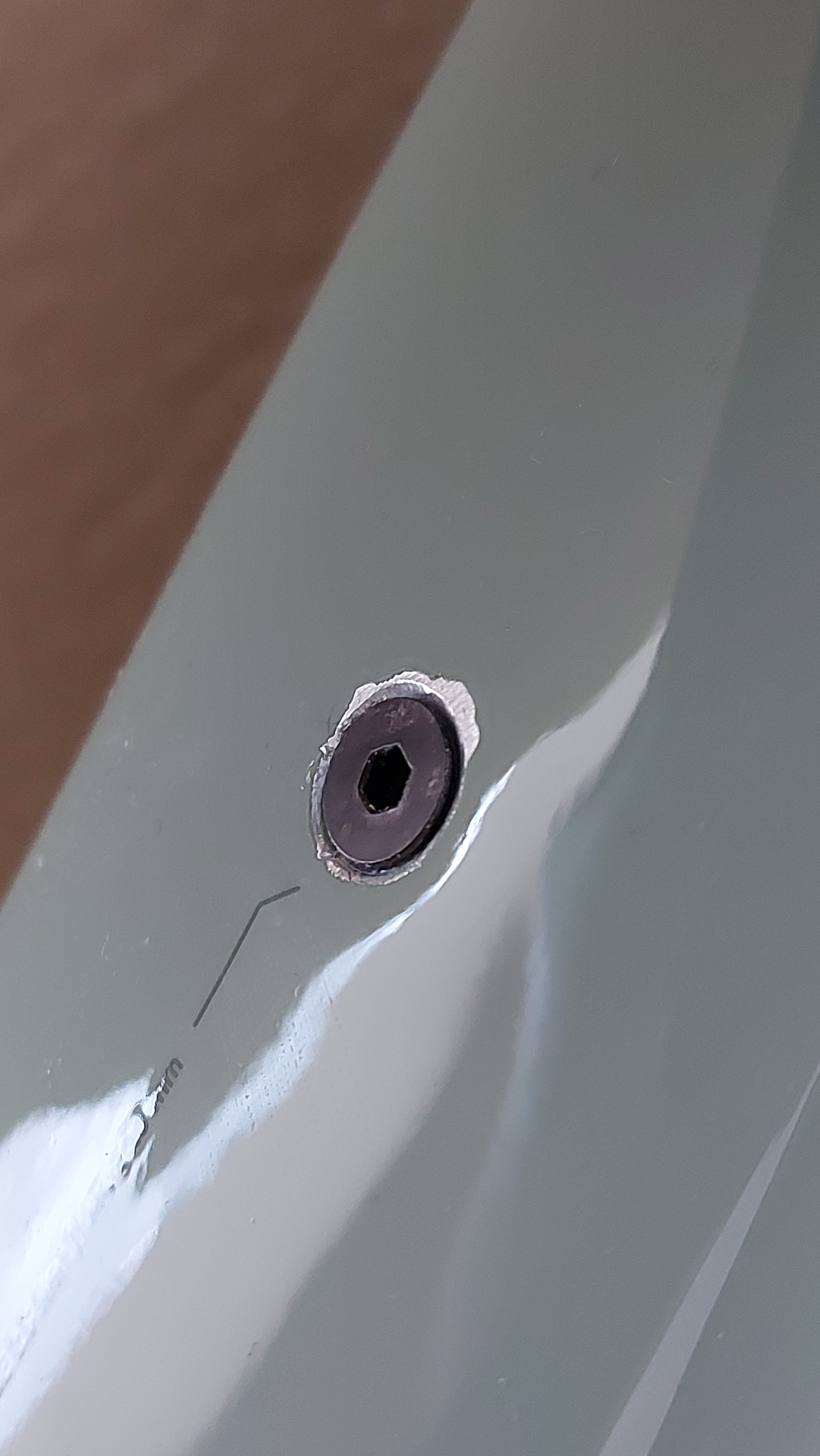

Got my Strive:On CFR two days ago (ordered it at 23rd of December 2023), but couldn't unbox it until today. I ordered a reduced bike in the outlet, unridden but with minor paint damage. Was super surprised that everything was like new, no scratches, nothing. Only in the area of the upper screw in the down tube some paint chipped off (see picture). Doesn't look nice but for about 1000 CHF less I can live with that pretty good.

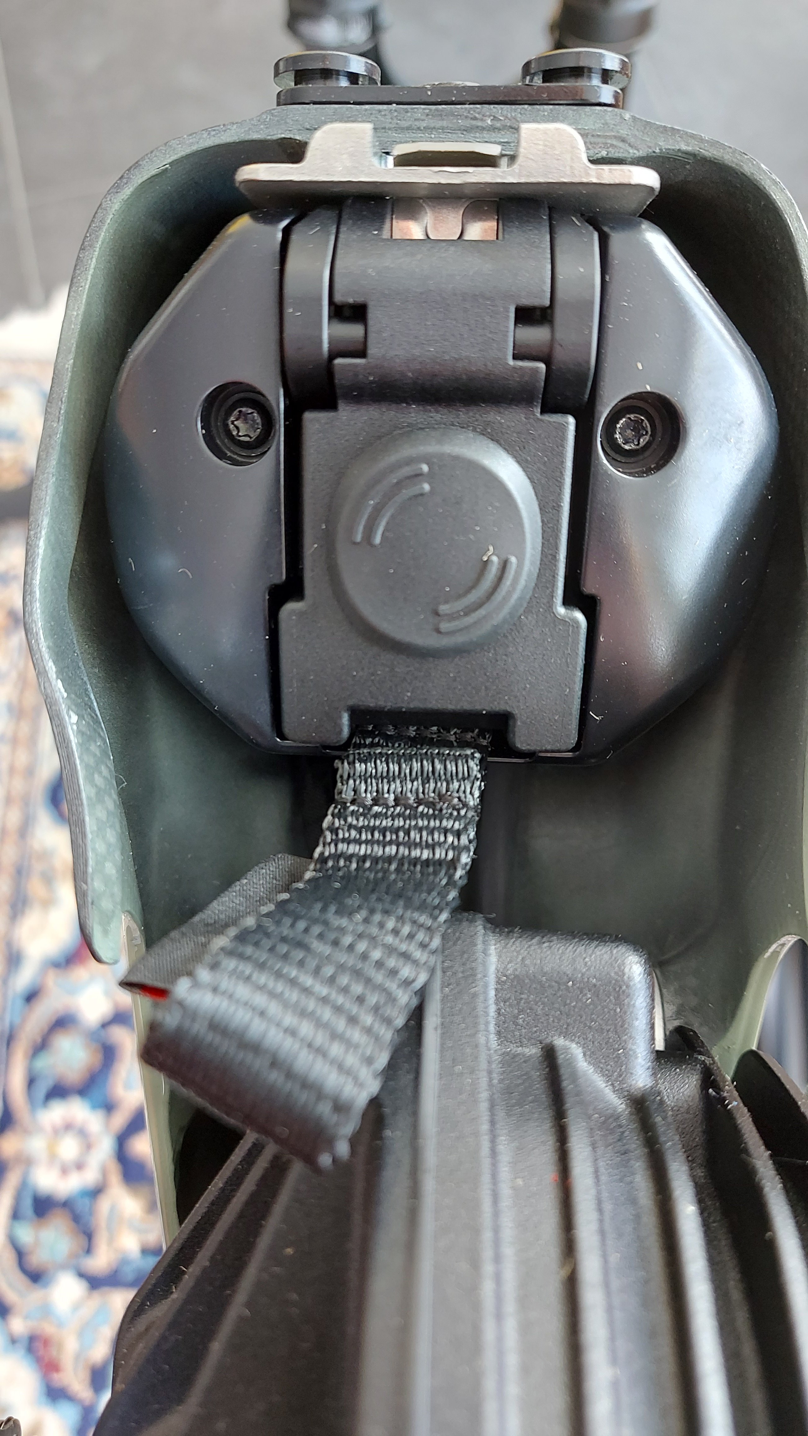

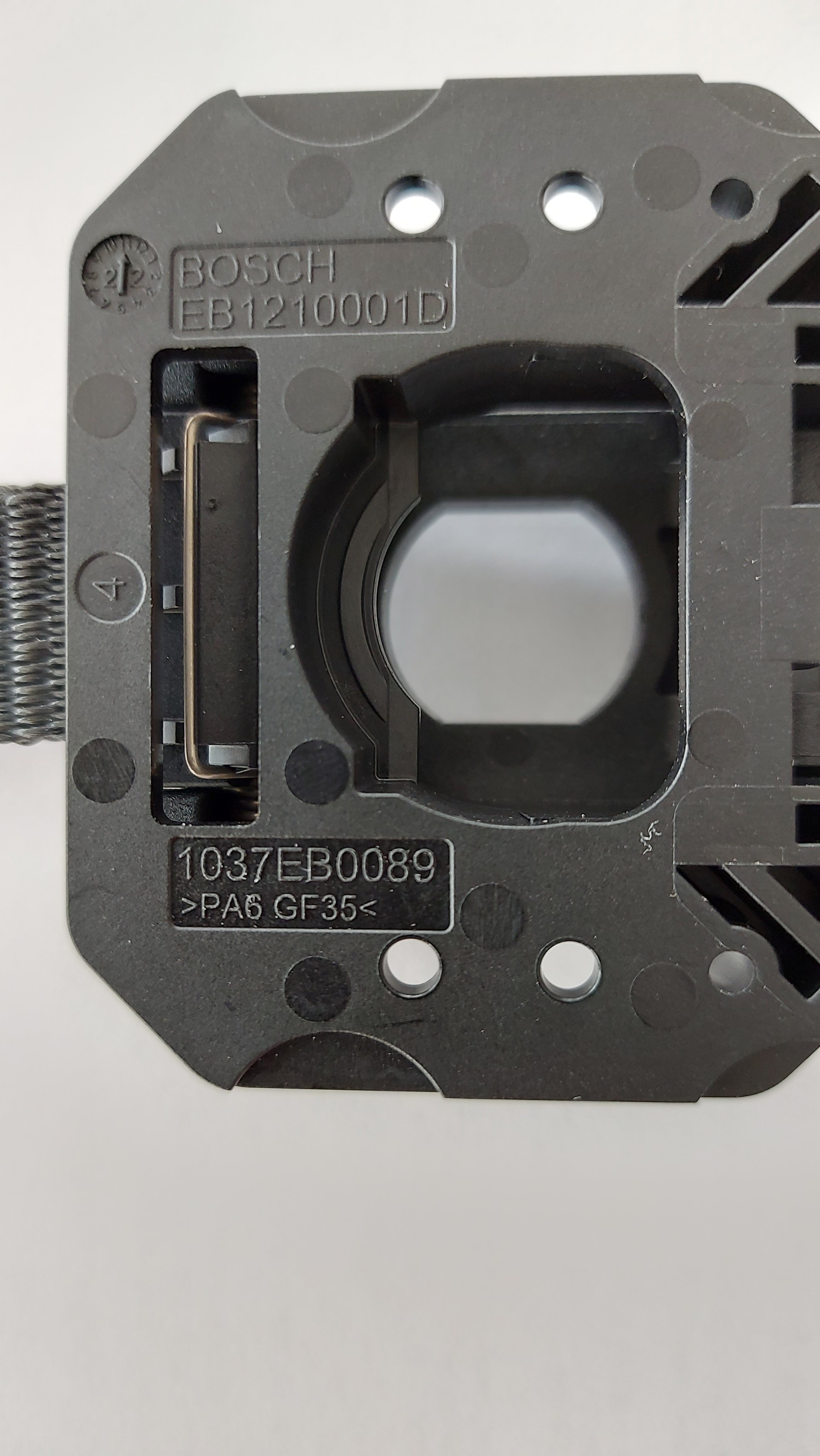

Again, I have to say that I am pleasantly surprised: They include the newly revised version of the Latch from Bosch with the bike (see pictures with part number). The old version of the latch was mounted, so you have to change it yourself. No instructions, not a word about it, but as a mechanic you don't have an issue with it. Have already changed it and keep the old as backup in case the new one fails.
Photos: left: new latch, middle: new latch part no., right: old latch installed

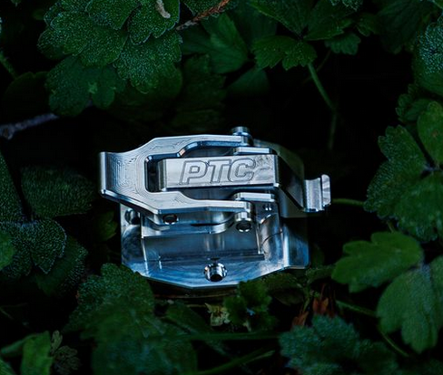

As an engineer, however, I still don't quite trust this solution. That's why I looked around at Cascade Components for the metal version (see photos on p. 14 of this forum). I’ve got the confirmation that it should be available soon! I will order and install it as soon as possible, and then I hope that there will be peace with this tiresome topic...

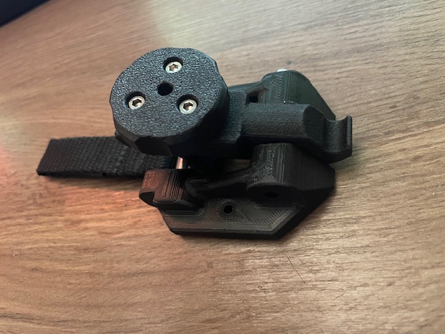

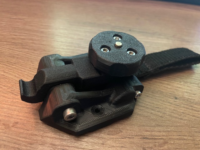

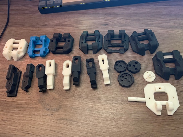

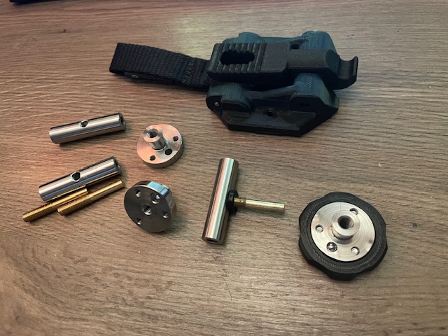

after a long wait, i started my own development last year. after many prototypes, i have a perfect and working solution, even with contact pressure adjustment.
That looks great and there are even metal parts underneath, wow!
Do you sell that? How long did you test your solution under real working (riding) conditions?
