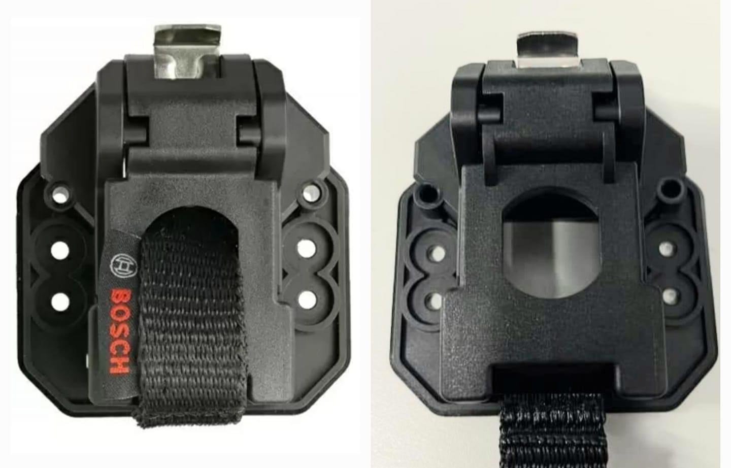

Just had an email reply from Canyon UK saying that they’ve sent out a new design battery latch to me. Hopefully be with me soon

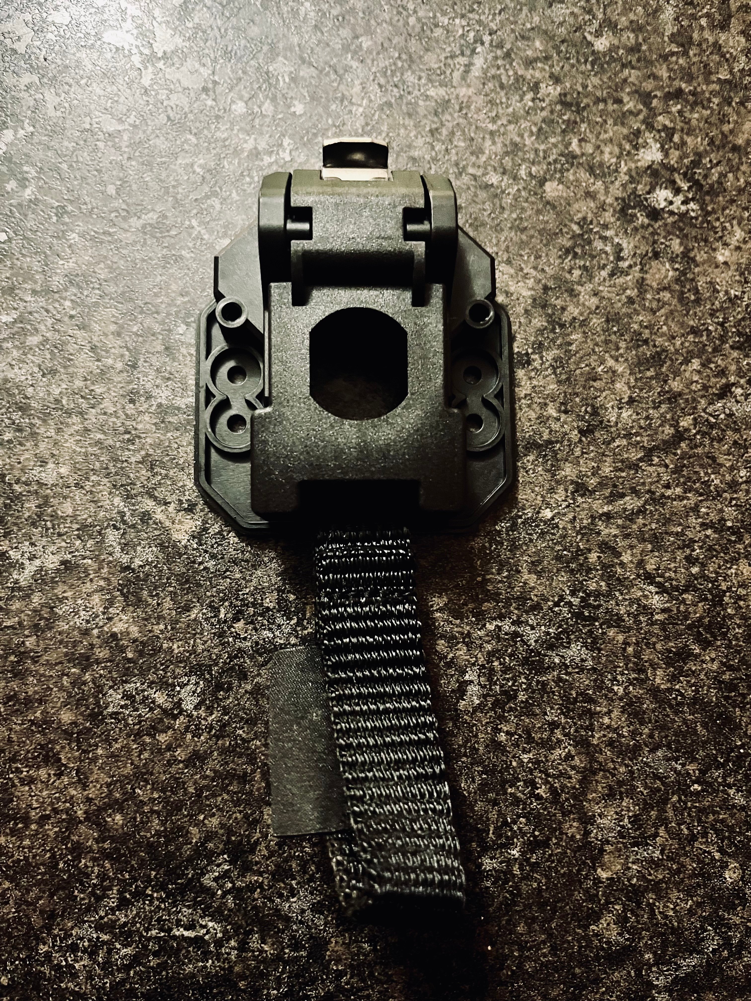

It needs to be a different P/N from the picture bellow, otherwise...
I've had a follow up email from a chap at Canyon saying that it's the updated latch hat has been dispatched to me. Fingers crossed. Once this is sorted I'll be so chuffed. It's been the unfortunate achilles heal of what is a brilliant and super capable bike

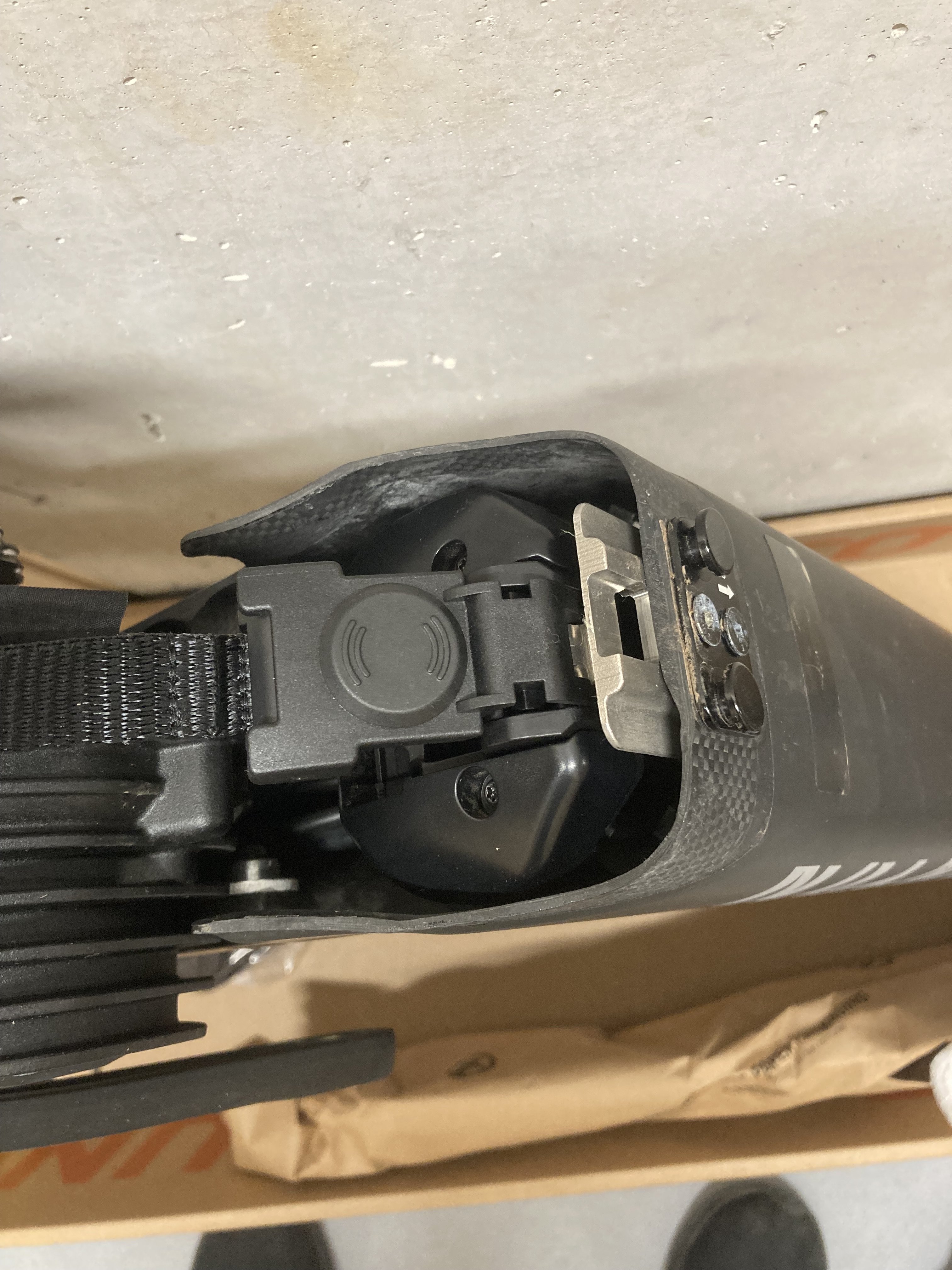

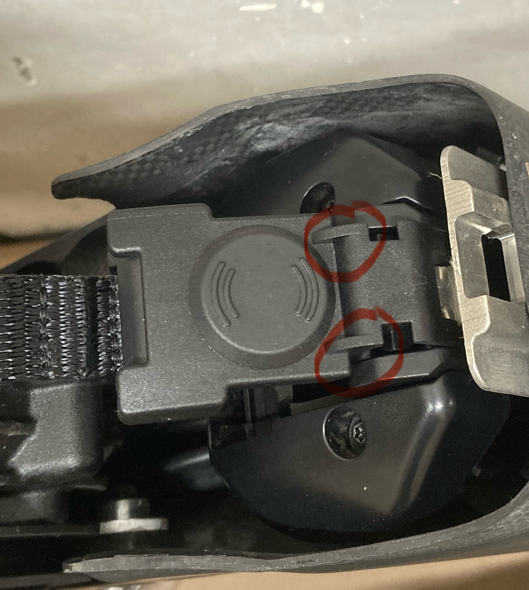

I just got my Strive today, it's from Canyon's Outlet store, meaning that it has been used previously for testing purposes or so. I have been following the battery latch discussions here, is it correct that I still have the "old" latch?
I ordered Tobias' fix, would you recommend installing it right away or wait until the current latch might break and then hopefully install Canyon's new latch?
I am not 100% sure I understand which part exactly is commonly breaking with the old latch. When I checked mine, it seemed fine. Can someone enlighten me once again which part in the latch to keep inspecting?
Further, I read that some batteries have a little bit of play even when installed. Mine has a lot of play if I don't engage the latch, however, when I do (after the very distinct click), there does not seem to be any play whatsoever. Am I right to assume that the batteries with play might be problematic if this is the case after engaging the latch, so nothing to worry about in my particular case?

That looks like you have the new latch fitted. The new latch has the two little extra lugs which yours clearly has. Looks like you’re good to ride trouble free 👍🏽

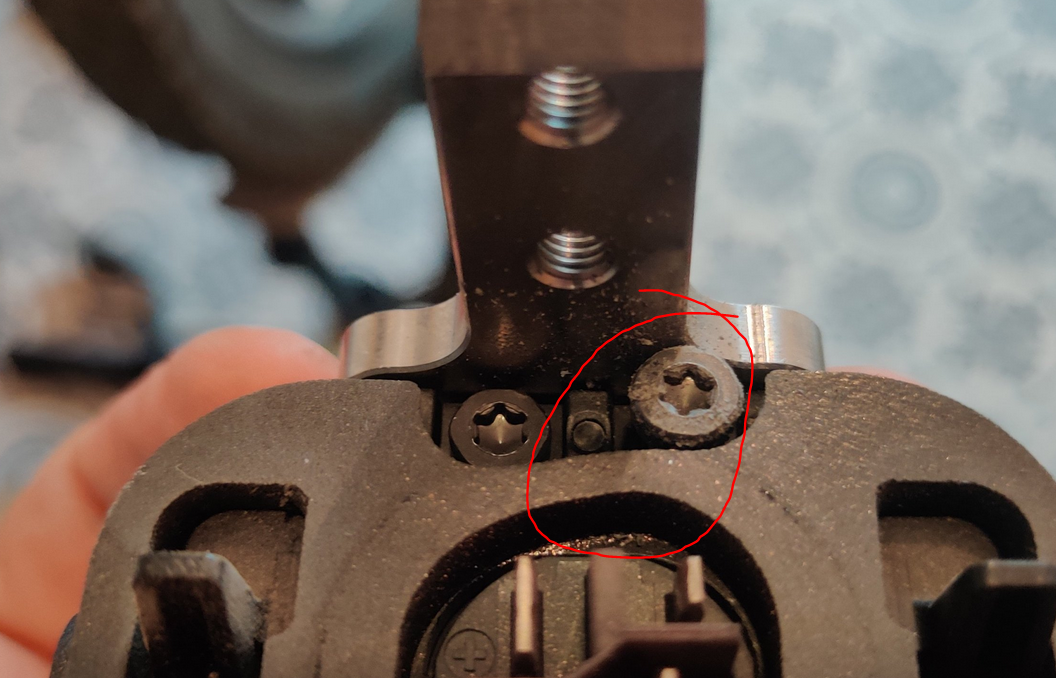

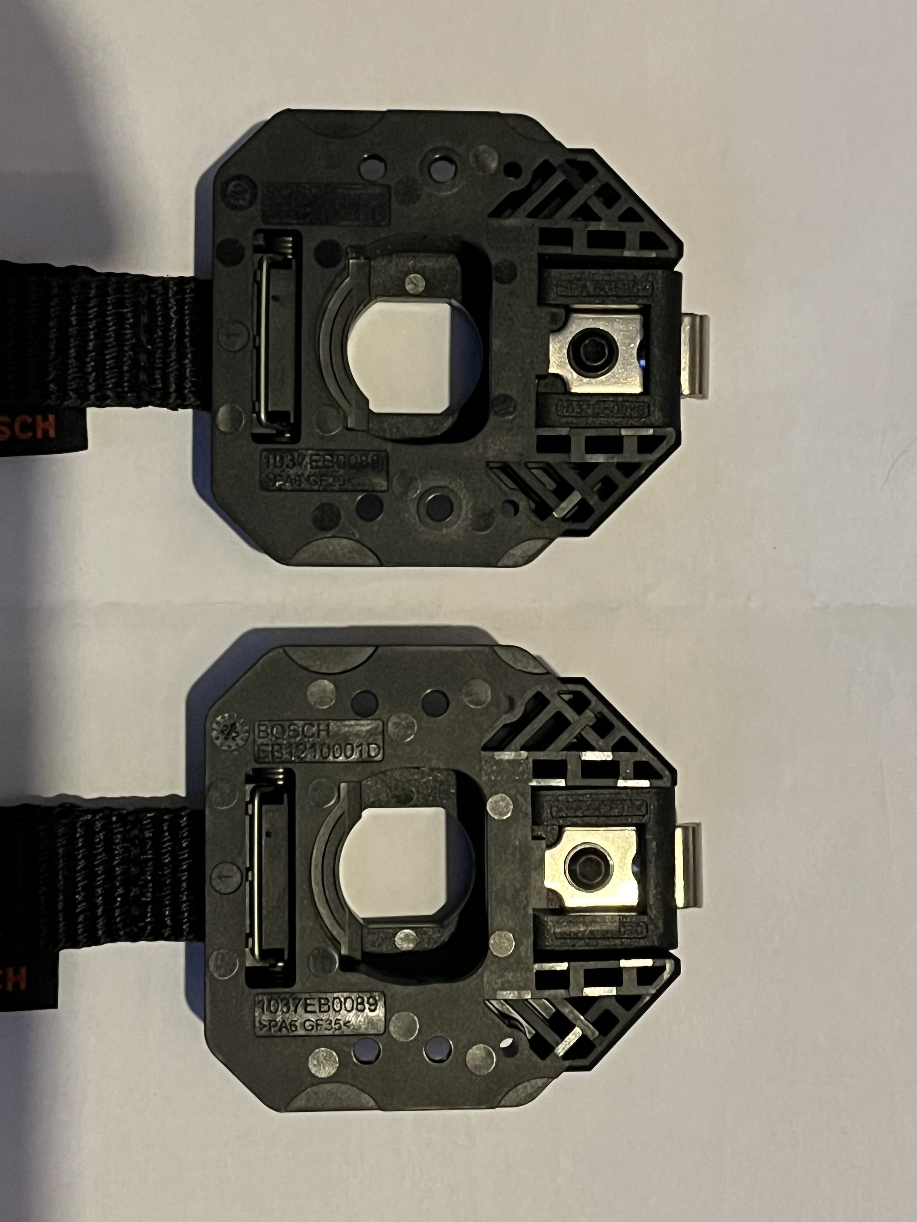

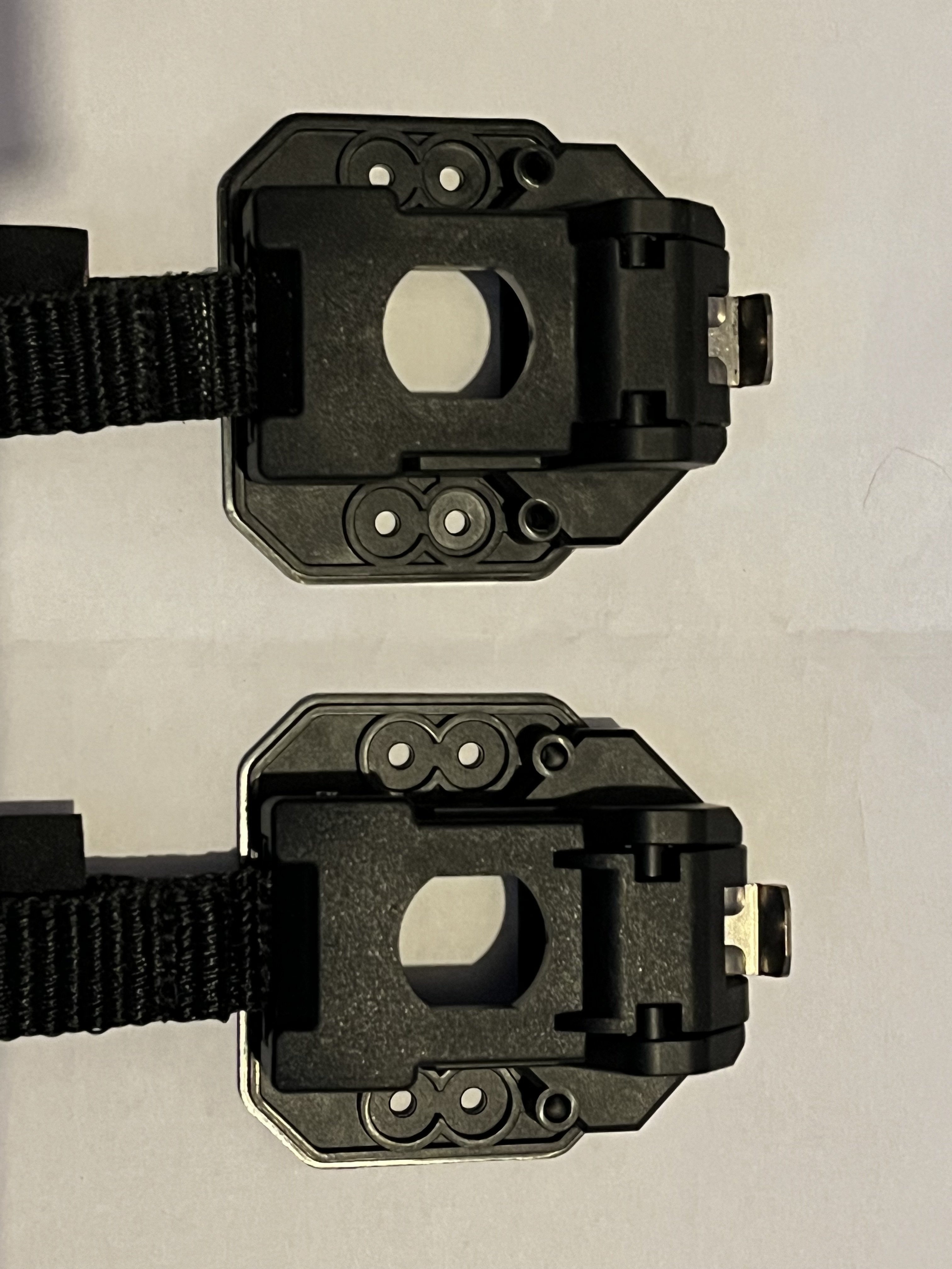

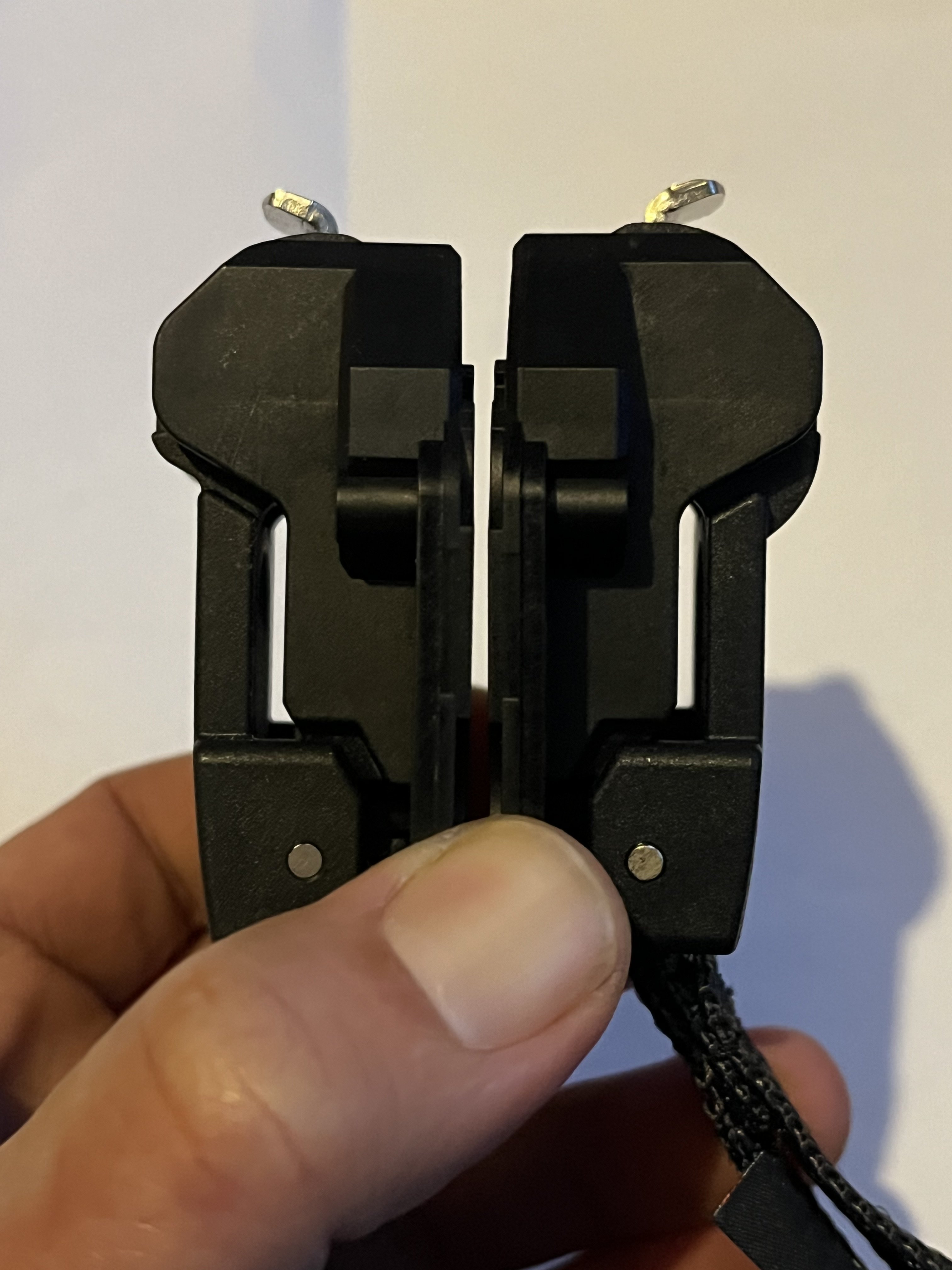

I received my new design latch from Canyon today. Old unit on the left and new unit on the right. The pivoting latch is beefier at the points that previously failed. Apart from that, visually, it looks like the rest is the same.
Fitted it to my battery (750). Good news is that if any of you have the latch fix kit from Tobias Post it fits too.
Fingers crossed this fixes the Achilles Heal of this very capable bike.

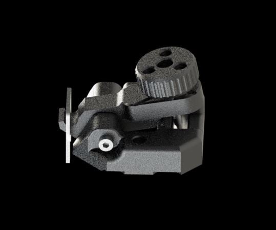

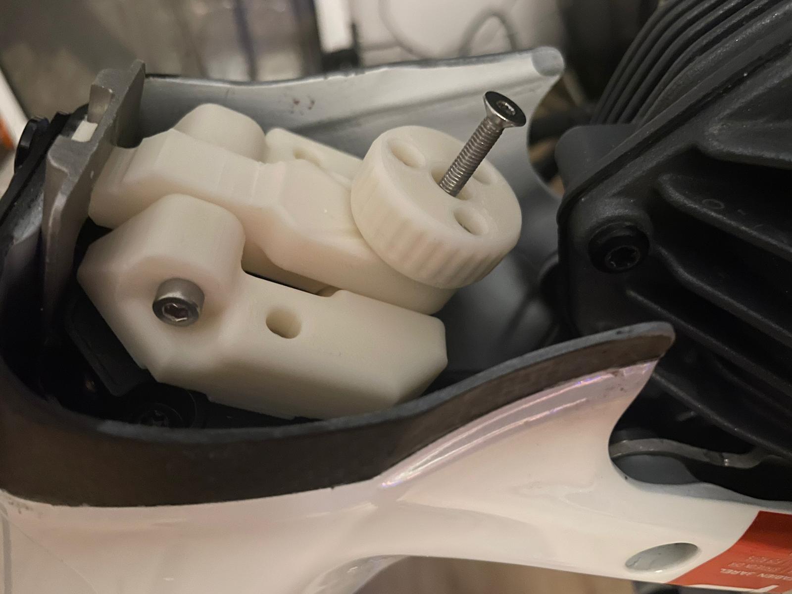

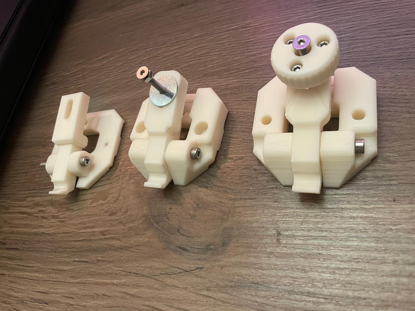

Hey everyone, since i am not so pleased with what canyon offers as a solution, i have started to develop my own locking system. Prototypes are already finished and work well. Next, some parts will be made of aluminum and some with 3d printing from a carbon modified ABS plastic. So I have a perfect solution for the next season.

I have already made the fastening at the top, you can see it on page 5. Page 5

There are 4 screws, I didn't mention the 2.

Latch version 2 has arrived in Yorkshire 👌🏽
@Tubby G , @CrispyDesigns

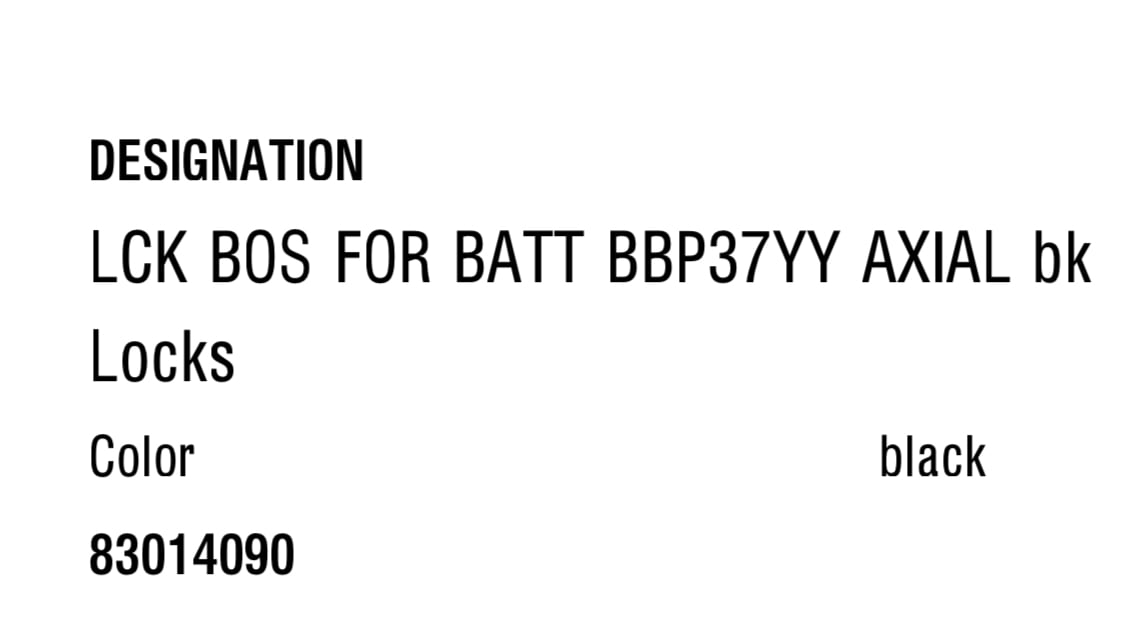

I contacted Canyon's warranty team yesterday and they're sending me out a replacement latch to Yorkshire - LCK BOS FOR BATT BBP37YY AXIAL bk
Could you please let me know if this is the Canyon Part Number you received?
There was some confusion over whether I'd be receiving the new or old one.
Thank you
Thank you
This is the description on my delivery note:
So it looks like you have the correct latch on your way 👍🏽
Thanks Tubby.
Please let us know how the new one holds up when you've had chance to test it properly.
Will do. It’s easy to fit, just four screws, I did mine last night. Back at work now though so won’t get to ride it until the weekend 👍🏽
