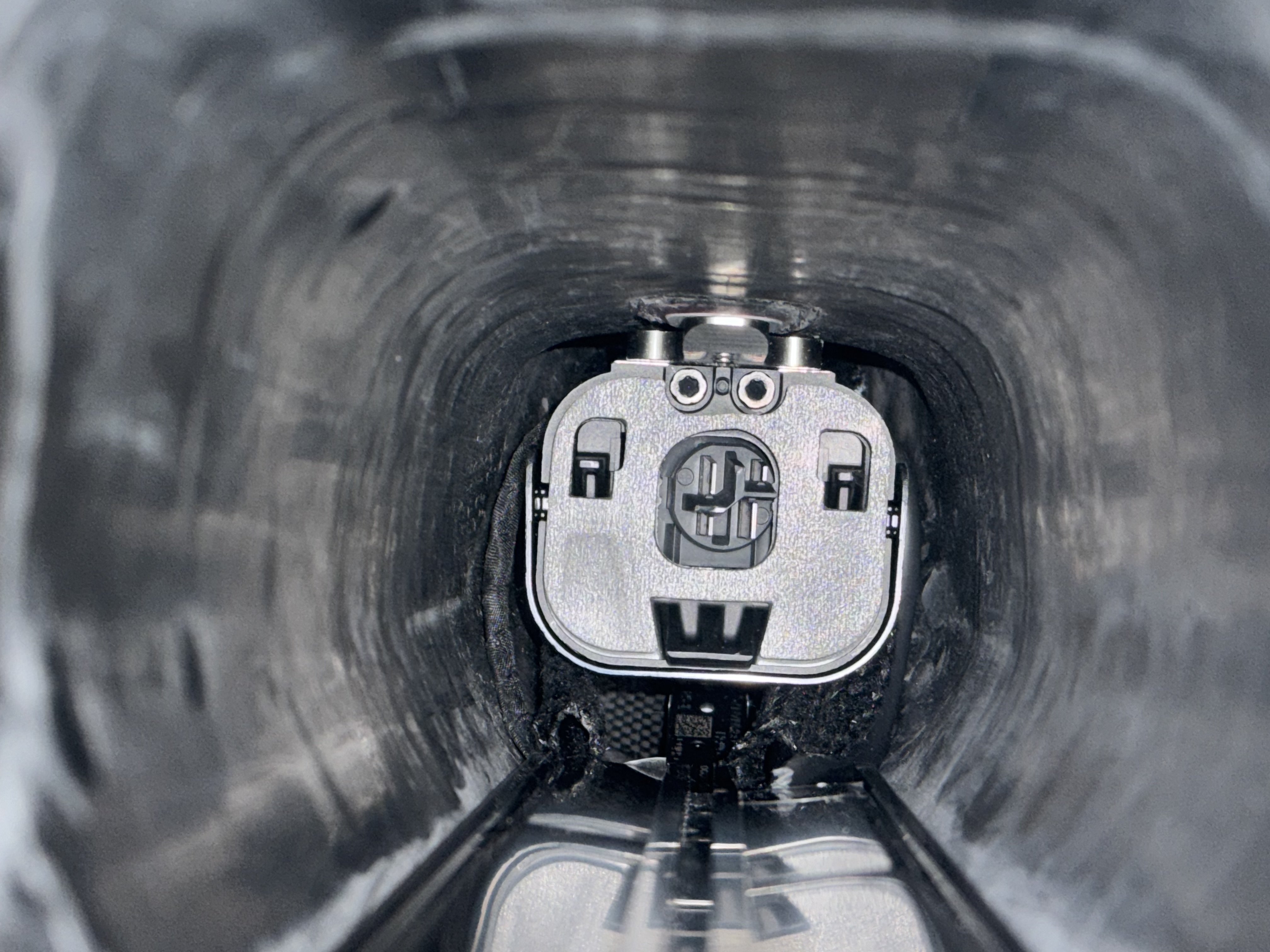

How I can check that ?

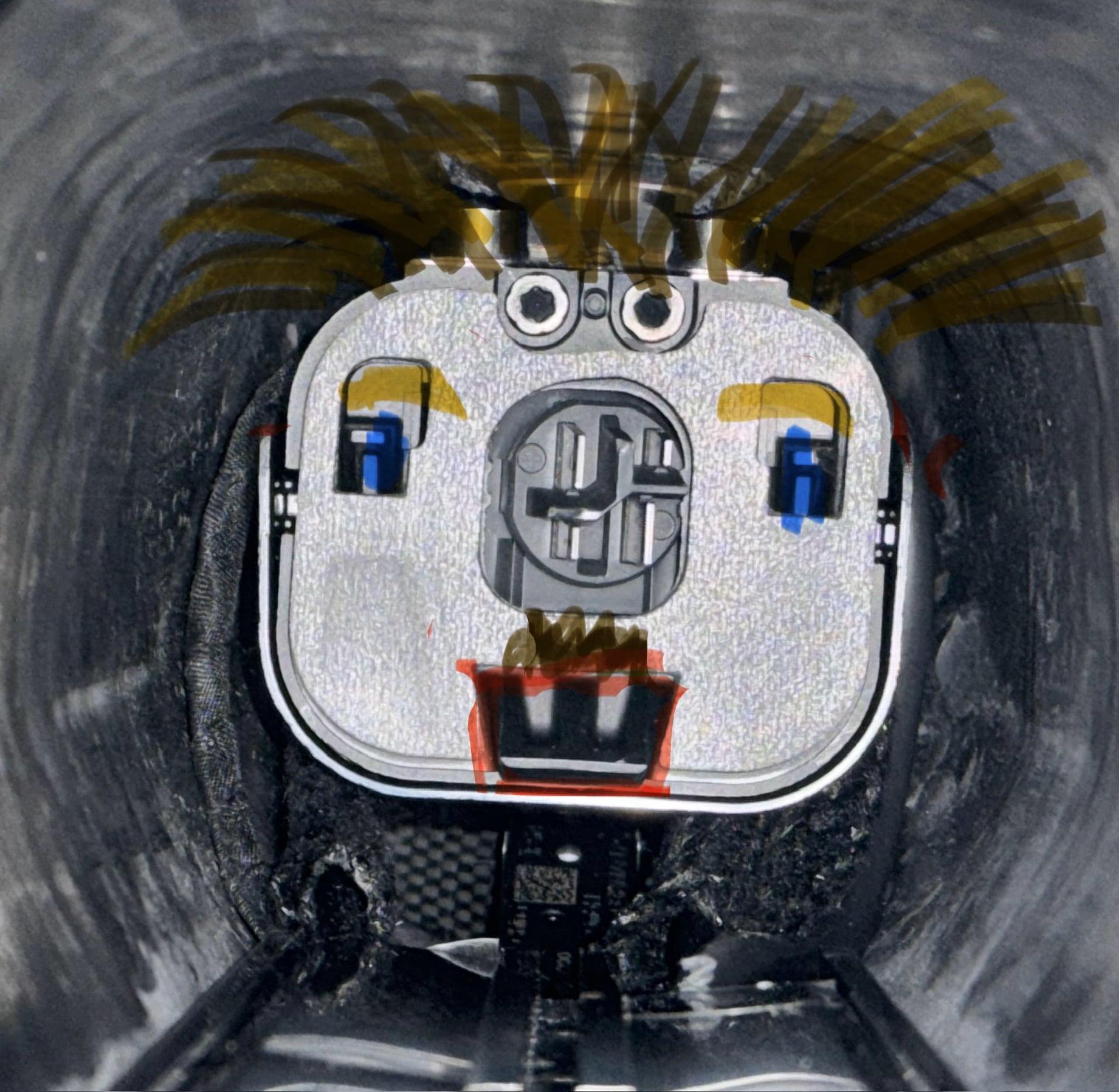

And how the plug at the top are connected to the motor ?
Because I see cable but can access …
Thx a lot really
You know how we can extract the top connector in downtube in the Strive On ?
I don’t found an access …
Thx a lot
It's easier than it seems, with the battery removed (obviously), there are 2 bolts on the downtube upper side, towards the head tube, those release the connector, then it's a matter of fishing it out, to make it easier, I removed the lower bracket that actually holds the battery, so your arm has more space, and remove the cover of the track that holds the connector cable so you can pull it out, and in reverse order to get everything back together
Thx you, I look that today :)

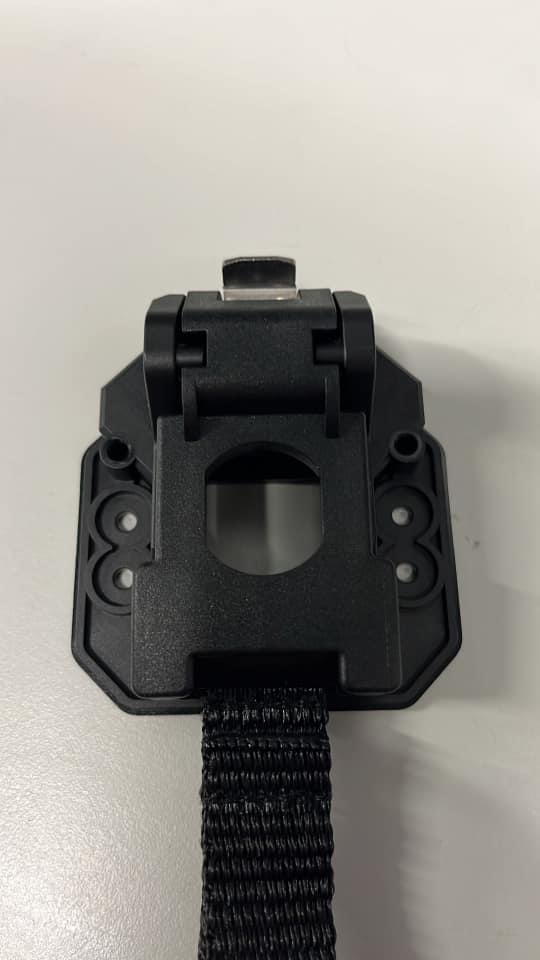

The new reinforced battery latch. Two buttress parts now strengthen the parts of the latch that failed
The new reinforced battery latch. Two buttress parts now strengthen the parts of the latch that failedView attachment 131313

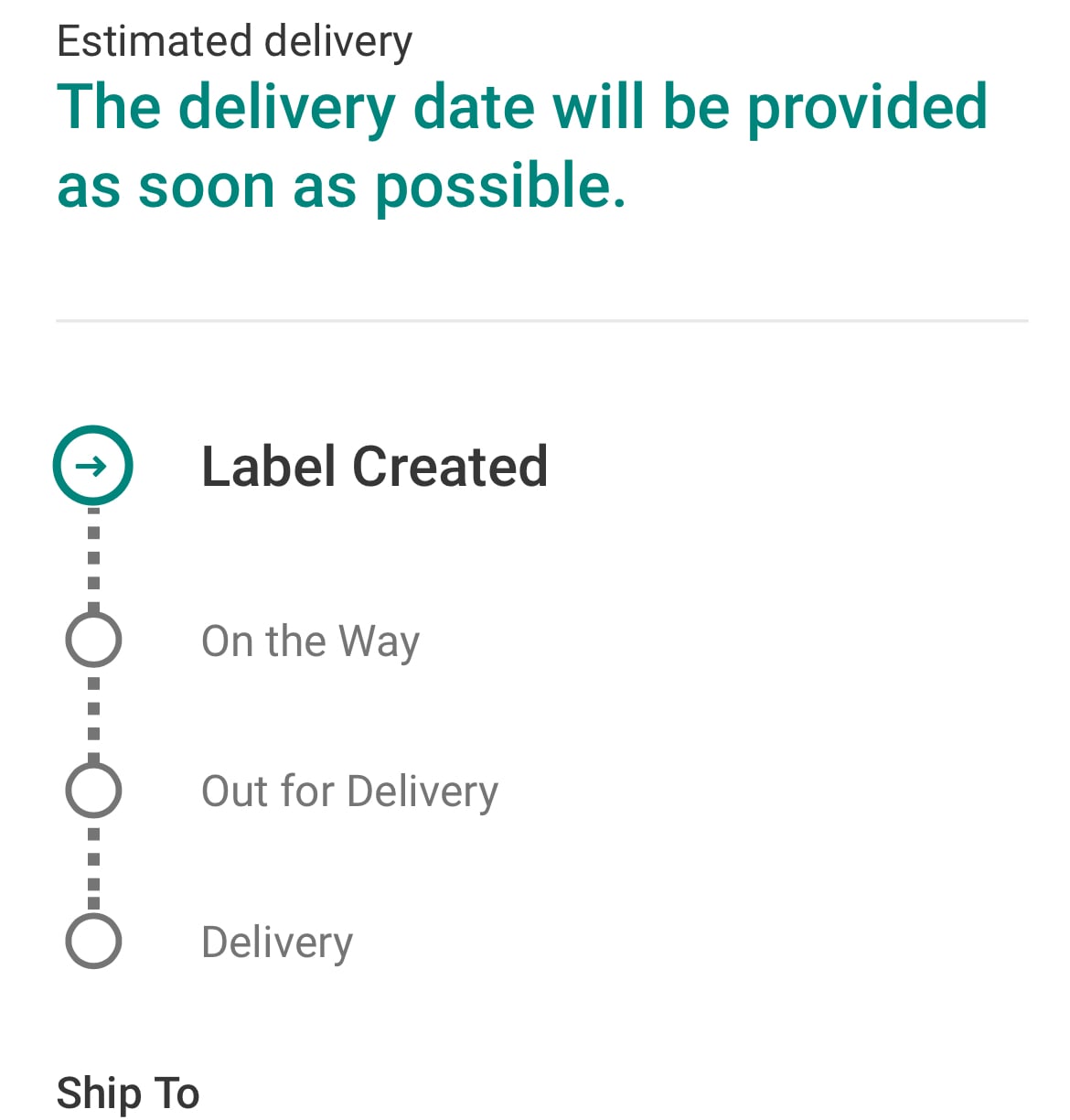

When was yours dispatched from Canyon ? Did you receive delivery today ? I’ve only had the following from the UPS tracking page, but it has been Christmas so wasn’t expecting anything too quick:
This isn’t mine. It was a picture posted on the Facebook group by the Service and Warranty manger for Canyon in the UK.
I’ve just logged a warranty email with Canyon requesting a new latch unit to be sent to me.

I hope the new latch shown above improves matters............my reservation is that the modification makes the latch less vulnerable to abuse from the battery, but does not deal with the "cause" of that abuse, which is battery movement. Maybe the new latch is only a part of the complete fix with more to come.

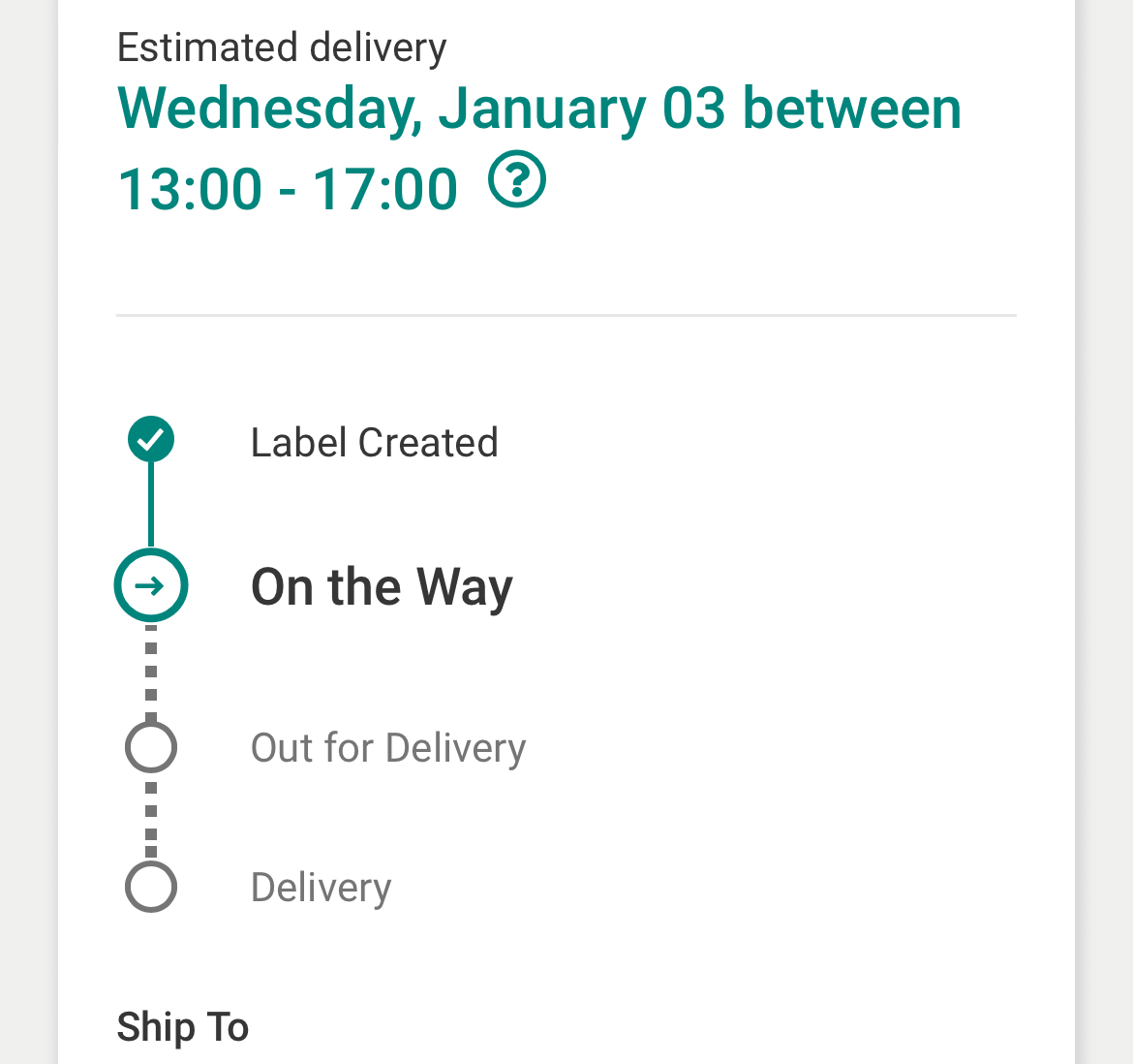

And by pure coincidence just received a delivery update, hopefully I’ll have the new updated latch on Wednesday 3rd January
Thx for your advice.
Yes for me it’s the connector in the frame the problem.
