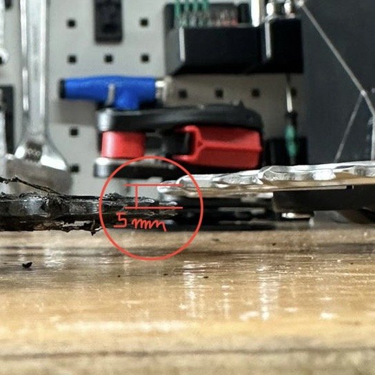

If you want to use a 104BCD chainring with a 55mm chain line then you would need a different spider to get the correct chain line. The new direct mount chainring will give you a 55mm chain line.
So why did someone mill down the direct mount spider to get the ‘correct’ chain line?
Because the Direct Mount vs. Spider or Hope Direct Mount chainring has 5mm more instead of 3. So 57 instead of 55mm.
Strange, there was 3mm difference between the standard chainring with spider and new direct mount when I did the same measurement, giving me a perfect 55mm chain line.
