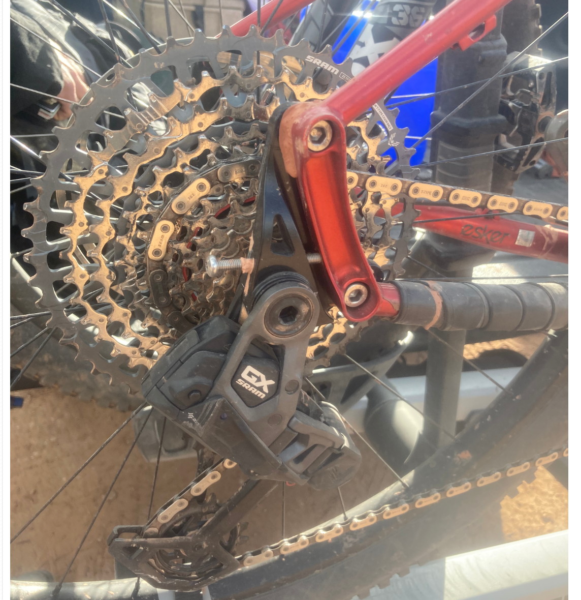

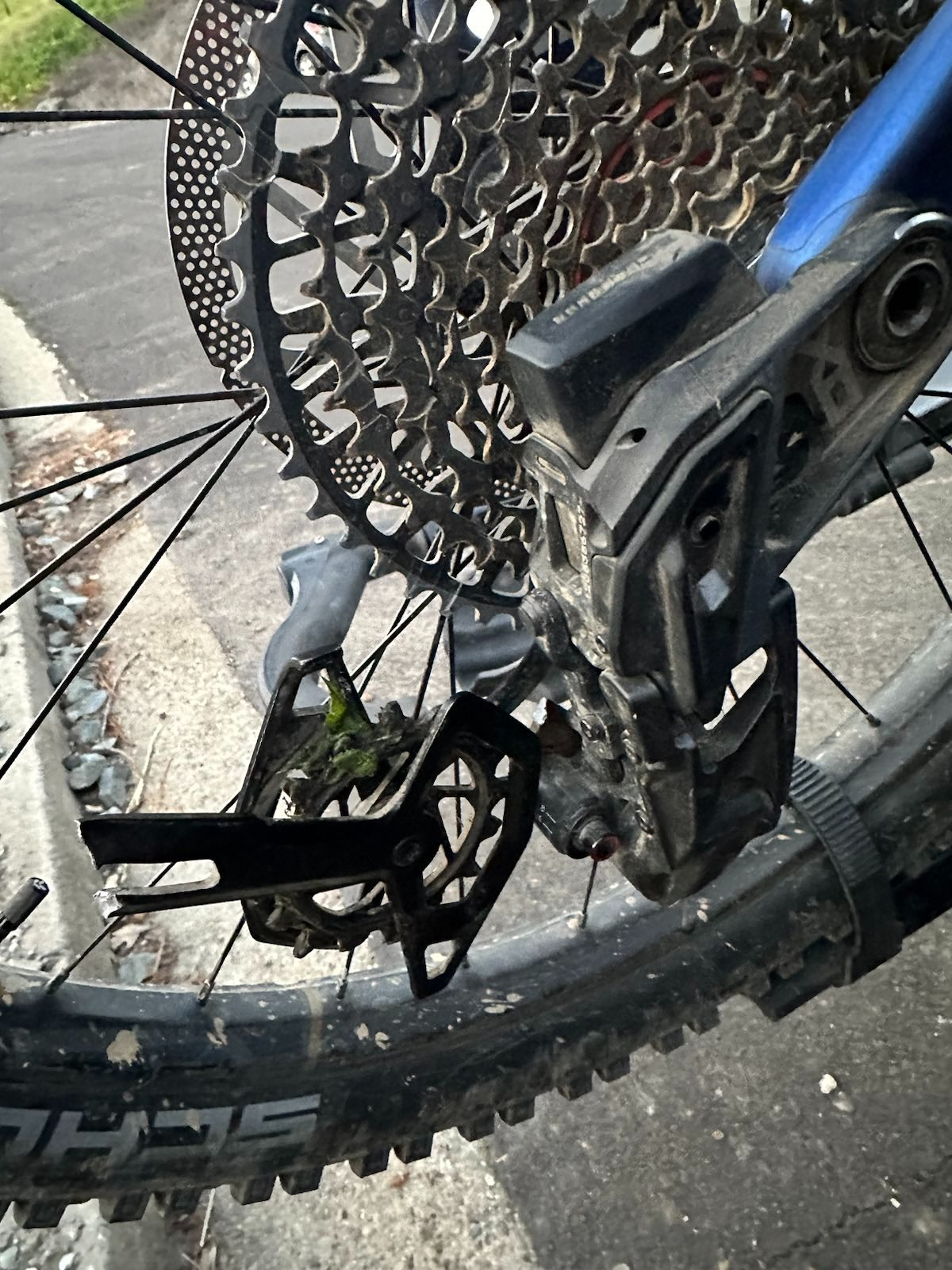

Also as a side note, last night a stick stuck in a buddies Sram 11 speed, pushed the derailleur into the spokes and ripped it off the hanger breaking his wheel. Frame is 100% fine and even the derailleur can be reused with a new hanger. Not sure of the damage that would have happened with Sram T.
If you hear a bad shift or something in your drivetrain, stop pedaling and lock up the rear wheel. Never try to power through.
Slipped off a 1 foot high log on a creak crossing at 5 mph.

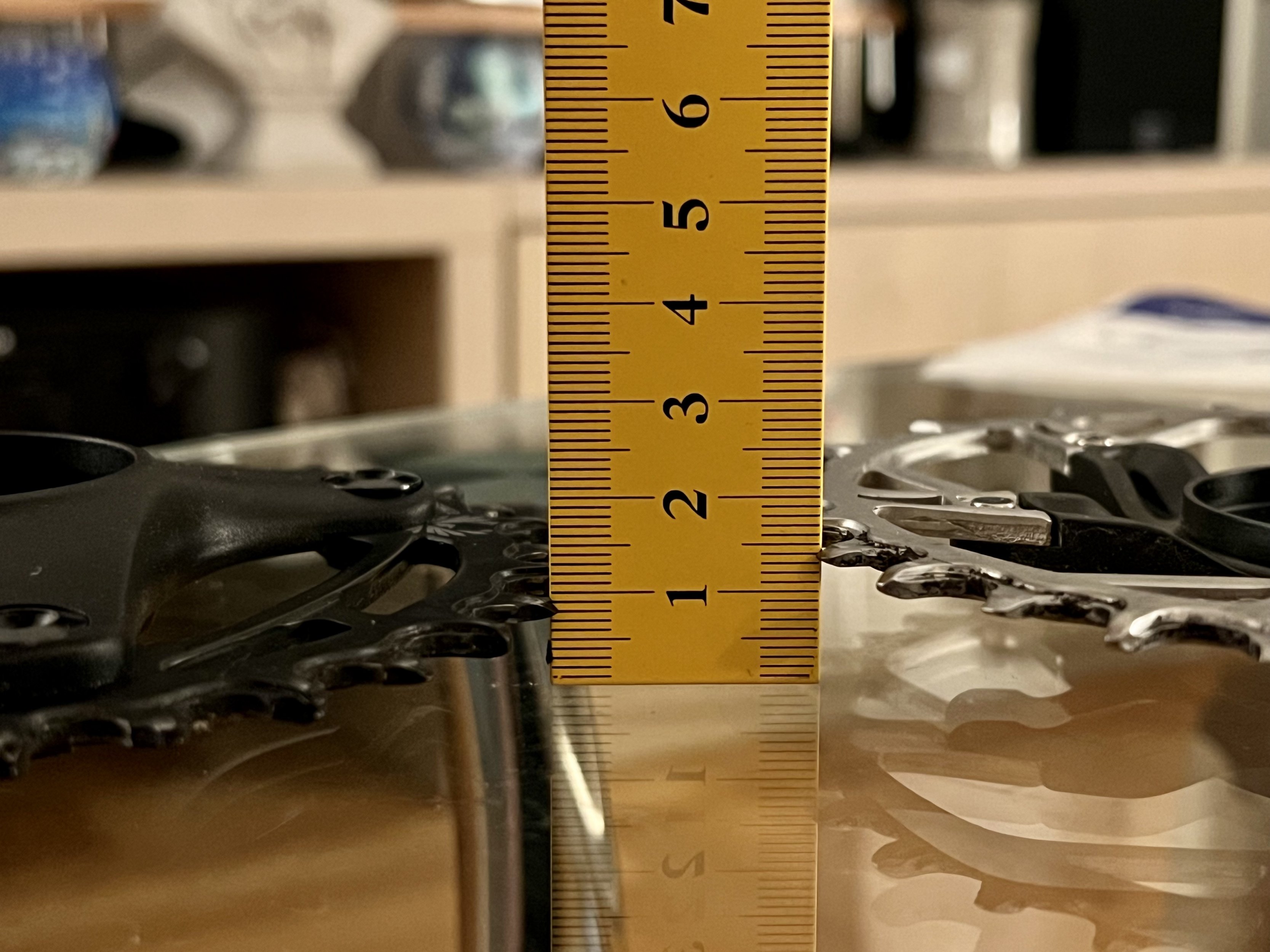

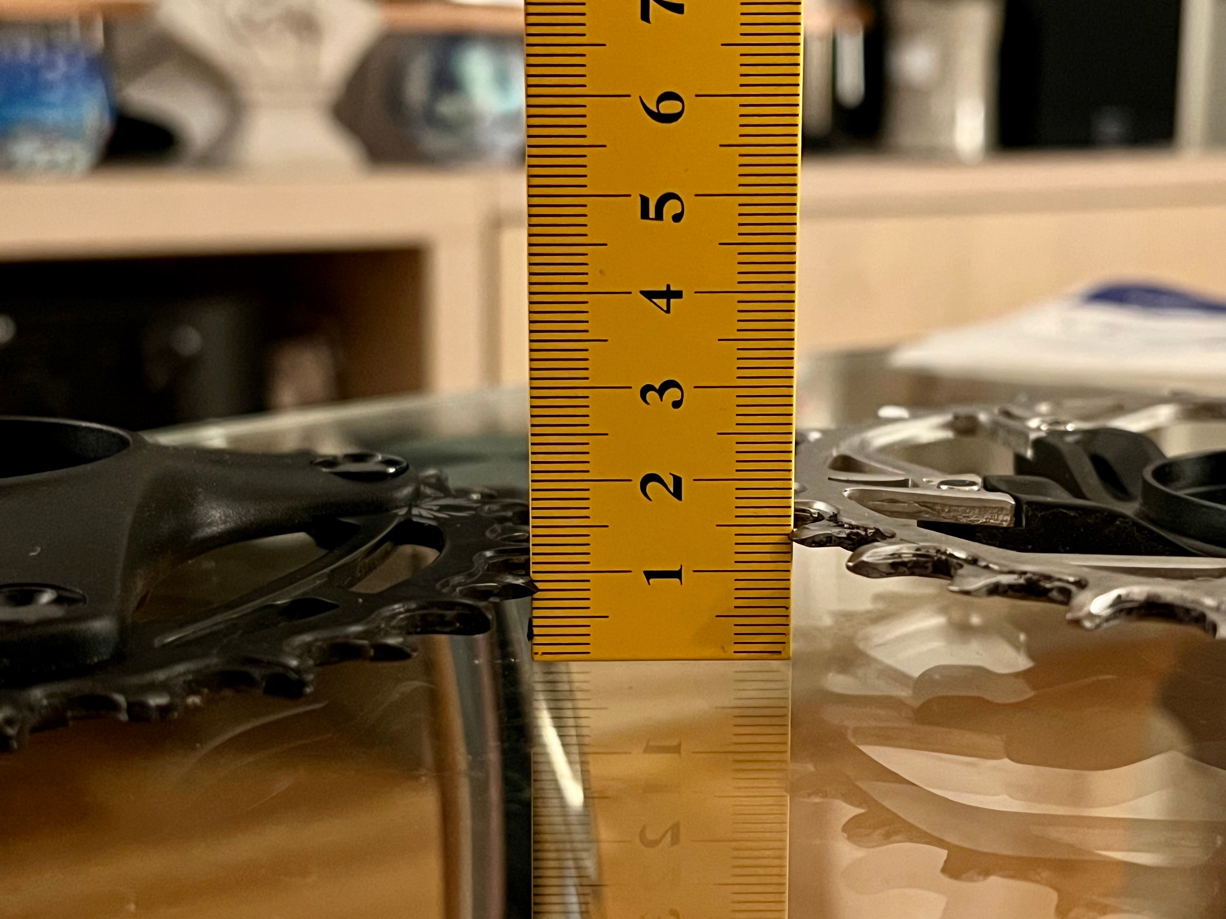

The original Levo chainring is supposed to have a 52 mm chainline? And the new SRAM Brose chainring is 55 mm?
Well, if I compare them on a flat surface the difference between them is 6 mm, not 3 mm... :poop:
So, the Brose chainring will probably give a 57-58 mm chainline on the Levo.
