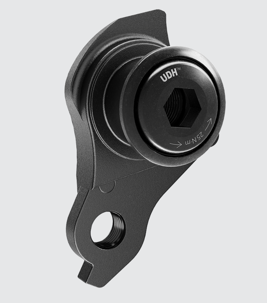

The online tool (SRAM eTap AXS Bike Finder) is only for eTAP equipment. And it reports that no MTB is UDH compatible.
pretty simple to check. If the bolt in the drive side rear seatstay pivot (4 bar) has a fulll size bolt head with a torque setting printed on it, the hanger is UDH.
Since my 2020 Levo does not look like the above I guess I can stop trying to rationalize why I need to upgrade.
