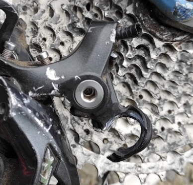

Arguably the axle as it is takes a large proportion of the forces placed though a traditional hanger, but for many of those "unfortunate" moments, the hanger can give and avoid placing unnecessary forces through the axle/triangle.
The problem is the "random" factors of impacts. The majority of frame/mech/triangle damaged you see is from freak occurrences where design can't provide a solution to every possible problem.
The UDH itself has already caused several issues on bikes where it's not bent/broken or has rotated "clockwise" as @Mteam said or like my example earlier in the thread.

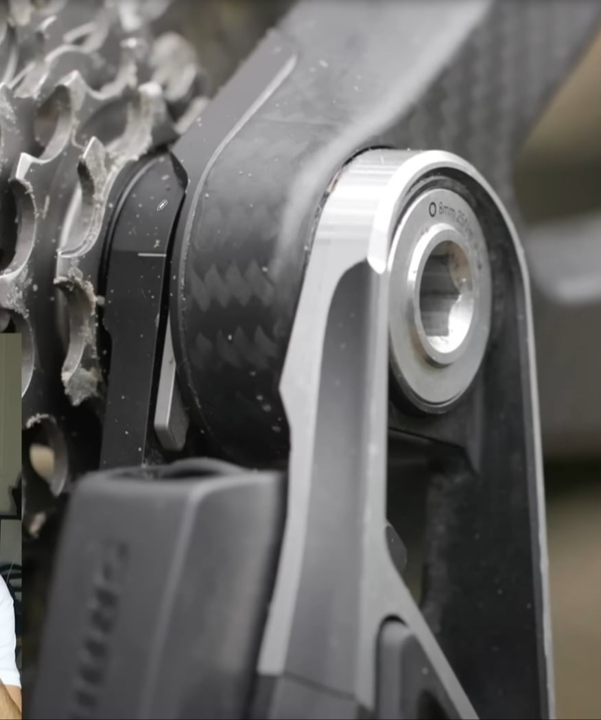

The new system is effectively the existing UDH on the inside with an outer hanger all sandwiched together with the axle and the receiver on the outside forming a considerably stronger structure with ZERO give in the design.
Yes, you're less likely to have a mech fail with this system, but with anything there's a trade off and in this case there's an increased chance of failure elsewhere - the energy has to go somewhere !

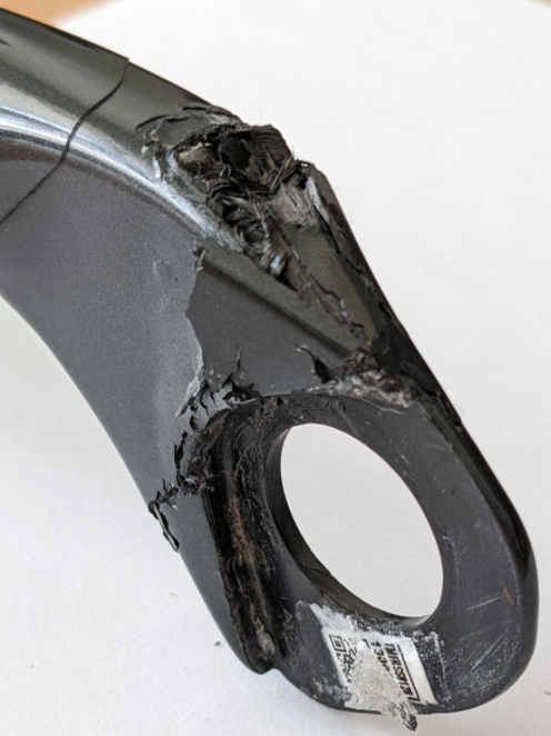

A couple of Rail related UDH fail treads, just for examples - a lot with clockwise rotation issues :

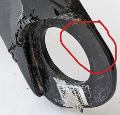

For anyone who can't be bothered reading those, a picture of one example :
With enough force, it's pretty easy to imagine this section tearing out :
If this can happen to an aluminium mech :
