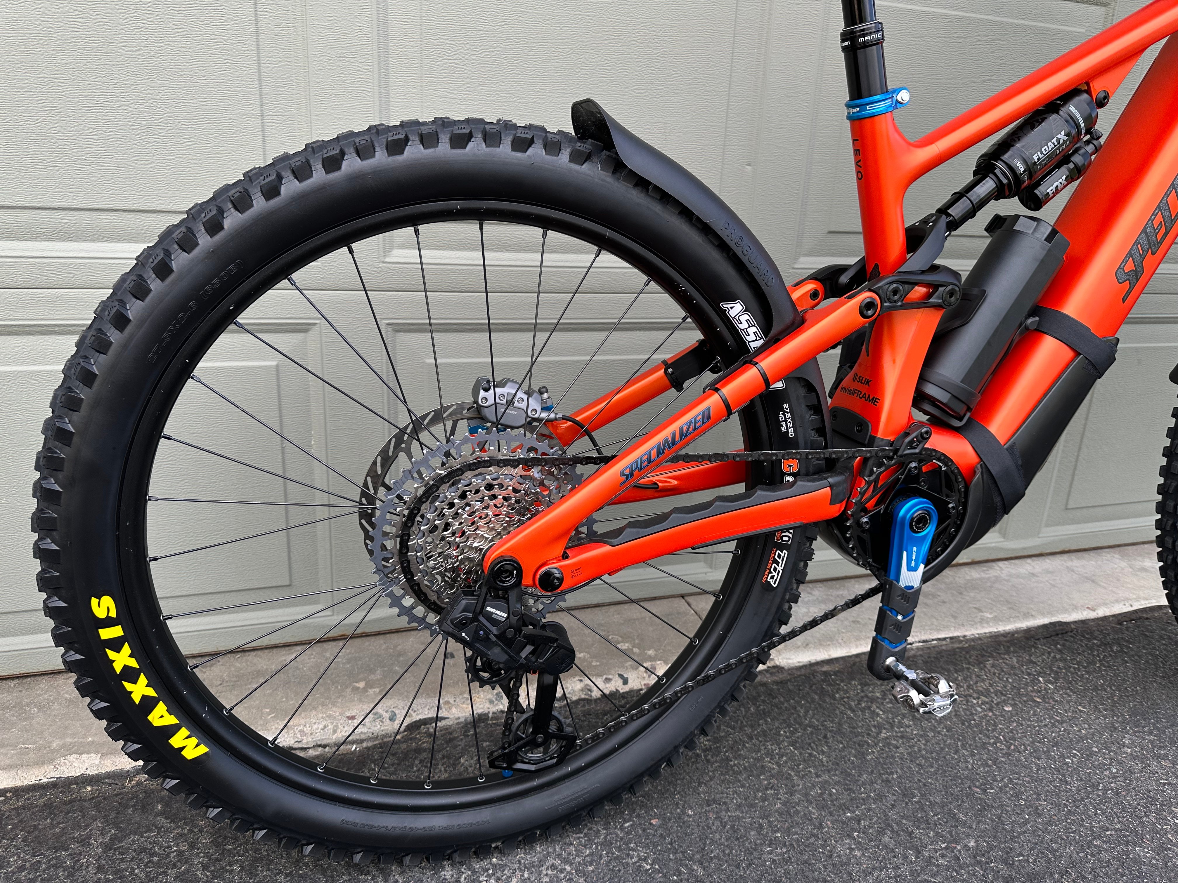

The new Amygos guard fits so well and protects the motor. Ive had them on all my Levos.
The motor guard looks nice, but that rear mud guard looks way to long and to tight to the tire. Looking at your second picture guessing you ride out west? Back east I am trying to imagine mud days and and the chunk in the mud rolling under that guard.
Be careful with the motor guard!!
The motor heat a lot and this guard don't help to cool the motor
Never had a problem on 7 other Levos. This is my 8th Levo. I ride in the alpine where it's a lot cooler.
Im running a 2.6 now and there is enough room. I can fit my finger between the guard and tire. It looks closer than it is. The 2.8 fit but I didn't like the mud clearance.
Yup.

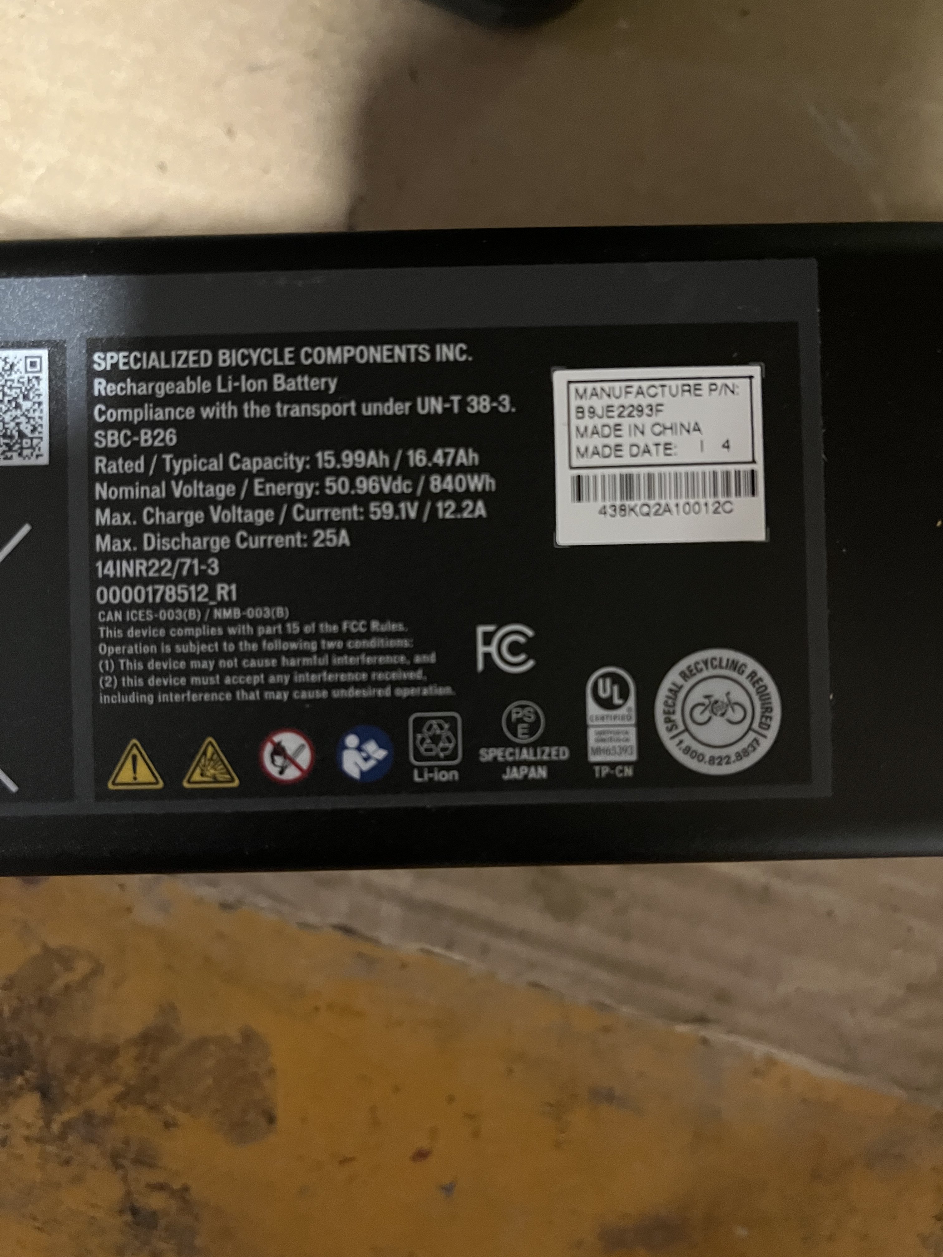

The voltage is lower than it was when in development - but it was outside of some region regulations.
