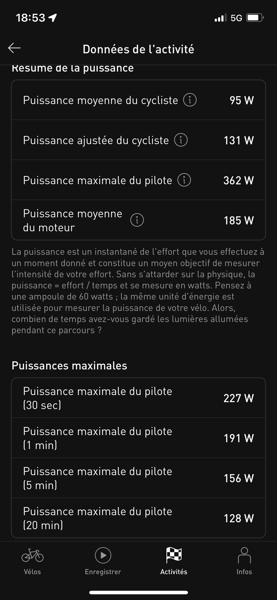

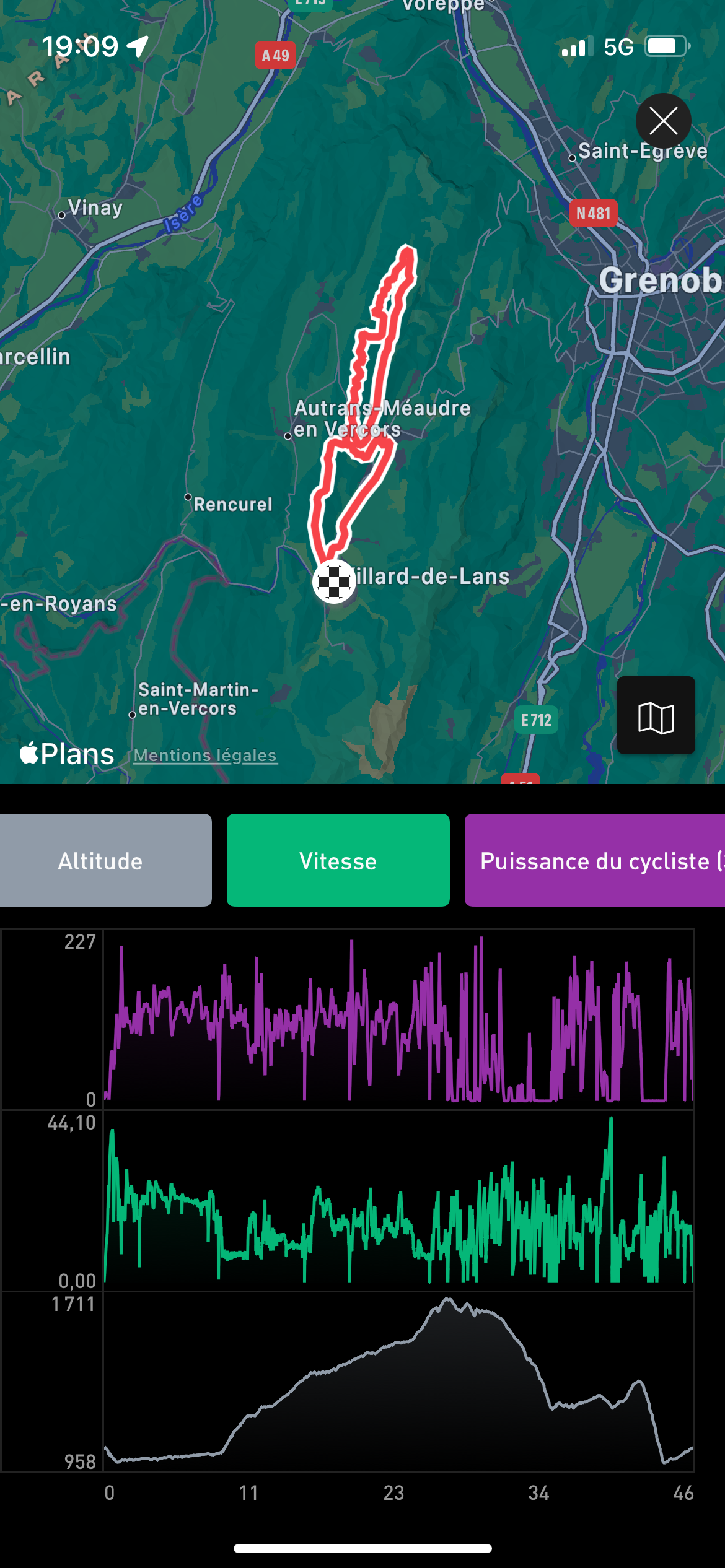

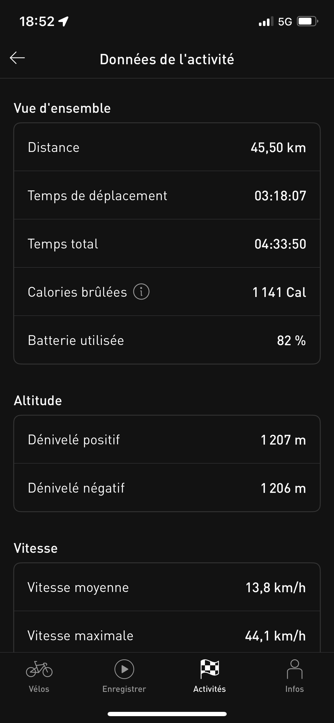

Shuttle off and Auto-... Yes I recorded this with Specialized app. You can take a look on the screenshots... About the frame I'm on a S3 like you. Maybe the pair of Cushcore in my wheels dont help too... Let me now if you need some other numbers.
View attachment 162209 View attachment 162210 View attachment 162211
Ok well those numbers don't tell the story of your bike using a ton of power. Average power usage of your bike was 185, so as a comparison my bike in 28 mile ride with way less altitude but at my sustained power of 215 watts for the ride my bike used an average 337 watts.. so basically 2x the power output from the battery / bike. So just from a cursory review that seem like something going on with the battery
