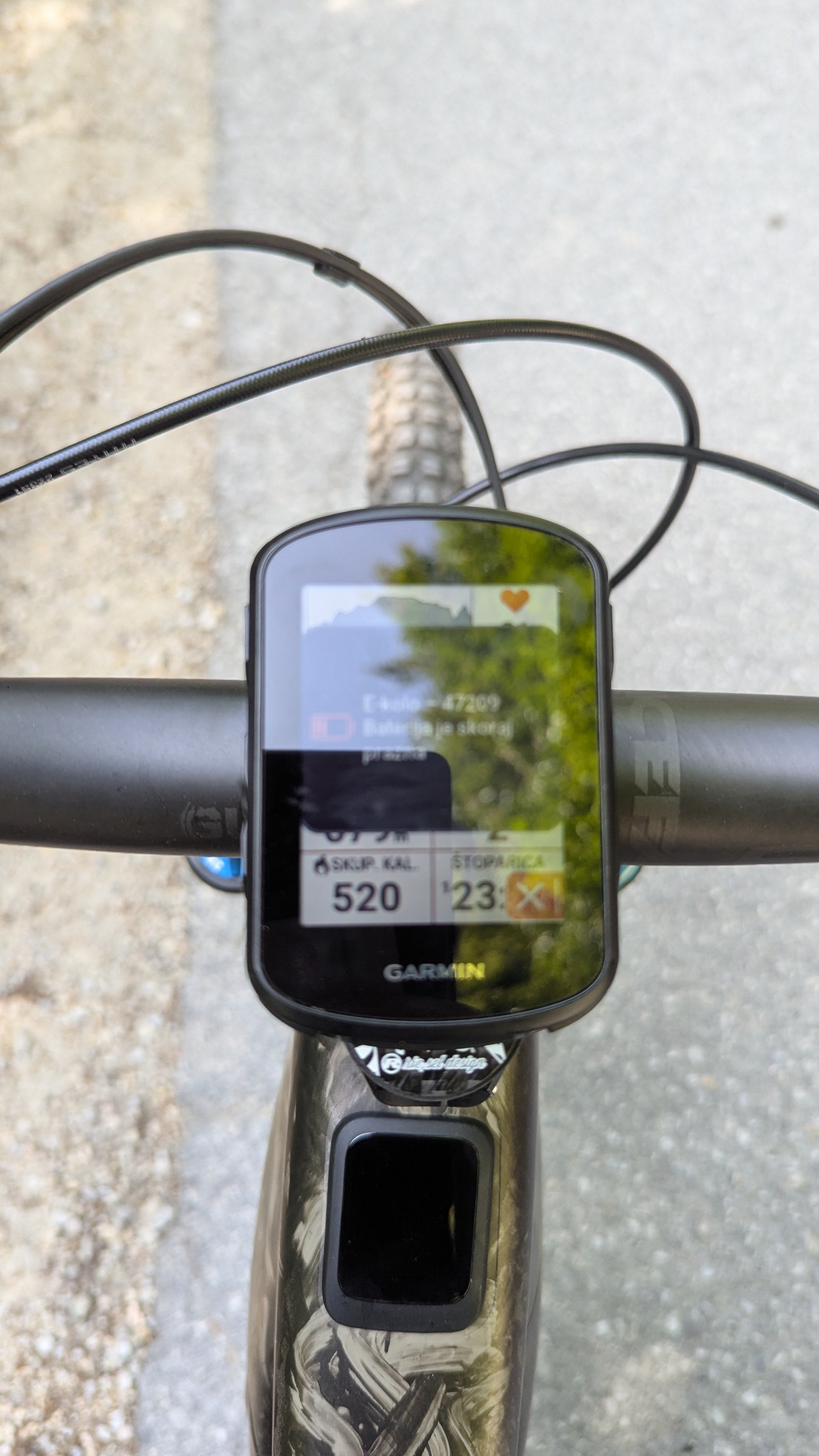

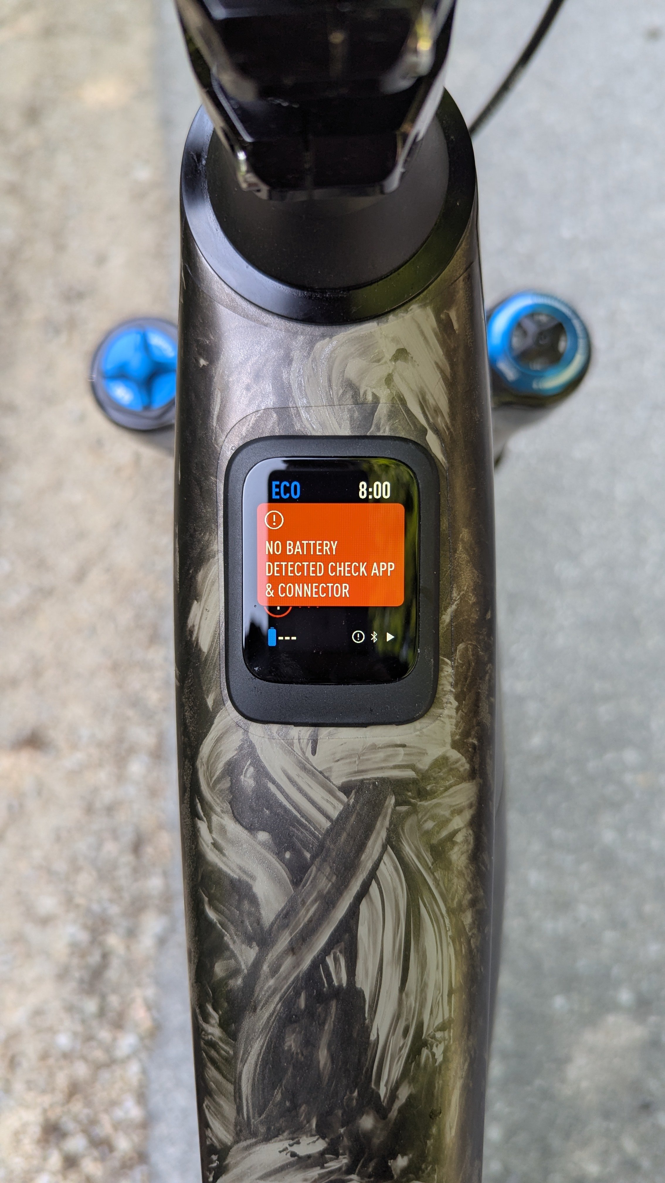

6x times today in 3h ride. 🥴🫣😐

Exactly sa
exactly same as i struggle with!
Here is what i have done so far:
1 error code:
HMI L4-D-HMI-2
The connection between the battery and the TCD-W got interrupted.
Symptom:
Drive unit power cuts off/on
Troubleshooting:
Checked all plugs and cables. No signs of loose contacts or corrosion.

4 error code
No battery detected red screen in top tube and bike turns off
Symptom:
Drive unit power cuts off/on before turning off completely.
Troubleshooting:
Changed to new battery, bike feels significantly more powerful and has now worked flawlessly for 50 miles.until yesterday.
5 error code
Symptom:
Drive unit power cuts on/off before turning off completely.
Troubleshooting:

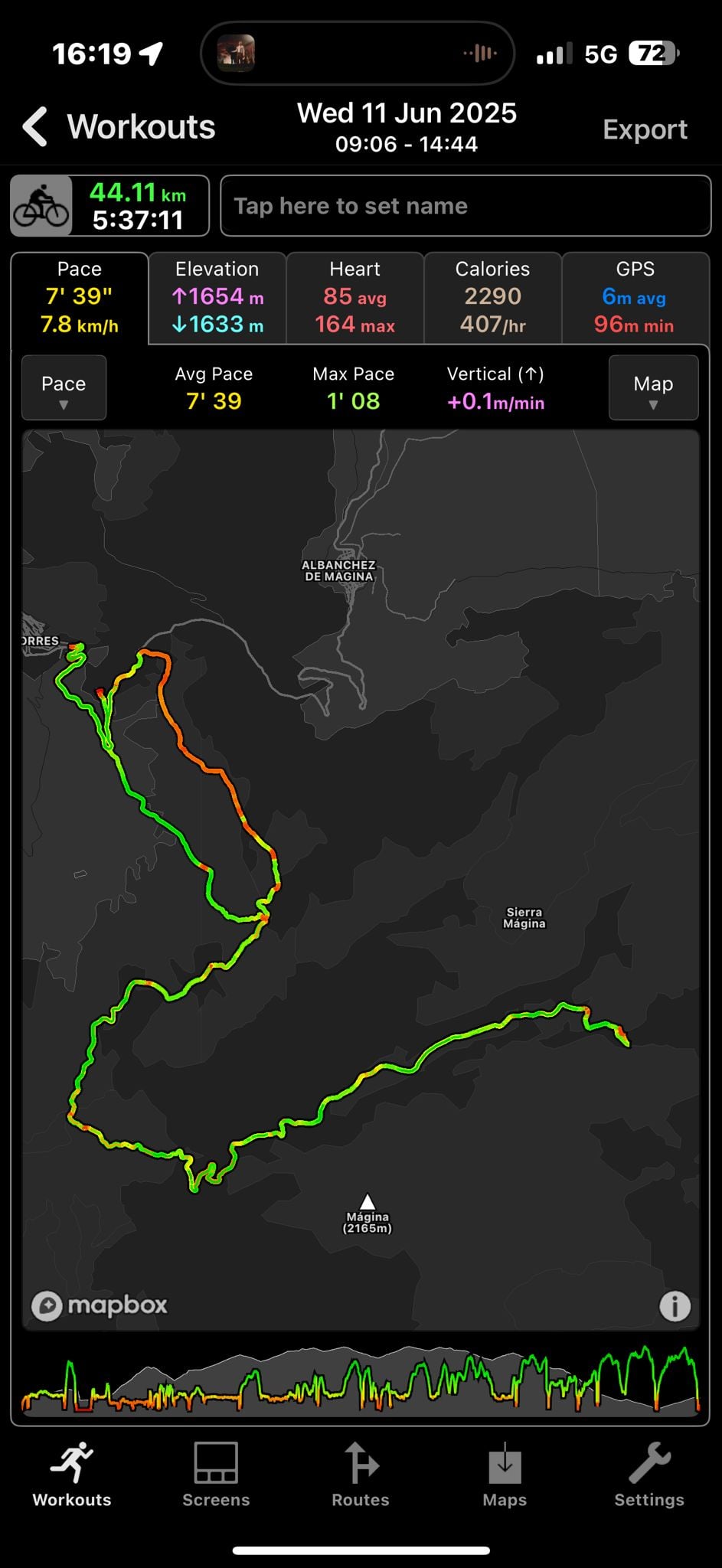

44 km and 1,650 m of elevation gain with 55% battery life.
Mainly ECO 10/20 and AUTO - for steep climbs.
This range is simply impossible with a Gen3. The Gen4 pedals incredibly with little assistance.
The frame/suspension balance puts the previous model to shame.
I'm VERY HAPPY with the new bike!

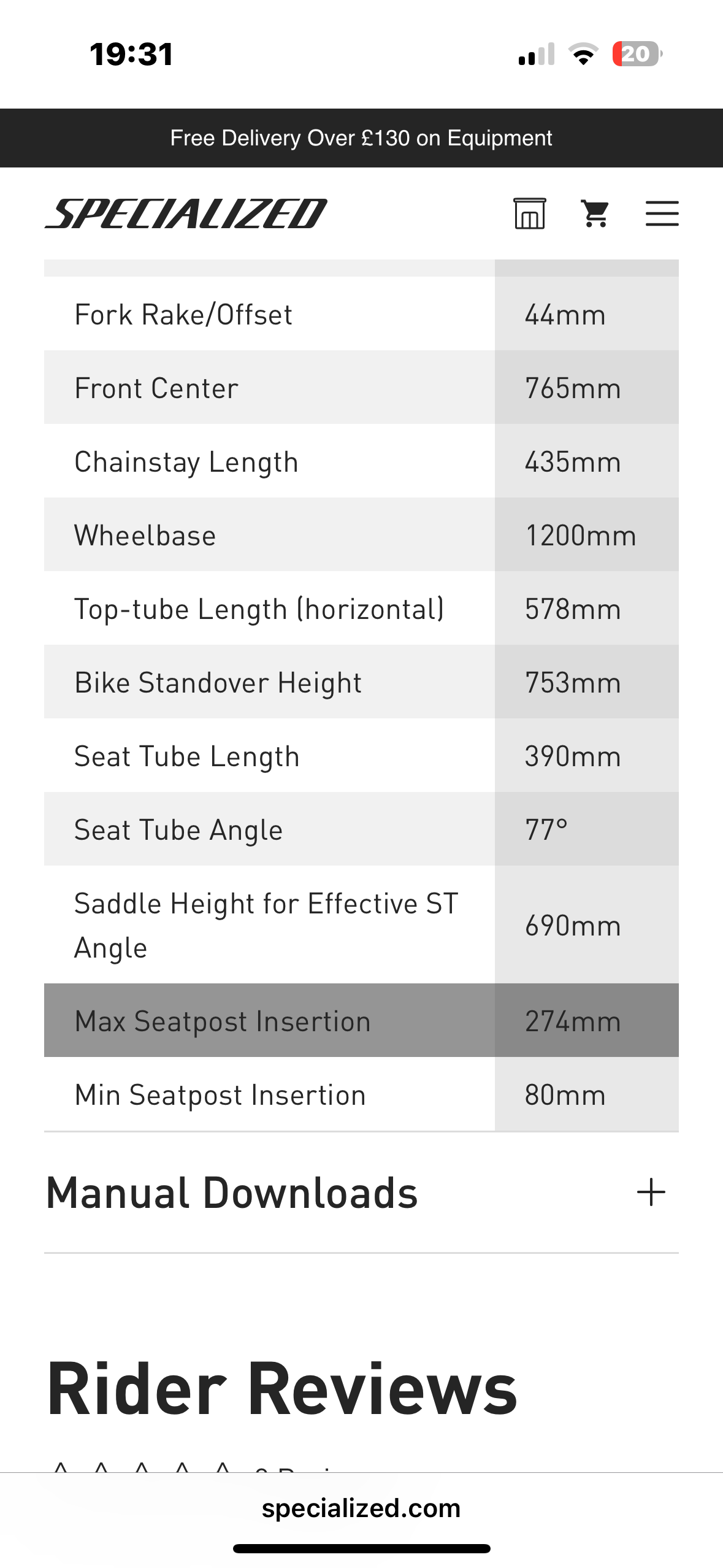

Could anyone tell me roughly what the insertible length is please on the seat tube on the S2 Alloy please.
My wife's seat post is a little too high from shop and before scratching the life out her her X Fusion seat post i wanted to check there was room to drop the post down.
I have looked at spec sheets but cannot see this dimension.
Thanks.
Thanks.
Its on the website, however just push the seatpost down as far as you need to.
for those with power shut down/battery power interuption...................perhaps worth remembering that on the Gen 2 Levos a lot of problems were caused by the battery to motor cable and the cause was that it was a very stiffly constructed cable but had to do a 90 degree bend to fit into the motor connection port. Over time the enclosed wires either shorted or created a high resistance disconnection...................or the way the cable was sealed to its motor end connector plug broke open and allowed water ingress. The replacement cable mostly solved the issue simply by having a far more flexible outer sheath............and clear recommendations how to route the cable. I ordered a new cable but then modified my original cable stripping more the outer sheath to make it more flexible.........replaced with self amalgamating tape.........and aapplied sealant to the end connector. I used that modified cable and kept the replacement as a spare. No problems!!
