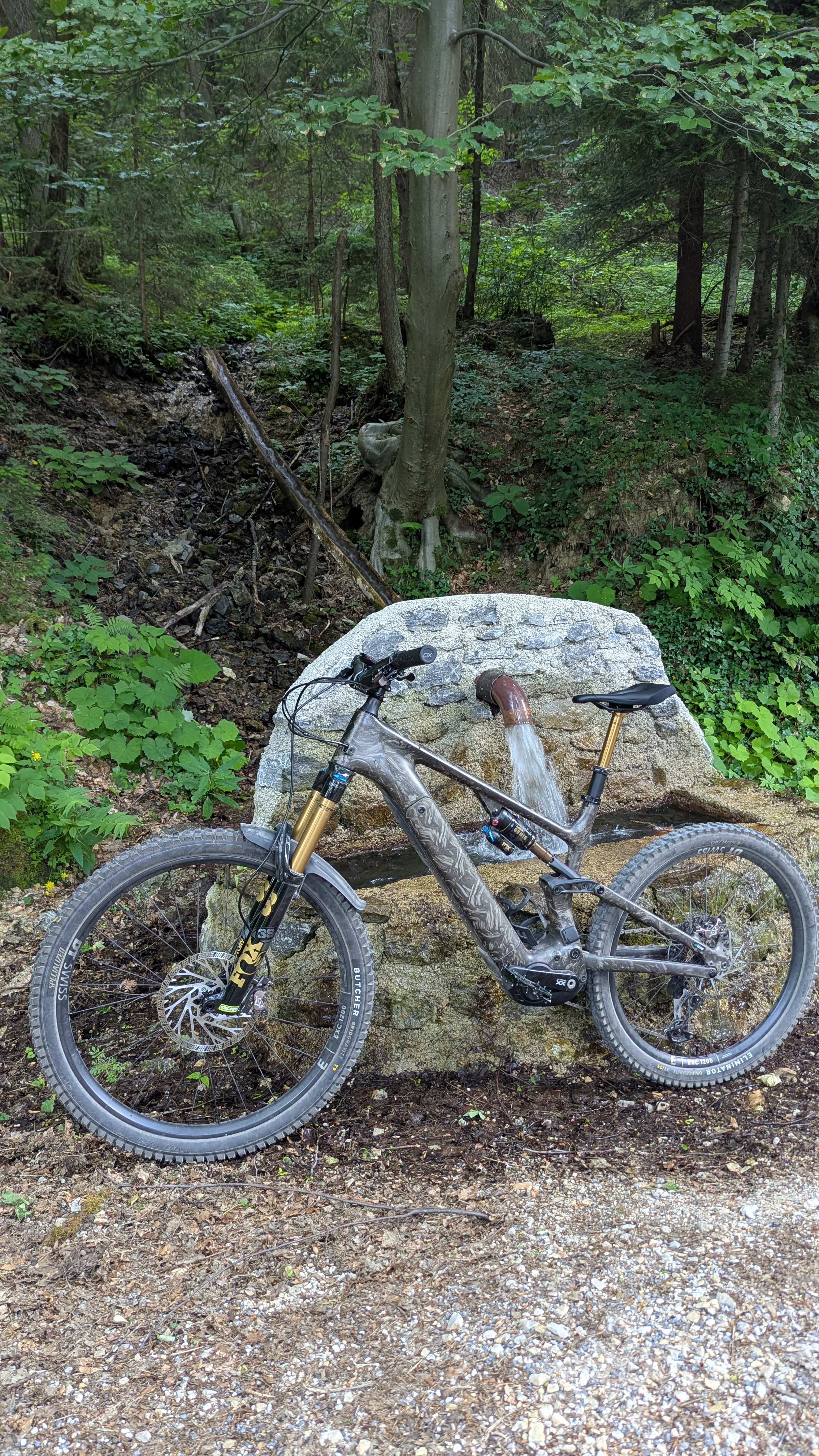

Report of 1 month using the Levo 4. There were 500km of trails with varied lengths and elevations. The longest was 104km with 1800m elevation and the shortest was 48km with 900m elevation. I also participated and was champion in a 58km competition with 1000m elevation. On all the trails I never had any problems or incidents with the Levo 4. The Levo always behaved as expected and surpassed me in performance, strength and autonomy, for my type of use. On the longest trail I did, 104km with 1800m, I finished with 23% battery left. This Levo 4 is fantastic.
Yeah the Levo is fantastic! I made a Tour with 70km and 1600m elevation, only in microtune... 20% battery left. A very good range, but your range is crazy! What modes have you used? Or you are a very fit guy 😉. Can i ask about your weight and do you use the original soft Butchers? I think with other tires you can get a little more range!?

I bought a Levo Comp 4 and upgraded the suspension to electronics and a XX AXS groupset. I removed the original tires and put in Specialized Ground Control tires, which made it faster on the flat and even on climbs. I weigh 96 kg and train daily with a sports accessory.
In the 104 km that I did here in the region, there was a lot of flat terrain and descents, but also long climbs. So it was 60% using assistance and 40% without assistance. Of the 60% with assistance, 80% was between eco and trail and 20% turbo.

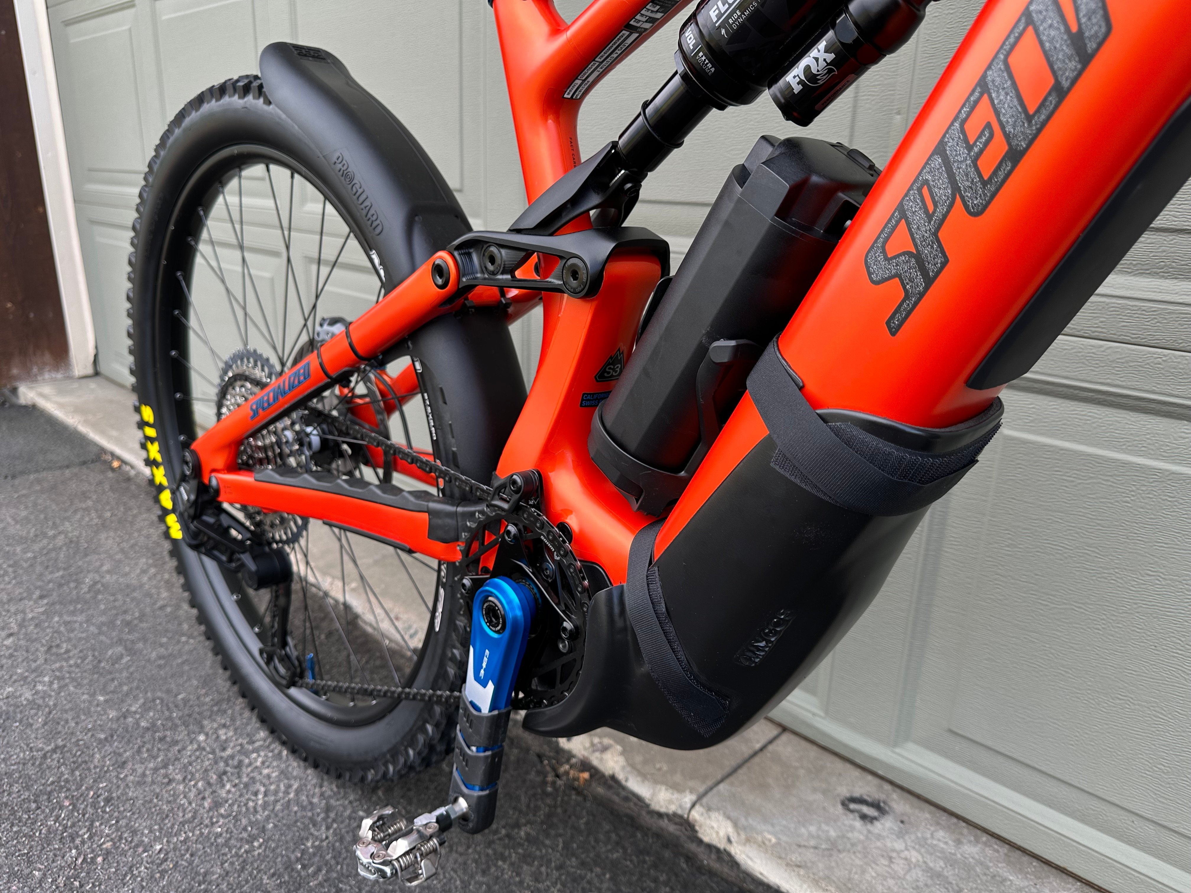

Does that mug guard not reduce the tire clearance ... as it is it rather tight on the seat stay arch. Unless you running a smaller tire ? What Maxxis you got on the back ?
I had a Maxxis DHR2 27.5x2.8 at first and it rubbed on the mud guard. Now Im running a Maxxis Assegi 27.5x2.6. We don't have thick mud here so it works great and no rubbing. The 2.8 would be fine without a fender.

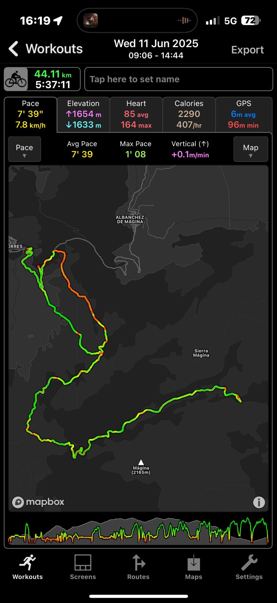

44 km and 1,650 m of elevation gain with 55% battery life.
Mainly ECO 10/20 and AUTO - for steep climbs.
This range is simply impossible with a Gen3. The Gen4 pedals incredibly with little assistance.
The frame/suspension balance puts the previous model to shame.
I'm VERY HAPPY with the new bike!
