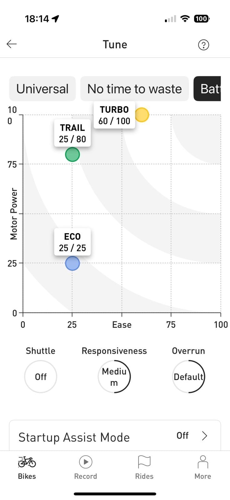

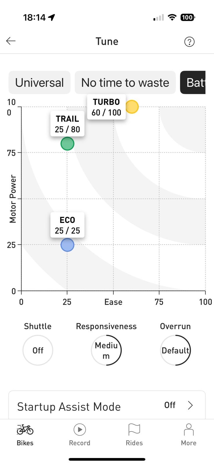

Mind sharing some of those settings im not getting the best range out of mine currently using ECO at 50/50 about 60% of the time and trail 70/75 feels like less power in these settings than my Bosch gen 3 in EMTB mode and i get more range from the Bosch 750Wh.
Not sure if the soft rear tire (butcher) is affecting this.
Those settings must drain the battery ridiculously fast. Try these.

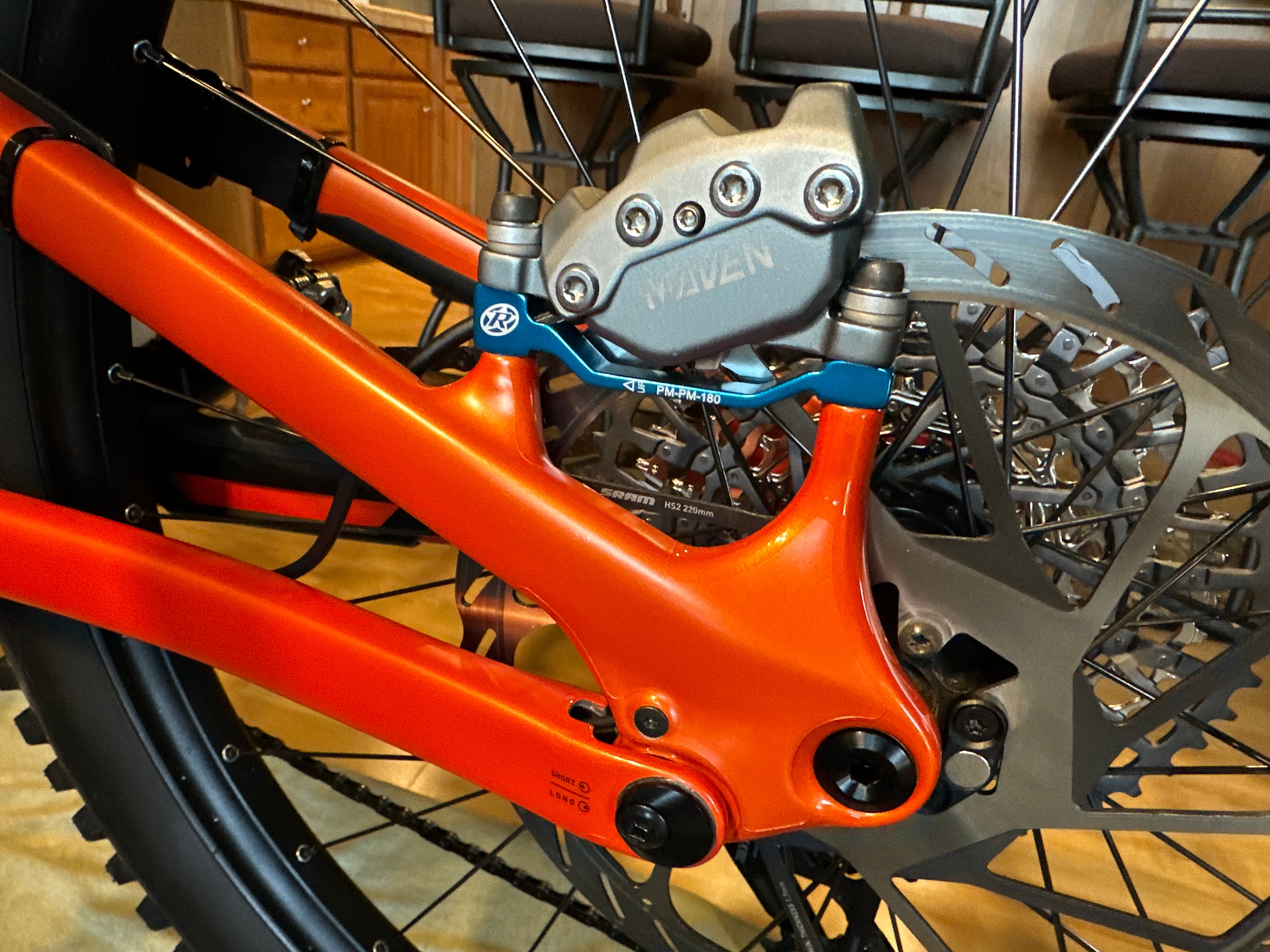

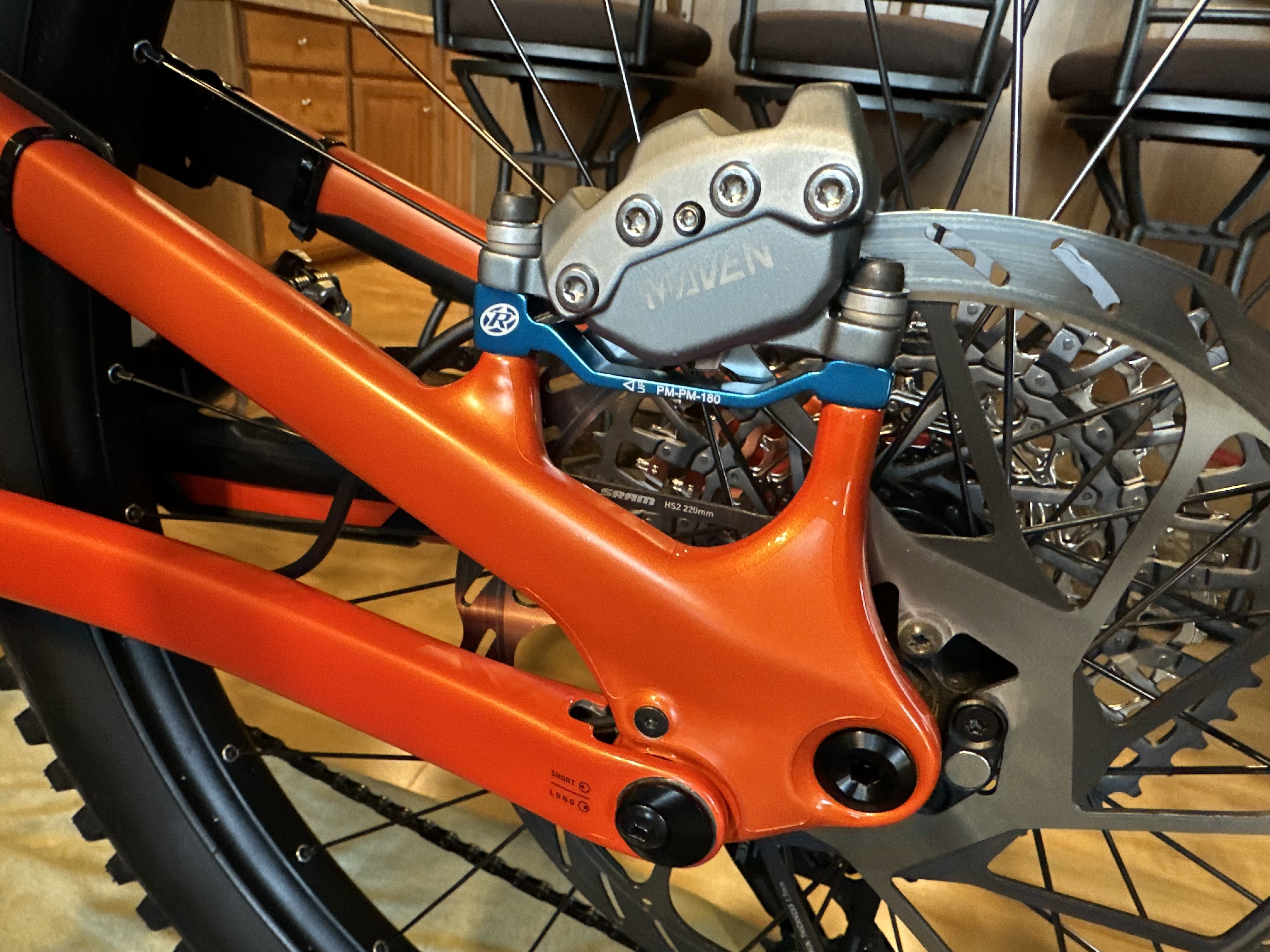

Has anyone swapped the 220 mm front rotor to the rear? Wondering if the 200 to 220 adapter can be removed from the fork and used in the rear to put the larger rotor on the back wheel and 200 on the front? My bike shop says the chain stay posts may have a slightly different shape from those on the fork of my comp S4 and it may not be interchangeable. I vaguely remember somebody asking but that would be a lot of pages to check back on.
It doesn't work. The front adaptor is a +40. You need a +20 for the rear.
Hey thanks kntr, exactly what I was looking for, real world experience. Now that I look at my bike I can see from your picture that I should've been able to figure that out. So the front 40mm adapter has to go down to 20 mm to accommodate the 200 mm rear rotor, and another 20mm adapter in the rear for the 220 rotor.
To all the other folks who said this is a weird set up I agree with you 100% but I had a severe spinal injury riding motorcycles in the 70s (Total paralysis from the neck down for one hour w/ yrs of recovery) leading to permanent nerve damage with weakened hand grips, L weaker than R. We have very long descents returning from mountain top Sunday rides so I have adapted to lightly dragging rear brake on the way down with the big 220 rotor so hand grip doesn't completely fade out, and rapidly pulsing the front brake with 200 rotor. Then I don't crash. My thing is all about dusting people on the climbs anyway ever since the cross country racing days in the 90s. I'm still good at that, but only because I have trained the reflexes to deal with max assist settings for shuttle, responsiveness, and overrun. I know, I know, that's cheating! Got range extender on the way so it'll be interesting to see if I blow through the 840W too much and need it for those longer rides.
Just to make is clear and short...
The Fox fork fits a 180 with no adaptor. There is a 40mm adaptor to go to the 220. My gen4 frame is an s3 and has no adaptor in the rear but is a 200. I had to add the 20mm adaptor to get to 220.

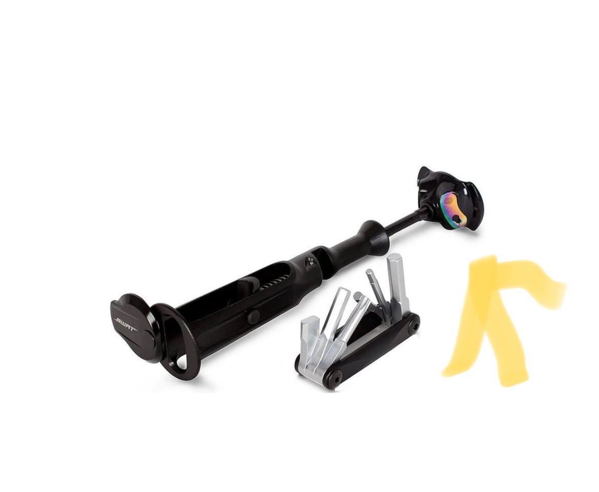

I still have a darn rattle I cant not figure out. It seems to be under the screen. I took the swat out and put a towel in the swat bag to hold all the wires in place. I took the screen out and tightened it. I made sure all the cables were wrapped in the velcro piece. I can not figure it out. My next fix is to just take the swat out completely and put a towel in there to hold all the cables under the screen. Anyone figure out the rattle?
Pic for attention. :)
Its with high possibility the quick link to your chain in the bottom of the swat tool in the fork 👍 was in my case!
Remove the SWAT internal downtube storage. This SWAT makes a lot of noise, I don't even use it anymore. With it, it sounds like the steering box is loose.
