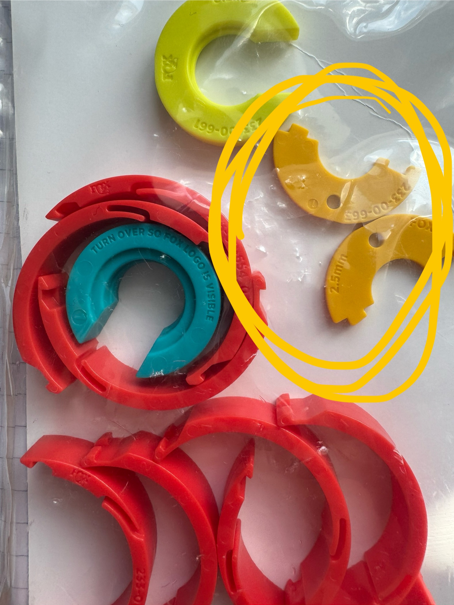

Does anyone know what the orange spacer is for? I can’t find it in the manual.
