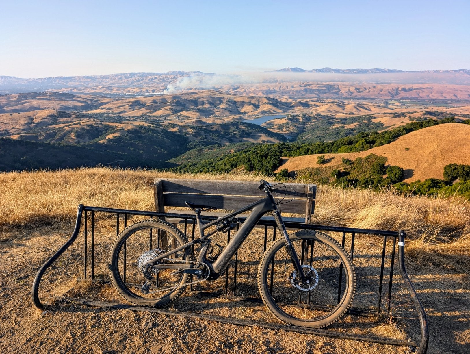

Finished building out my bike and took it on its first ride. It's great. A 200mm dropper managed to be just right when slammed all the way down, which is quite nice. No motor or battery issues to report. Managed to wash my front wheel about 15 seconds after taking this photo and chewed up my forearm/elbow pretty bad. That was a fun 15 mile limp home. I'd say maybe 50% getting used to Mavens and 50% just a bad off camber with loose over hard.
The fire in the background is just California being California.
Did you weight it?
