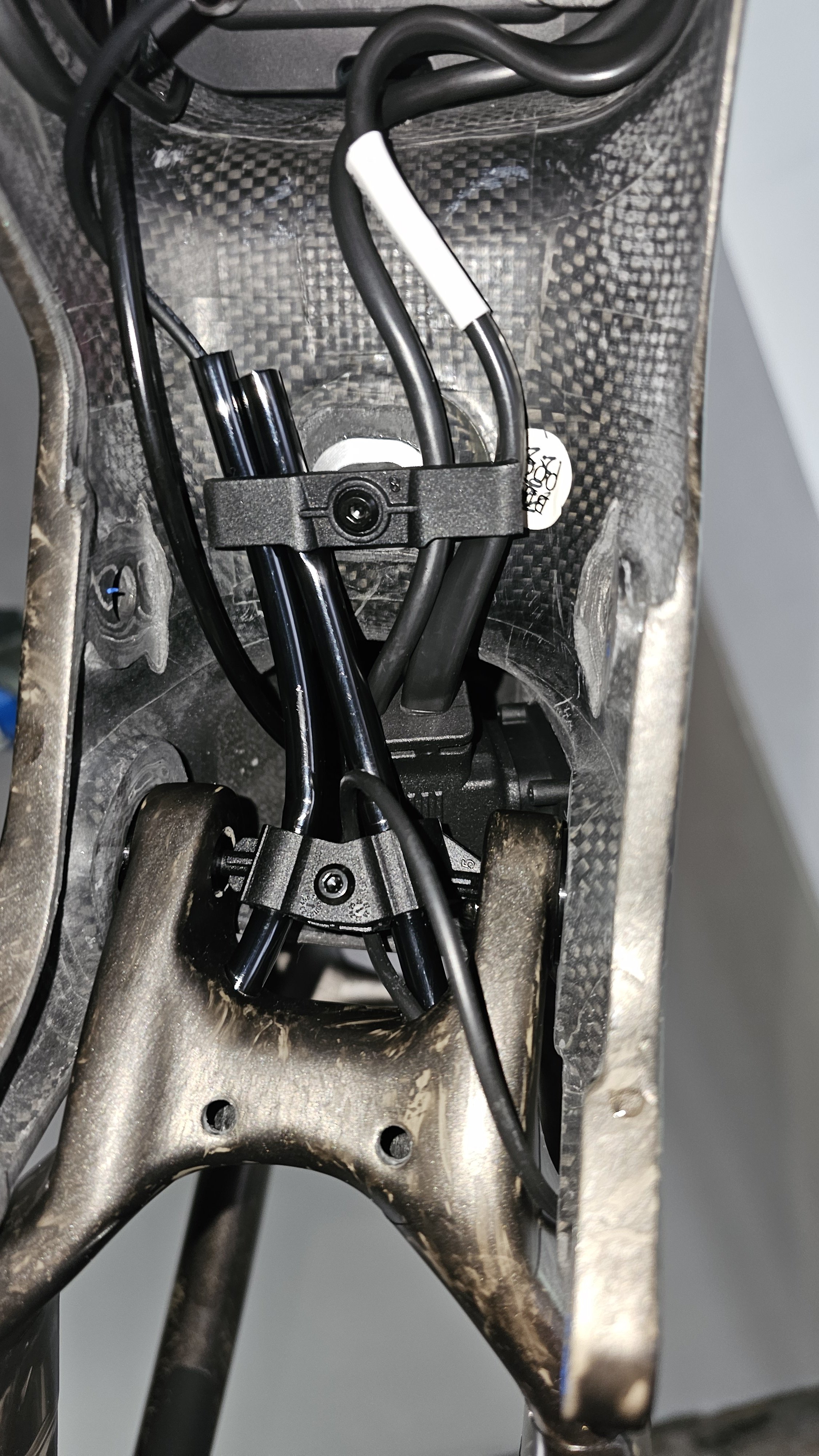

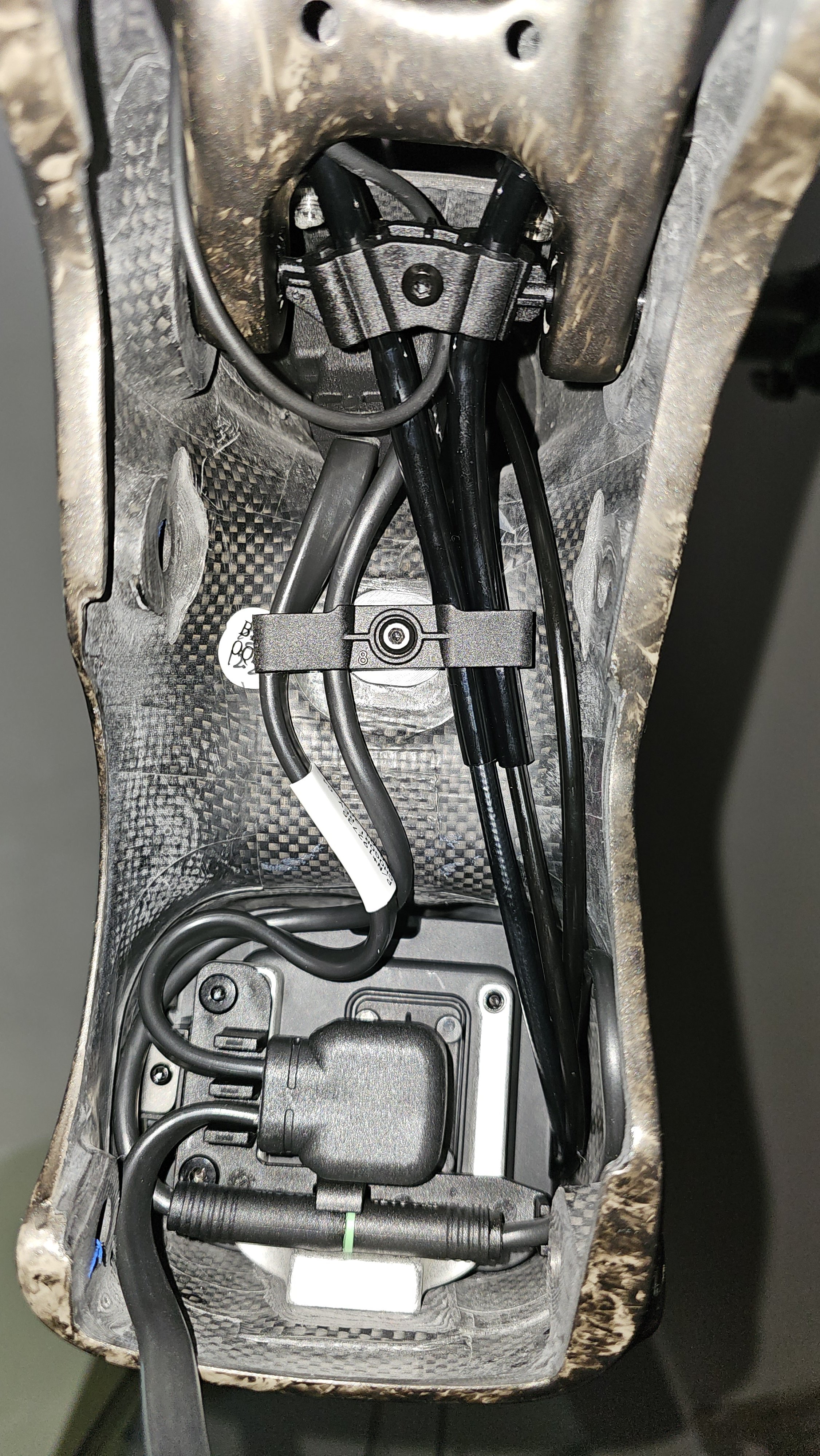

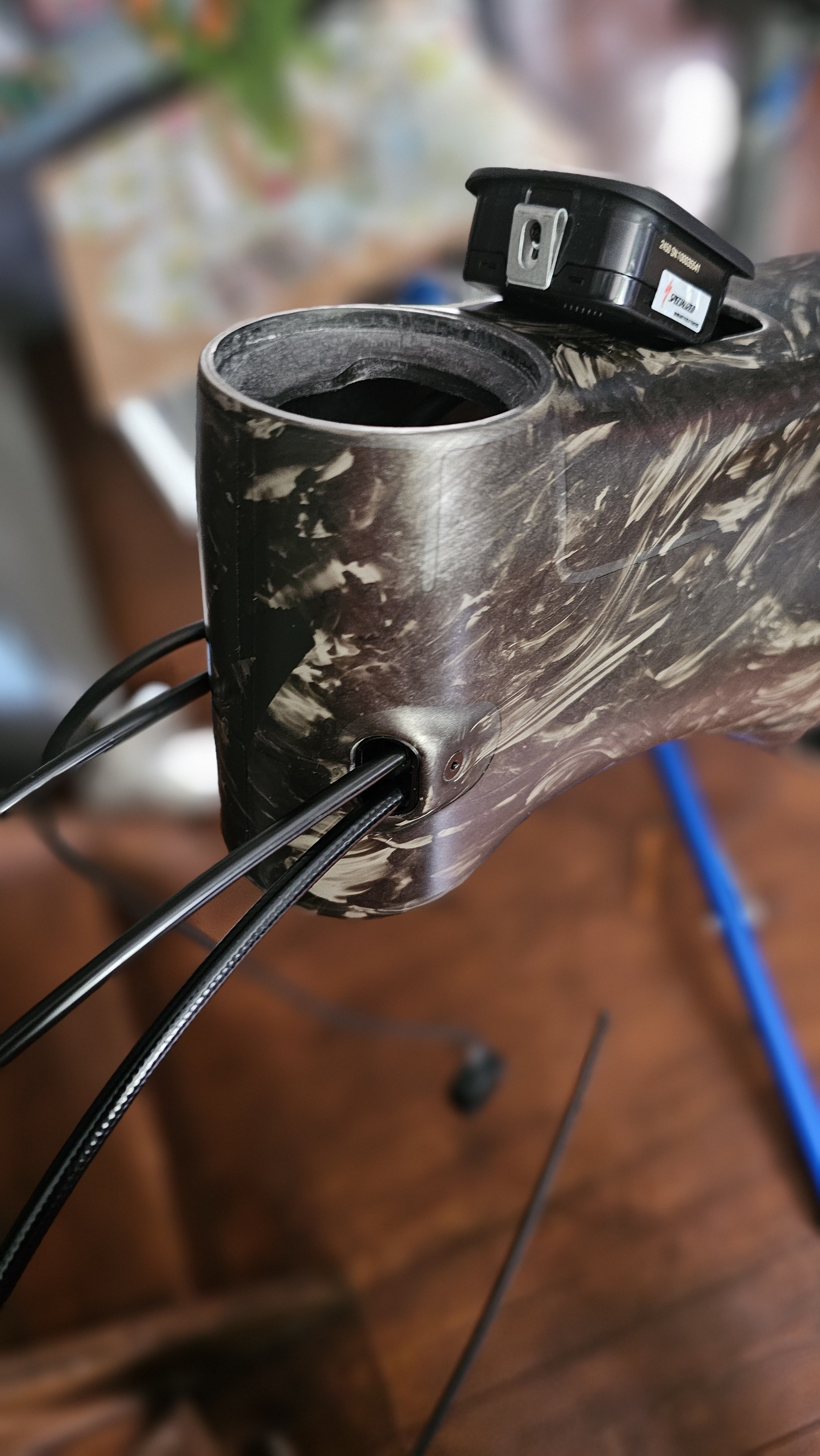

Sad to hear... Seatpost cable is too short on mine. Not really happy to go to my LBS to make the change...

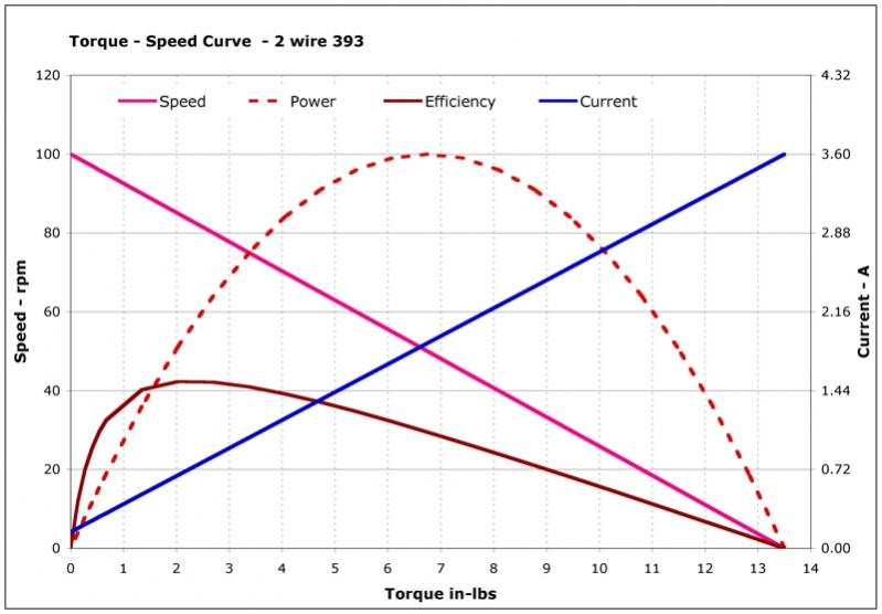

You are 100% correct and I could waste 15-20 mins explaining technically why a bigger battery and new motor (more torque) does not equal same distance as old bike with smaller battery and lower torque motor. So disagree all you want but the laws a physics still apply! Glad to see someone else understands.
