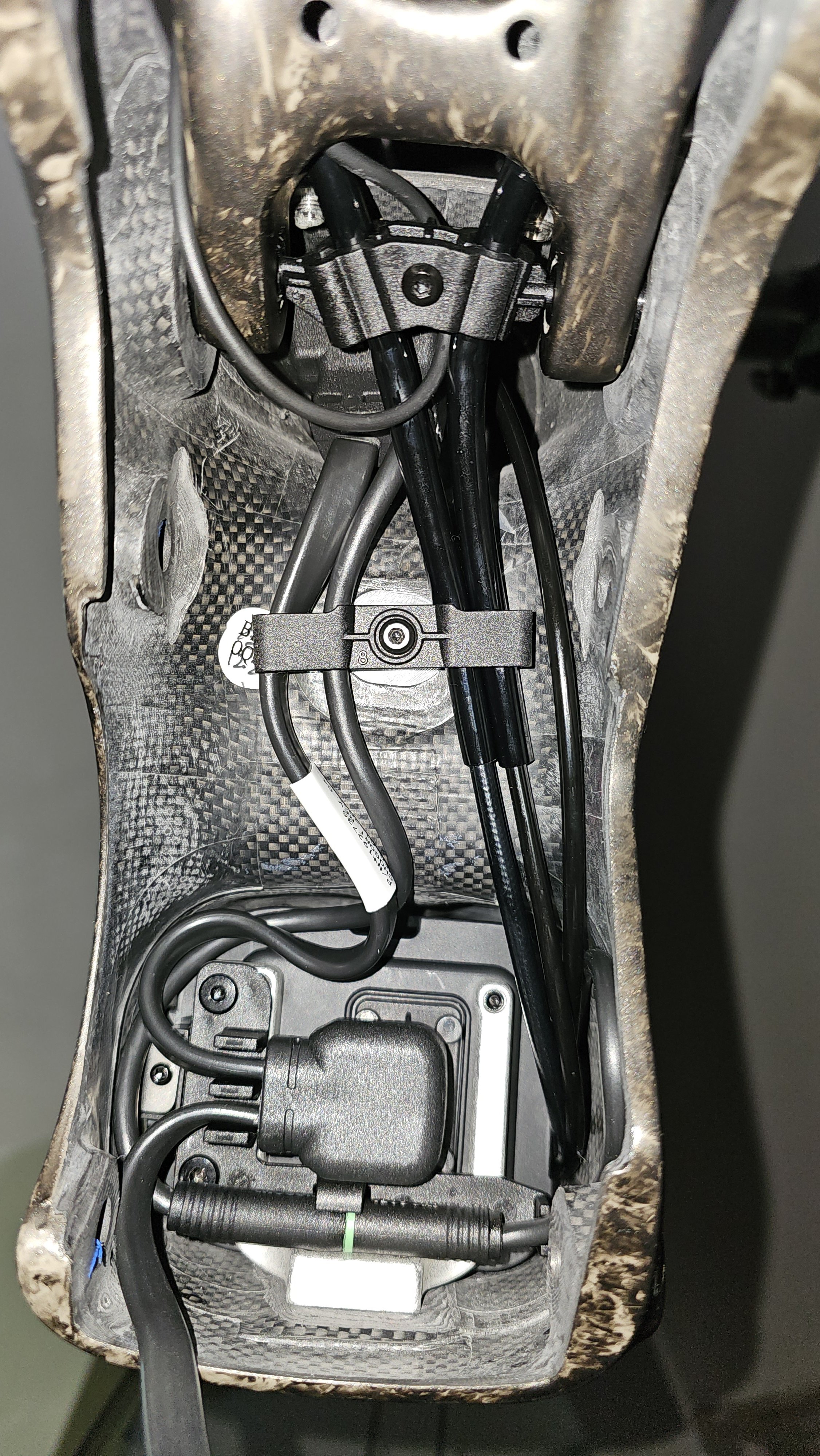

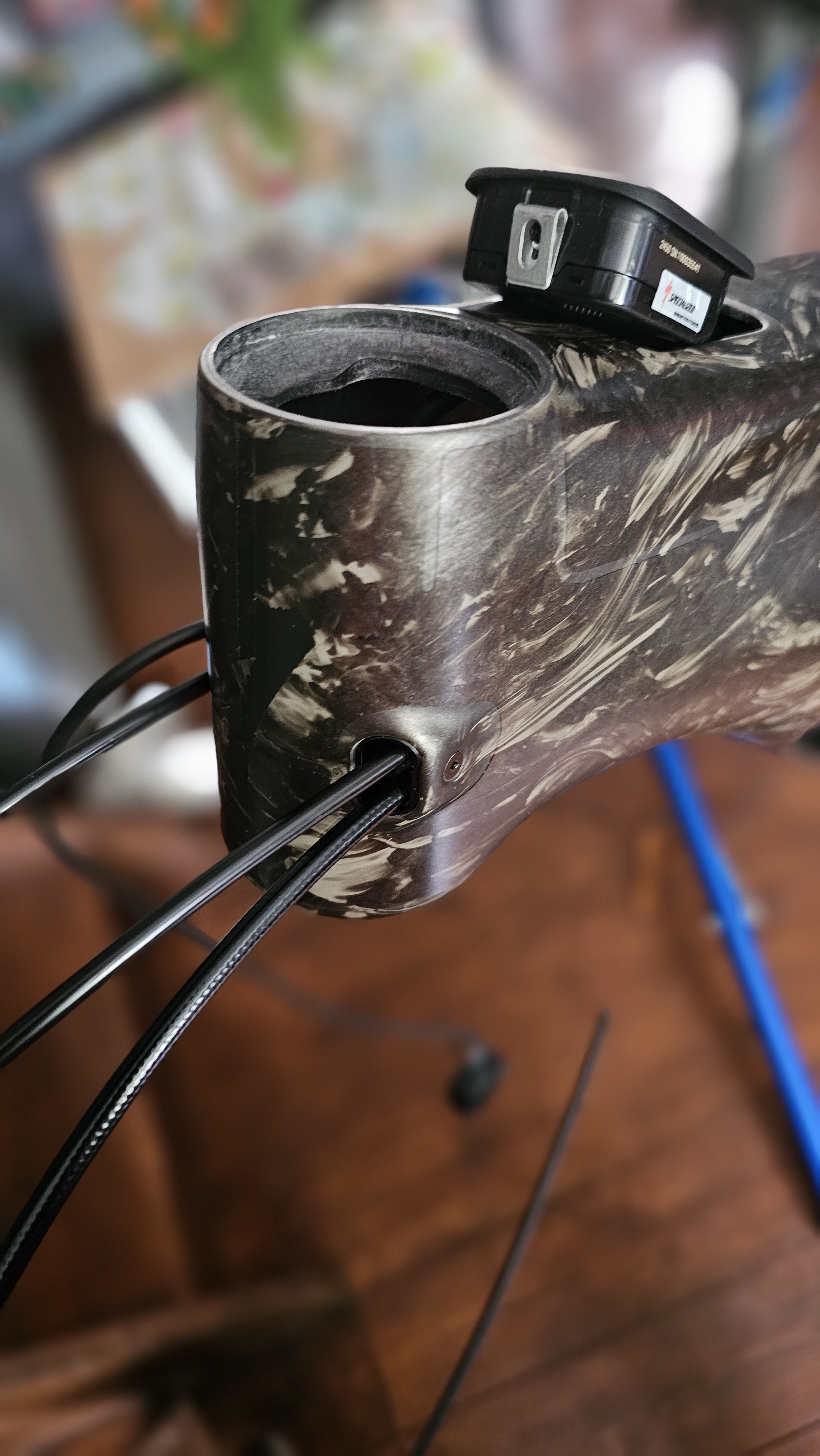

I also bought just the frame and it came with the cable already installed. If you removed it, there is no other way to put it back in except to remove the motor
I also installed a normal derailleur so I had to disconnect the battery cable from the AXS derailleur and this also requires removing the motor
Hope it helps 👍
Hope it helps 👍

Are you sure about that? Usually they put a nylon tubes inside the frame to help protect the cable and to guide the cables to the handlebar openings effortlessly ... Also on Gen2/3 you could for example only remove the left motor cover to help you guide the dropper cable in both directions ...
Its always so weird to me that people don't notice a weight difference of a bike of 1-2 kg. When I switch from a sub 23 kg bike to bike that is around 25 kg I notice it immediately. I don't even have to ride it for long. Just grabbing it and rolling, flicking it from side to side its immediately obvious. I mean that weight is equivalent to strapping 2 to 4 waterbottles on your frame.
I equate riding eMTB to riding MTX (motocross), you can feel the weight yes but you also have a motor to over come most of that weight. Now 2-5lbs on a regular MTB is way more significant.
all cables and wires run along the inside of the downtube just behind the battery and then further down the frame just behind the battery mount. There is no way to run a cable from the seatpost or derailleur without removing the motor
