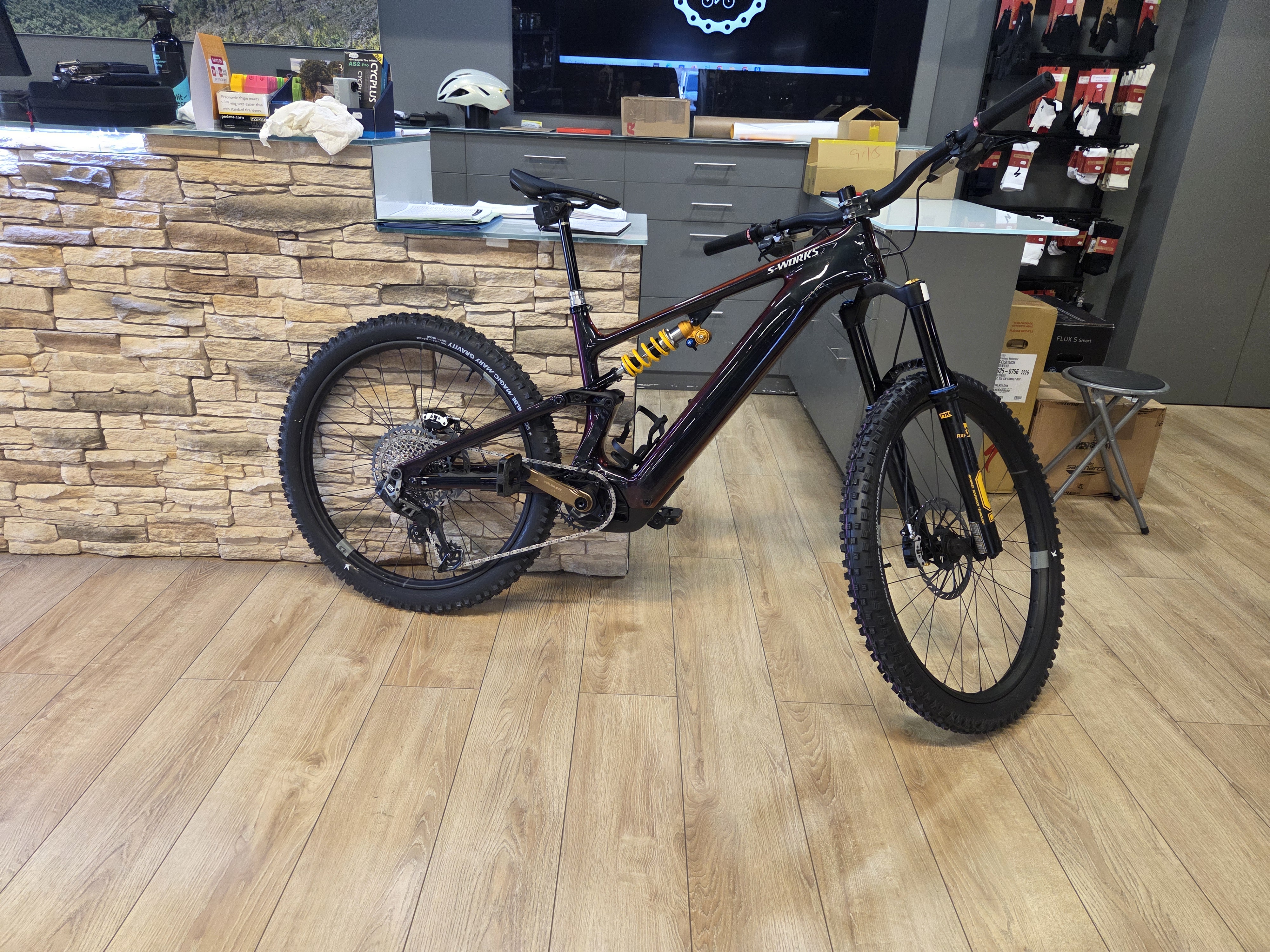

Has someone build there Levo gen 4 with Mechanical drivetrain ? I have taken the AXS of and unpluged the AXS cable to the mastermind. Struggle with all kind of error codes🤣
