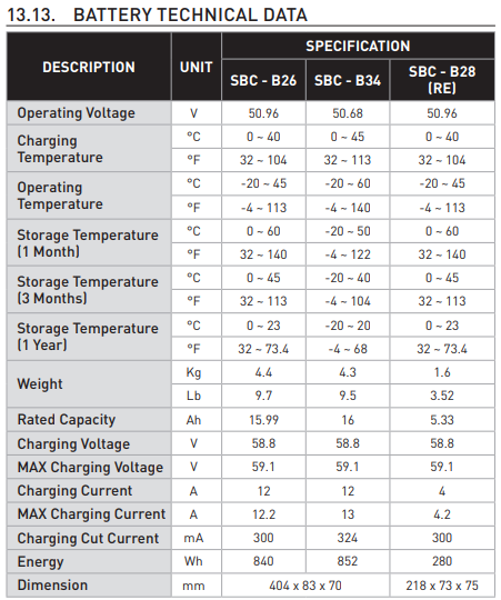

I seem to remember in the manual it lists two versions of the battery (slightly different numbers), presumably different suppliers.

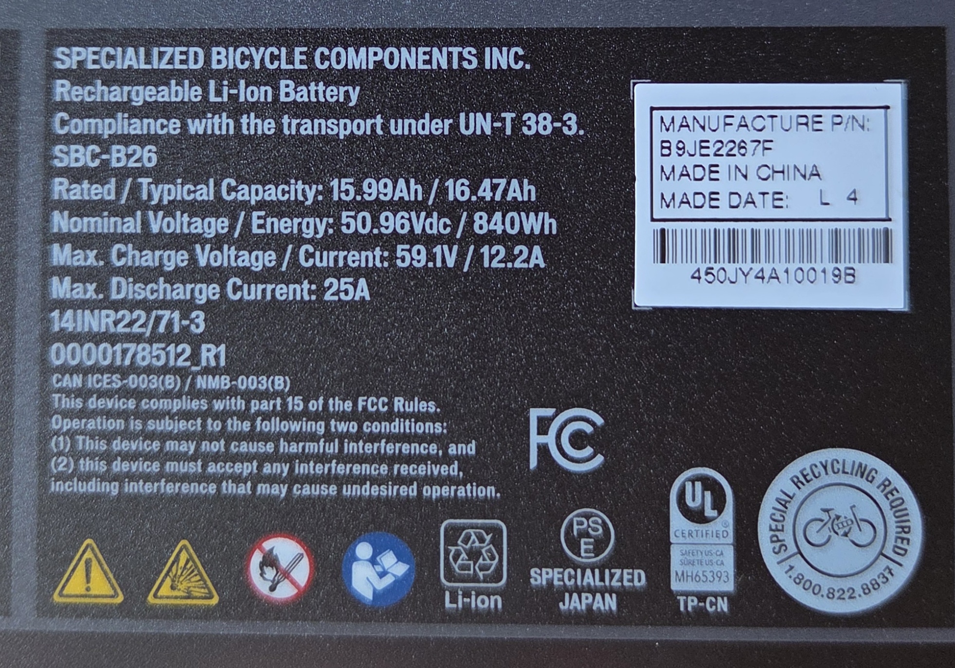

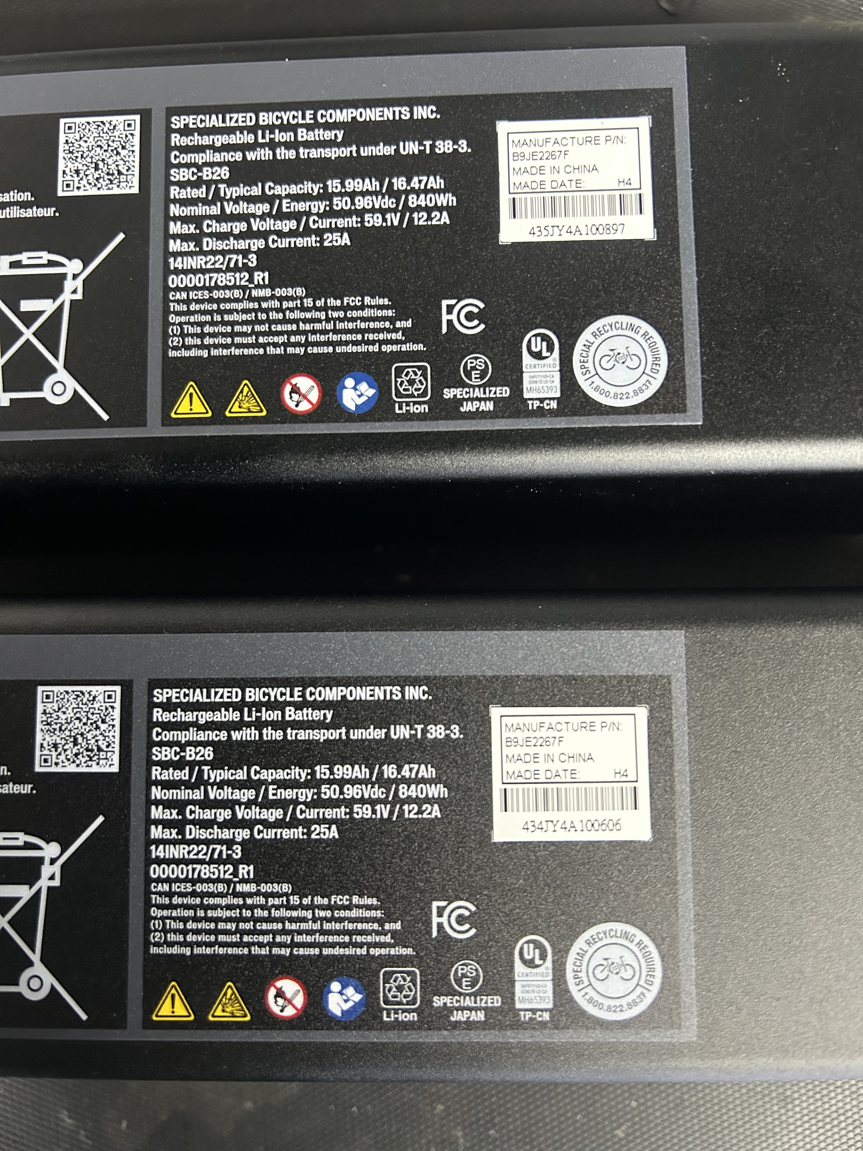

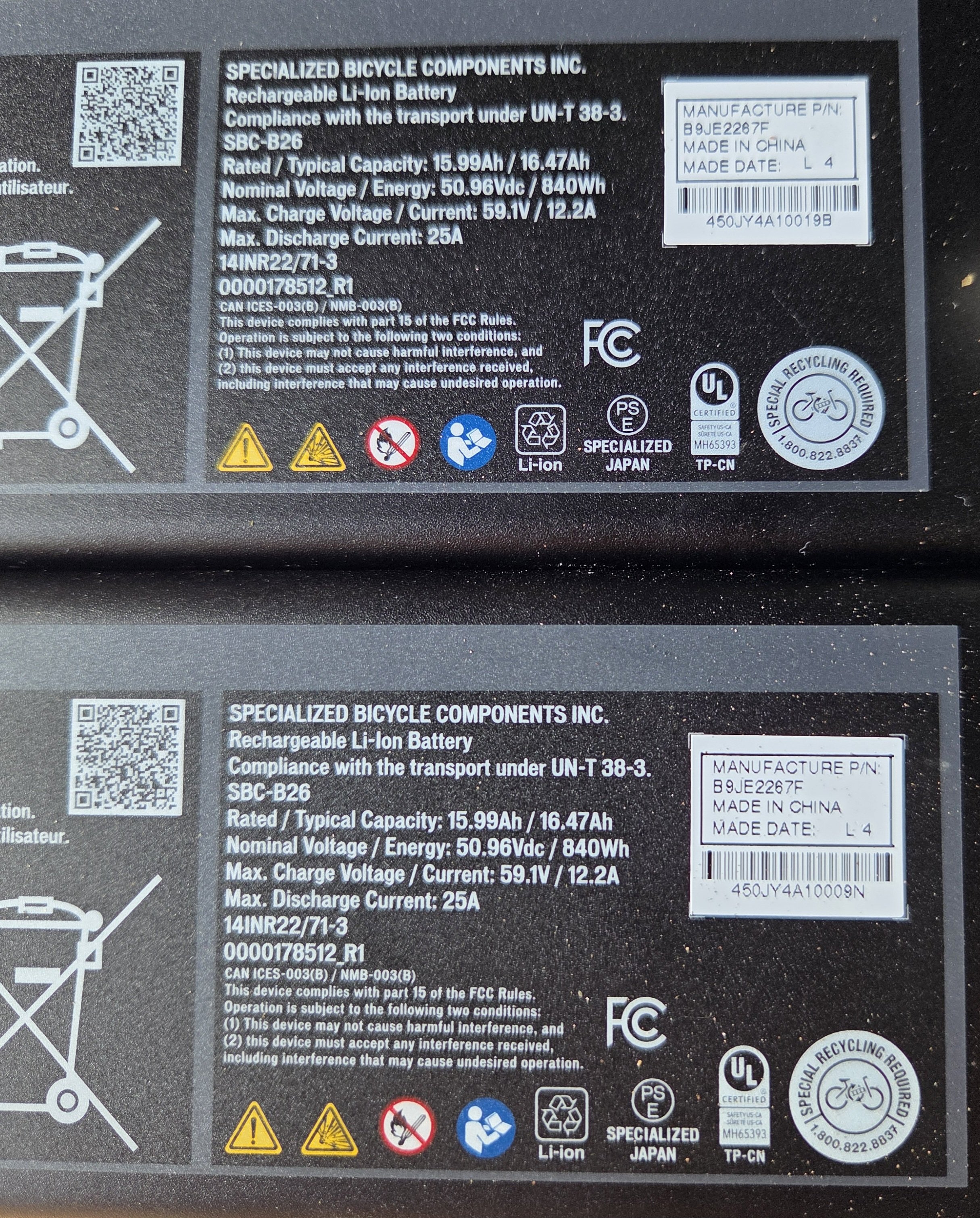

Here Are the info from my batteries, what does it say on yours?
looks like You uploaded picture of the same battery twice? At least when looking at det number in the white square at top right corner?

Are you guys with battery issues riding an S-Works or the regular Levo, the battery you posted is the SBC-B26. Could the S-Works come with the SBC-34, maybe someone with an S-Works can check?
