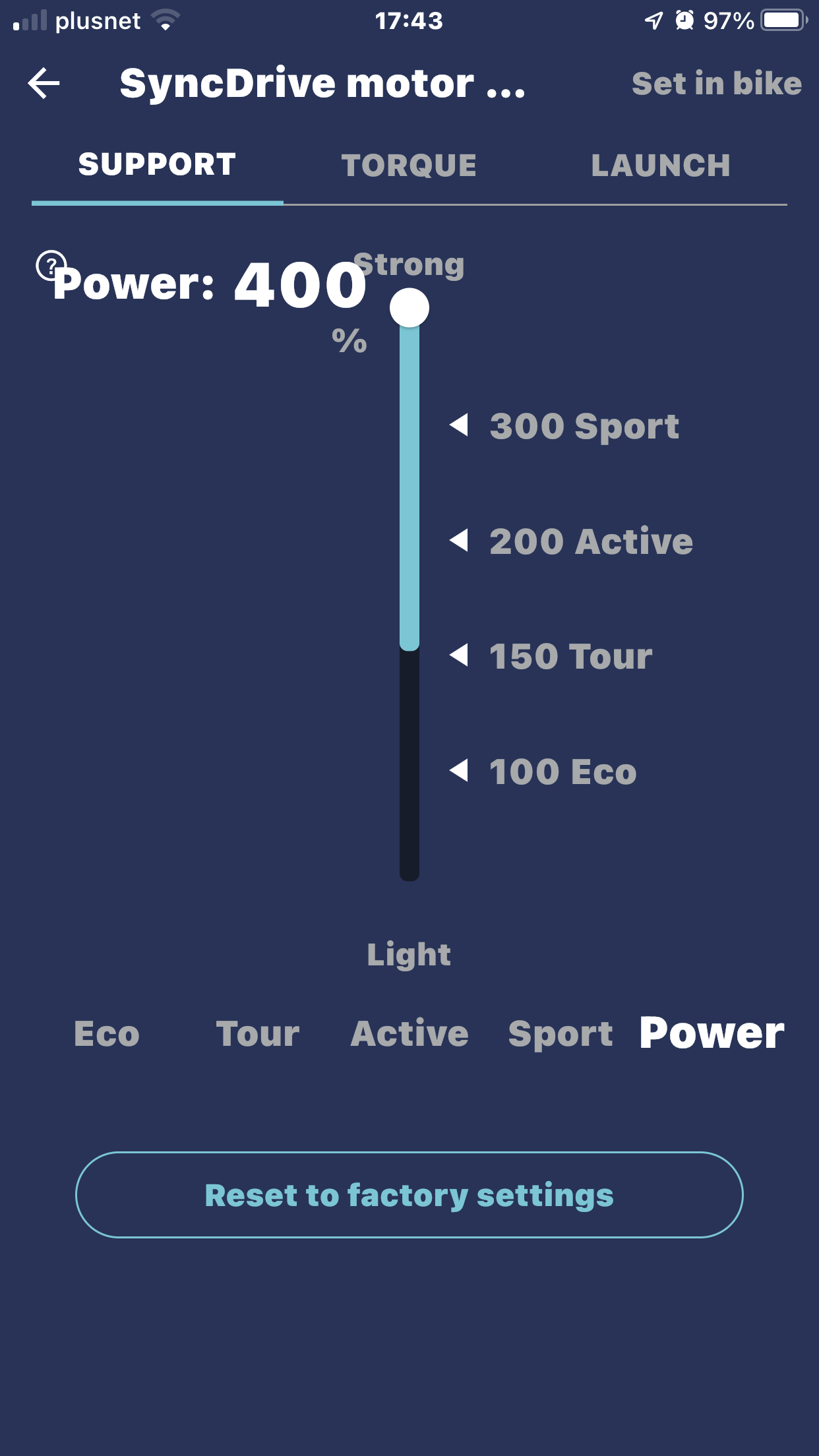

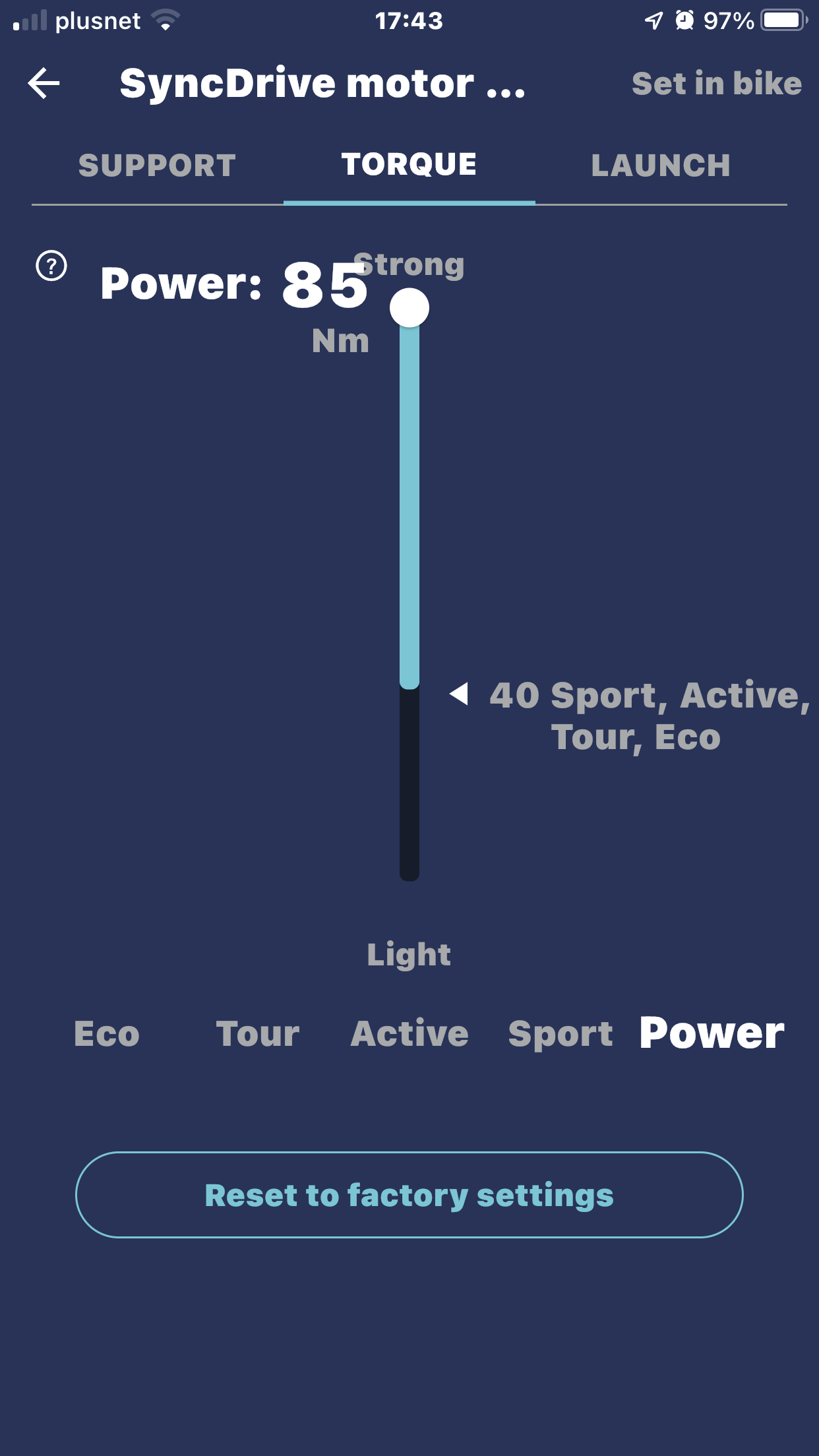

2) Power is not that impressive, I did an hour long test in the most powerful mode. Coming from an e8000 with 20% less torque and max asistance set to 200% assistance, the max power on the Giant feels roughly similar despite a claimed 85NM of torque and 400% assistance. To be clear, I don't need more power than there is, but I was expecting a much bigger bump up, I found myself getting quite tired during sprints and you can't quite just sit and spin on the flat. That being said I do think you get more power out of the motor on smooth inclines, and I did clear very technical climbs without issue.

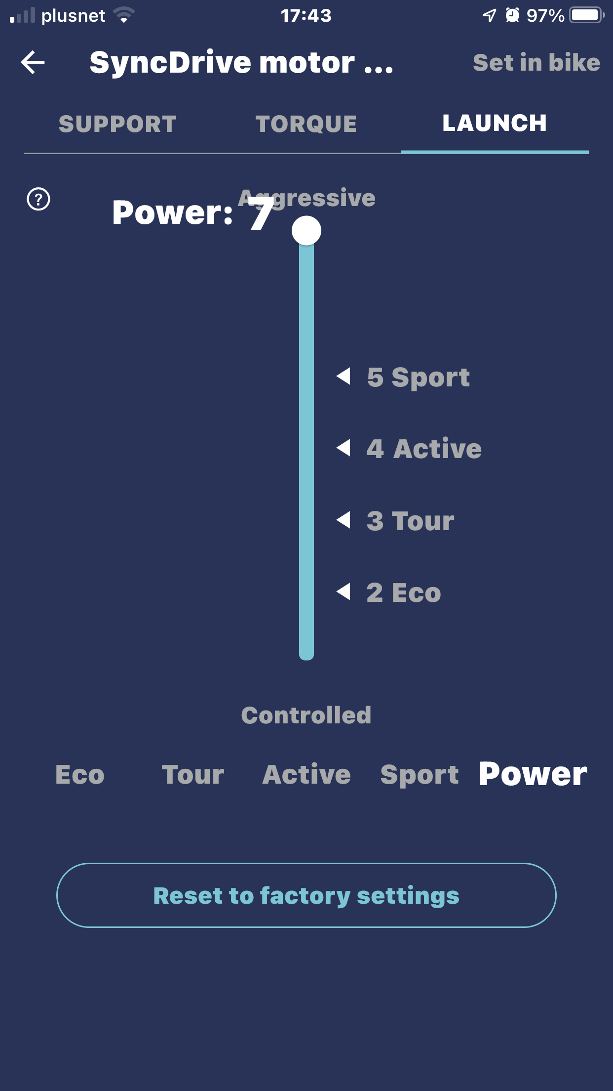

Have you tried the launch tunning? can it help to tone down the engine when you start in a slippery greasy slope?

They have been looking at the new Giant Bikes a lot on EMBN its the New Light Trance not Reign BUT they have the same App and they have been discussing the different settings including the Launch Setting, The Launch if you did not know controls how fast the power builds to the max you have set for the mode I was not sure now I know :). Video here starts at 7:20

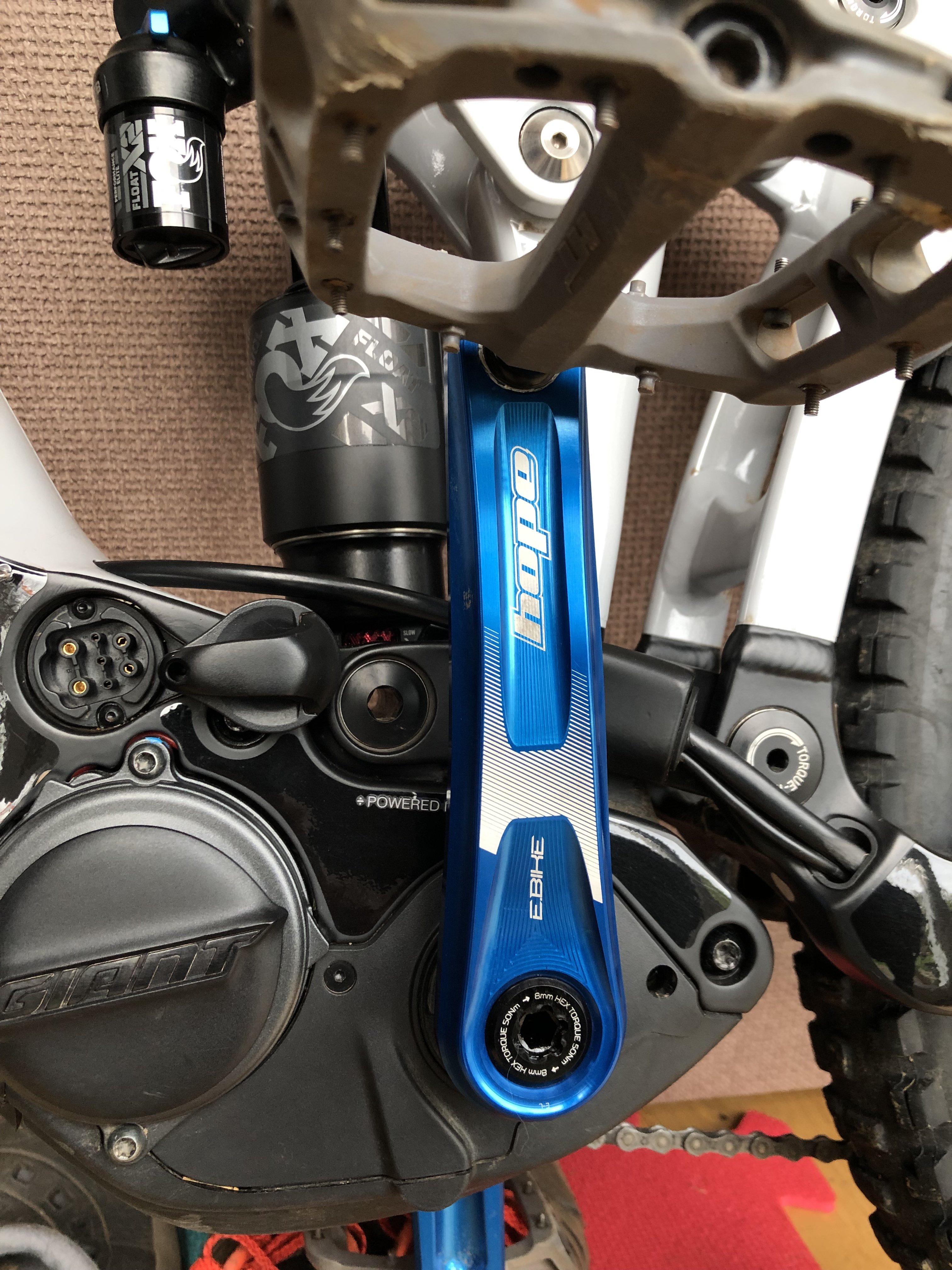

For anyone who was considering going for shorter cranks, I can confirm they totally transform the ride.
Went for Hope 155mm on my medium and absolutely loving them - hardly ever get pedal strikes now. No effect on pedal performance that I could detect.
I have 150mm Mirandas love them
Still running the oem Praxis cranks on mine, but I'm just wondering what is the offset of the Hope cranks that everyone are buying ? Standard ?
