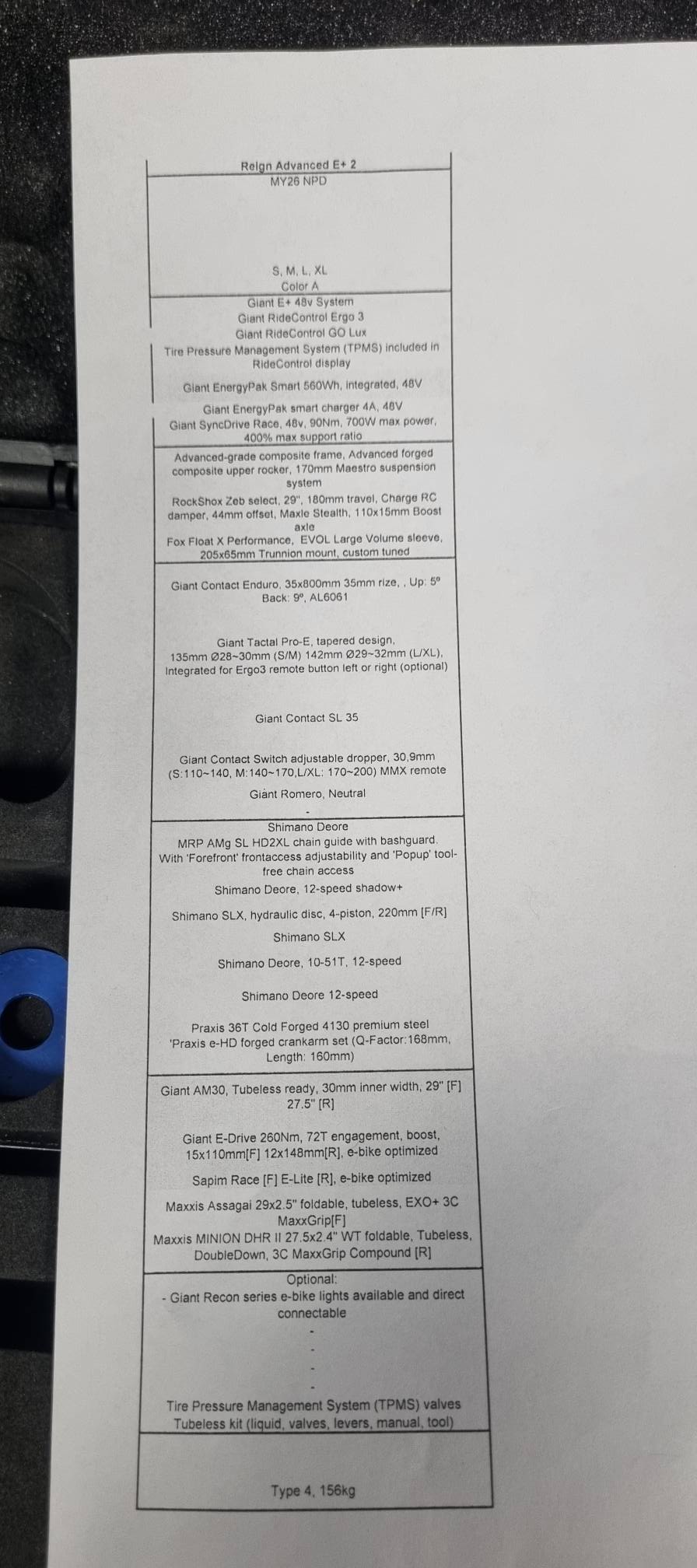

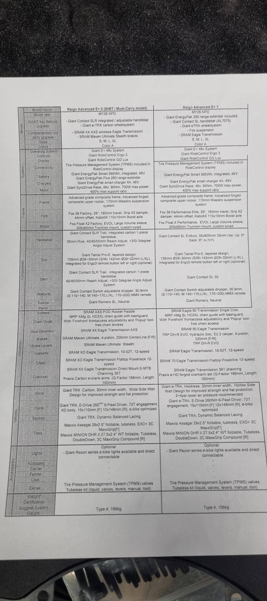

I saw some rumors & spec sheets circulating on FB about the 2026 Reign E+ so I figured out we could start a thread on here to share informations.
Leaked spec sheet below, here's some highlights :
  • New carbon frame available, model is switching to 180mm F / 170mm R
  • New Syncdrive Race motor - 90Nm & 48V system
  • New integrated 560Wh battery + 280Wh extender included
  • New RideControl GO Lux top tube display with integrated TPMS
  • Some models are featuring the new SRAM Eagle 90 T-Type drivetrain (mechanical)
Giant didn't produce any Reign E+ for the 2025 model year so I expect them to release 2026 ahead of their regular model year color refresh schedule.
No motor manufacturer confirmed, but I'm pretty sure this is the new Yamaha PW-Link system as the new system is CAN-Open based making features like integrated TPMS a possibility.

Interesting.
156kg system weight? I am guessing that either means 21kg or 26kg bike weight. Hopefully the former based on it having a 560wh battery.

Just sold my 2022, I had asked the local shop if there was any news from Giant and they said no... The info above might have made me think about waiting.
I havn't been that interested in smaller batteries and extender based systems, but 560Wh + 280Wh is a really appealing set of numbers. We'll have to see the weights they announce and motor specs and tests.
If the geo and overall weight are good, it could be a competitive bike. But I'm worried with gimmicky stuff like the tyre pressure valve, they will try to position themselves as a premium brand, and price themselve out of relevance...
