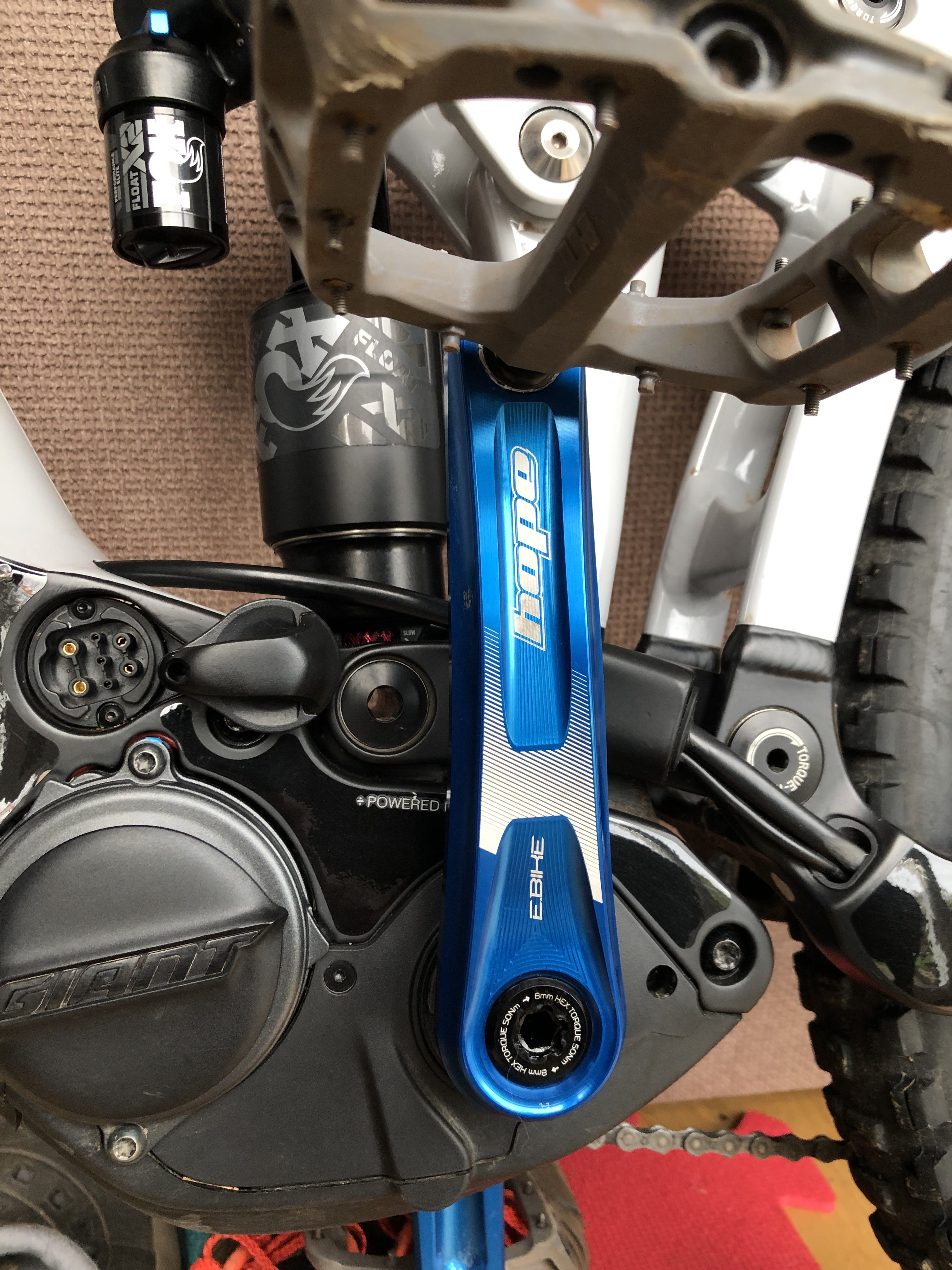

For anyone who was considering going for shorter cranks, I can confirm they totally transform the ride.
Went for Hope 155mm on my medium and absolutely loving them - hardly ever get pedal strikes now. No effect on pedal performance that I could detect.
Are there any other, less expensive choices besides the Hope. I’m having a hard time justifying that number.
