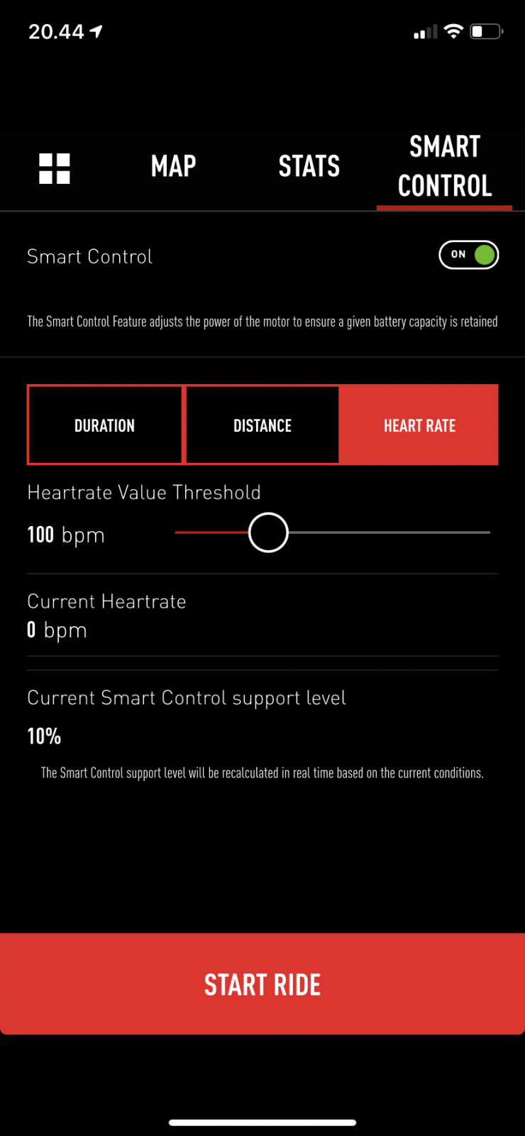

I am looking for the new smart features like elevation to go, but can't find it in my mission control app... Which version should have the new features?
[edit] just checked the appstore again, and there is now version 2.2.0 available with the new features.

Can an Apple Watch be used with Mission Control to drive the HR features? (I’m not sure Blevo can do this either).

How is hr sensor paired?
And wich types are ok? Ant+,ble?
Cant get the hr reading, my heart still beats ?

Someone can compare this feature with the Smart HR of BLEvo? From the setting point of view, I think Mission Control is too simple.. But maybe BLEvo is too complicated.. :cry:
I have been using the combination of smart power and smart HR together and I it is the best for me! I set up smart power to effort that I want to make and use smart HR as a "safety meassure" in case the smart power setting is not enough.It might sound complicated but once I found the setting I like I seldom adjust them.

I'm wondering the same. You'd think they'd have have an instruction manual built into the app or at least a link to one on their website but I can't find anything anywhere.
Hey @Specialized Rider Care, where's an instruction manual for the latest Mission Control?
I figured out how to pair my CooSpo Ant+ Bluetooth HR monitor with Mission Control. After strapping it around my chest it showed up in Settings > My Sensors and I just had to select it. Haven't ridden yet so don't know how well it works.
Just tried this, HR monitor connects to Bluetooth automatically and to Blevo, but not showing in Mission Control. I am closing Belvo and then opening MC to be sure it connects to one of them only :(
While playing around with MC my HRM wouldn’t stay connected, even with Blevo off. What did the trick was “forgetting “ it in Blevo’s configuration then reconnecting in MC. I’ve read that Bluetooth is picky about multiple pairings so maybe that’s it.

So I got my HRM to connect, I had to remove it from bluetooth on my iphone and reboot the phone. Then without pairing it to the phone, go into the app settings/my sensors and it showed up so I could add it.

Got iphone 11 and tried with polar and garmin belts. Cant get connected in mc. Got blevo but no belts connected to it.
Bike is 2020 comp and tcu is 22.b.0
