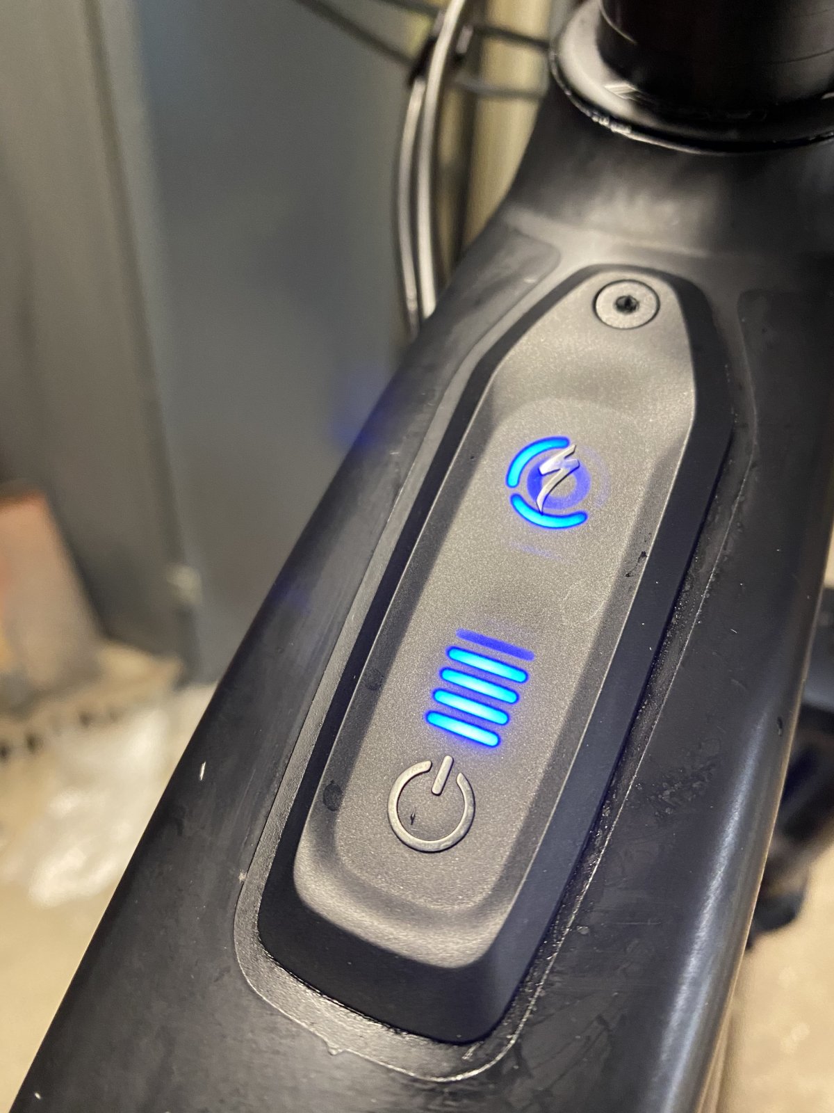

The SL Levo has also green LED's in the TCU... Is that a new TCU, or could this also be done on the "normal" Levo? If so, the the TURBO mode could maybe displayed with different color.

Green in sl is for extra battery.

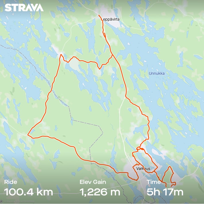

Imo the new HR feature works great.
Did today 100km ride here in Finland. Weather was -3’c, normal winter condition with ice and snow. Rode with spike tires. There was 40% battery left when I got home:p
Set the HR treshold at 150bpm seems to work for me. Imo this hr system works smoother than blevo and is simple af to use, just set your treshold hr and your good to go.
One thing i do want to add it:
Option to set the lowest amount of power that system gives you when you are below the target hr.
