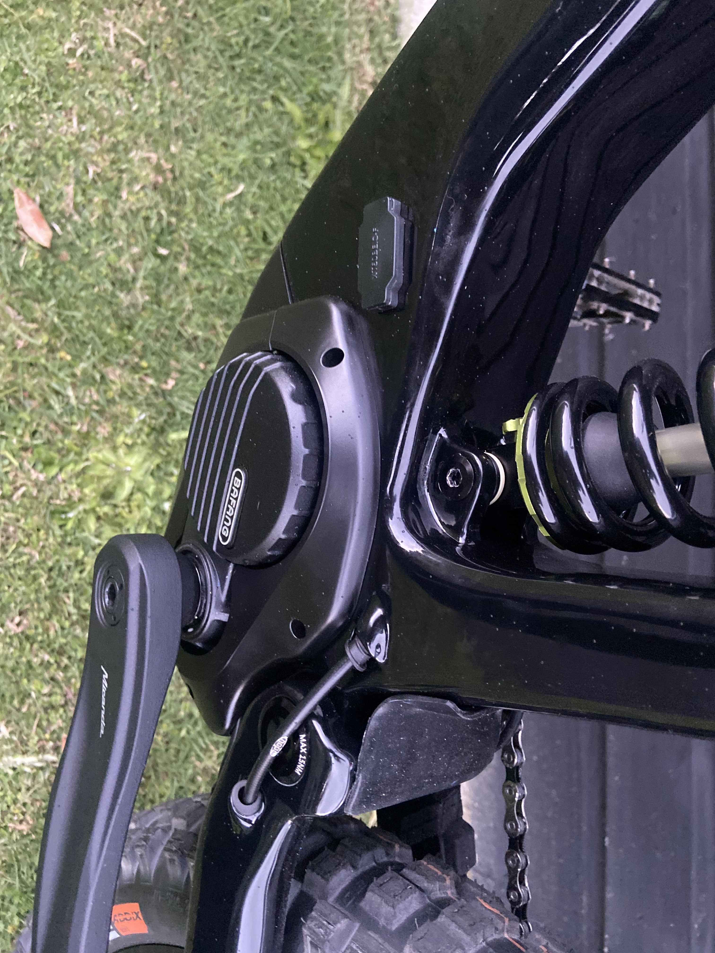

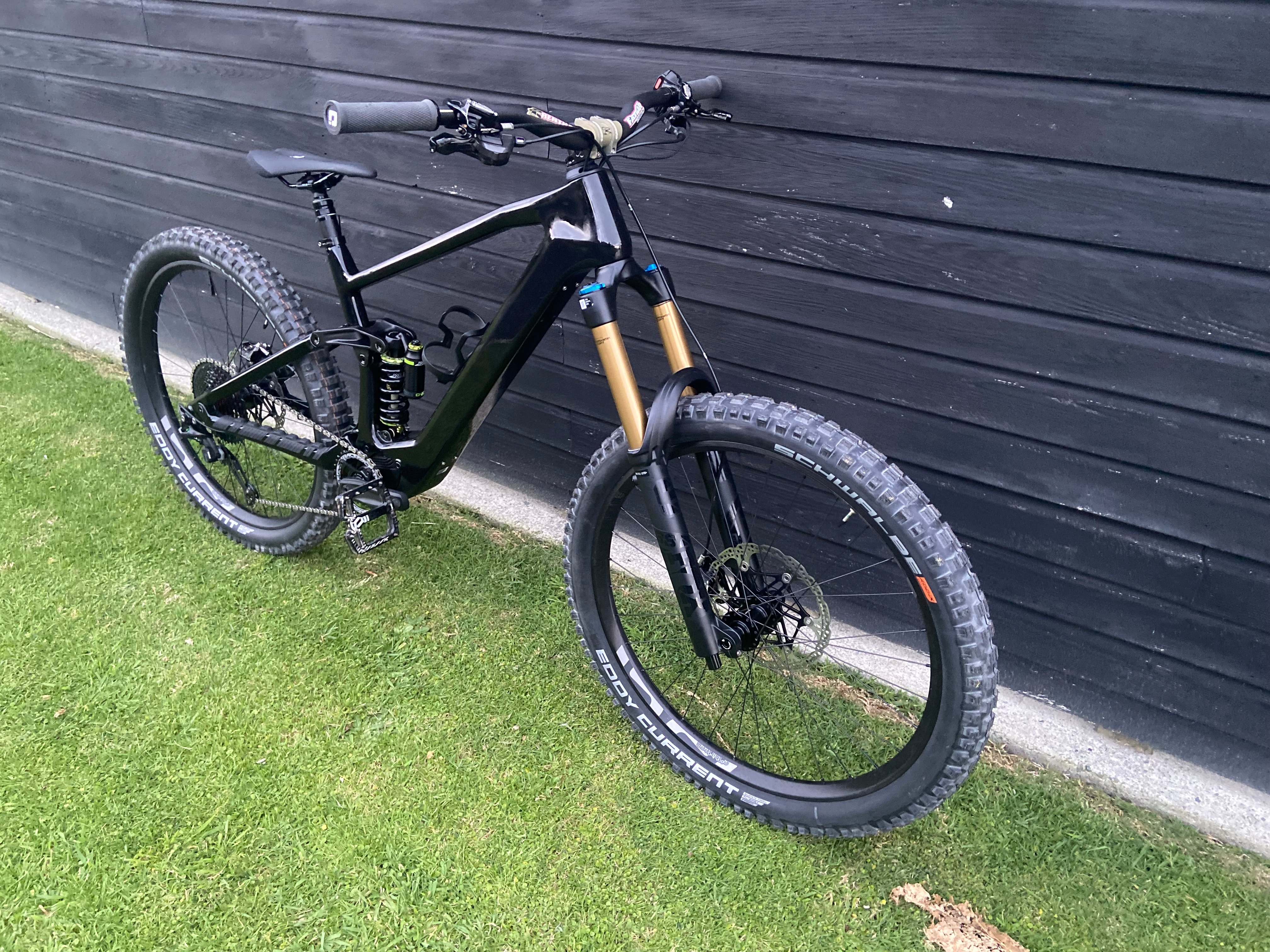

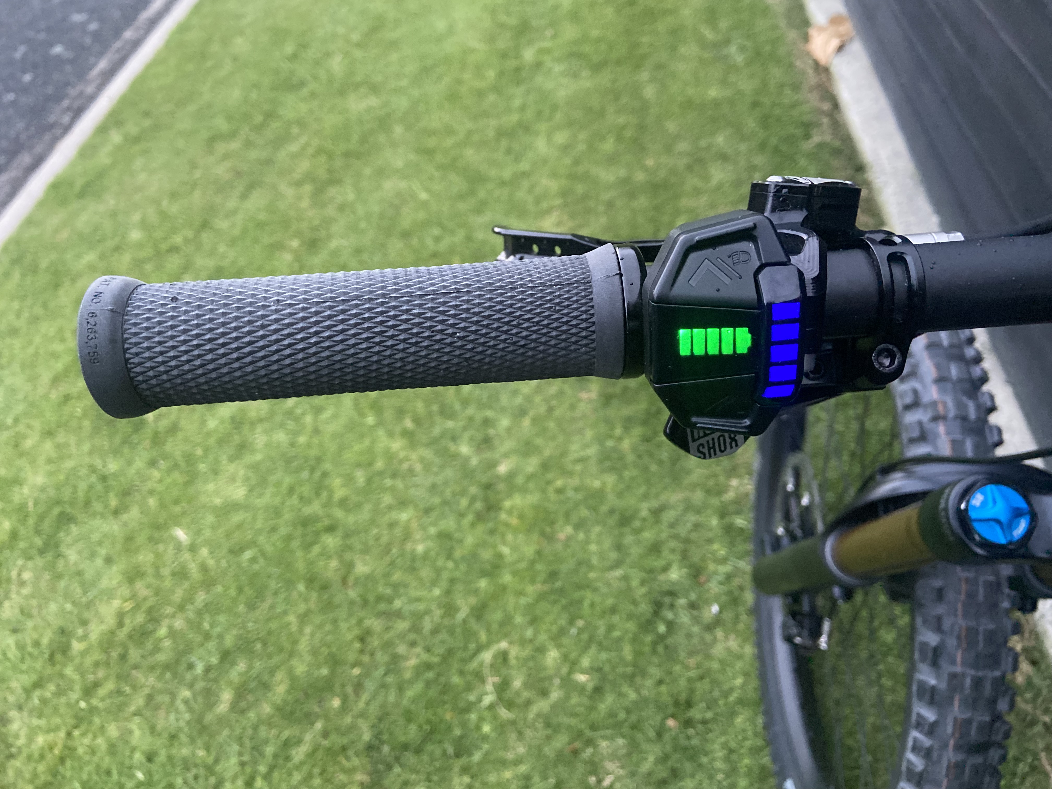

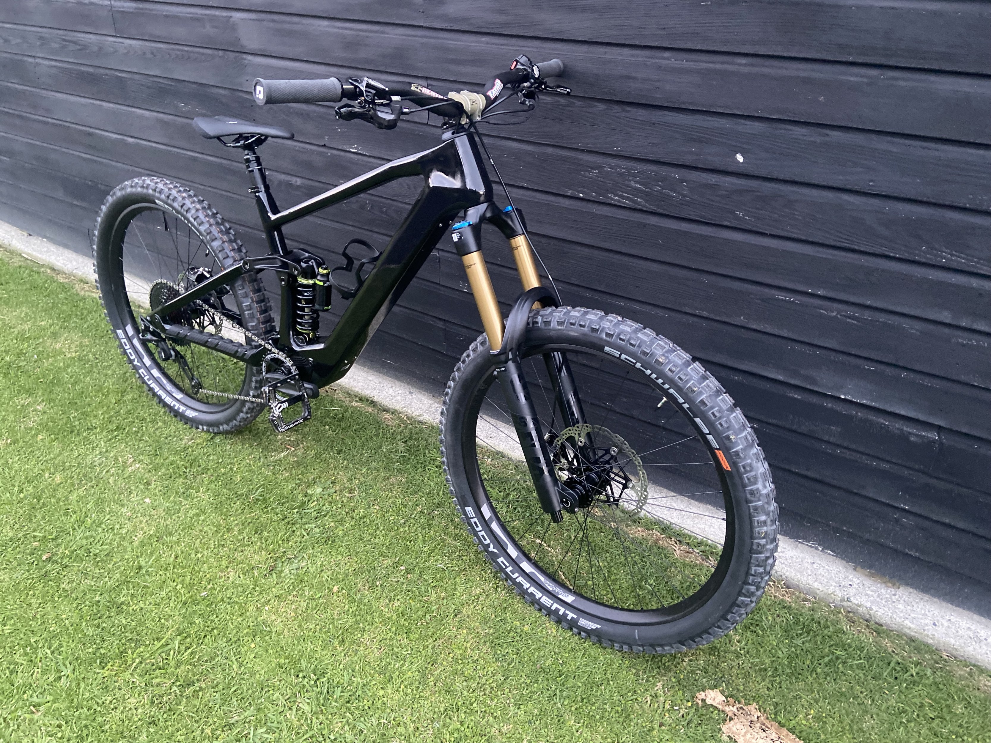

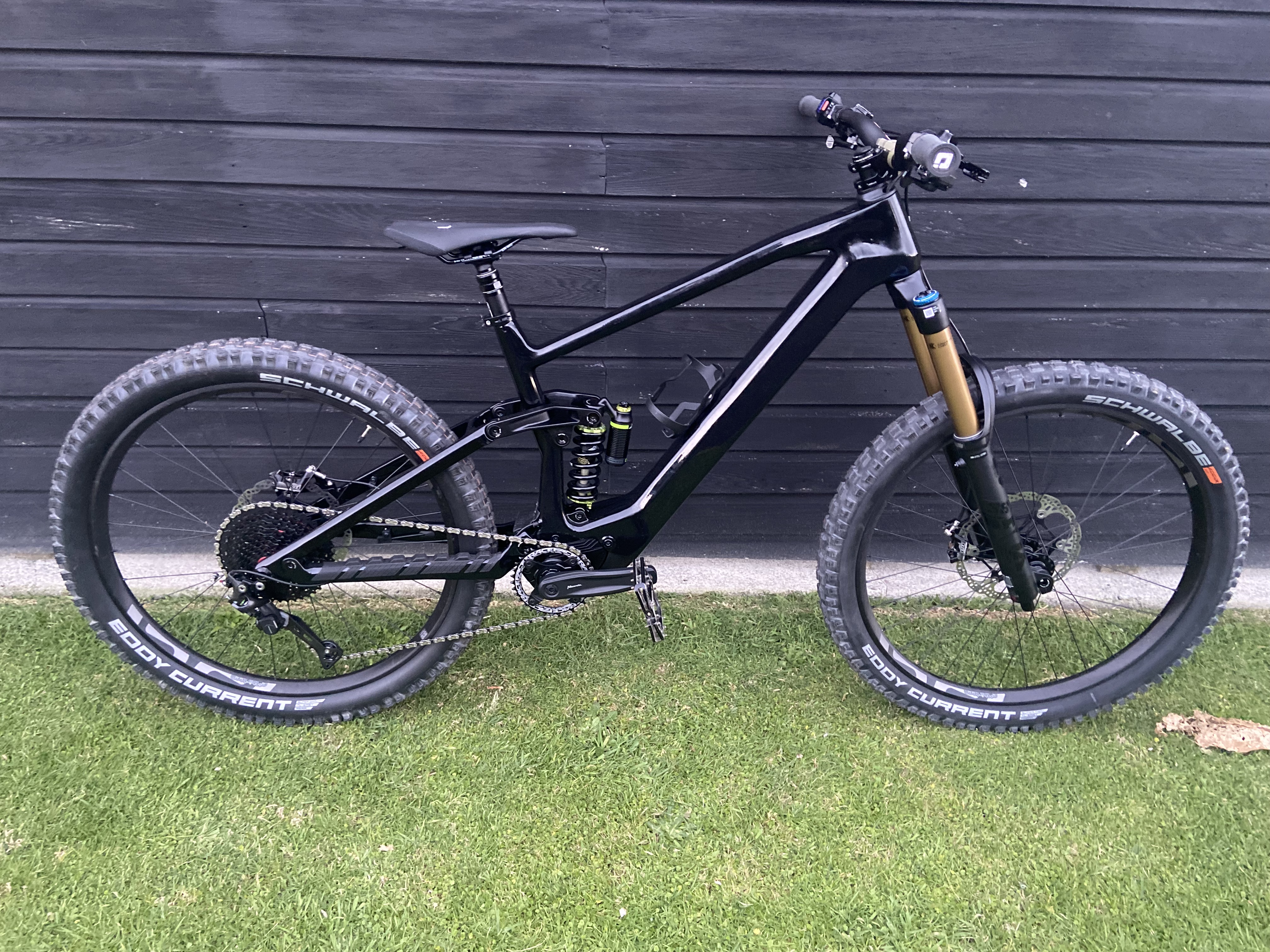

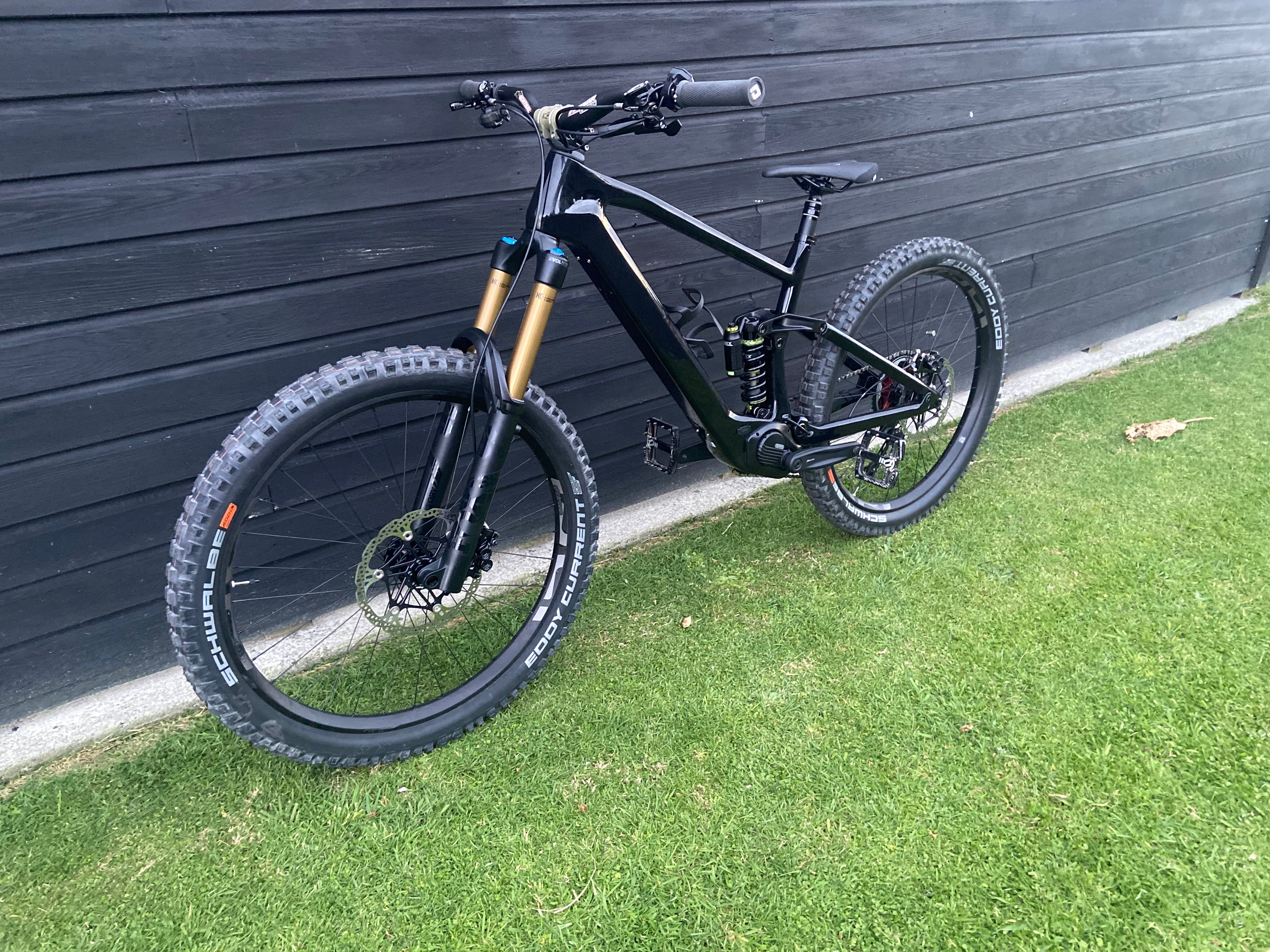

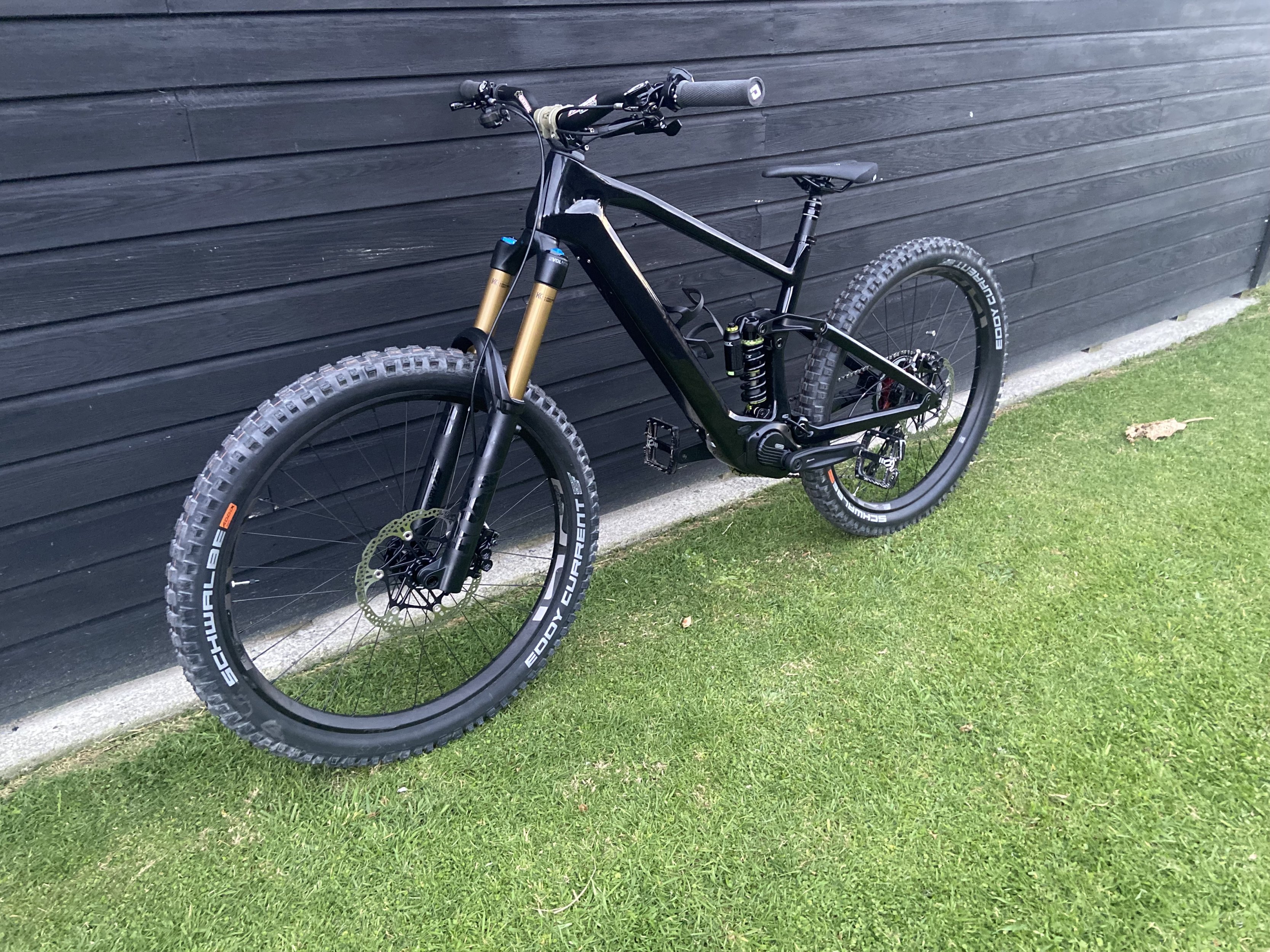

Finish my build, pretty happy with the frame and motor, good quality.
2E3F1484-C147-4097-AA84-4D868C717CAF.jpeg 5C8EF168-7B48-46DA-BFDF-3E1608D2C0CF.jpeg 7DBE2CB2-D4EE-4D12-9102-A3CE44FBF893.jpeg D43A108D-E749-46F1-8D28-EE7A928B49EC.jpeg 59F2C203-F6F1-4E09-AF01-9E134D6A3390.jpeg 4735CA99-573F-45C1-B7B7-56A260A3A98C.jpeg

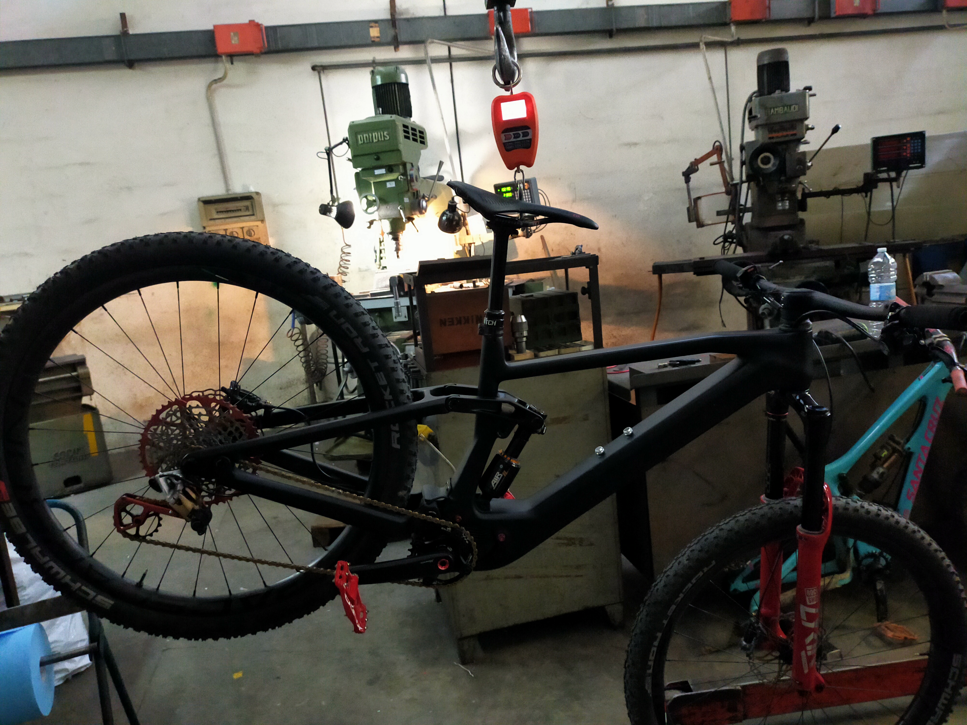

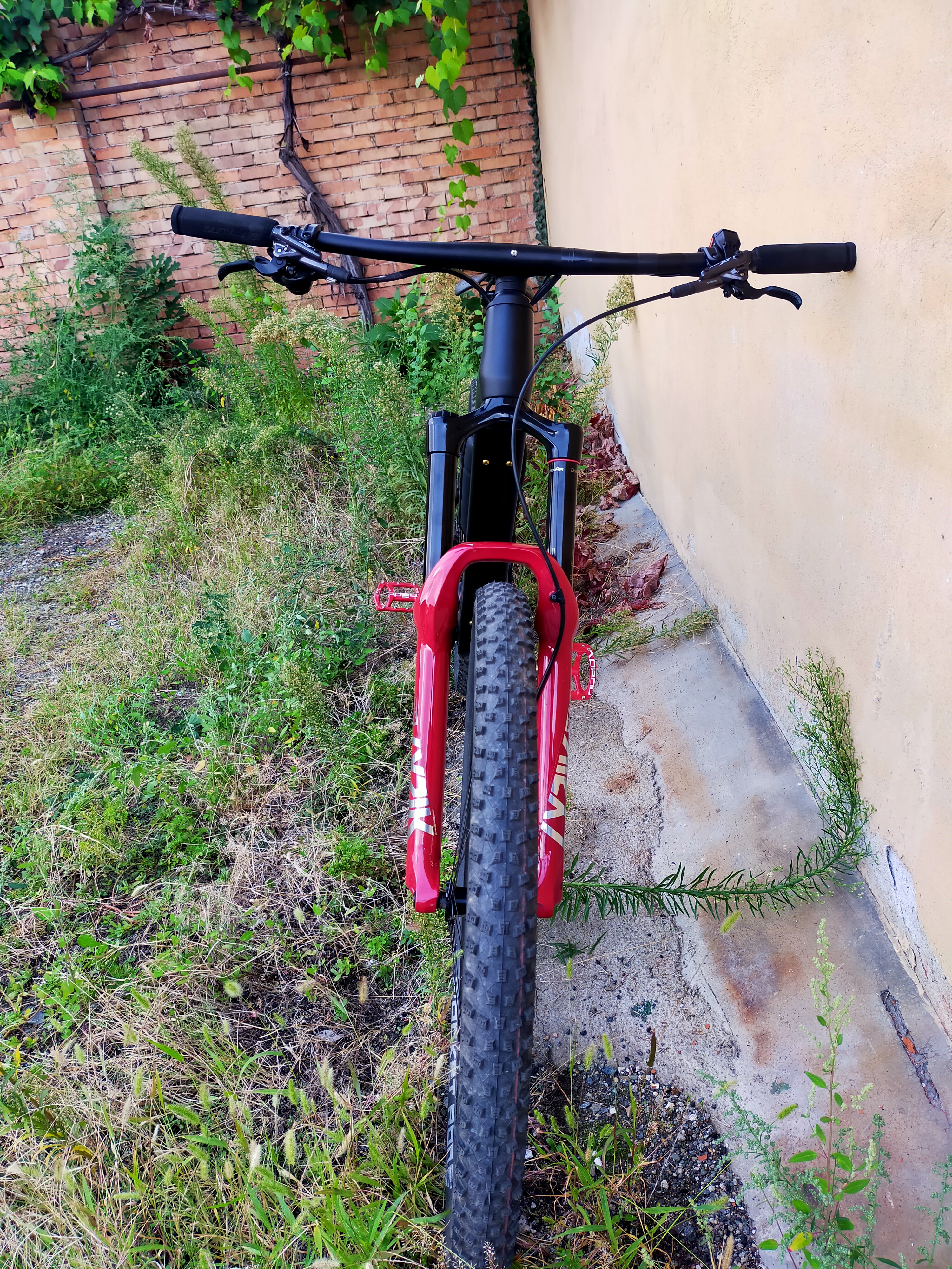

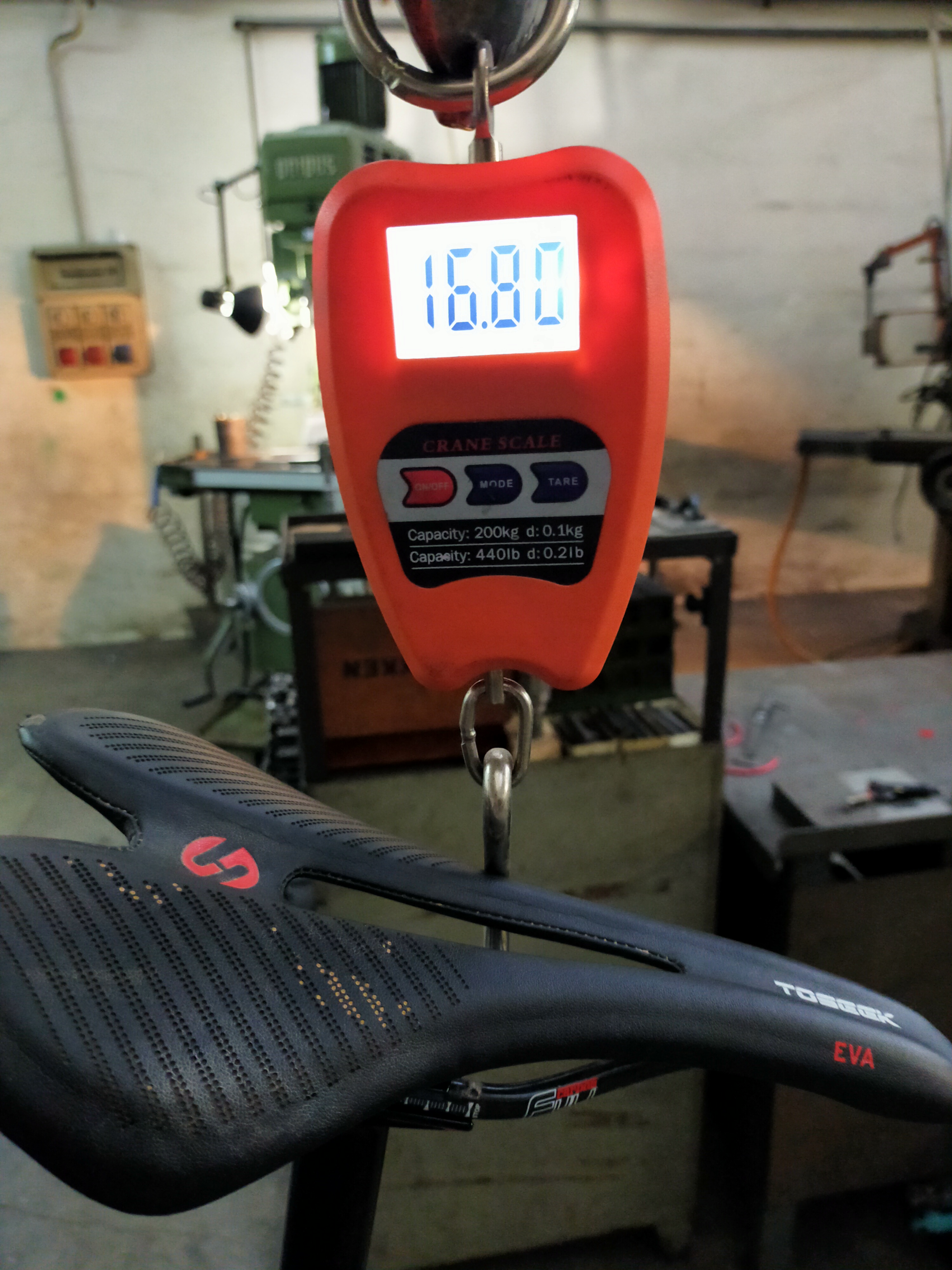

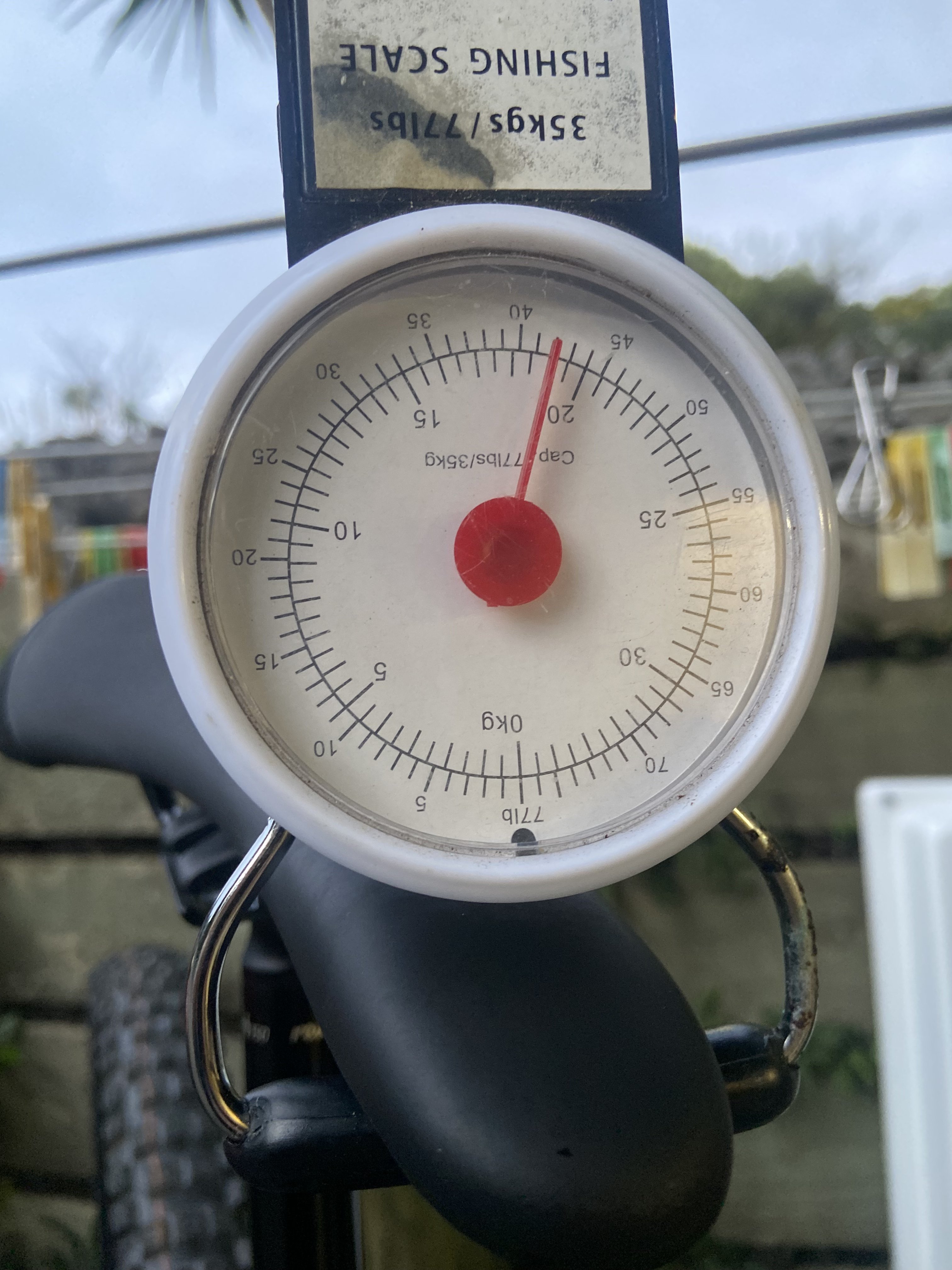

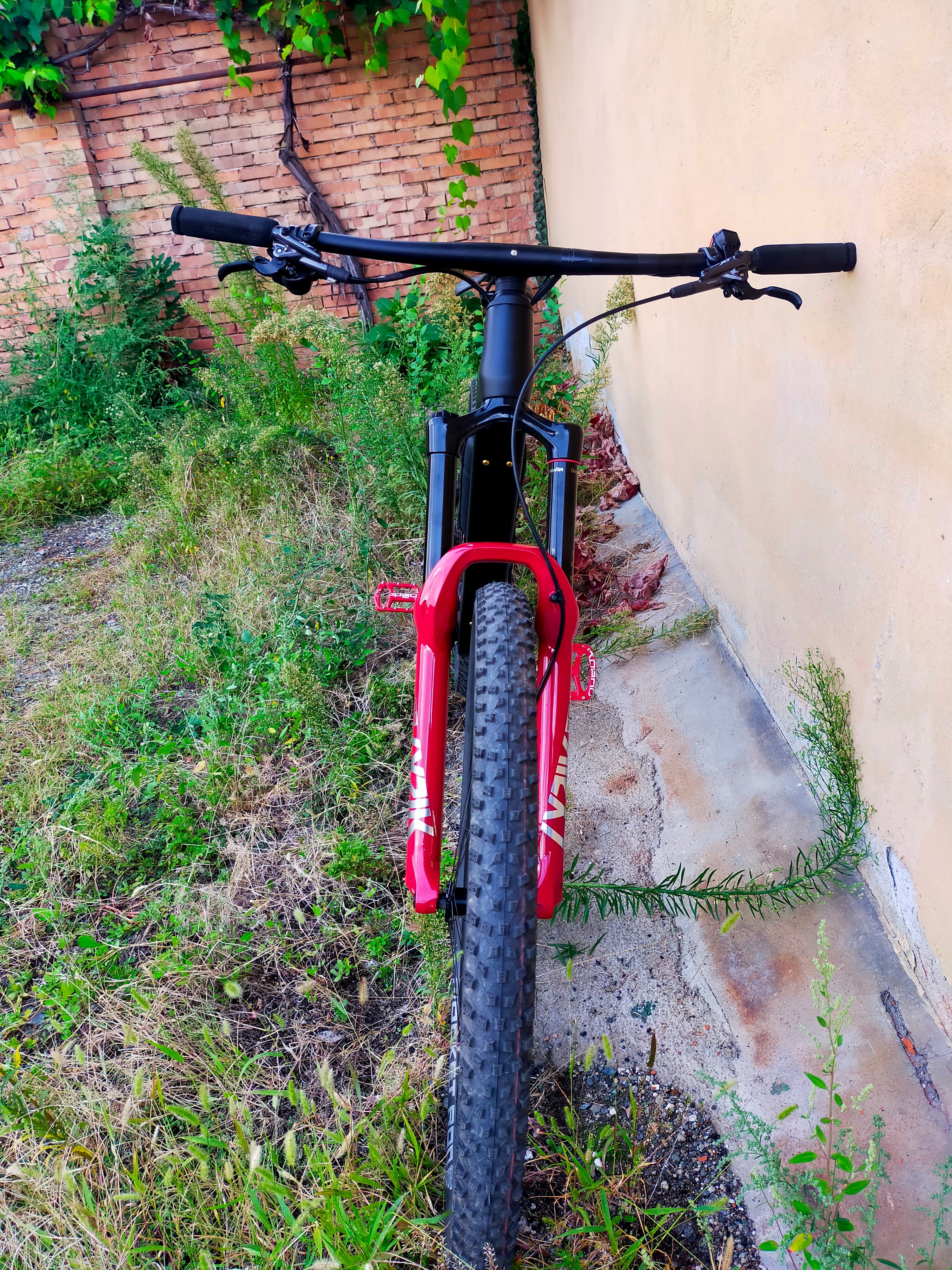

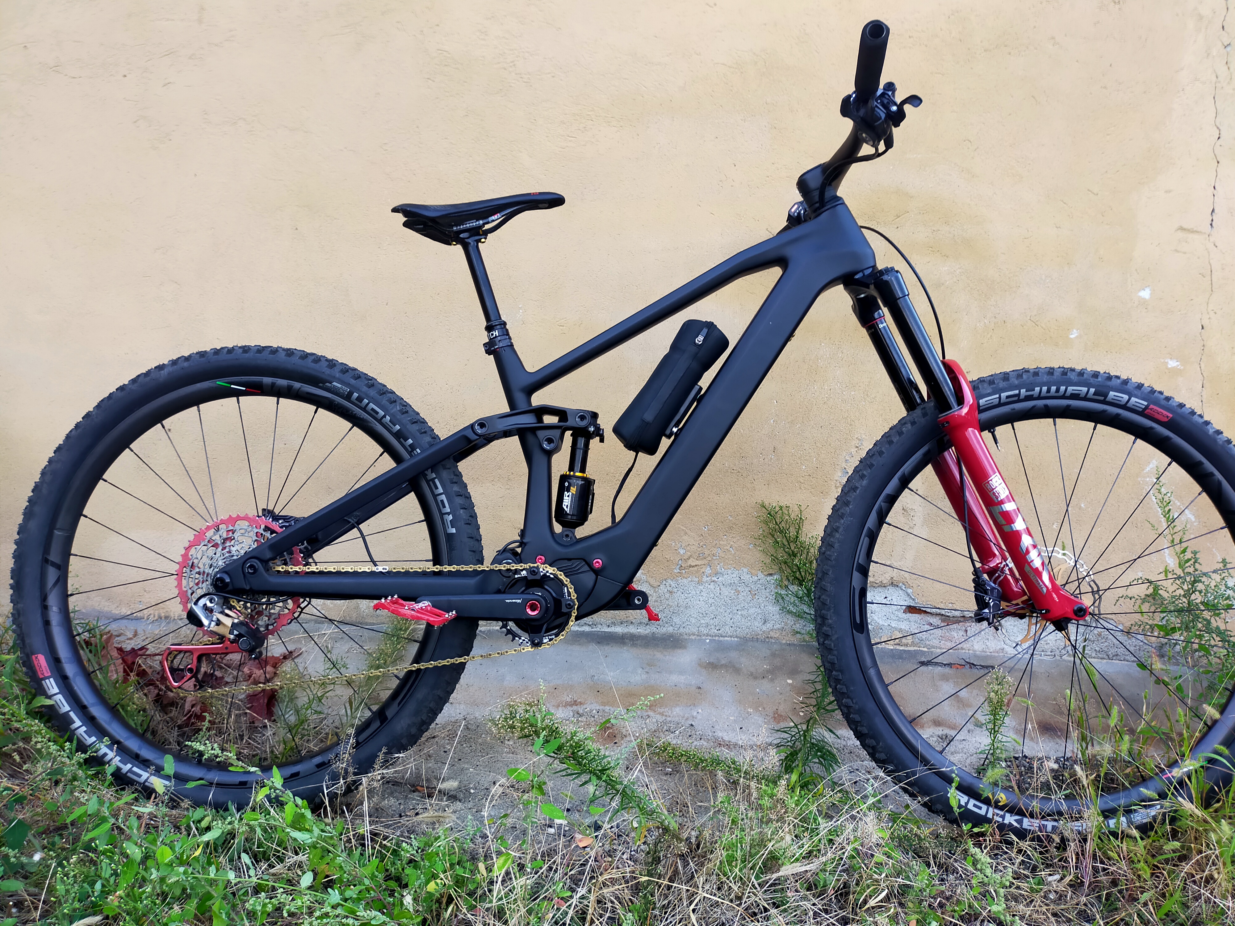

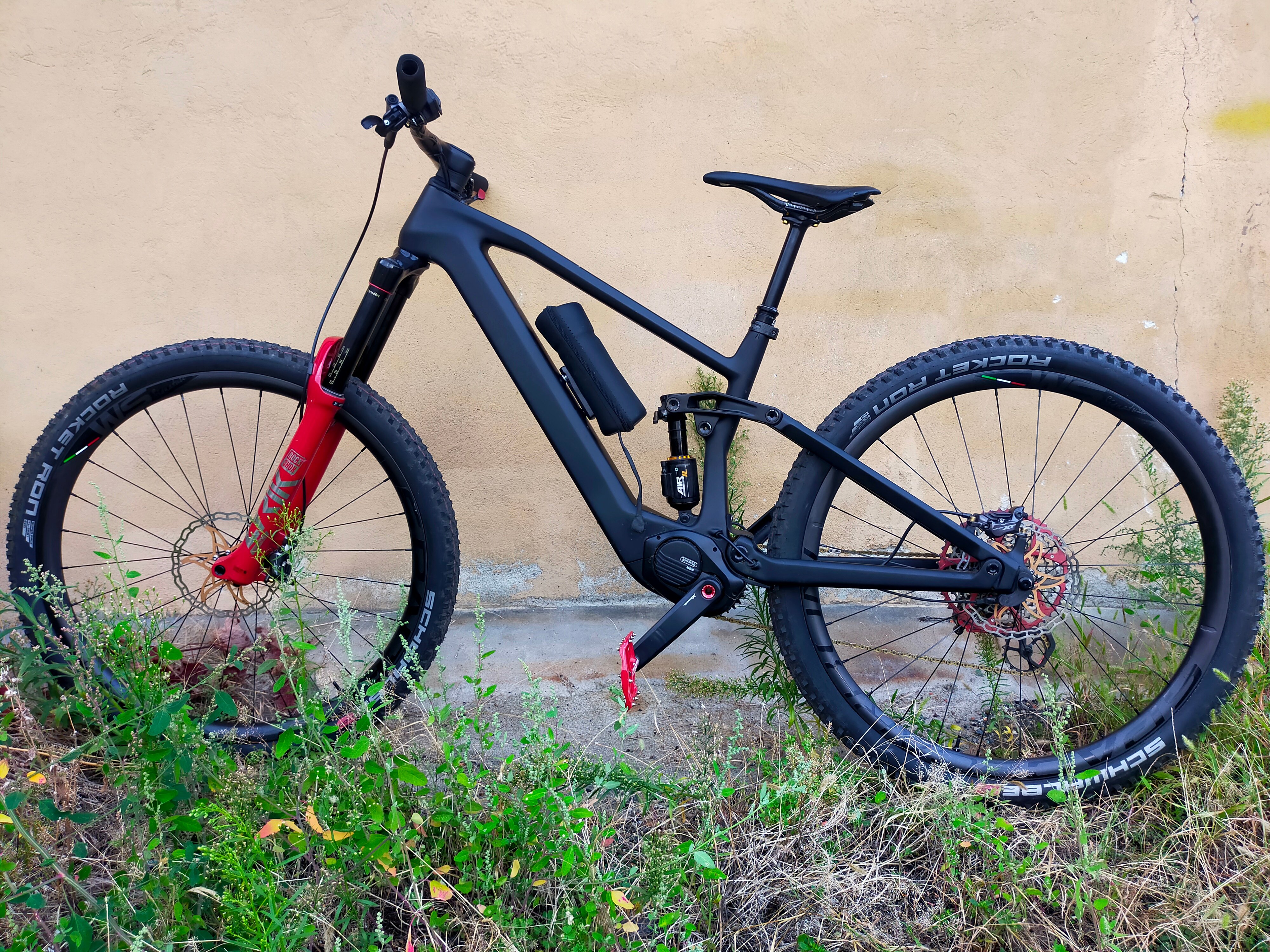

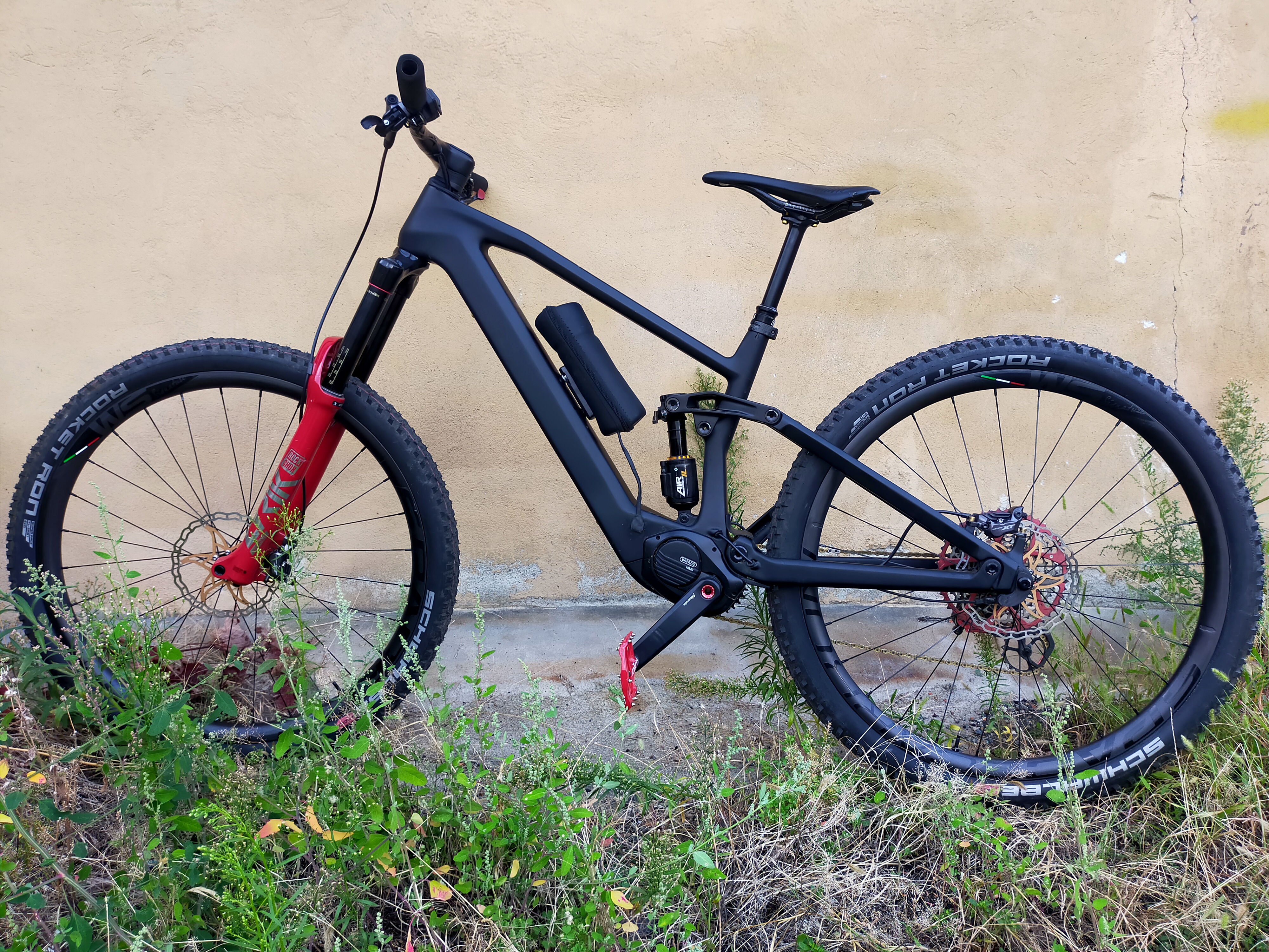

I would like to introduce the mtb I made for my wife
Normal version: 540 Wh battery 16.80 kg total weight with pedals
Long journey version: 900 Wh battery 18,45 Kg total weight with pedals
View attachment 124822 View attachment 124823 View attachment 124824
Impressive weight! Would U share battery configuration and how connect the extender??
Yes DIY internal battery 10s3p Samsung INR21700-50E 540 Wh + external 10s2p Samsung INR21700-50E 360 Wh
Please more details on the battery(case if any and how you attached it to the frame and probably a list of all the parts you used.Nice build!

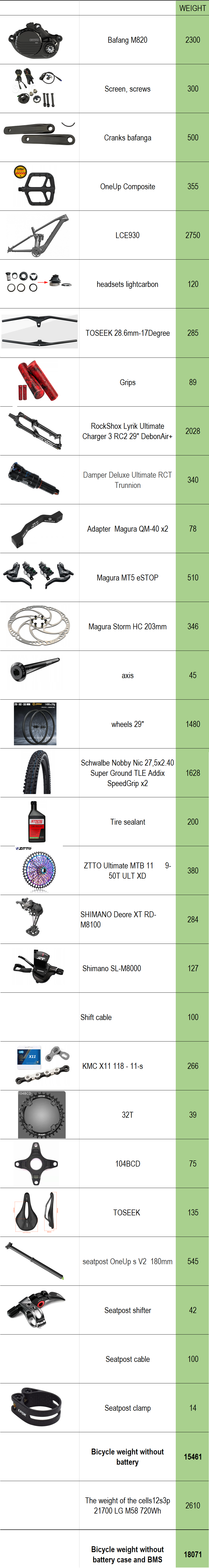

Could you please provide a parts list? The weight of your bike is incredibly low. I was looking for light parts for construction, but I have 1 kg more weight than your bike.
I think he has carbon crank arms!
Maybe lighter rotors as well.
The weight for the Lyric ultimate seems high also, is it a 160mm ?
