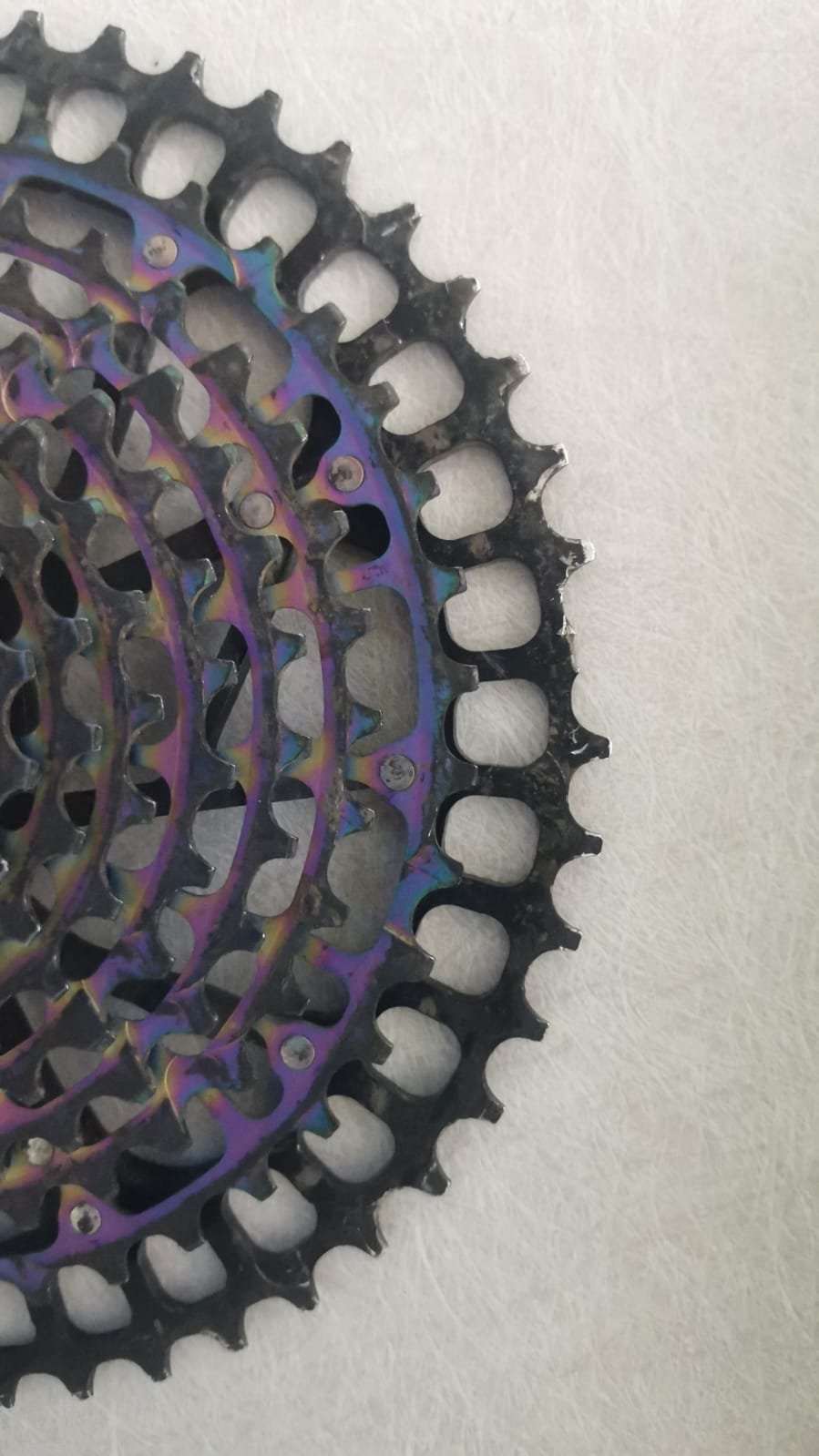

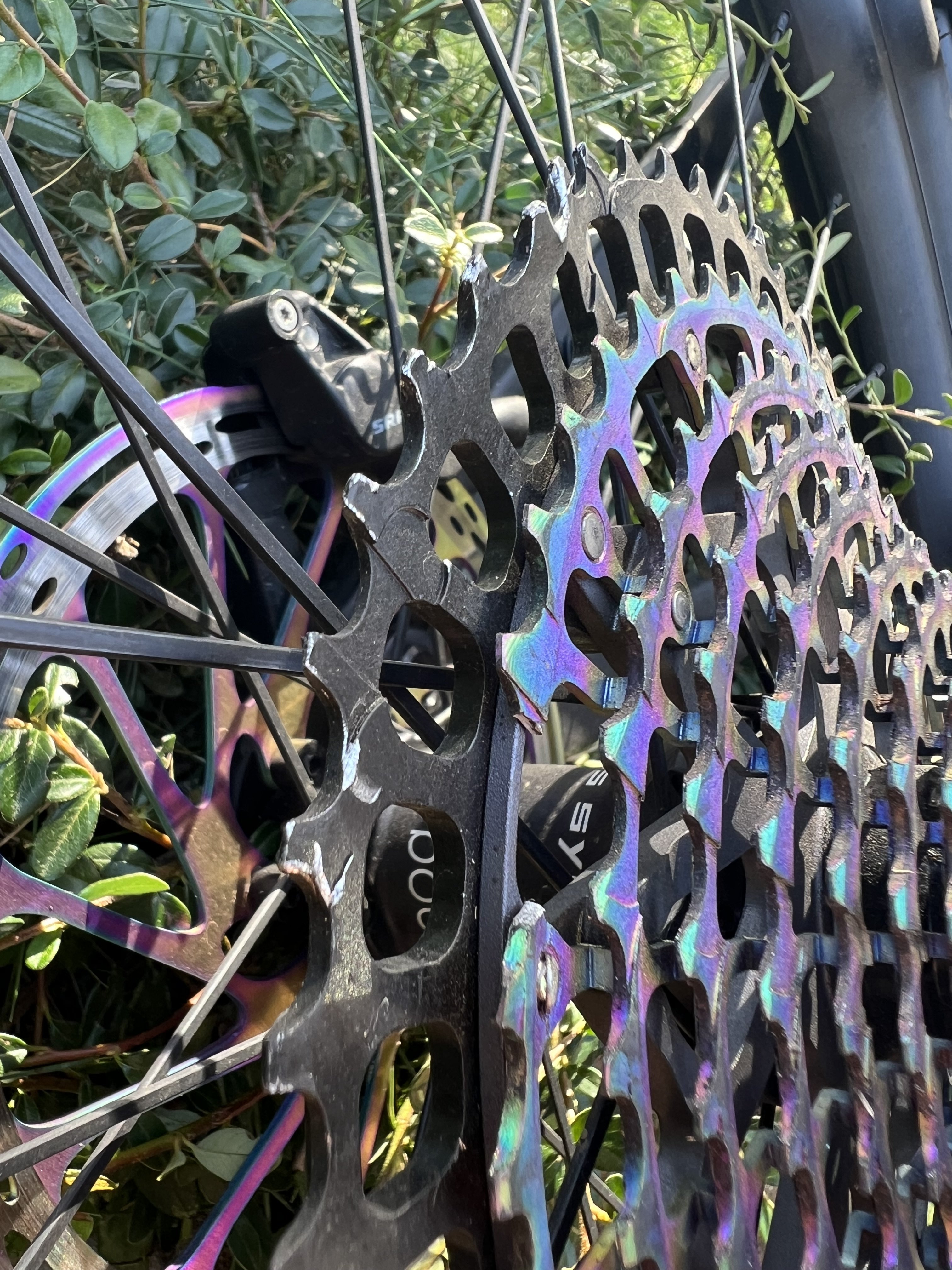

bad luck. :( Which cassete is it?
Ztto pro, Aliexpress cassette :D same for the chain…
I’m switching to xx for the chain and gx for the cassette, it should be a bit heavier but that shouldn’t break that easily
I recommend Sun Race all steel not aluminium. KMC chain.
I have stuck with 11 speed because the cassettes are much cheaper.
Aluminium cassettes will break even Sram, my friends Trek Rail 9 cassette didn’t last long.
Good choice, imo. As far as chains for eagle drivetrain go, X01 and XX1 are much more durable, than GX and below. X01 is the one I go for on my non-e mtb.
Yup, this is also the reason I went with shimano 11 speed linkglide stuff. Cassets are a bit of a boat anchor, but they are all steel, with wider tooth base profile, to increase longevity and wear resistance. Also, because it is 11 speed system, it should be a little less finicky to setup. I am hoping for a somewhat set and forget system, apart from regular chain lubing.
Unfortunately, axs is not compatible with 11 speed, otherwise, I would have switched!
You broke it when switching. I have exactly the same cassette and I broke the star on the last aluminum gear. I have set up axs to shift one gear at a time.
My axs only switch 1 gear at a time, it was a difficult climb and I think I put too much power and shift at the same time.

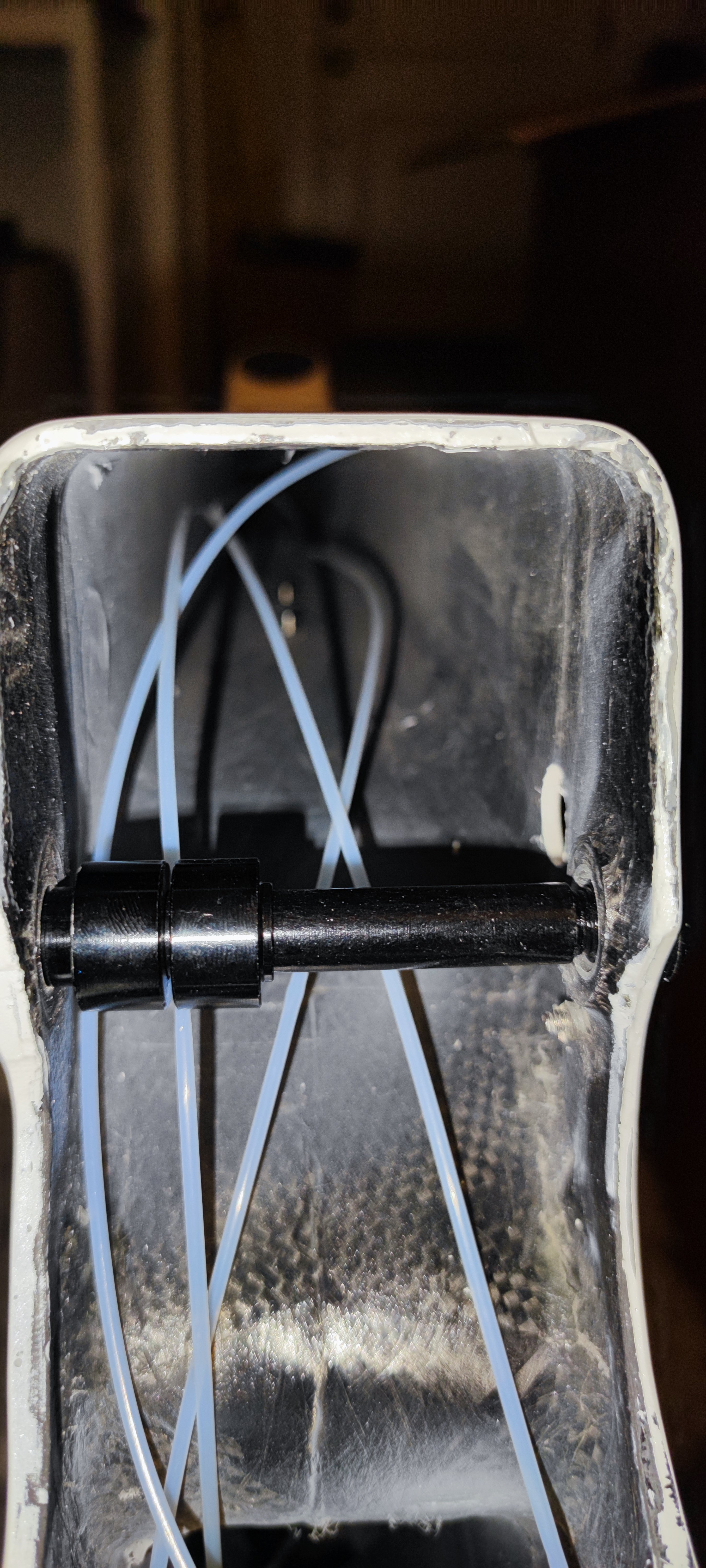

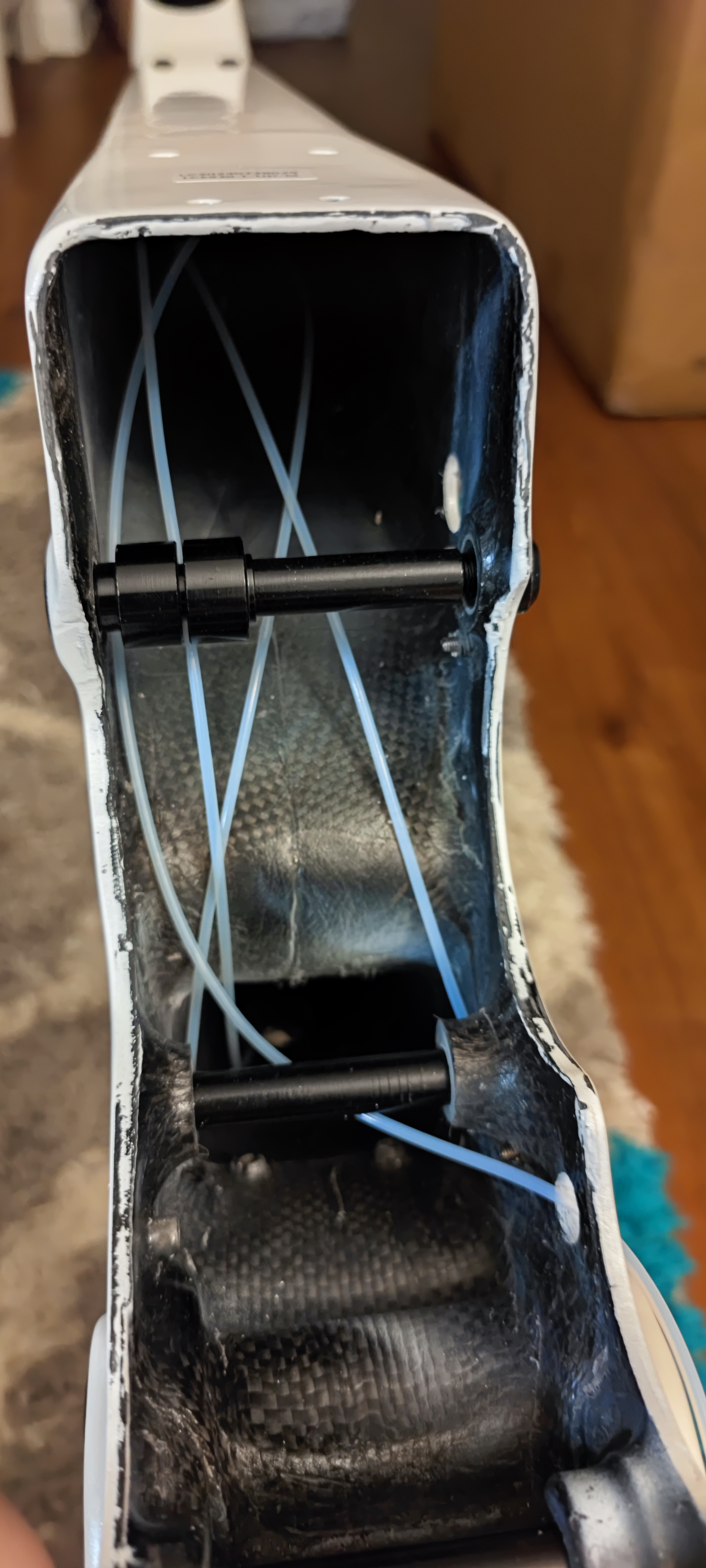

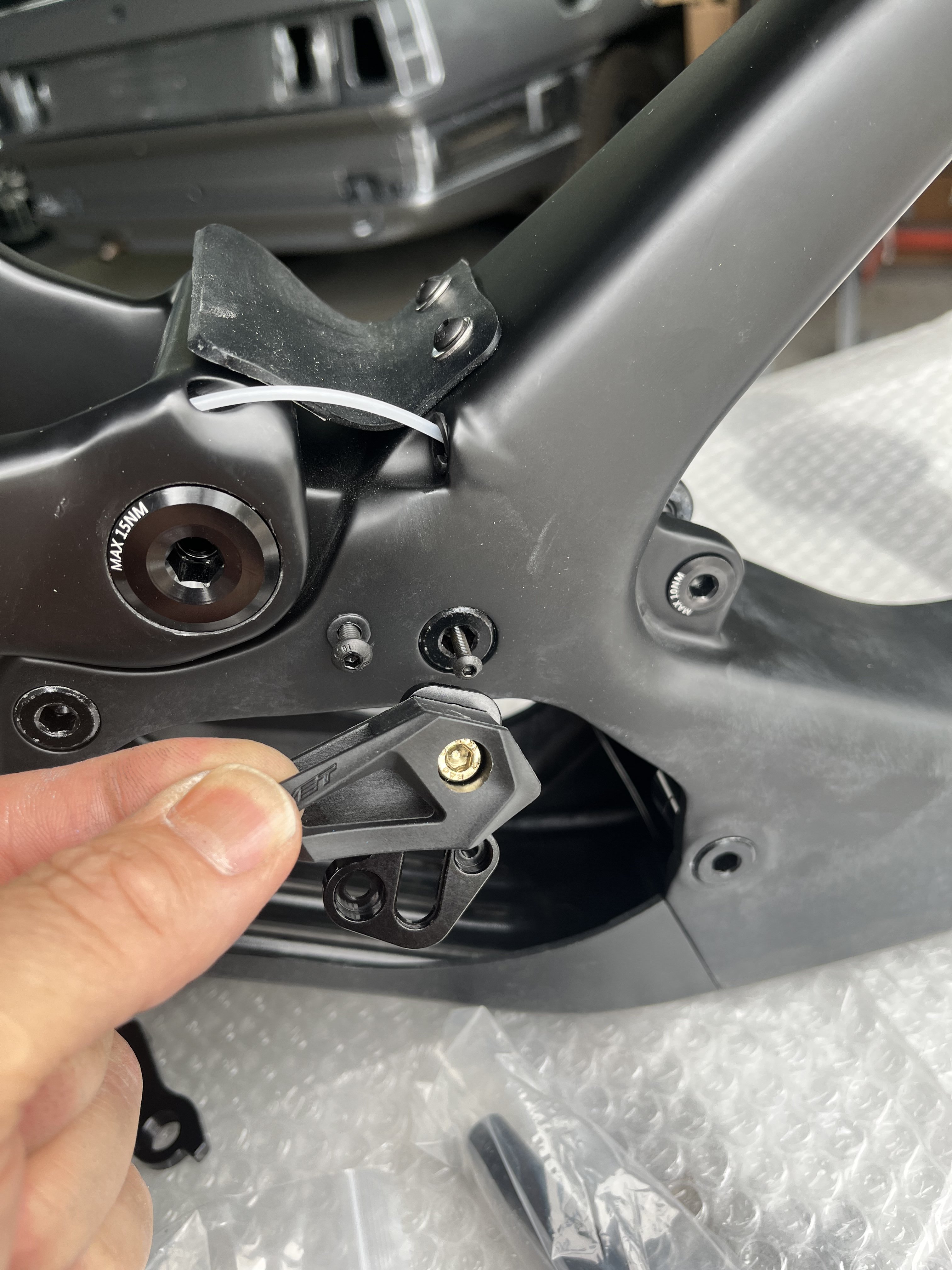

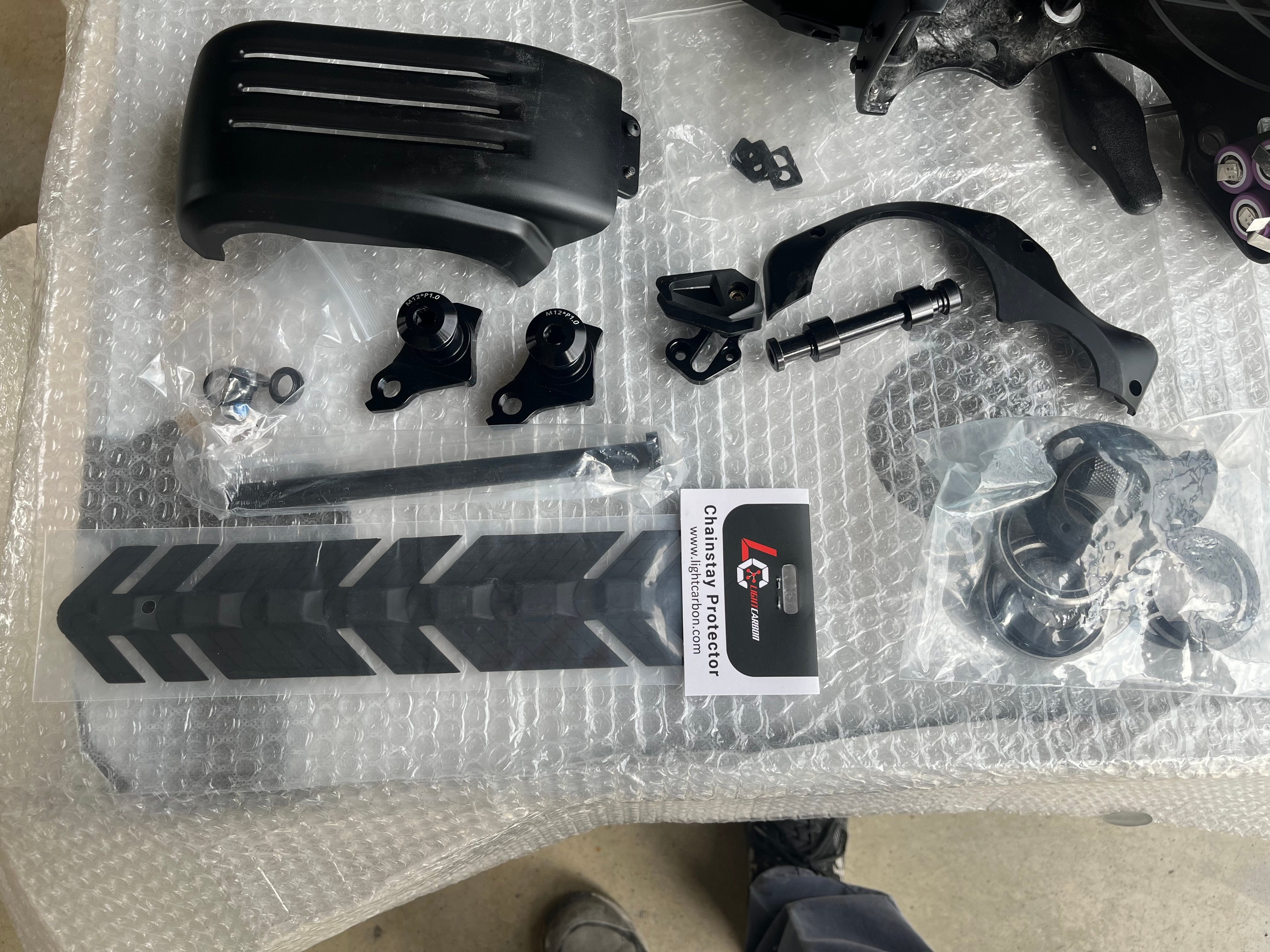

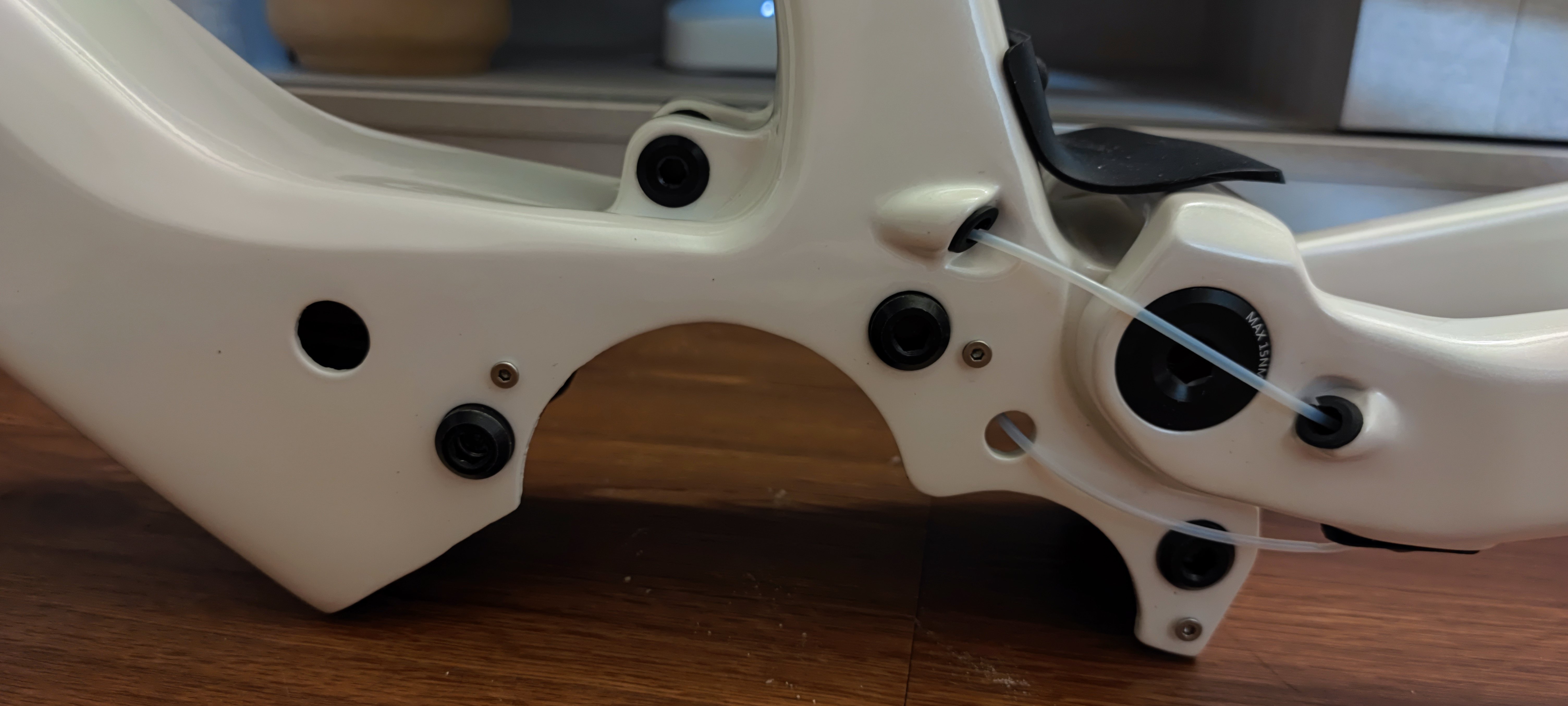

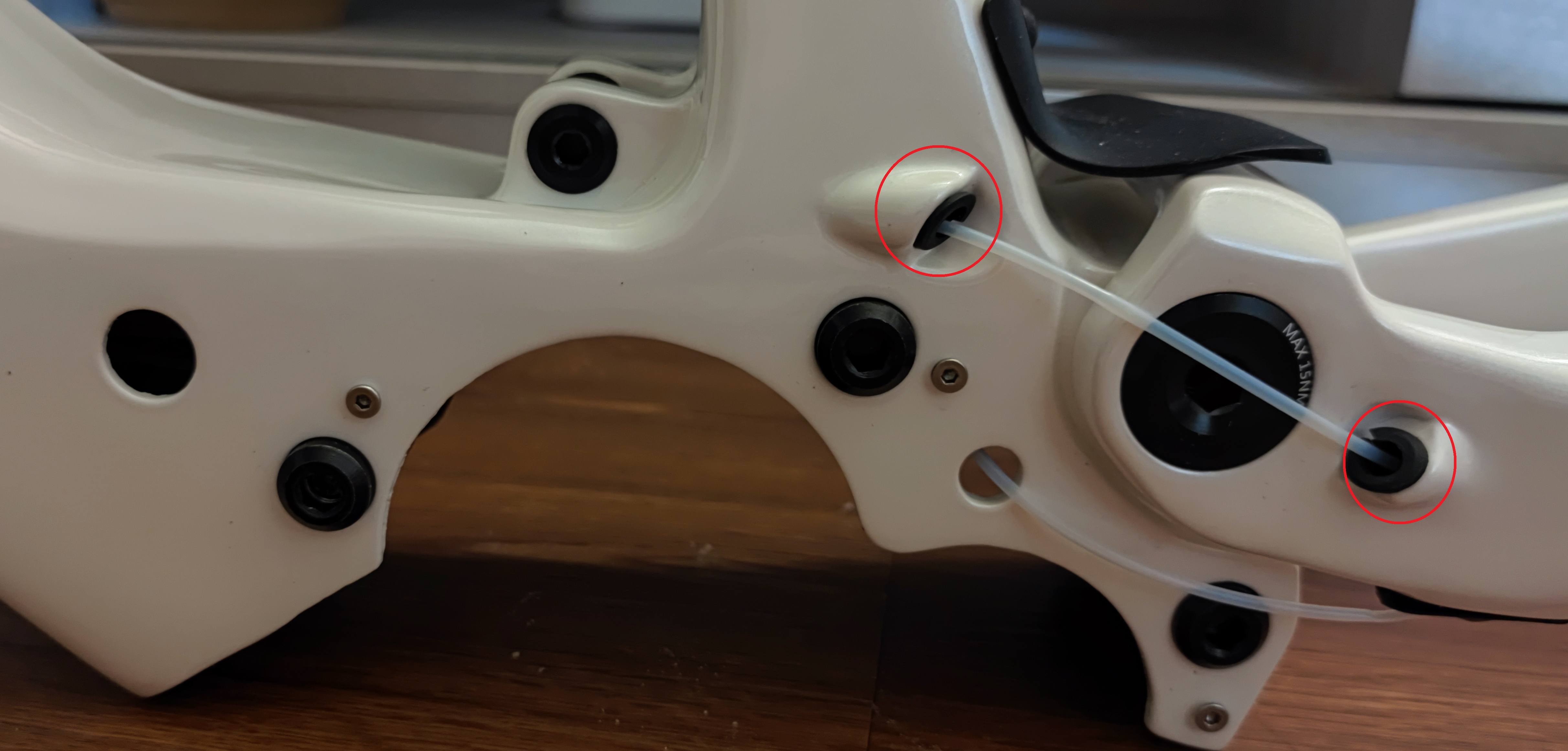

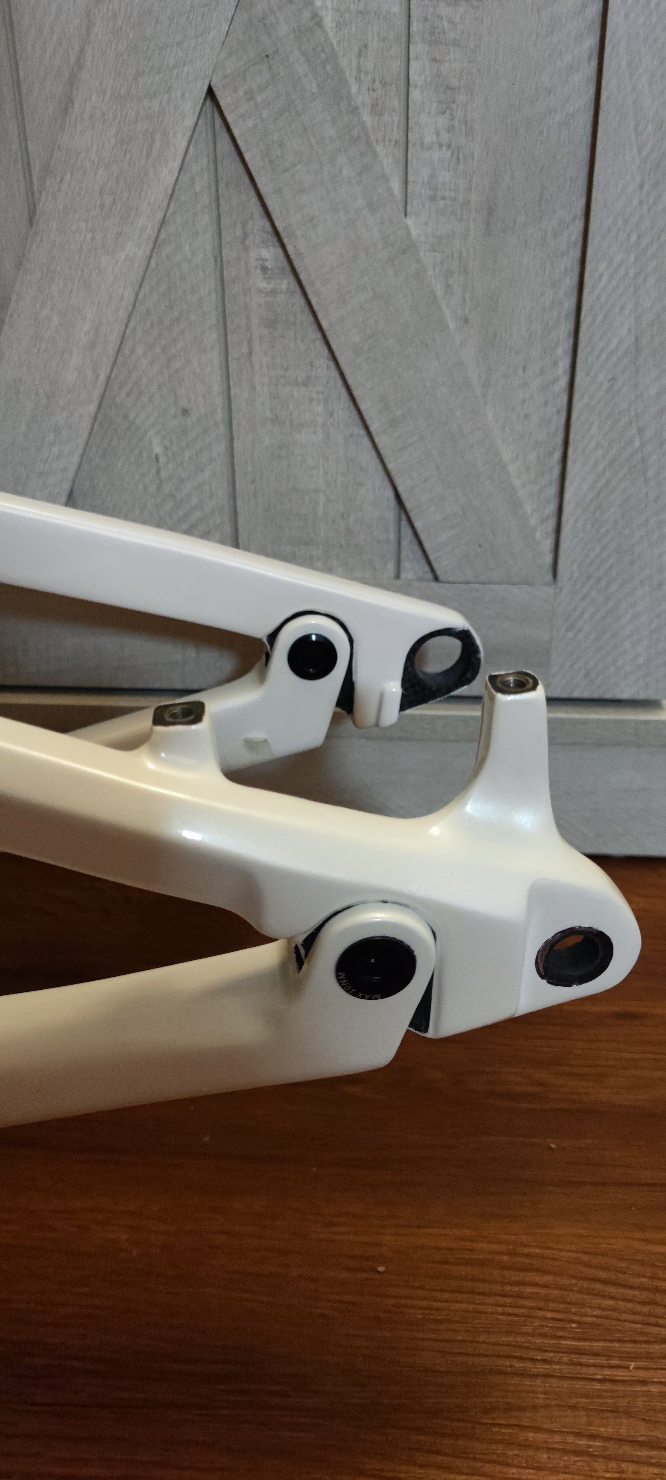

Looks verry nice! :)
But my frame didn't come with these gromets:
Can you also check the other side? do you have them also for the shifter cable?
Did anybody else receive these?
The other side has 1 grommet for the shifter cable where it exits the main frame. Mine has no grommets for the shifter cable in the rear triangle.

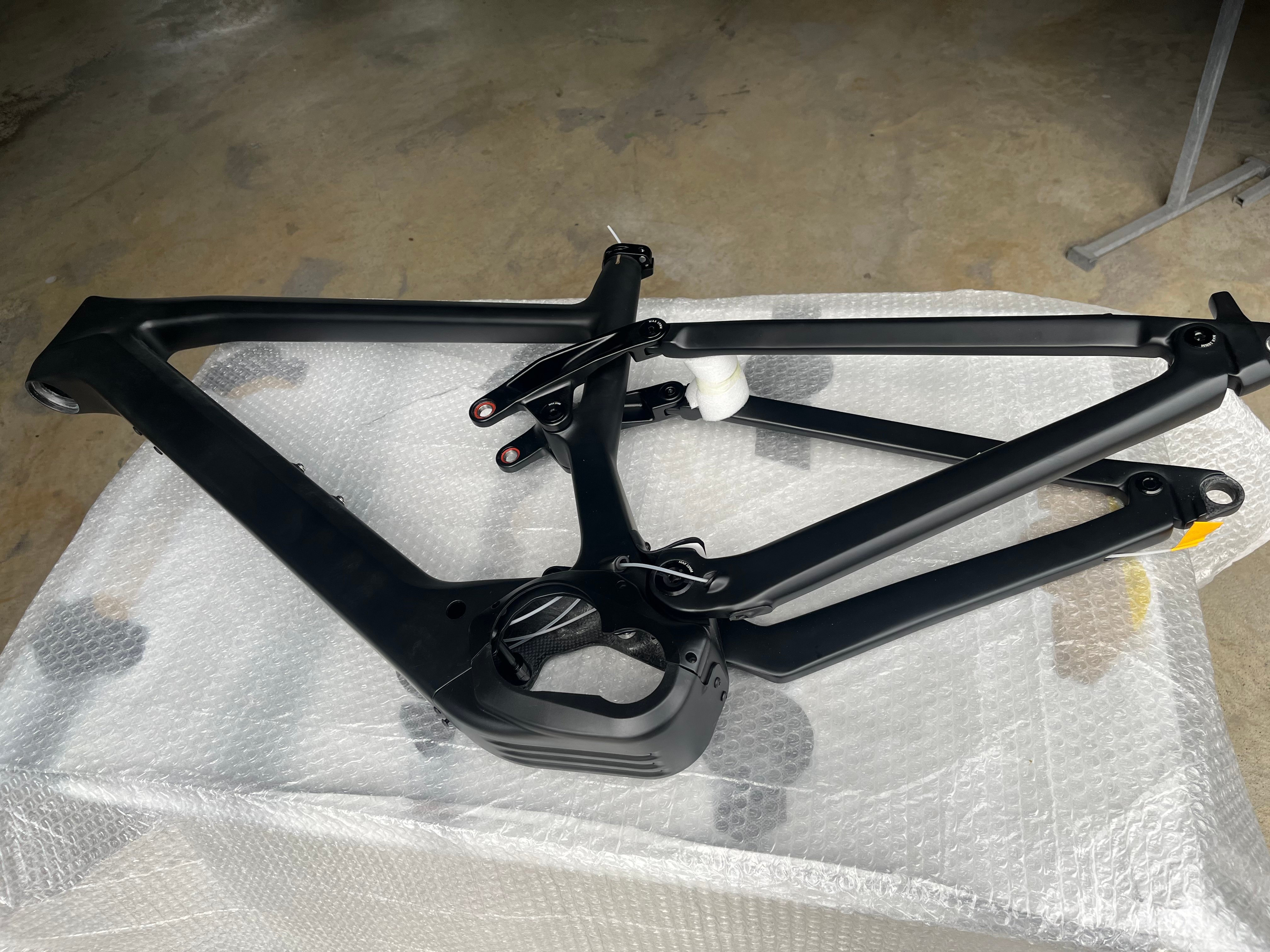

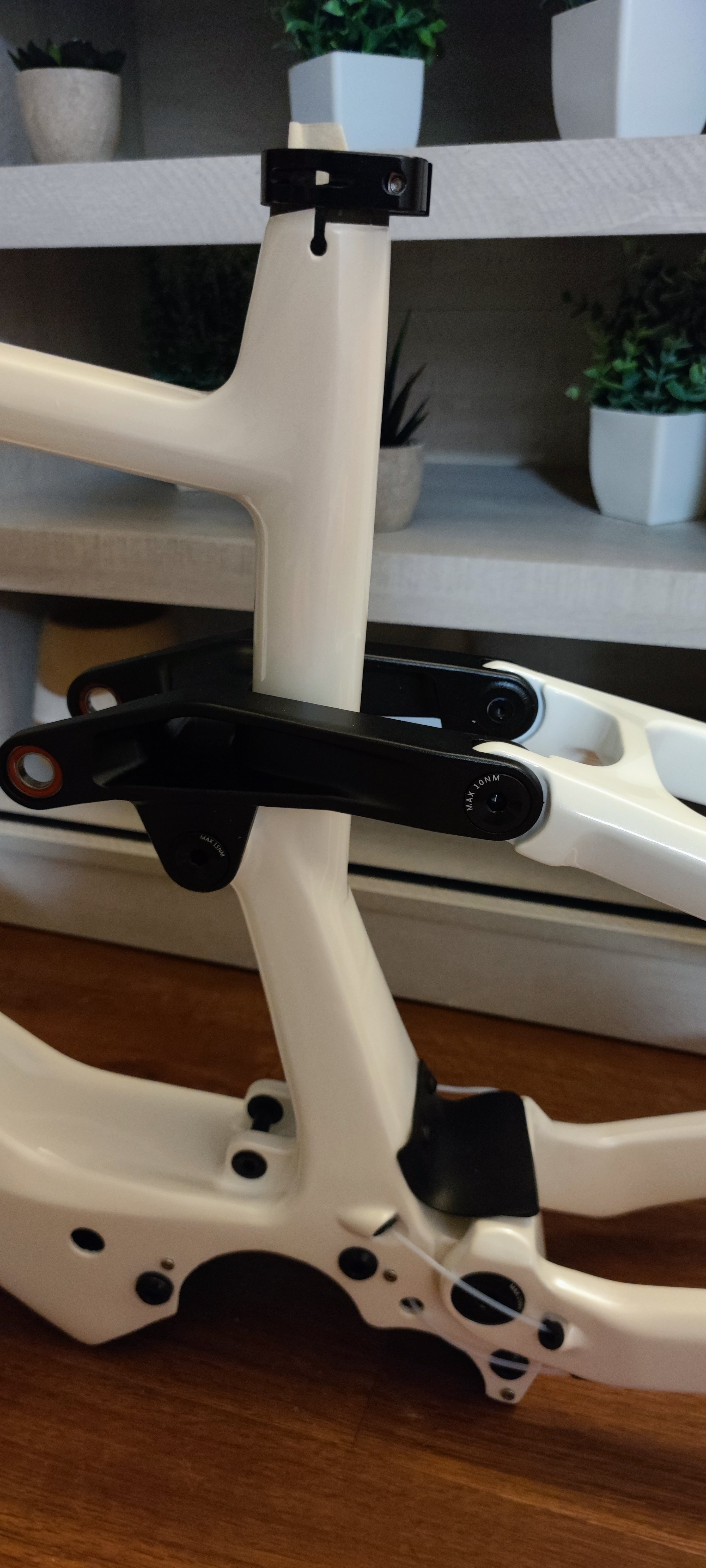

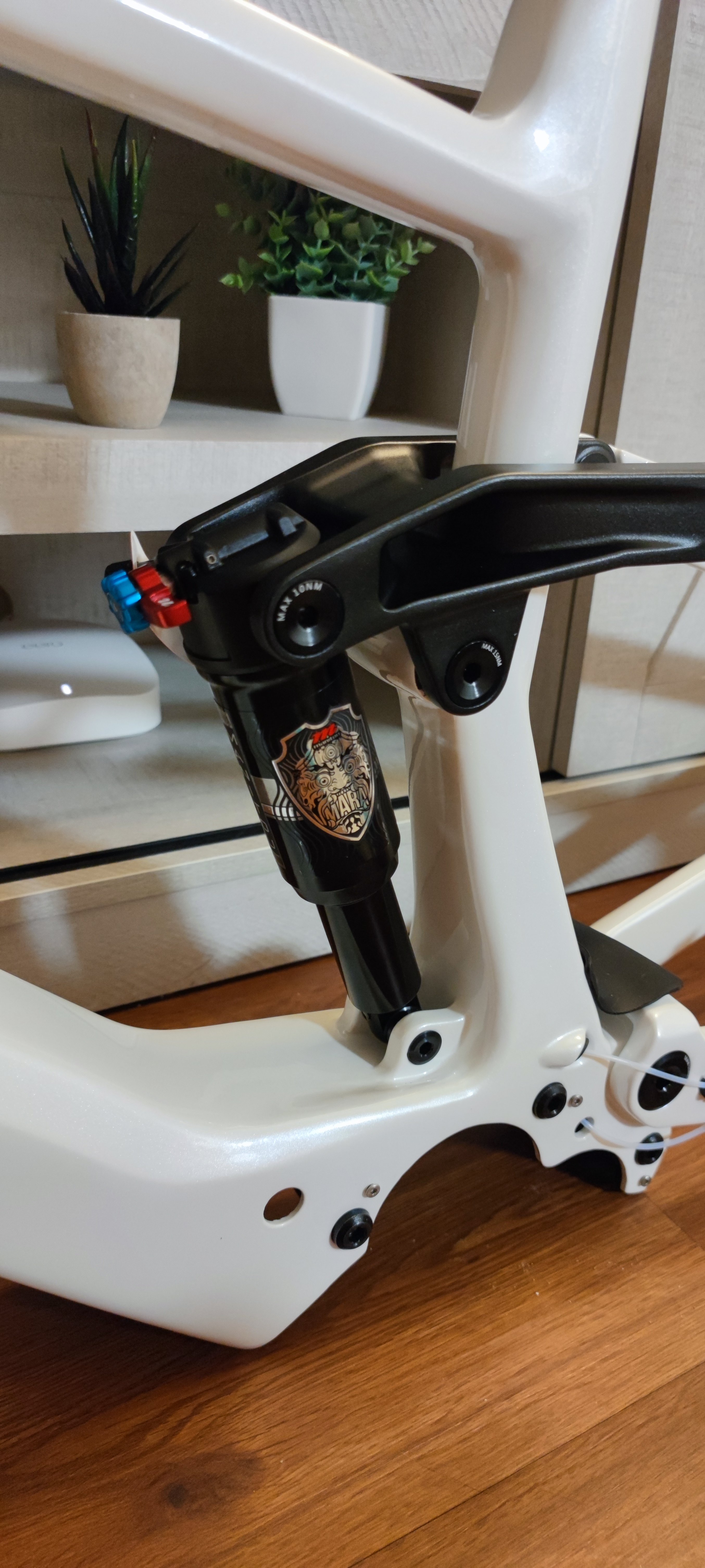

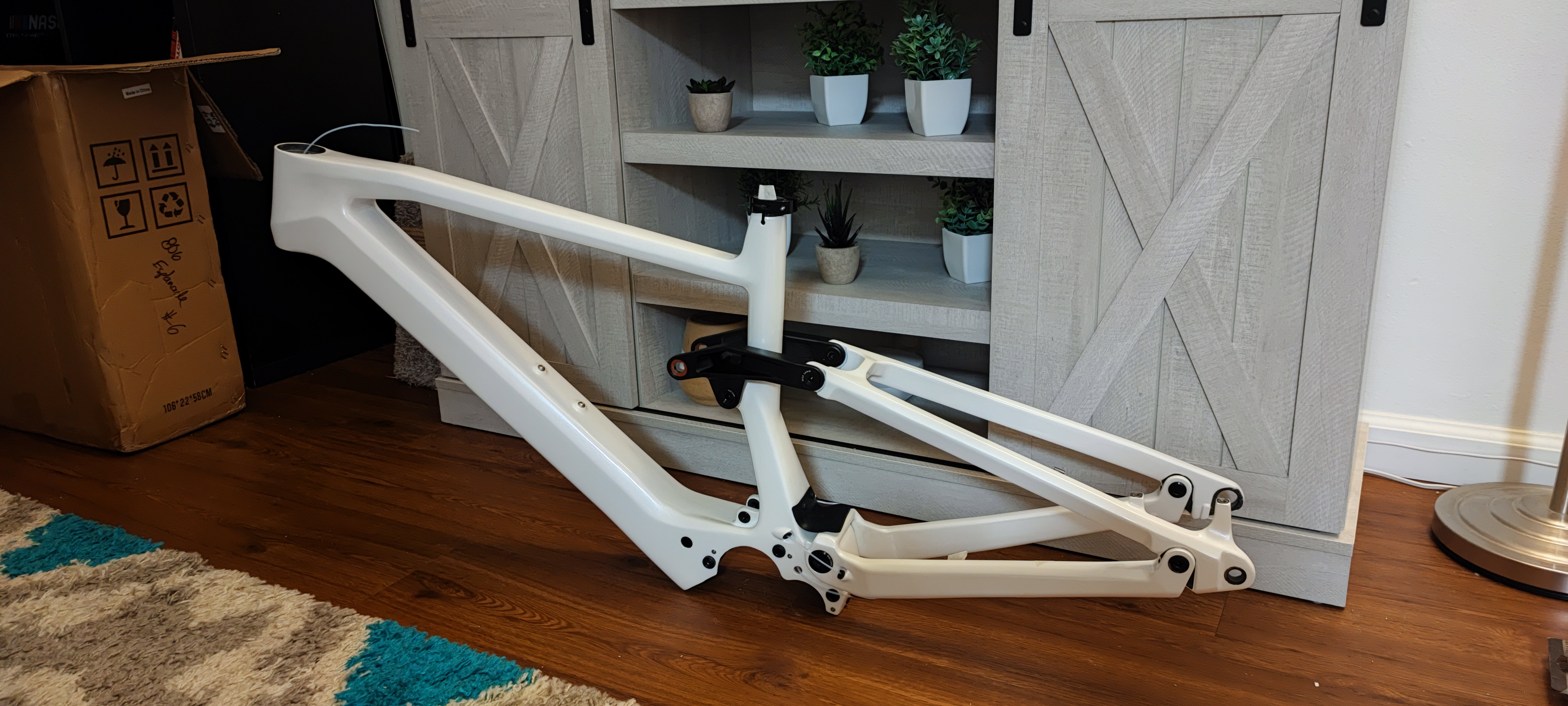

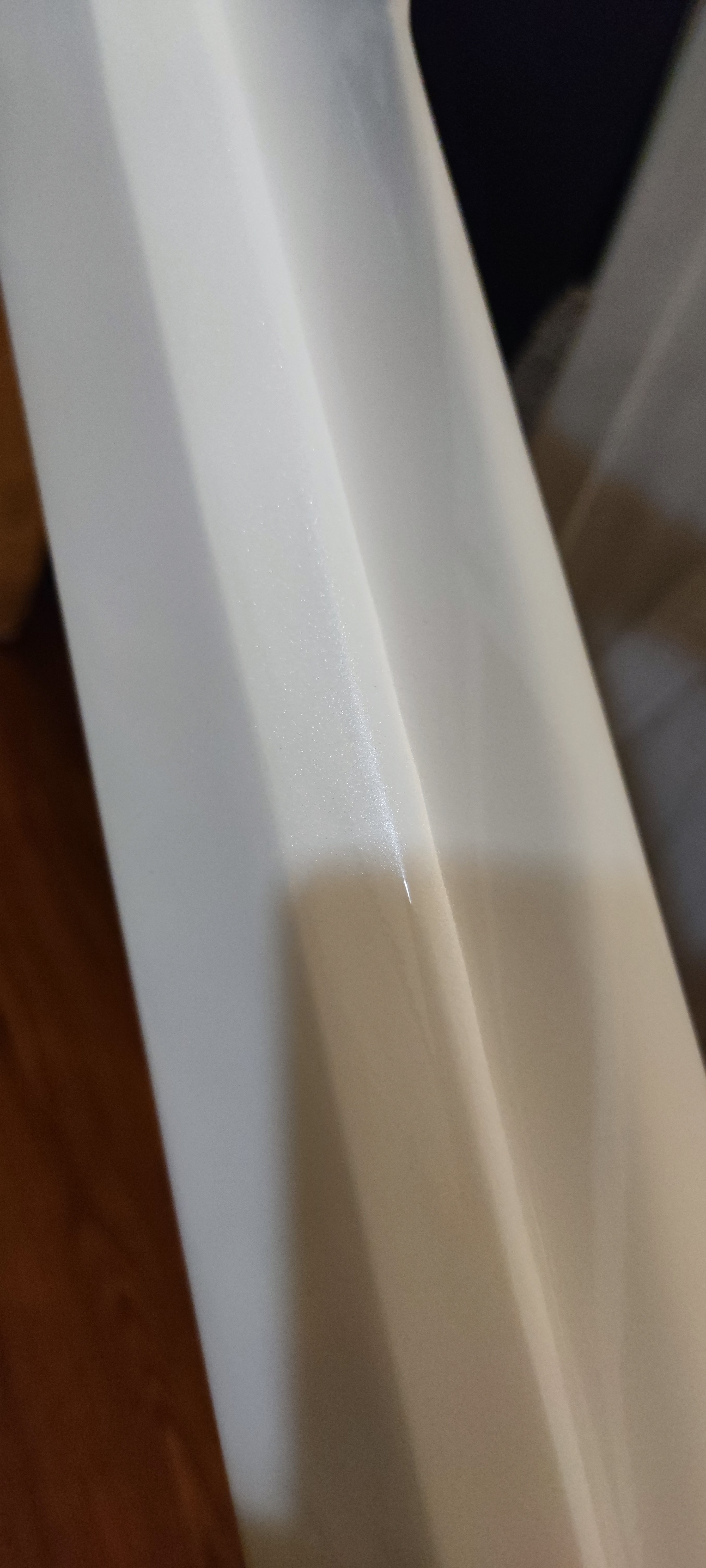

My frame arrived today! Color is pearl white. The paint looks great and carbon quality looks very good too! Bare frame as it sits weighs 2763g, size L. Mounted up my new Manitou Mara inline shock, fits perfectly!
View attachment 123157View attachment 123158View attachment 123159View attachment 123160View attachment 123161View attachment 123162View attachment 123163View attachment 123164View attachment 123165View attachment 123166

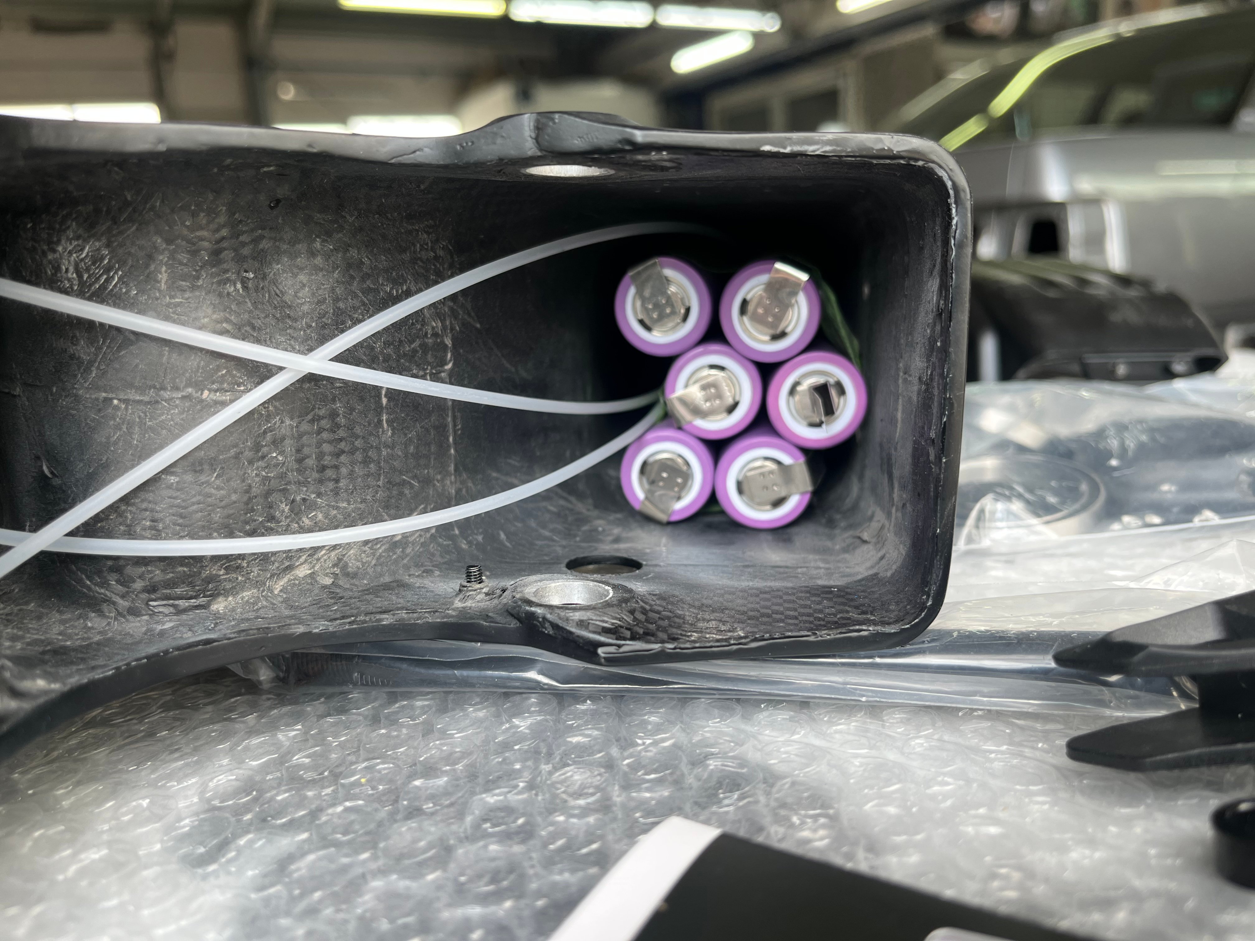

If you have the chance, can you measure inside downtube, how much actual space there is for battery? Thinking about custom battery..
