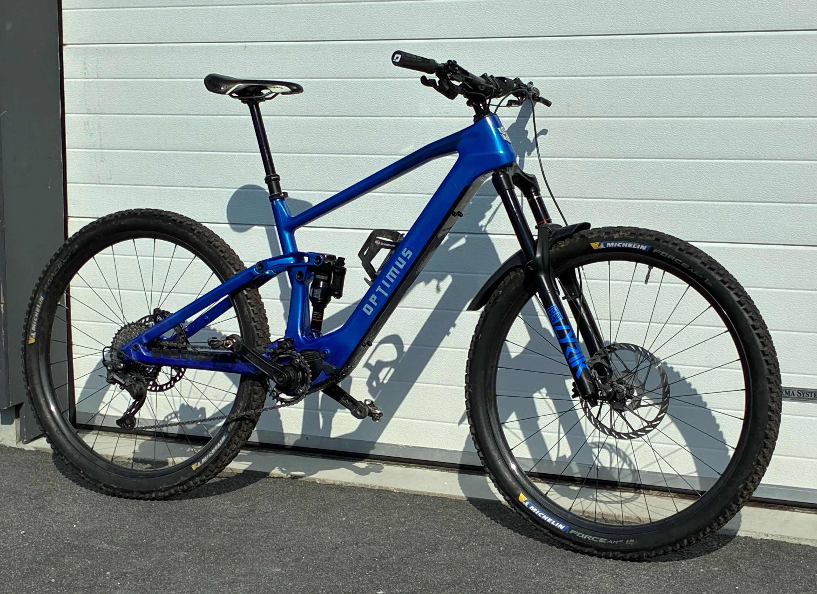

Hi Everyone,
New here! Completed my build of the LCE930 frame with Bafang m820 motor. Really enjoying the bike!
Reading everyone's experience with the LCE930 build was so helpful. Happy to answer any questions about the kit or assembly process.
Huge thanks to @JimLee-Lightcarbon for amazing support, communication and outstanding delivery process. Can't recommend LightCarbon enough!
LCE930 (size small)
Custom Paint per spec by LCE before shipment
RideWrap
Bafang m820
Bafang 410Wh Battery
LCE 27.5 carbon wheels w/Maxxis Ardent 2.4
LCE Carbon integrated flat handlebar
160 Fox Factory 36E / 150 Fox Float DPS
PNW Ridge Dropper
Tektro Orion 4 piston brakes - 180mm
Shimano Deore 11 HG
Riding weight: 20kg

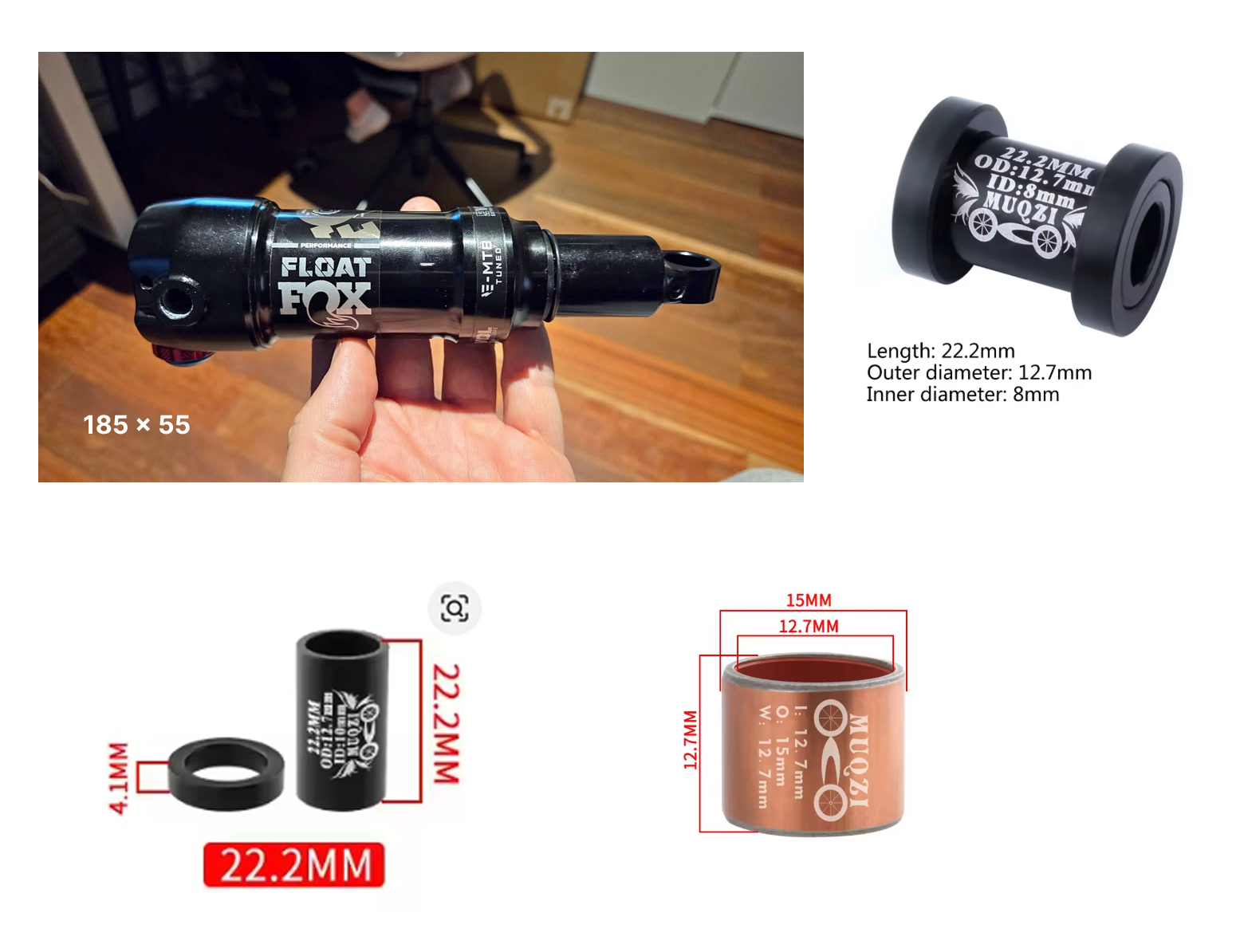

Hey guys, was wondering if this DU bushing and mounting hardware will fit LCE930? I tried computing it.
4.1 + 4.1 = 8.2 and then the eyelet width is 12.7 of the fox shock. it will only be 20.9, worried there might be a play.

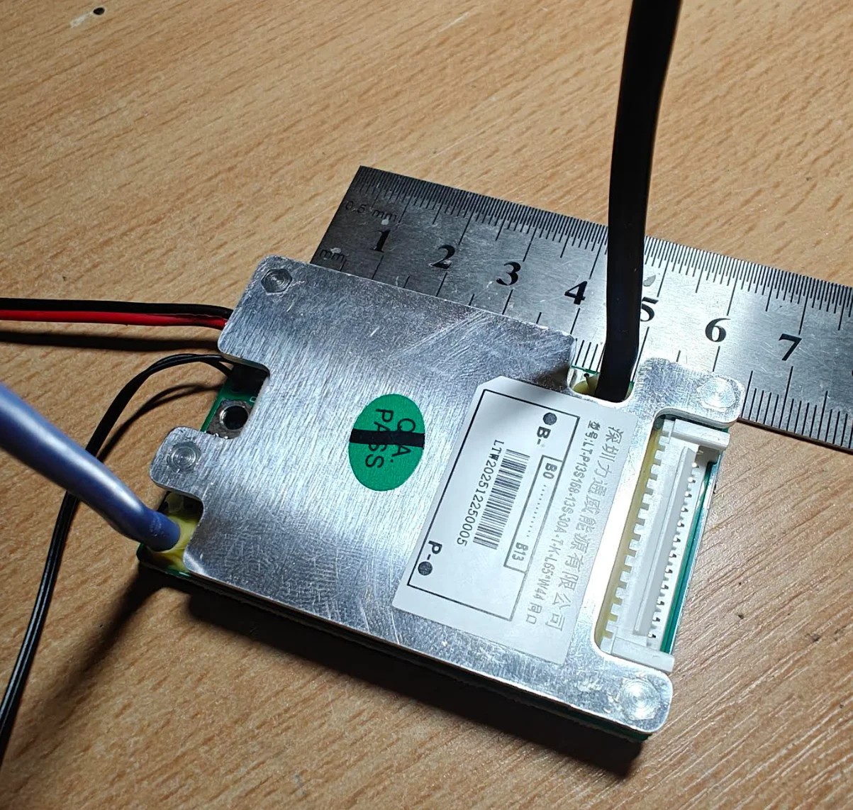

hi borris, im getting the same issue now, but it seems it's the provided m8 bolt. Did you sandwich it inside the bolt? or inside the hardware? I'm getting vertical rattle, specially when picking up the bike.
Dengfu BMS. 30A written on it.
And super small 65x45x10mm
And what is funny, it was handling even 50A ;)

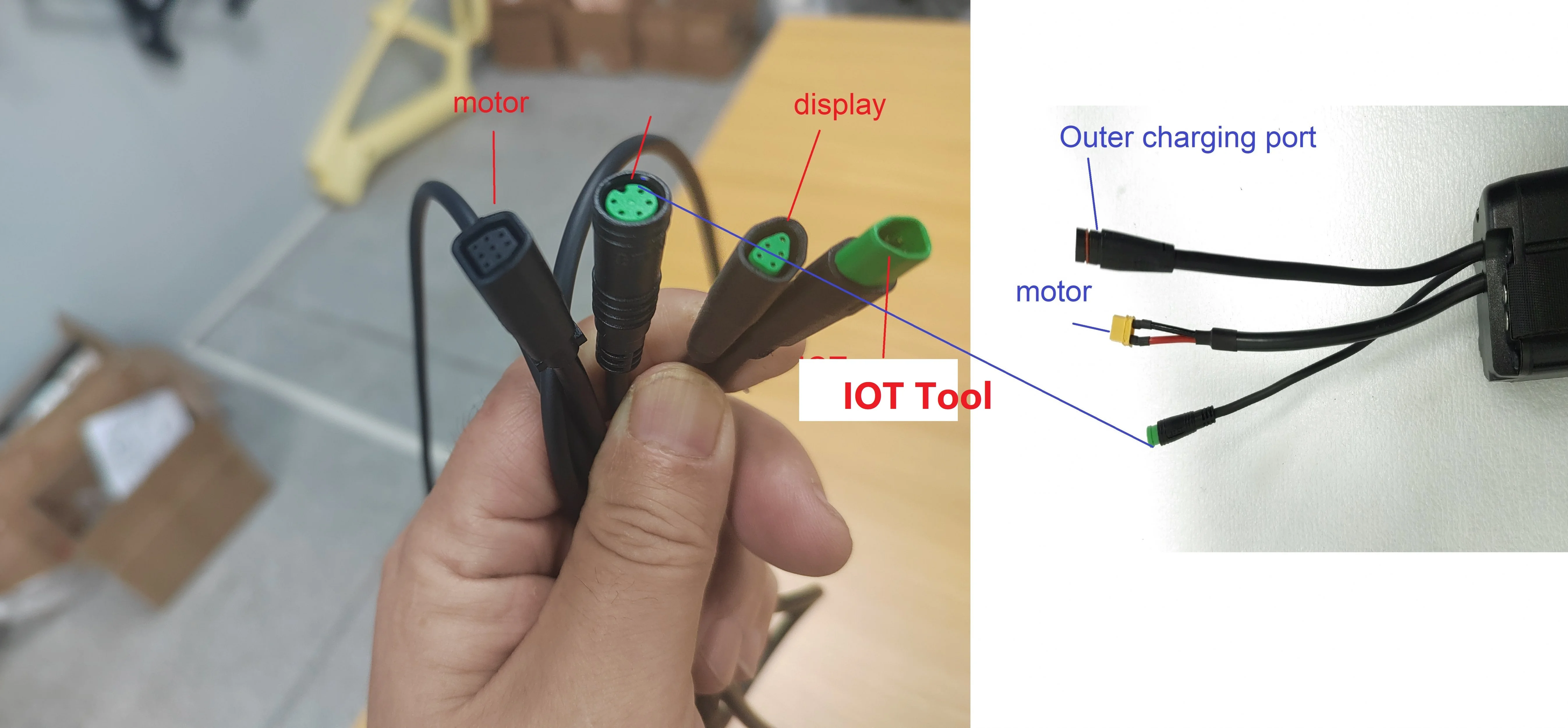

what bafang canbus cable you running ? some have the 1t4 canbus cable but dont use all the ports. if water enters one connection you are ducked.
not what u want to hear but todo some proper problem solving you need to dissambly the bike and check everything.
even something simple like a speed sensor cable that is to tight can duck your controller. i had that happen myself. it was to short and it broke first try as the suspension cycled. it caused a internal short and burned a controller
look for damages on all cables, maybe it was stuck somewhere and finally after some rides it decided to stop working?

those bafang can cables are cheap on ali, look closely which one you need
i like the 1t1 (only display)
on my e82 i run 1t2 (display+ battery)
i dont want unused ports for moisture ingress ect
Thank you for your reply. I searched all over AliExpress but couldn't find anything. I also contacted Bafang, and they said that only the bike manufacturer has this cable. LightCarbon hasn't replied yet to let me know if they'll send it to me.
These cables should be readily available on Ali/Aliexpress. If anything you may need to contact a seller like Fieldebikes and just chat with them, show them the connectors you need and they should be able to guide you in the right direction.
Thanks for the tip. I contacted Fieldebikes last week, and we found the cable I need. They should be sending it this week.
Thanks for your help
