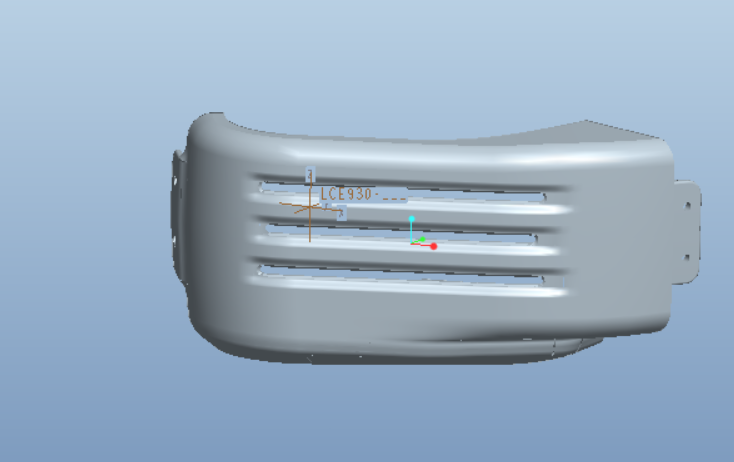

Heloo @JimLee-Lightcarbon can u share the 3D file of motor side cover please? thx.
Here's a link to my design for this cover - it's a bit thicker than the original and surprisingly, despite being 3D printed from PETG, it seems to be more durable than the original.
thanks man. so using PETG is more durable?
PETG is more radiation-resistant than ABS, but ASA filament would be even better.
However, I think that PETGis a sufficient material for this cover, especially since it's very flexible.
Always use PETG if you not printing toys. PLA is shit and just decays by itself after some time.
sorry just check the post, the cover's size as below, bottom and side covers
the file is .x-t, if anyone can change it to step please do it, thanks,
