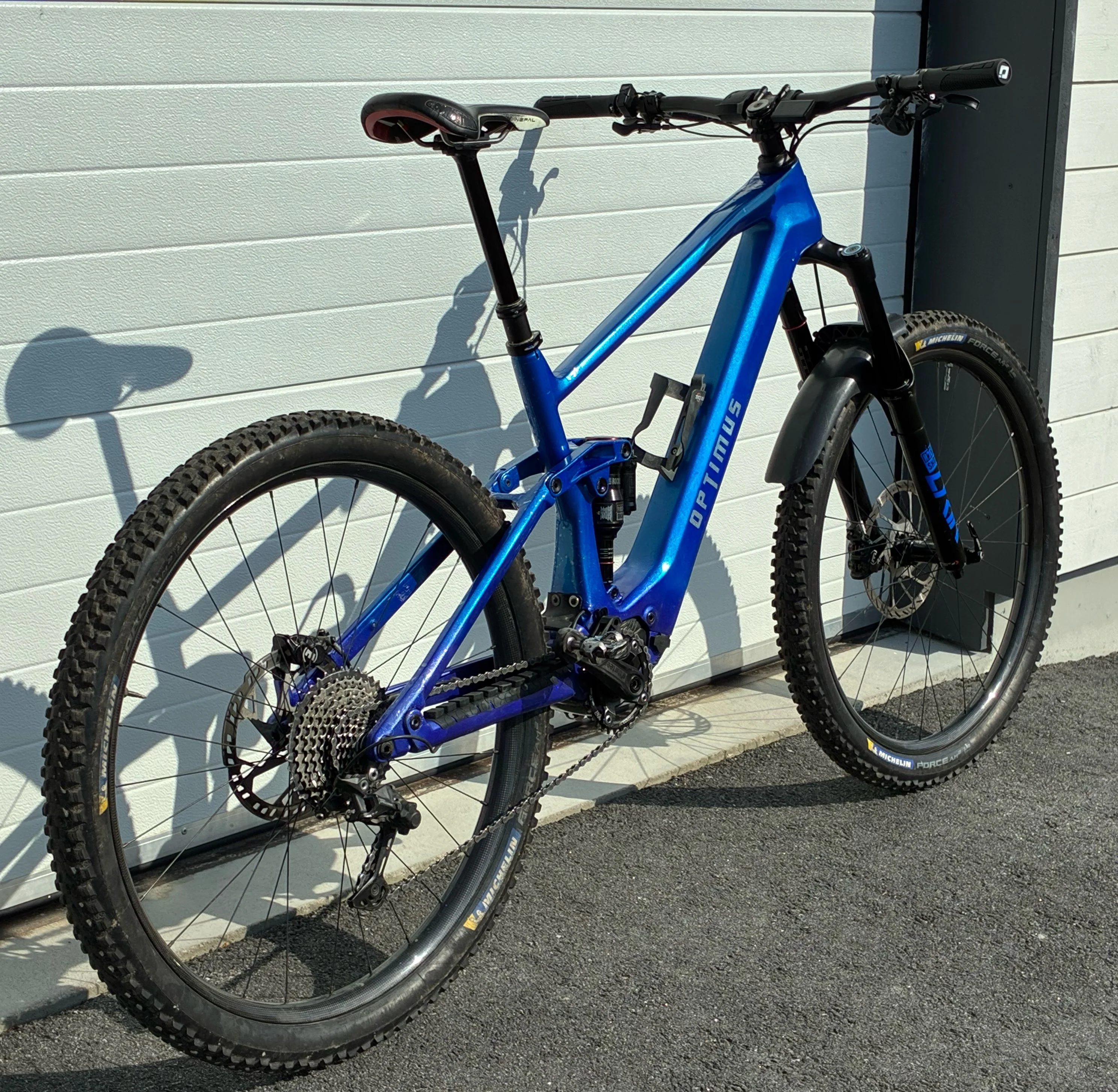

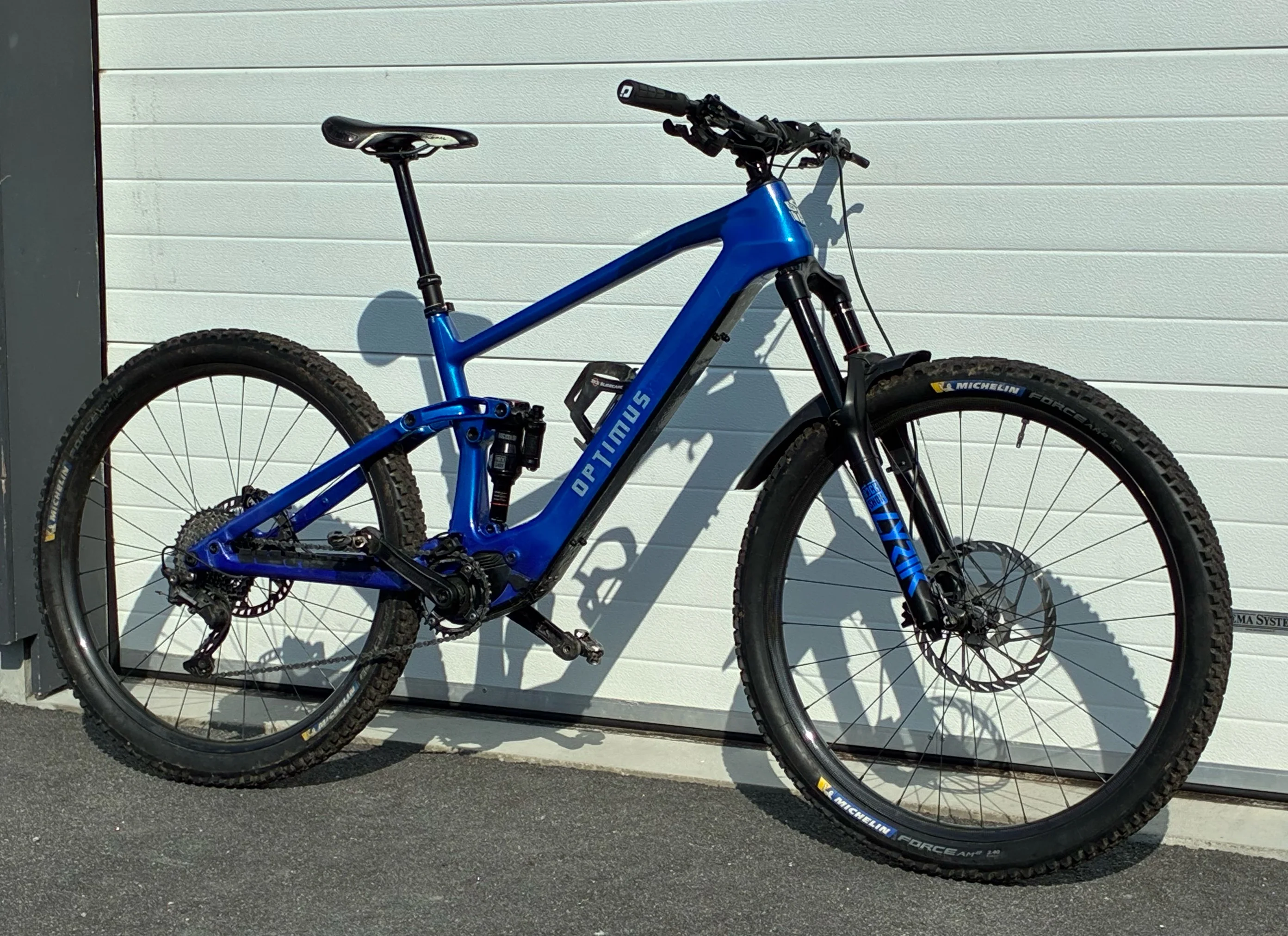

M820 Bafang - LIGHTCARBON LCE930 Frame (lightweight)
