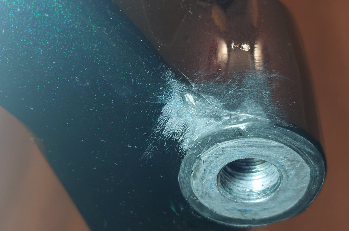

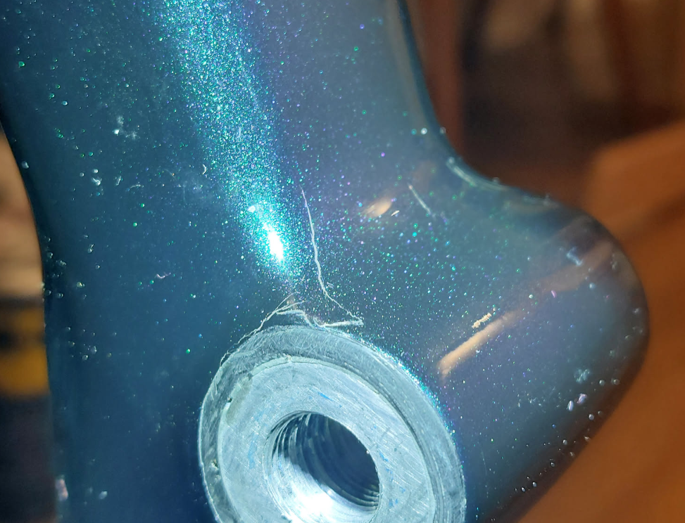

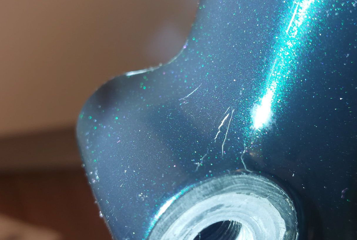

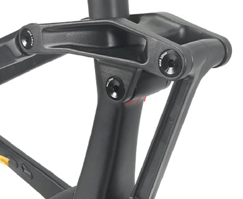

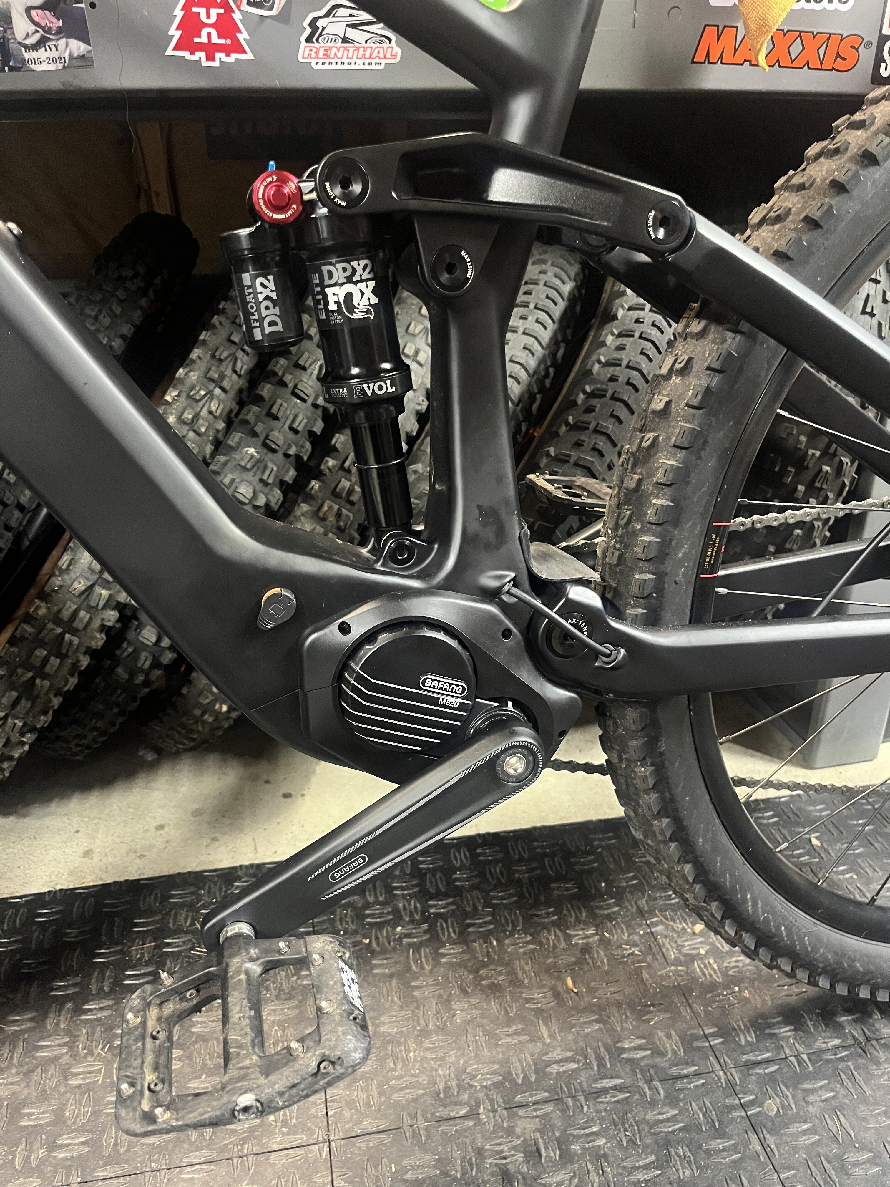

Hi all,
Not so great news from me. I think I found few small cracks on my frame. I was doing some maintenance of the rear linkage, because during riding, some creaking and squeaking was audible. I found them below the central pivot point, for the rocker arm, on the main triangle, like shown on the picture below:
Pictures of my frame (bike is upside down, that is why it looks like it is on the top:
I decided to sand down a pain on one of them, to check if it is only paint, but to me it looks like they are actually cracks of the carbon:
And considering a location, I believe that this area is quite highly stressed, when a shock is compressed.
Can you guys please check, if somebody can see something similar on their own frame?
I am quite worried now and not sure if I should ride it anymore. What do you guys think?

I’d contact LightCarbon for sure on that one.

Not good but repairable.
You should contact Light Carbon

I got the response:
Hello Martin ,
Sorry to hear that your frame might get cracks , yeah, for your safty, please do further test to check if the crack comes from the paint or the carbon fiber.
And really regret to tell you that your frame 2 years quality warranty is over.
If you finally affirm it's carbon crack, you can consider order front triangle from us to replace it.
I'll do my best to offer you a discount price .
I received the frame on 10th of August 2023, so it looks like I am 1 month over warranty. 😔
I am a little angry at myself, because the frame that I received had very poor headset seat. It was oval, and even with proper preload, bearing was still moving and creaking. I decided to fix it myself, like this guy in the video: Link
I sunk few 100€ to fix this. I should just request a warranty and would not have this problem now.. 😟
Oh well, we live and learn 🙃
I requested a information about the discounted front triangle price, so waiting for this info now.
Tough break, man. Don’t beat yourself up too much – we all learn from stuff like this. Fingers crossed you find a cheap and easy fix!
Hi, LC offered new front triangle for discounted 300$USD, which is IMO fair price.
Was anybody else able to check if they, by any chance, have the same cracks on their frame?

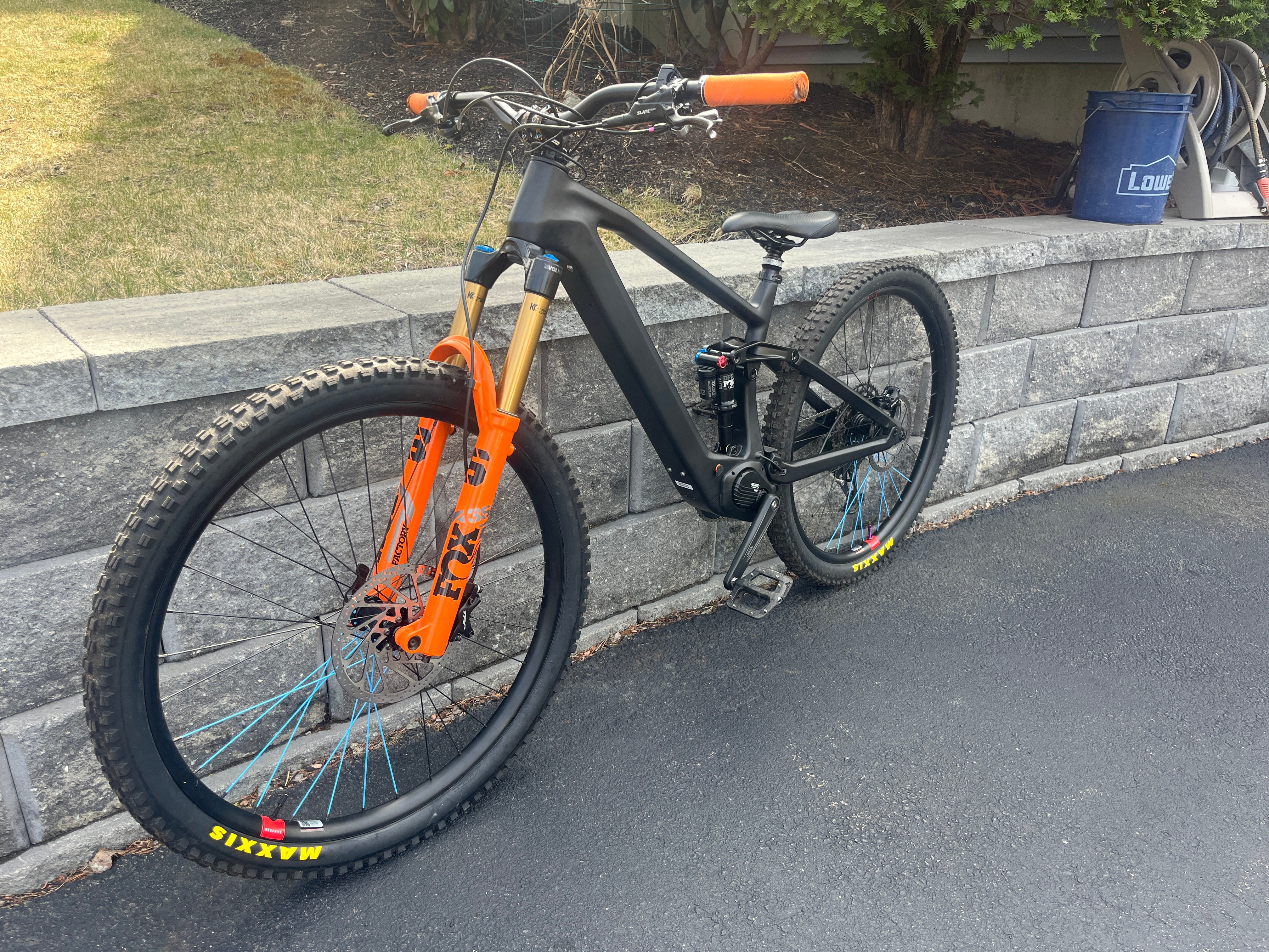

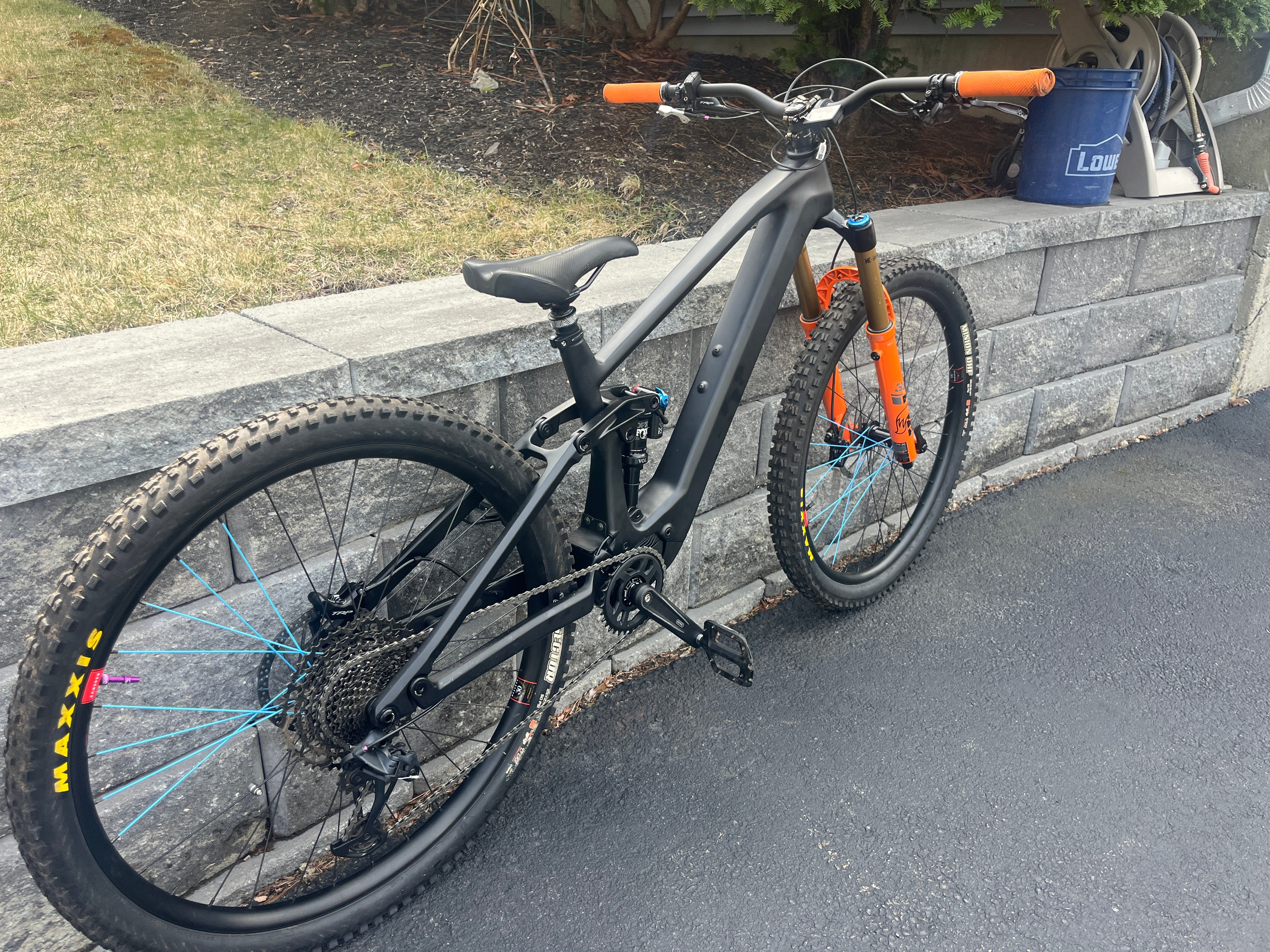

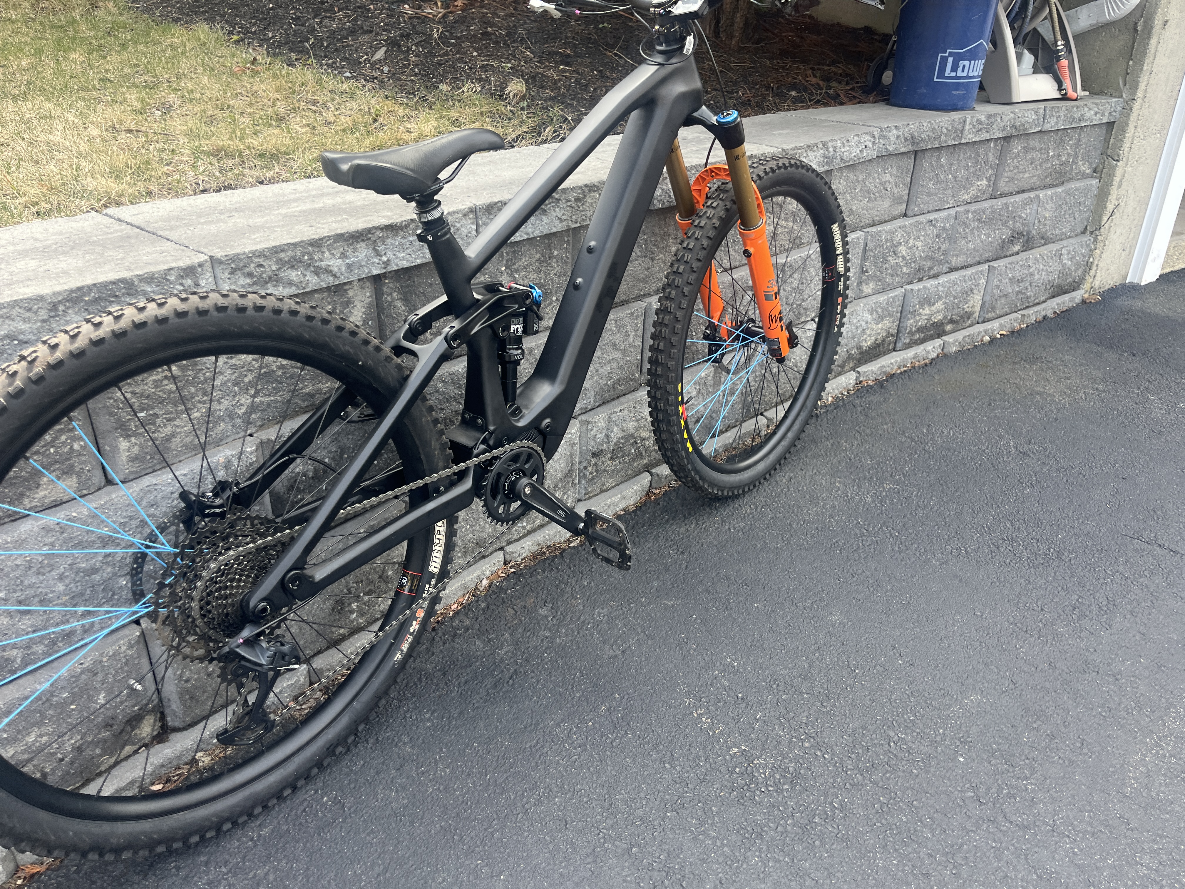

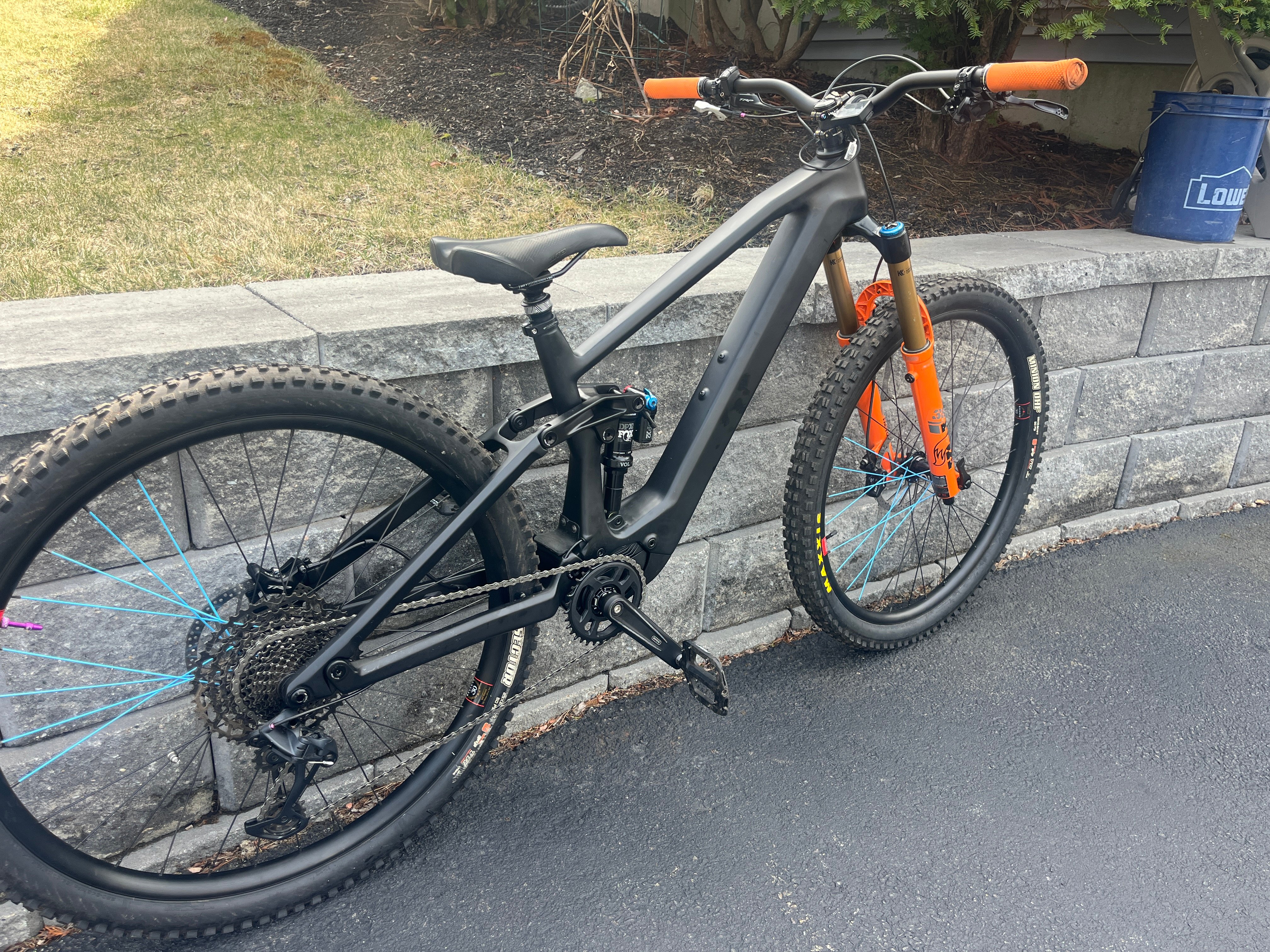

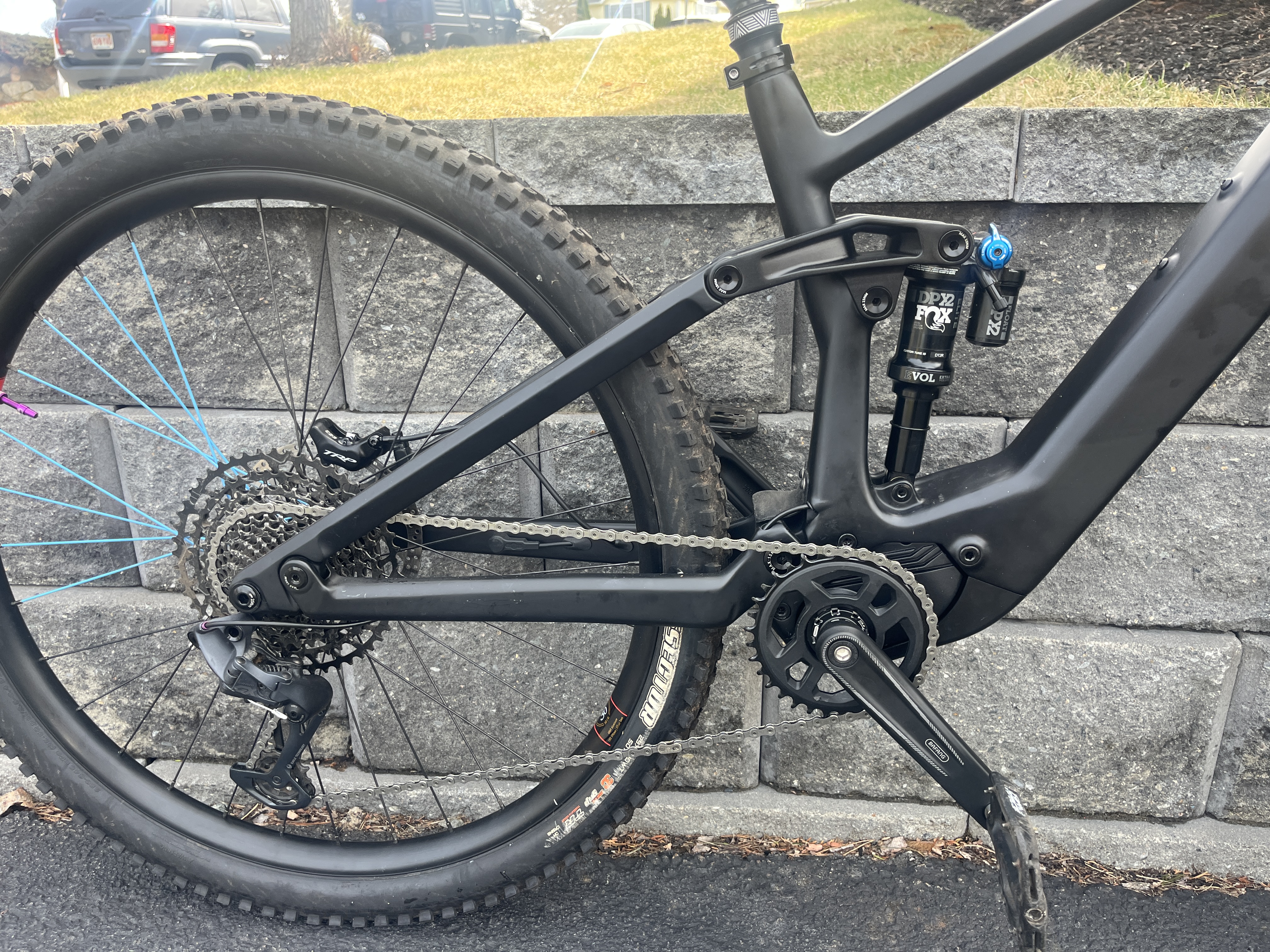

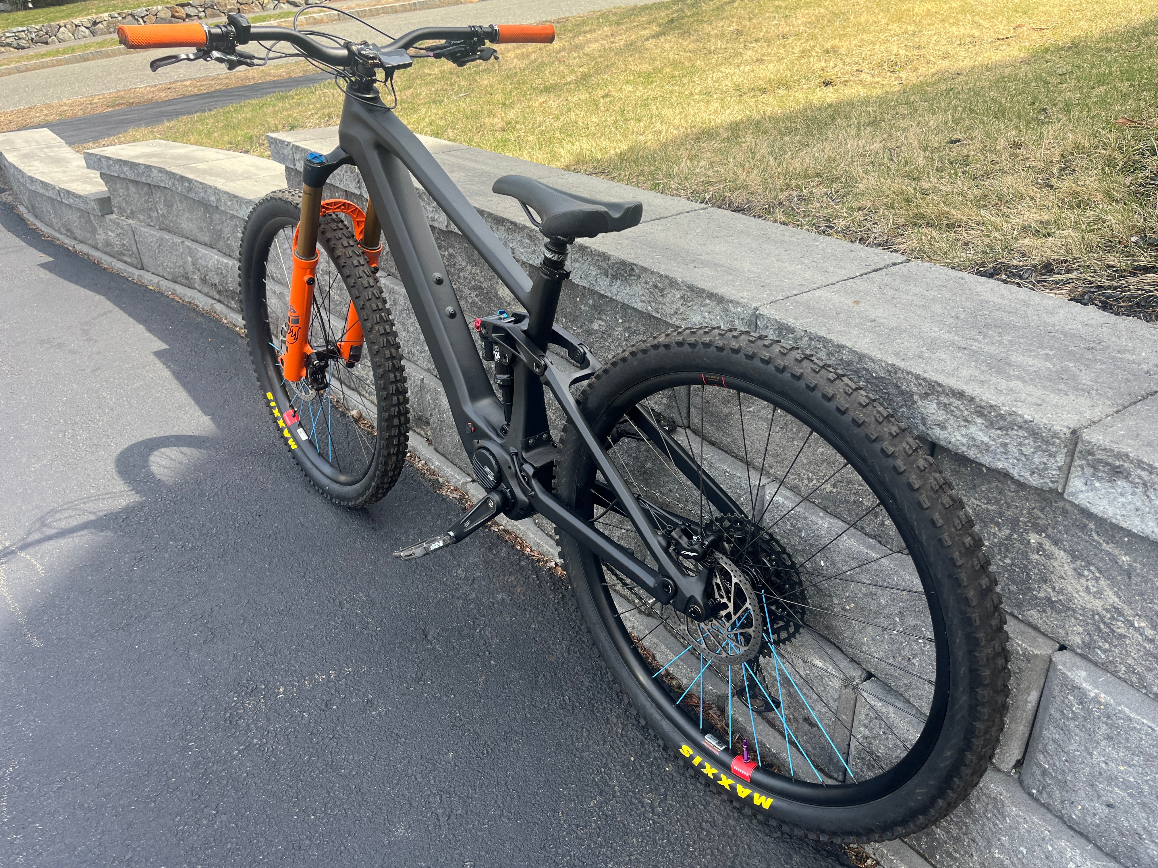

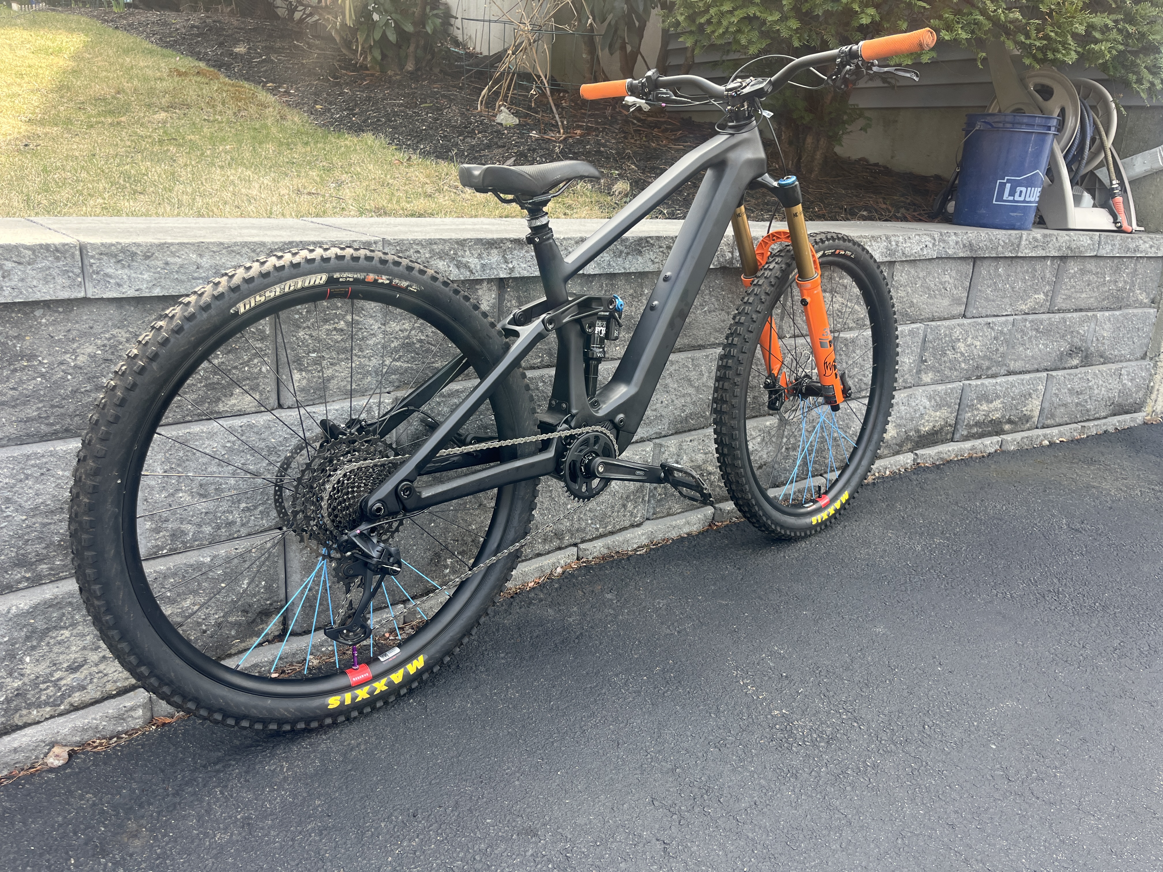

Selling my LCE930 medium frame, complete bike. All new parts, except the fox 36 fork and only tested in driveway. TRP brakes, SRAM GX 12 drivetrain,PNW 150mm dropper. Picked up a different ebike waiting for parts on this bike, so need to sell. Has the newest headset from lightcarbon for cable routing. $4000
View attachment 157805 View attachment 157806 View attachment 157807 View attachment 157808 View attachment 157809 View attachment 157810 View attachment 157811 View attachment 157812 View attachment 157813 View attachment 157814 View attachment 157815 View attachment 157816
Would you sell just the frame ?
I am sorry for your frame! That seems like a fair price. I checked my frame, nothing visible, yet at least. I have been riding quite hard, jumps and lots of downhill on roots and rocks. I am also 90+ kg.

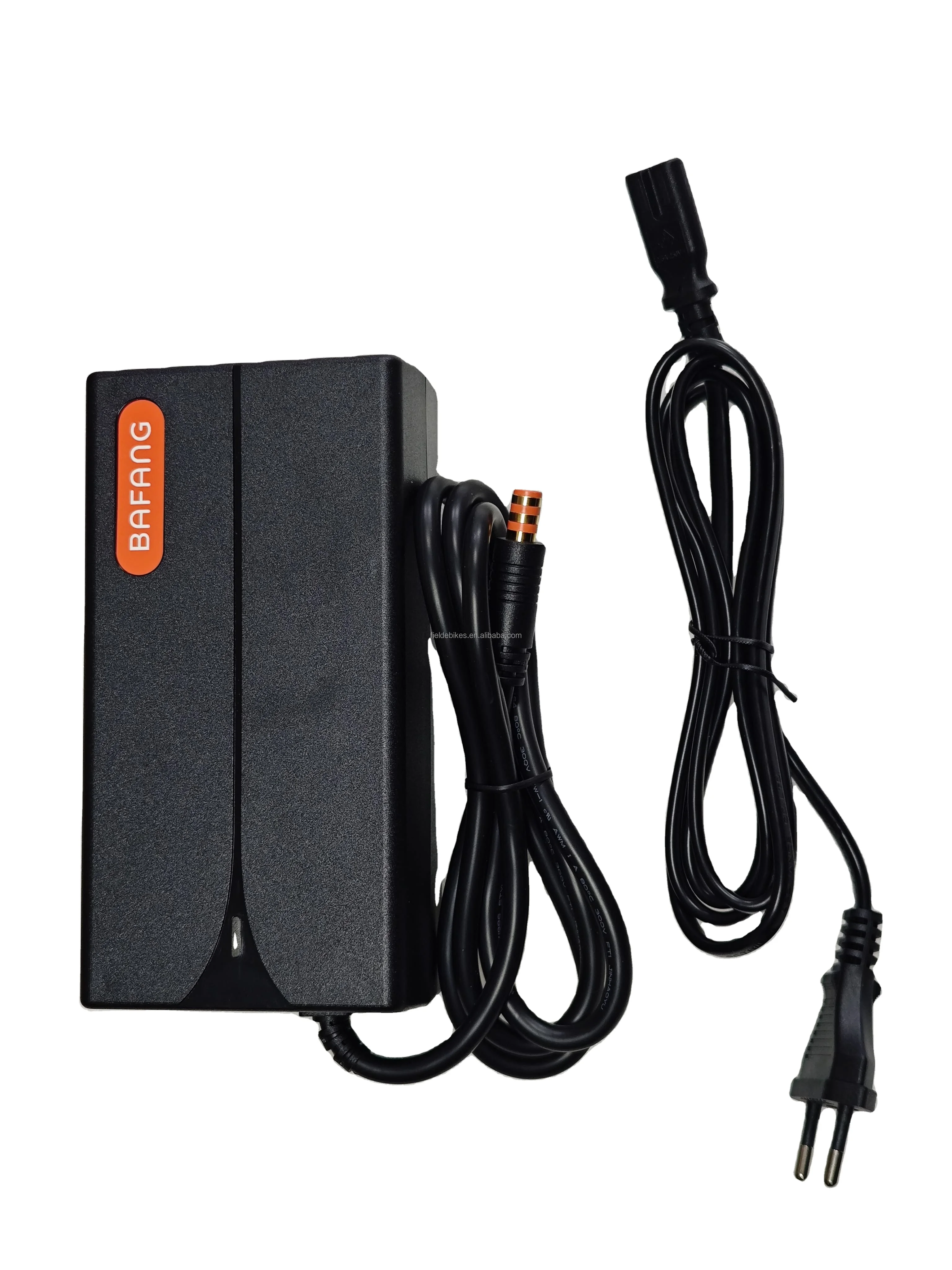

Looking for a replacement charger for the 820. Mine seems to be clipping out of charge state after an hour or so.....unplug and replug and it goes again and can get to 100% with repeated replugs. Best tool does not show any battery issues. Supplier suggests trying a new charger.
I ordered a couple of these. Took a month to arrive but they're exact Bafang replacements. Note these are for the 43V battery and IIRC the m820 supports a 36V battery also (so make sure your charger voltage matches this one before ordering it):
perfect thanks! yes I'm 43v

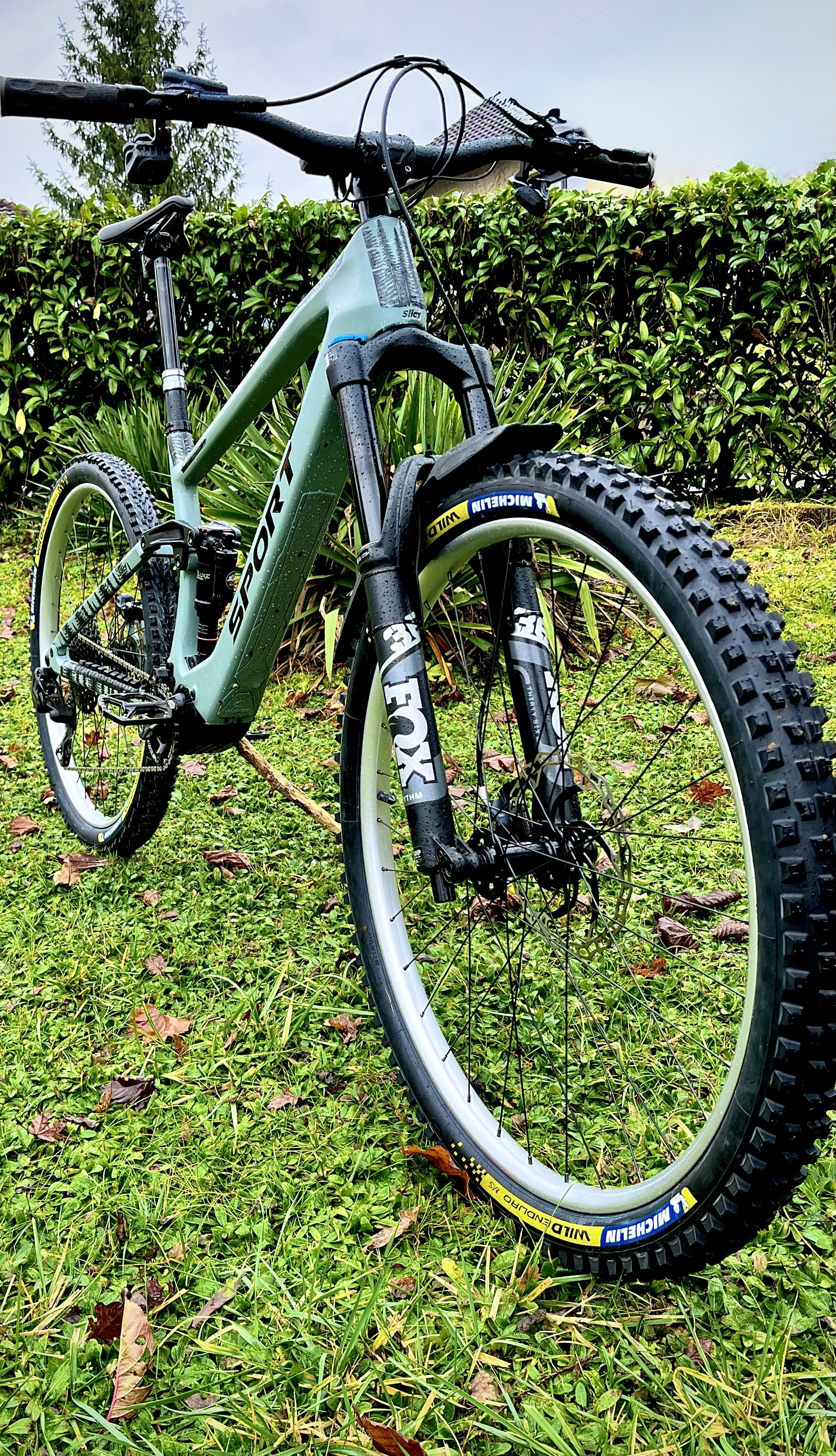

I mount my own Carbon weels. Circle from Light Carbon and P3 ZTTO hub.
new color from covering it is not painting.
new michelin Wild enduro tire, MS front and new special réal.
it is always a pleasure to ride this bike 😀

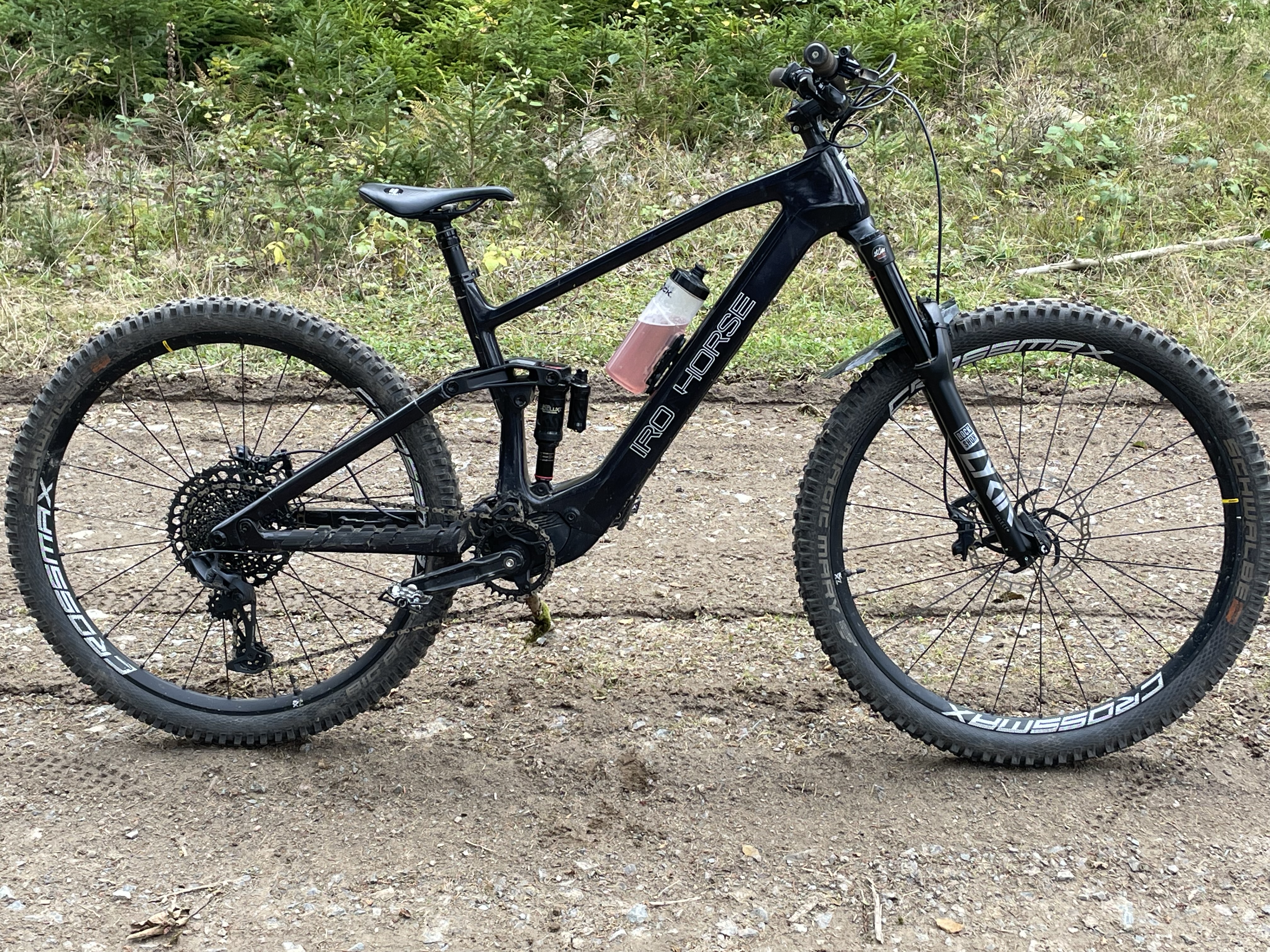

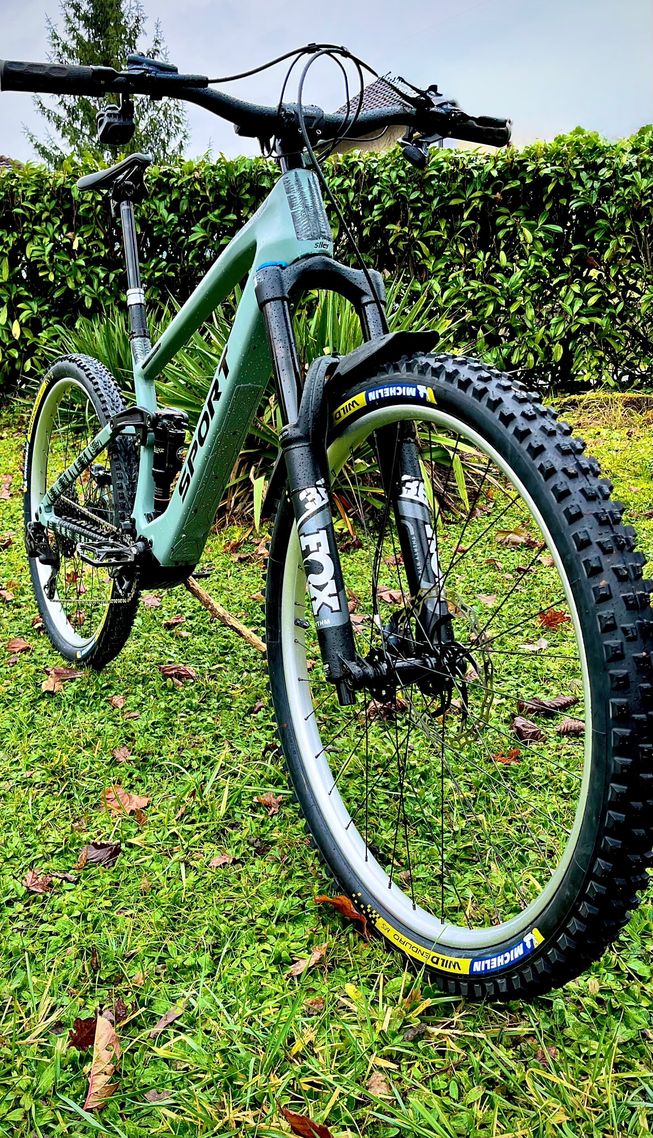

Salut à tous, un grand merci à ceux qui ont partagé leurs constructions sur ce fil de discussion et qui m'ont donné envie de construire mon lce930.
Je vis à Marseille, en France, mais je suis actuellement en vacances en Italie où j'ai enfin pu tester ma construction 10 mois après avoir acheté le cadre chez Jim.
Après 100 km et 3000 m de dénivelé positif, je suis impressionné par le vélo. Je crois que je n'ai jamais roulé avec autant de facilité.
J'ai testé le Mule et le 29, et pour l'instant, le 29 est le plus fiable. Je retenterai l'expérience avec le Mule une fois que j'aurai installé un meilleur amortisseur.
J'ai la version avec batterie Bafang 43 V. J'y ai ajouté une rallonge avec une batterie 43 V achetée sur AliExpress (je sais qu'il est difficile de trouver une rallonge 43 V, alors n'hésitez pas à me contacter si vous souhaitez plus d'informations).
J'ai une transmission XT 32 dents, cassette 10/45. Je voudrais passer à 30 dents pour éviter le mode boost, mais j'ai peur que la chaîne ne déraille.
Si des personnes ont essayé une prothèse de 30 dents, je suis attentif à leur impression.
Unfortunately the charger works but does the same thing. I have not been able to figure out what is wrong so I assume its the BMS in some way.
