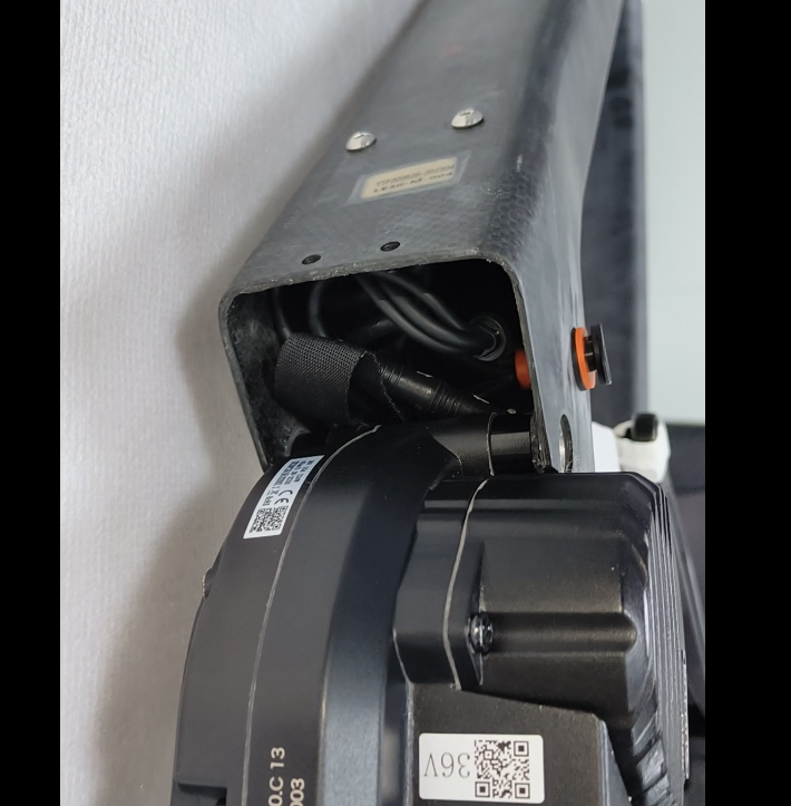

For those who installed their battery (btf014), do you think there's enough room in the frame after the battery is installed ? Do you see any other option ?

If you tie the cables, there is enough space here; but you need to pass the cables through the downtube first, and then install the battery.
with 18650 cell will fit on 3x2 row. but with 21700 will it fit to frame?
I’m not sure they would need to be staggered, My battery is the same size as the bafang battery 63 x 53 and it’s really tight.
My frame is slightly tighter at the top.
