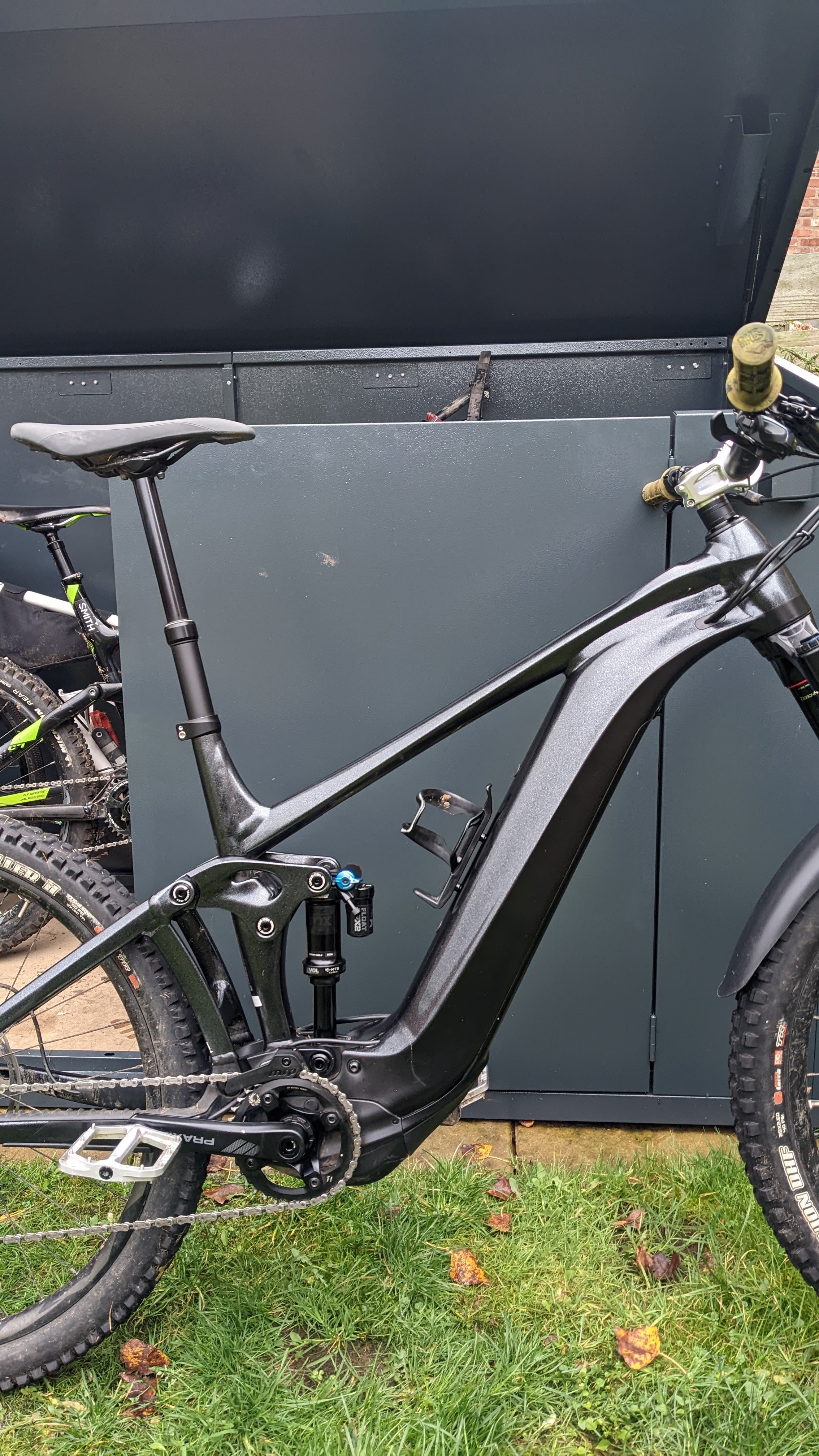

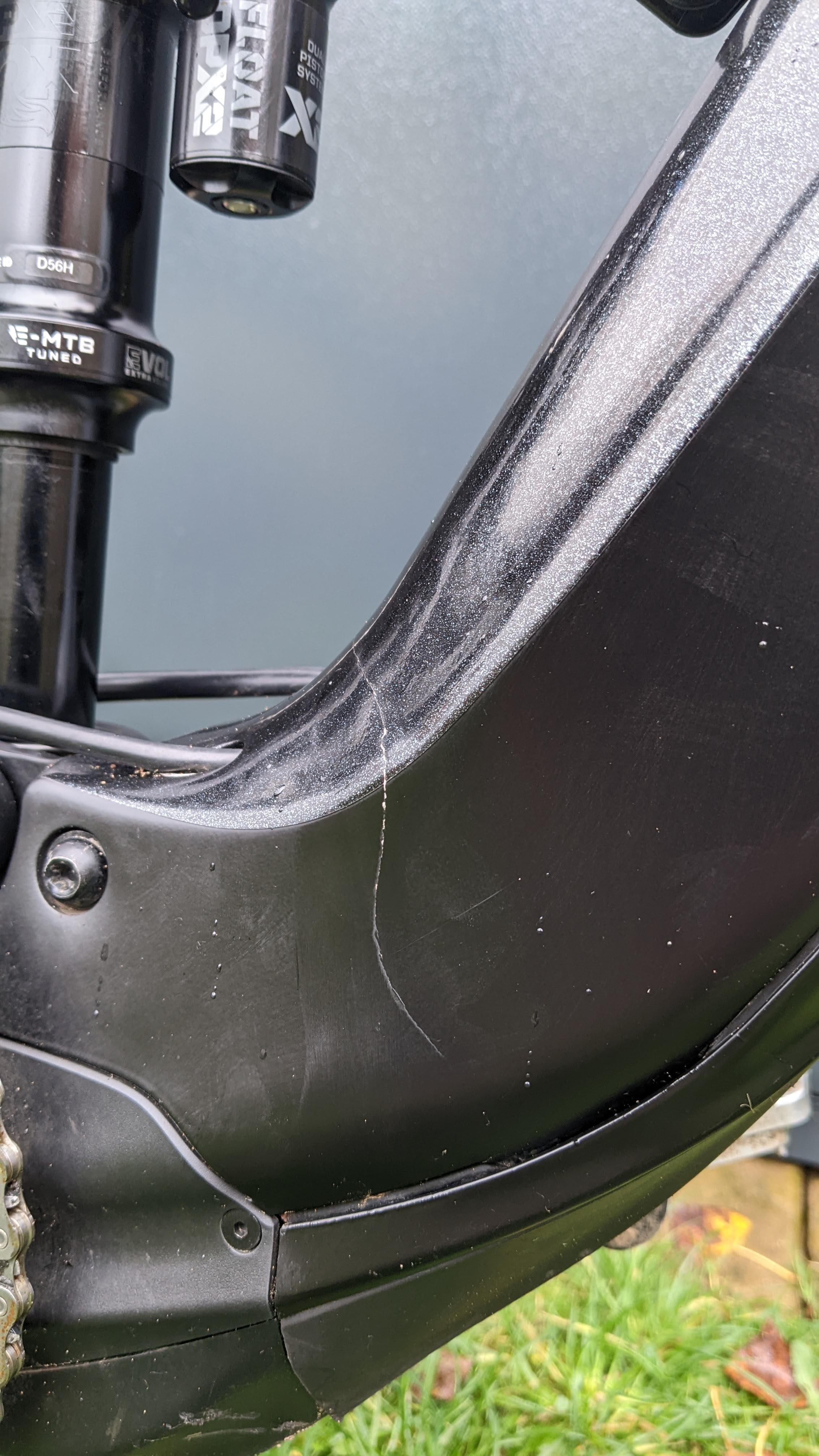

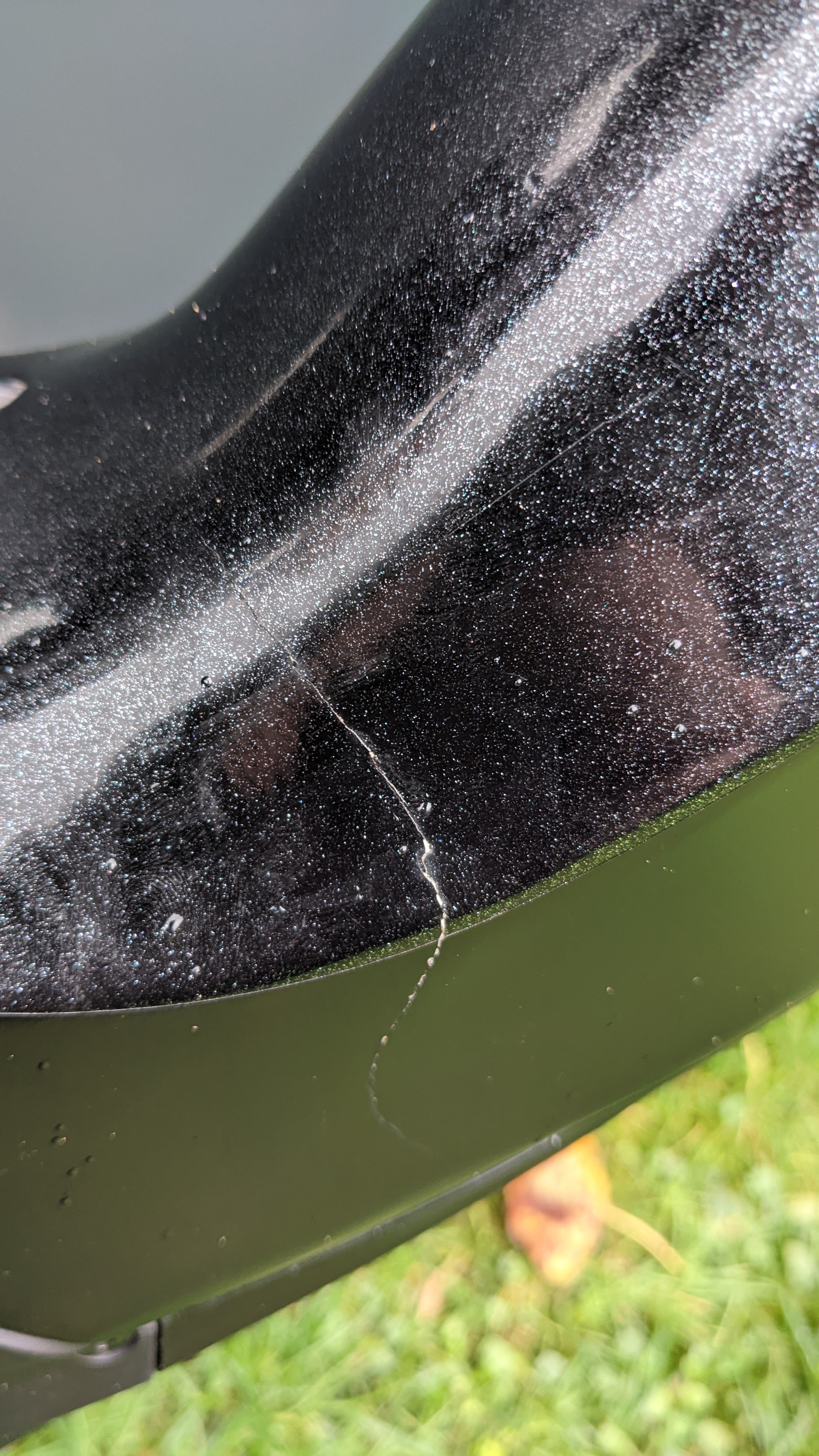

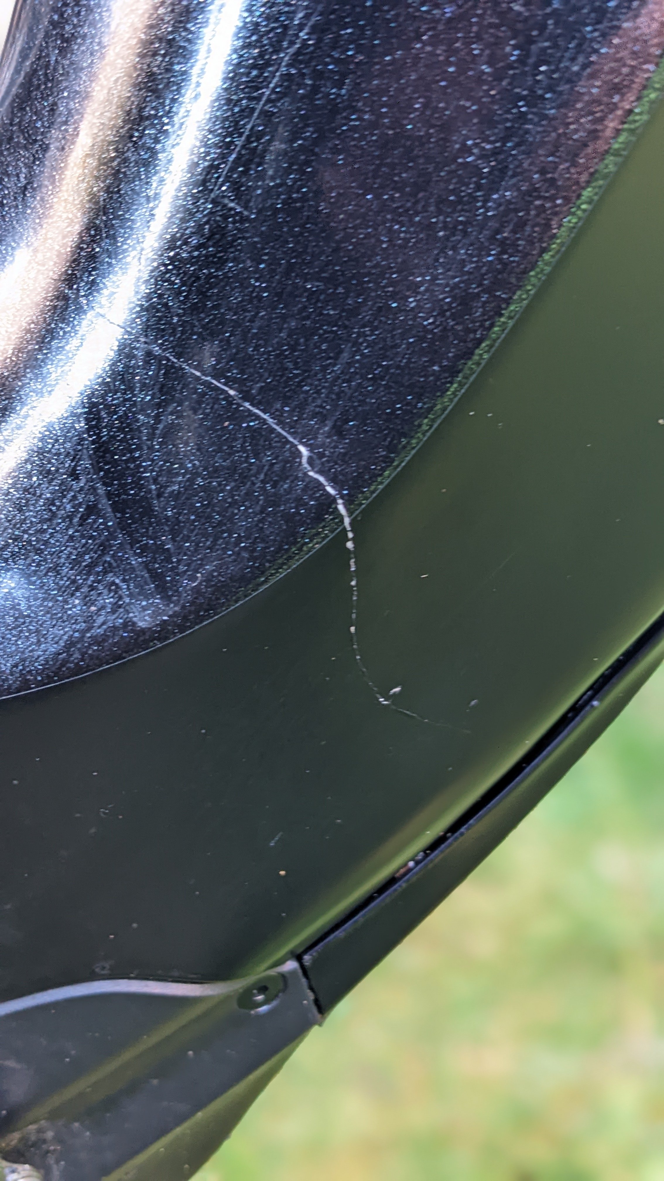

Hi,
First off, I want to say I love this bike and have been very impressed by how capable it is. This is my first eeb and I am absolutely buzzing.
Now to the shit part, after a muddy ride in the Peaks I found this (see pictures) after cleaning the bike, as you can see it’s pretty big!
After worrying for the last few days whether or not Giant will cover it, I’d like to mention how impressed I am in the shop (Rutland) and Giant UK. The service has been top notch!
It took 5 days and a few emails to get confirmation of a replacement frame (Green +0) being sent from Giant Europe, 7 - 14 Days until I have the bike back and ready to rock.
I then googled “Giant Reign crack” and found you lovely people, but unfortunately I also found that it’s a known issue. From what I have read here, it has made me a little worried and a little happy.
I’m half worried that this will happen again with the new frame, but on the other hand it could have been a bad batch from the factory and they have sorted it since?

View attachment 100818 View attachment 100819 View attachment 100820 View attachment 100821 View attachment 100822 View attachment 100823

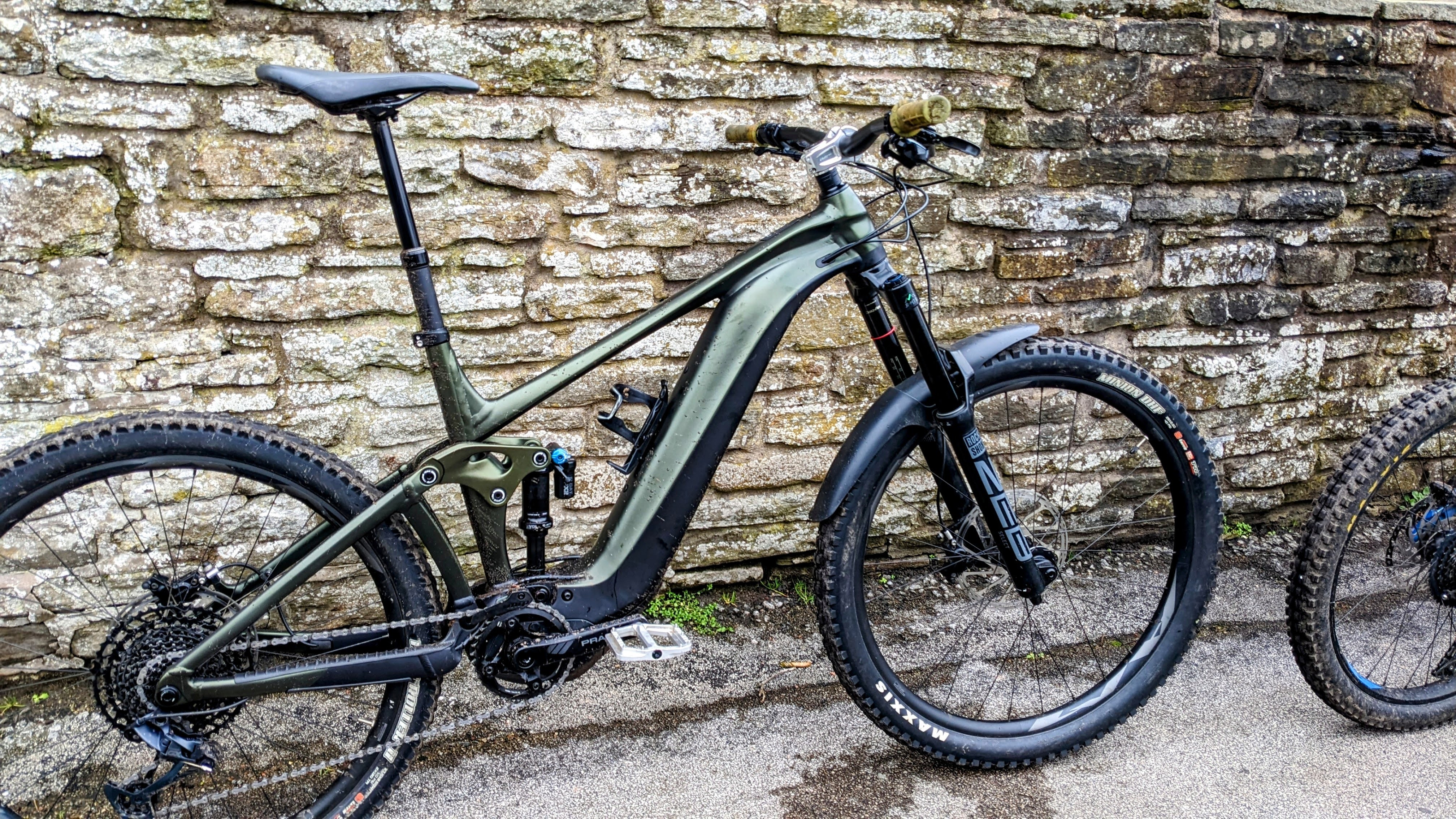

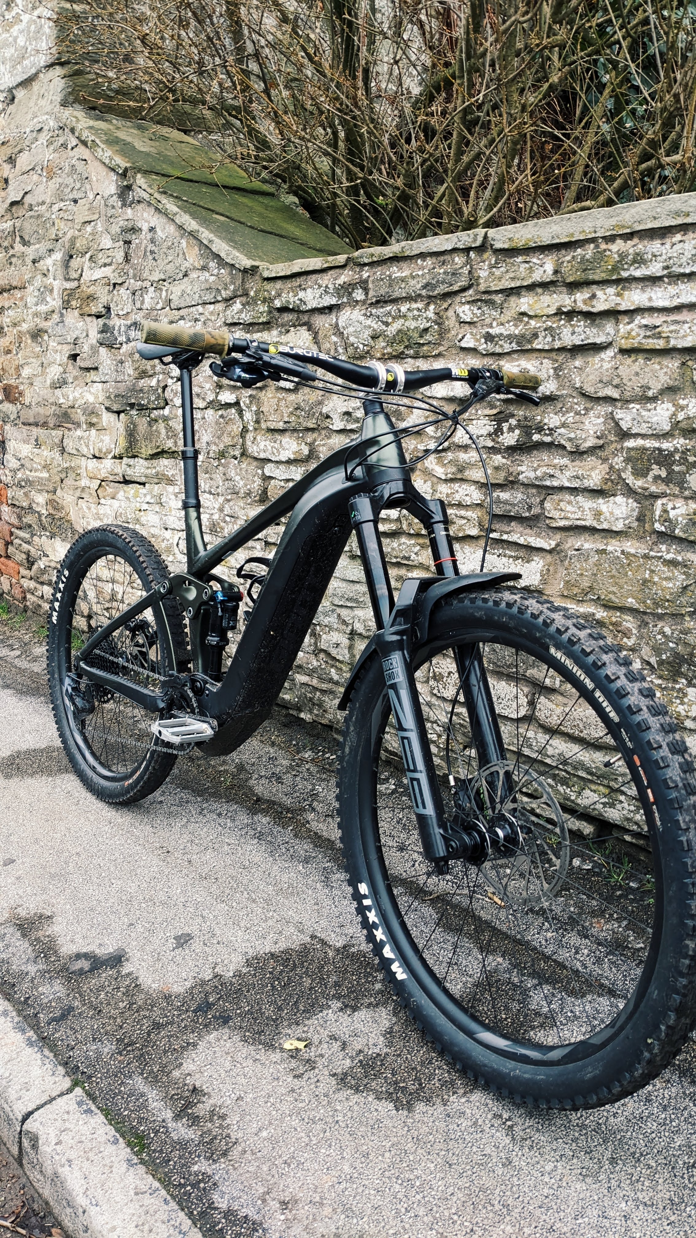

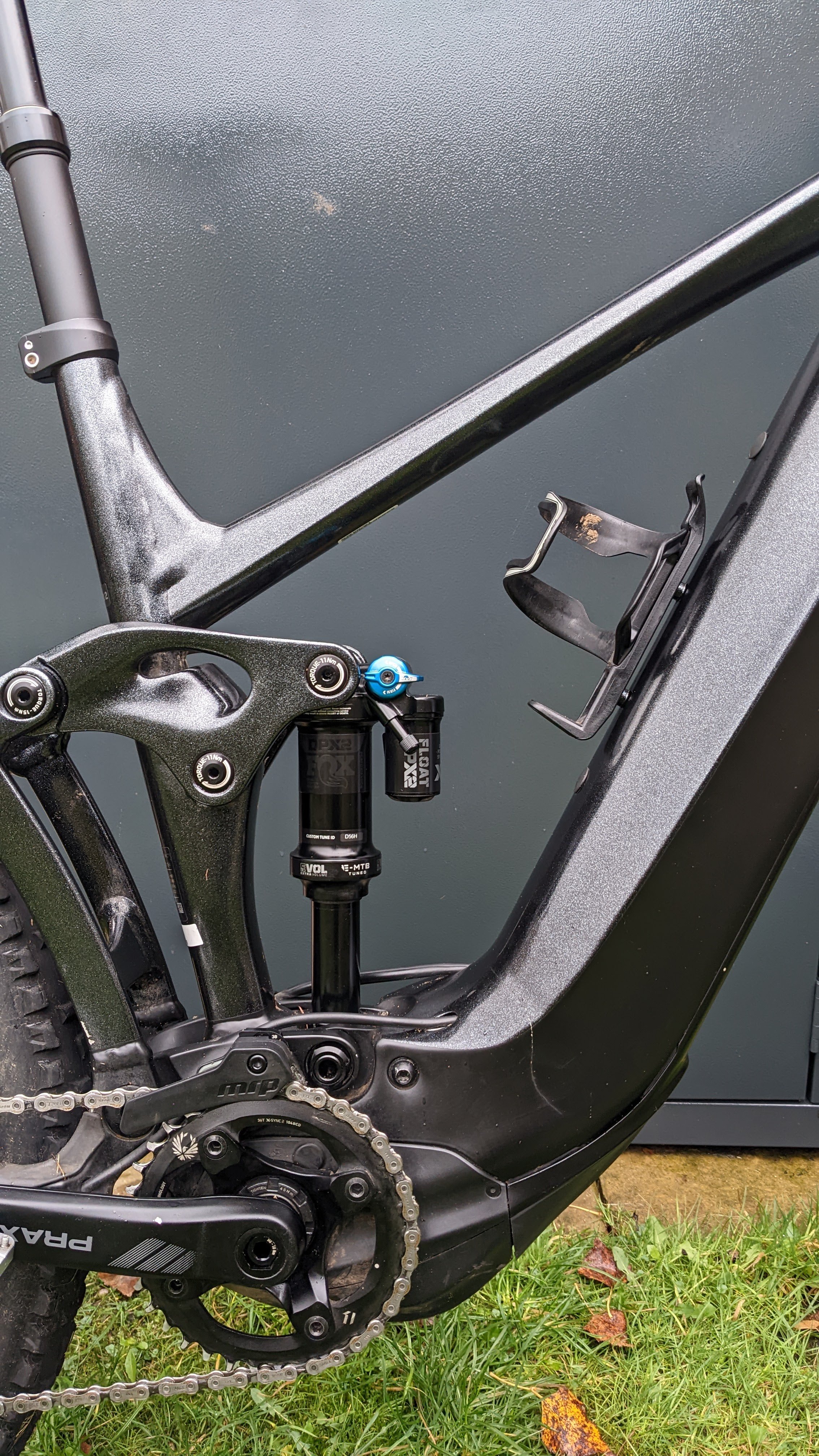

UPDATE!
Finally got my new frame from Giant, what should have been 3 weeks turned into nearly 4 months.
Long story short - Giant Europe sent a Small instead of XL, it then turned out that there wasn’t any XLs in the UK or Europe so I had to wait from one from their main factory.
I can confirm that the new color doesn’t come with the matching battery cover, no biggy though. Would recommend Invisi-Taping the frame as this color scratches easily and can be seen a mile off - No crashes, just mud rubbing on top tube has scratched it.
Still over the moon to have it back, LBS (Rutland) were great - They kept me in the loop and didn’t mind me pestering them every week for updates😊

UPDATE!

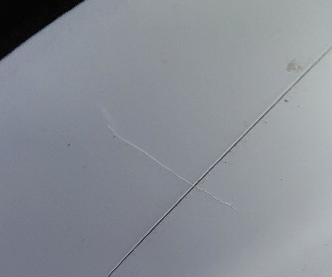

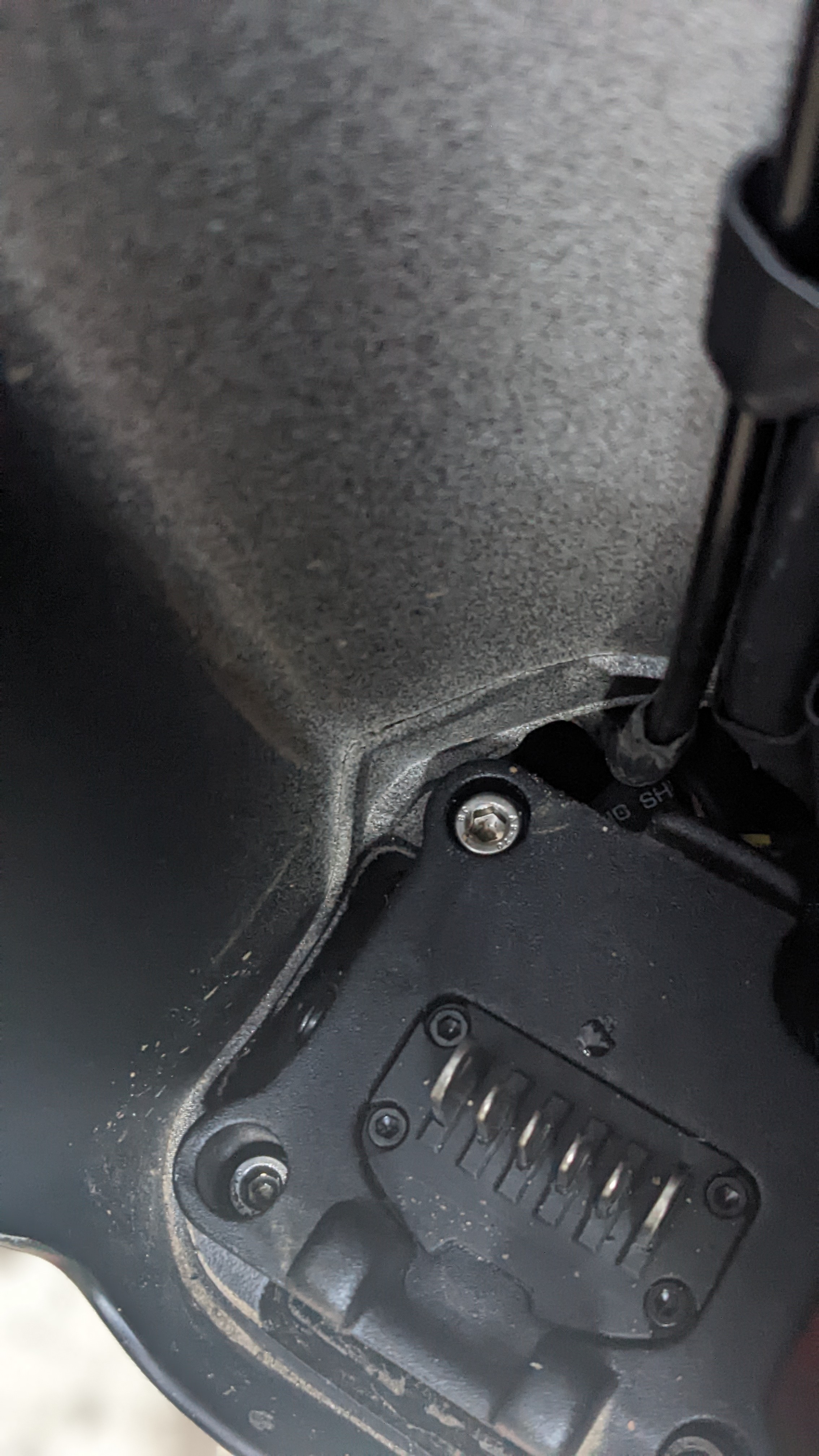

Hi, I'm also joining the club (bike has around 200km, so almost new frame). I'm thinking to keep riding the bike and take to Giant dealer later in the autumn (if the crack is just cosmetic failure). I dont want to miss the best riding season. But let's see how much it will be extending...
This is what I did with my frame. I waited for the end of the season and replaced it. Where exactly is this crack? The usual?
That sucks, there were a few horror stories on this thread of people having to wait months for a replacement, but I personally would be a bit more optimistic about delays right now, compared to the last 2 years... On the giant France website, they have the 2022 E+3 in all sizes marked as ready to ship. My tiny LBS has 2 bikes sitting on the show floor. I would be quite hopeful that if you are ok with a frame colour swap, they could sort you out rather fast.
I might just be naive though, also waiting until later in the year increases your chances of getting a 2023 frame with the issue fixed.
