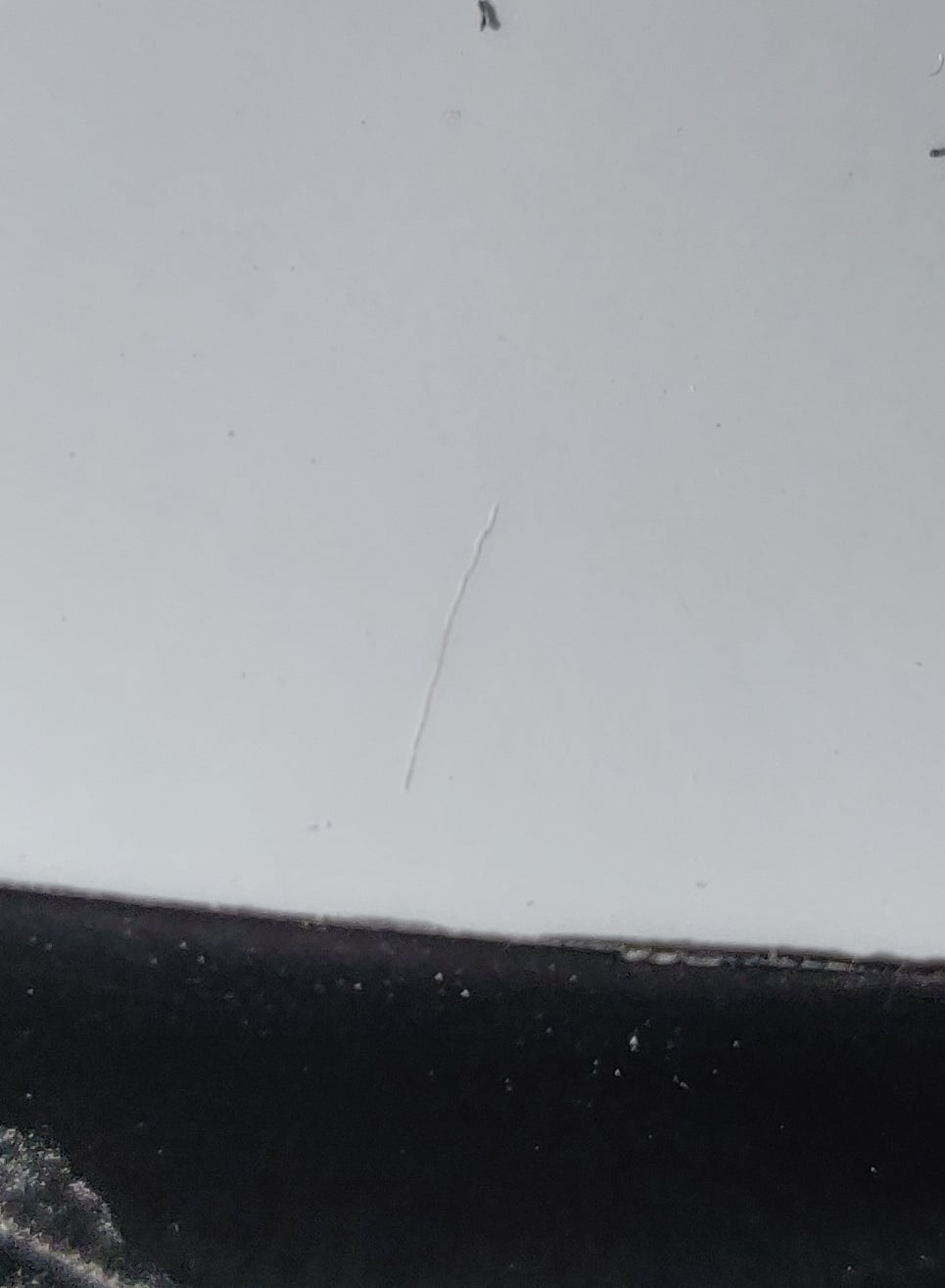

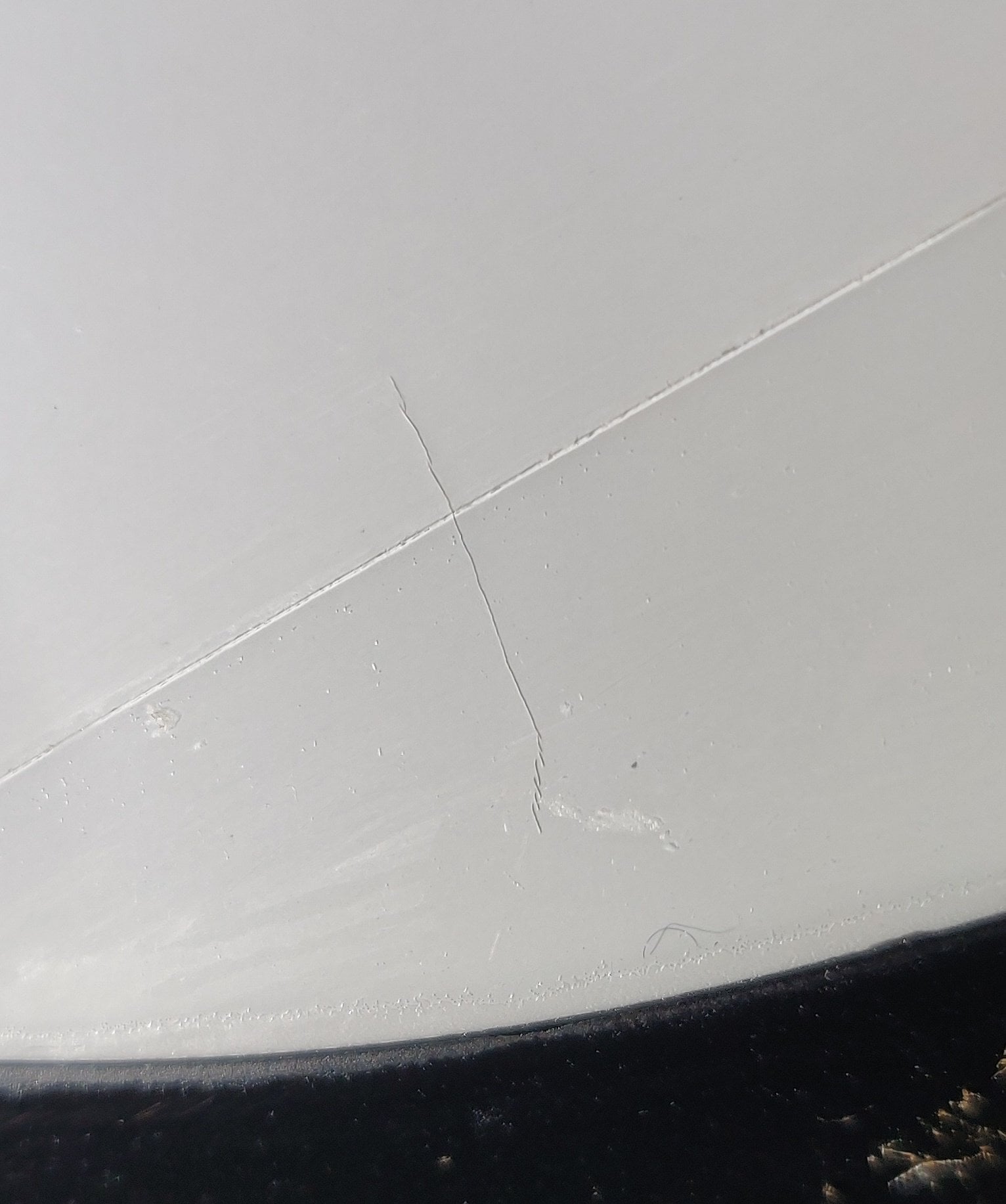

How big are your cracks? I got 2 small cracks soon after I got the bike. One is maybe 15mm long, other is under 10mm. But I have been riding now around 500km and they are not getting any longer. Also on grey paint they are practically invisible.

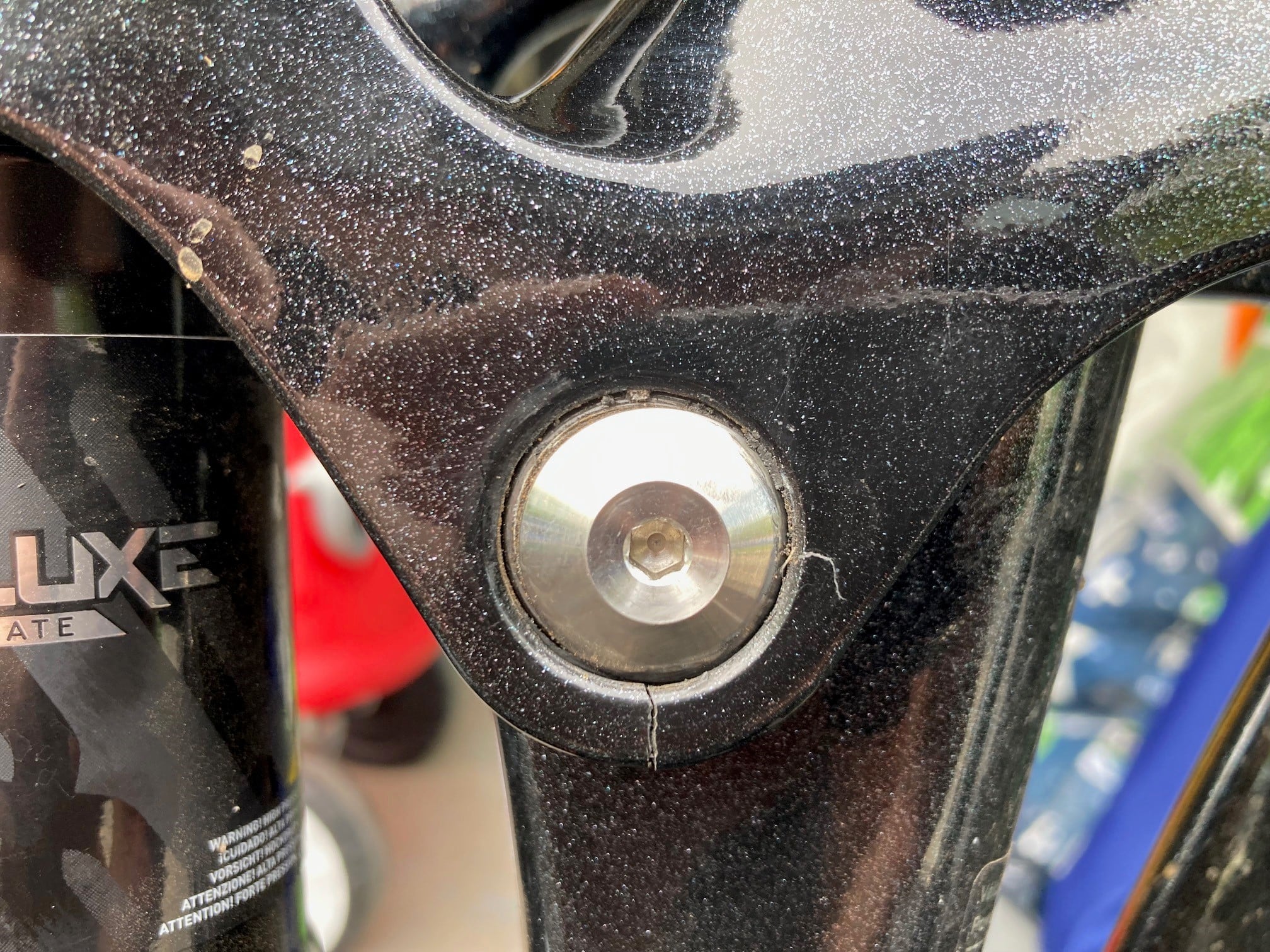

Well mine also cracked today, but on the rocker link at 2 places.
I believe it's the first time I see one cracked like this.
Crossing my fingers so Giant can quickly replace it.

My frame cracked on the rocker arm, giant blamed a collapsed bearing, but did replace the whole frame when I argued the point.

I'm surprised Giant replaced the whole frame just for a cracked rocker ? Was the frame itself affected in your case ?
I don't care if it's a collapsed bearing, bike is only on it's second summer and I'm maintaining properly...Giant shouldn't start blaming bearing for such issues.

Mine went within 8 months. They were just going to replace the rocker arm, but it had already destroyed 2 rear shocks and due to me kicking off big time insisting that the frame was twisted, replaced the lot.

I'll insist on the frame being bent as per your input and my local suspension shop saying that my shock is getting eaten on one side only.

That's exactly what happened to my shocks. Same side, same pattern, same size of damage.
Quick update after dropping the bike at the bike shop this morning.
Looks like it's really the bearing that collapsed causing the rocker to have freeplay and rocker finally cracked. Frame isn't bent or anything, but that bearing is to be watched from now on.
Rear shock damage can also be an early sign that it's starting to fail.
Bike shop submitted warranty claim this morning and Giant already approved and shipped a new rocker same day. I should get my bike back by the end of week if shipping goes well.

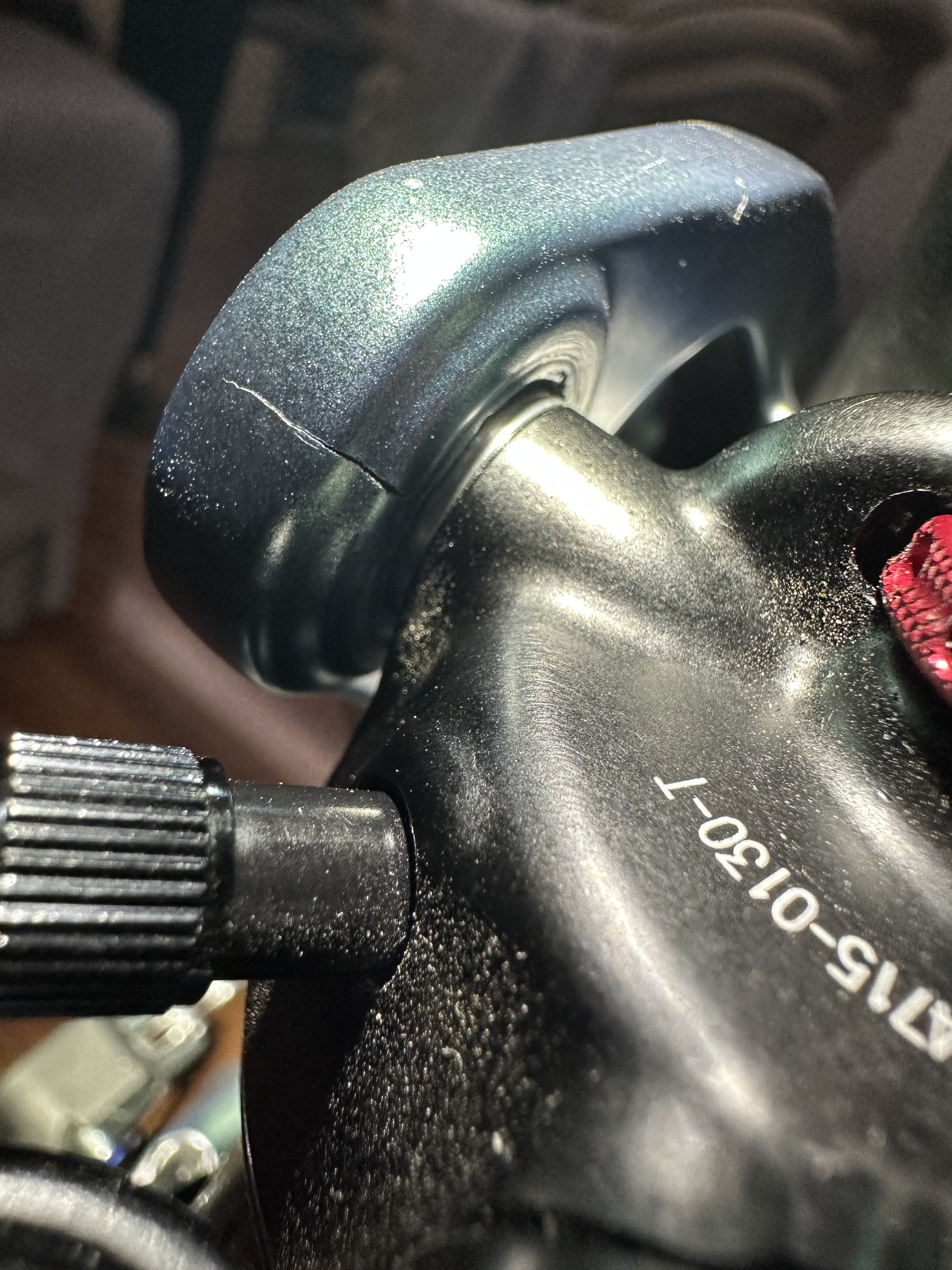

Unfortunately, my trance x adv e+1 (2023) rocker arm also cracked
Ouch, looks like these rockers are flexing at multiple locations....
Did you get Giant to quickly replace it ?
I received a response from Giant tonight, and they will replace me with a new bike instead of a new frame. I was very surprised. I thought Giant would replace me a new
rocker arm, but I really didn't expect it to be a new bike

Giant sure ain't kidding by shipping out frames & bikes for broken rocker arms, holy shit!
Great warranty service.

Maybe they know the real reason for the rocker arms cracking, like a twisted frame, but won't admit it?
The new Reign e+ is now out for almost two years and these are the first reports of broken rockers that I've seen. Or at least there are not that many that it has been heard.
every bike manufacturer has some issues especially with new frames or technology for those like ours with smoothing the welds with non movable filler. I think Giant so far has made everyone whole and not one person has been refused per this forum.

I just talked with my bike shop and they just received the rocker arms today and working on my bike right now, so Giant are not replacing every rocker claims with bikes or frames.
Not a lot of Reign E+ yet (only 2 cases in this thread), but there are more cases of regular Giant Reign cracked on the rockers, could be a fatigue thing combined with bearings wearing down....still strange on bikes that are not even 2 years old.

4 giant frames replaced by J E James in Rotherham over a 2 month period at the beginning of this year. All were either a trance, or reign ebikes and all done on warranty, plus all the others that I've read about on here, something is obviously wrong in the design of these bikes.

I was referring to cracked rocker cases only.
Picked up my bike yesterday, claim & repair took 8 business days total which is pretty quick.
