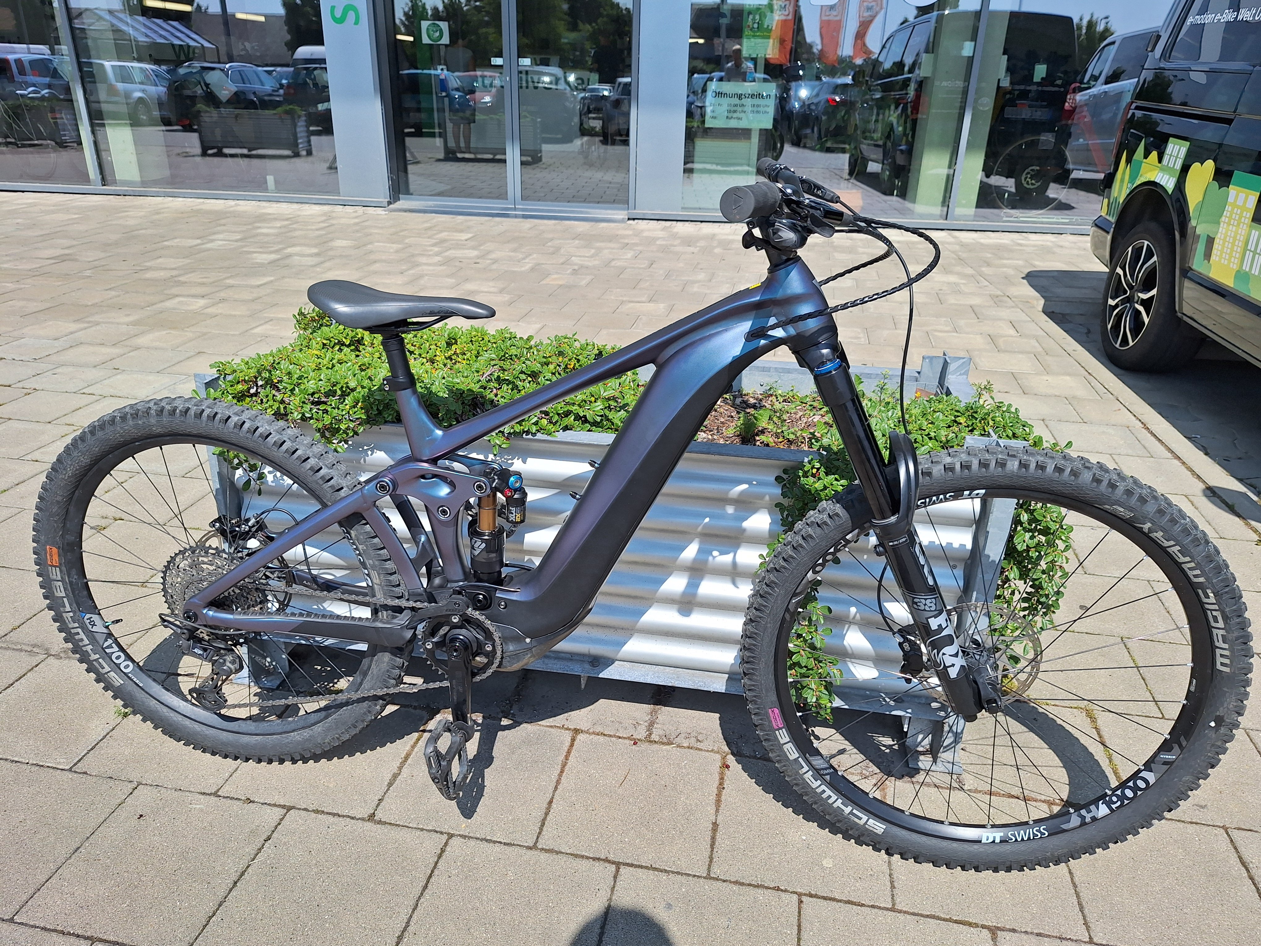

I had my Reign frame replaced just recently. I bought the bike from an internet store in Germany in 2023. I noticed the crack (in the usual place) since almost the bike was new. I kept riding because it was almost invisible and did not get any larger over the time. Then when the bike was almost 2 years old, I took it into a local shop to get the warranty process started. In a few weeks I got confirmation from the local Giant dealer that I would get a new frame for free. But, because I did not buy the bike from the local store, I have to pay the installation work partly, it was around 450Eur. Giant paid also part of the frame installation work, maybe around 200Eur.
Warranty process started in February and the new frame arrived at the local dealer in early June. So it took 4 months! The good thing was that I could keep riding while waiting for the new frame.
So in your case, as you bought the bike from Austria, you should be able to get the warranty process started there.
My old frame was white/grey and new is "Blue dragon fly". Looks really good at least for me.

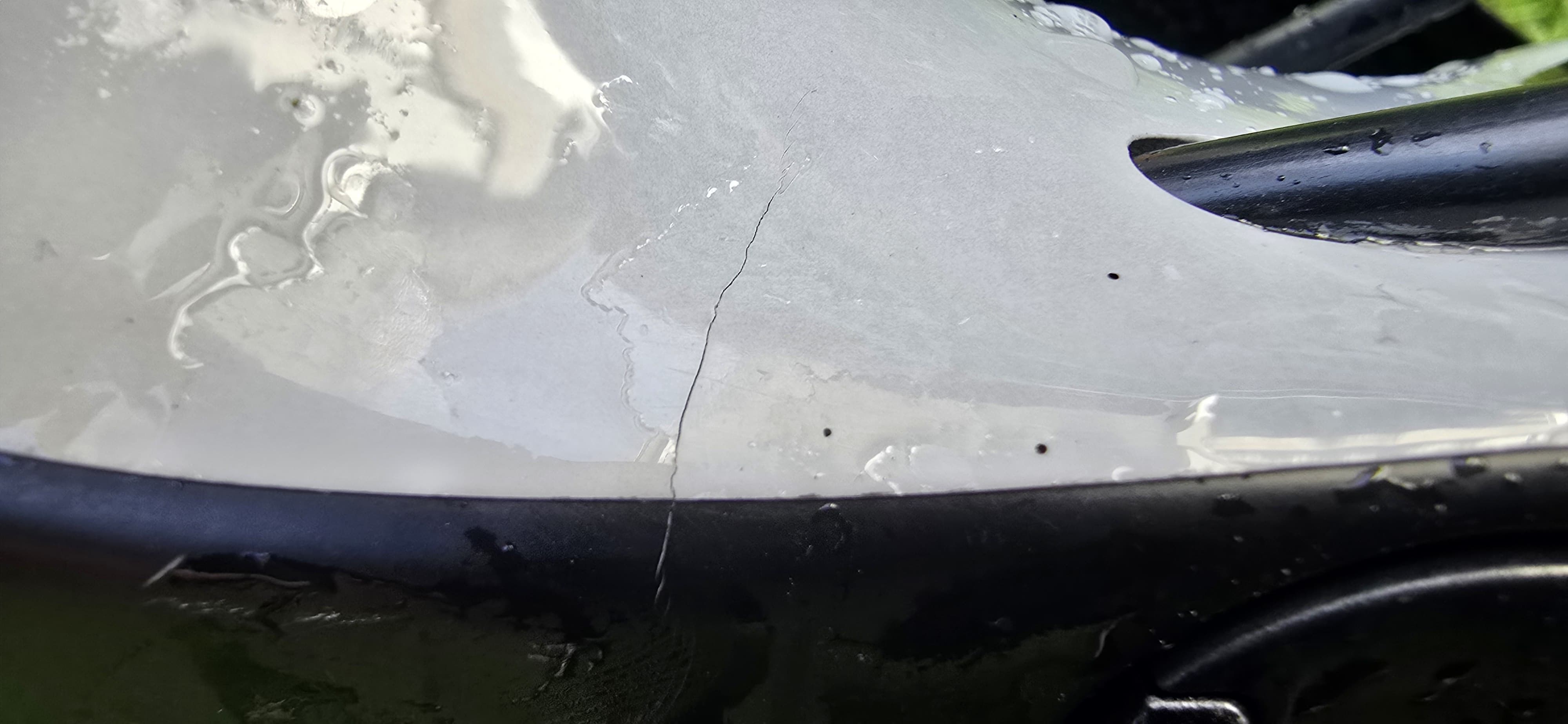

I was out on my bike today. After my ride, I noticed a crack in the frame. That's how I discovered this forum. What do you think about the crack? Paint or frame?
I was out on my bike today. After my ride, I noticed a crack in the frame. That's how I discovered this forum. What do you think about the crack? Paint or frame?View attachment 167624
looks like all the other bikes that the filler(bondo) is cracking. You could remove battery and have a look inside frame but I suspect this the same issue with the filler.
My 2022 Reign has 2500 miles on it and no cracking, I bought mine in May 2022, it seems like the ones in late 2021 and early 2022 had the filler cracking issue.
I believe Giant was replacing the frames with the issues under warranty as frame has lifetime warranty.

Yep, that's what mine looked like as well. Giant UK replaced my frame under warranty with no quibbles so hopefully you will be the same if you decide to go down that route.
As I mentioned above, I had a good look inside my old cracked frame when I swapped the parts over to the new frame and I couldn't see any sign of a crack inside.
An added bonus of getting a new frame is that it comes complete with all new rear end as well so you get new linkage and pivot bearings.
