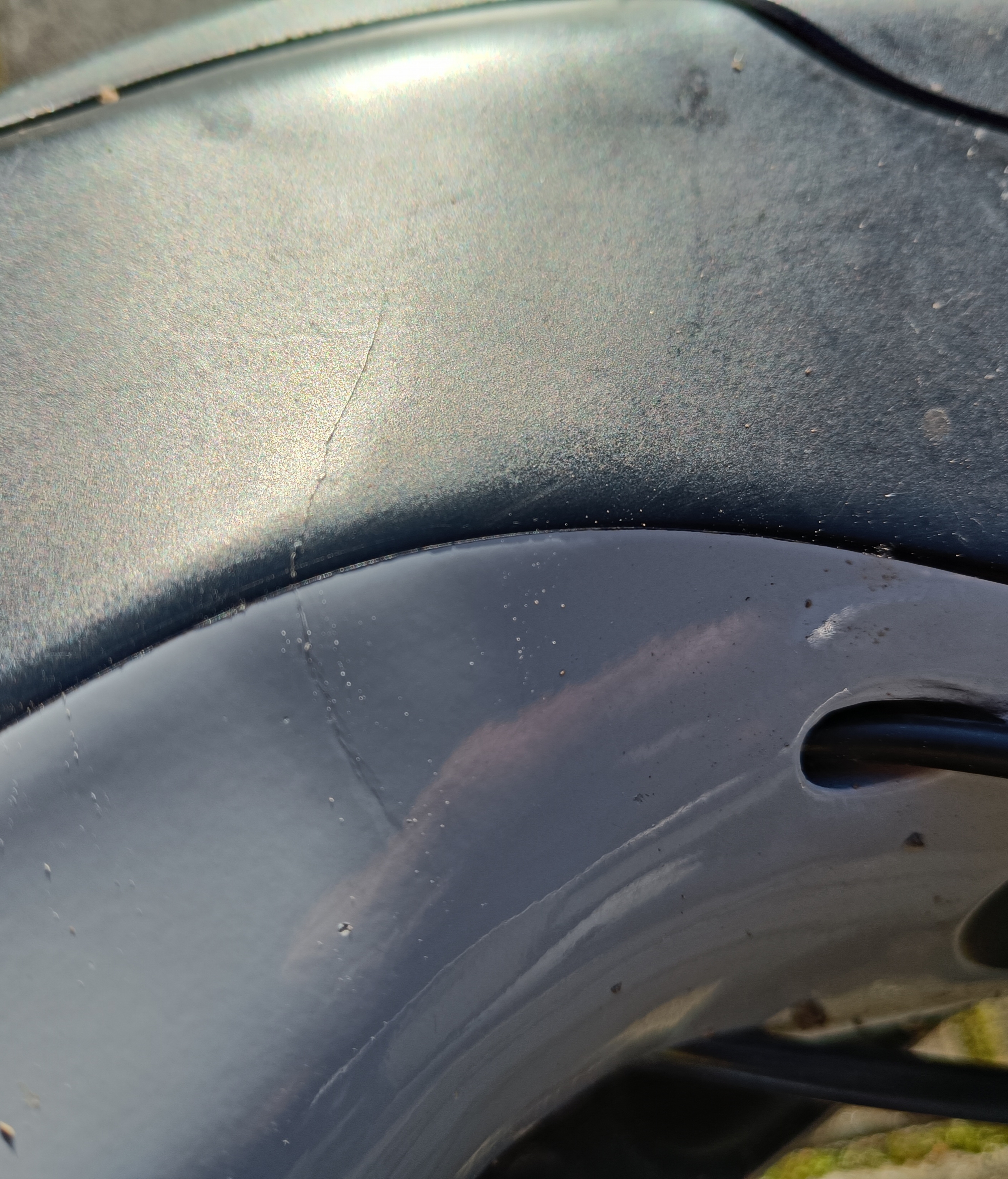

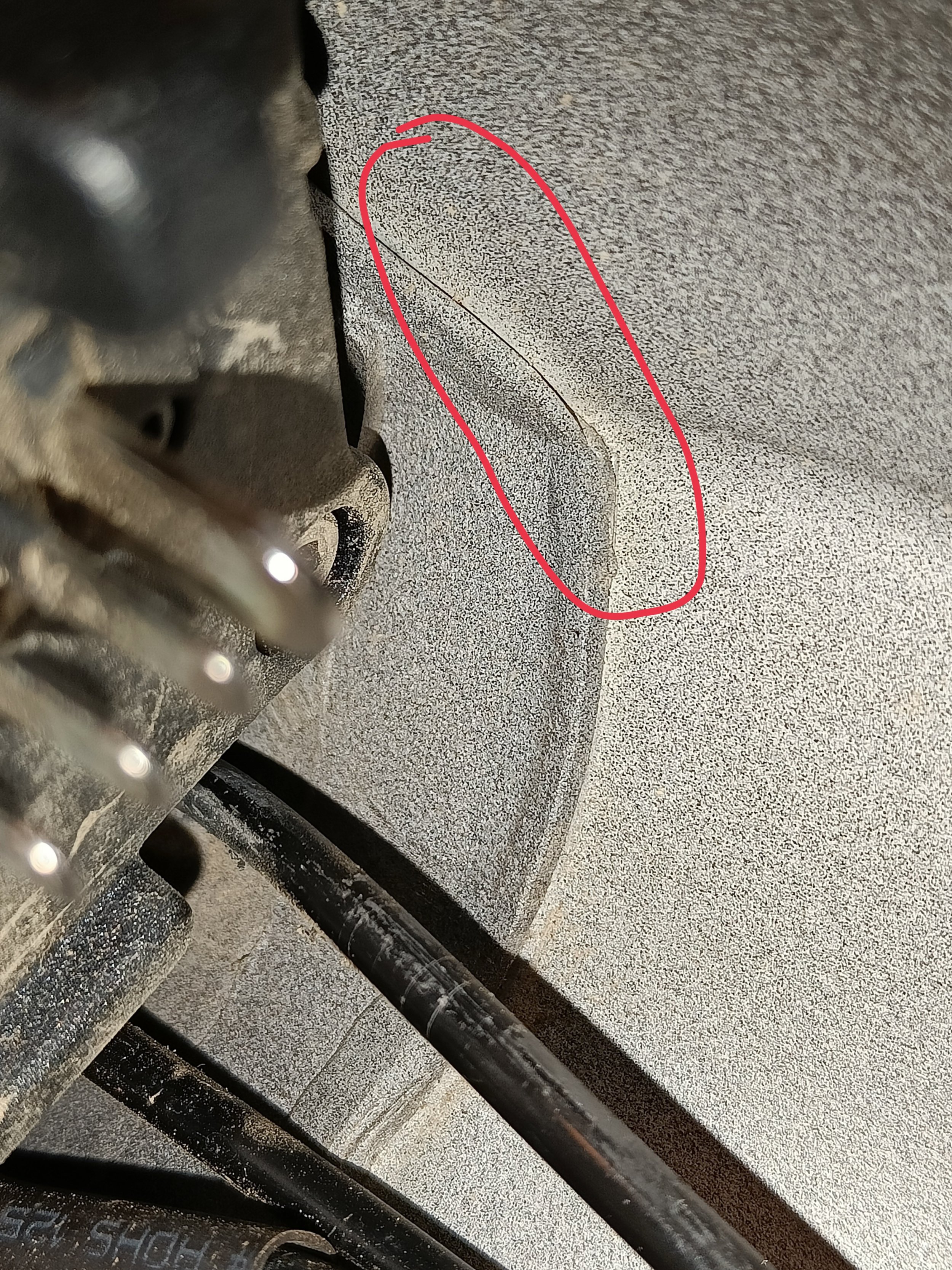

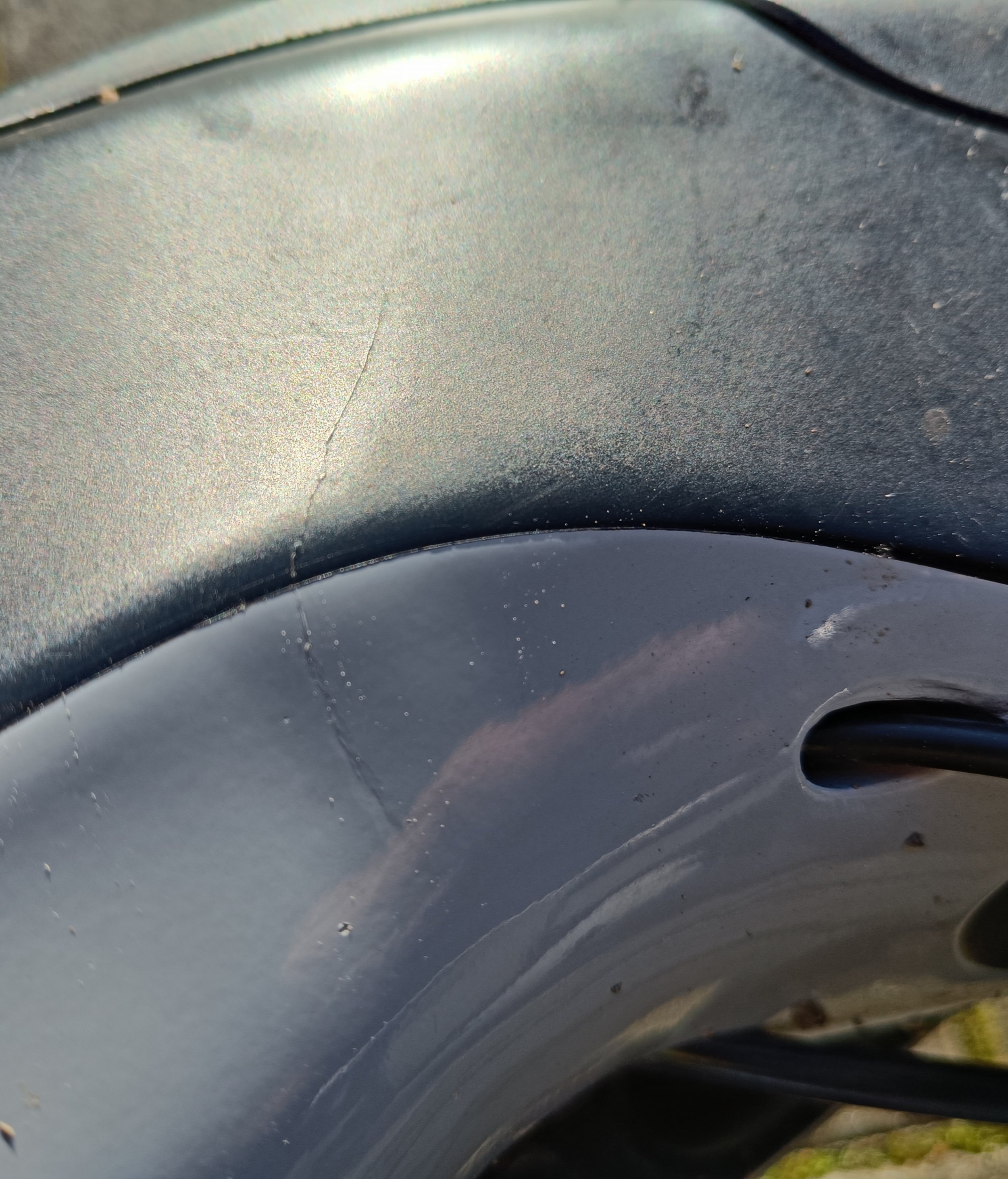

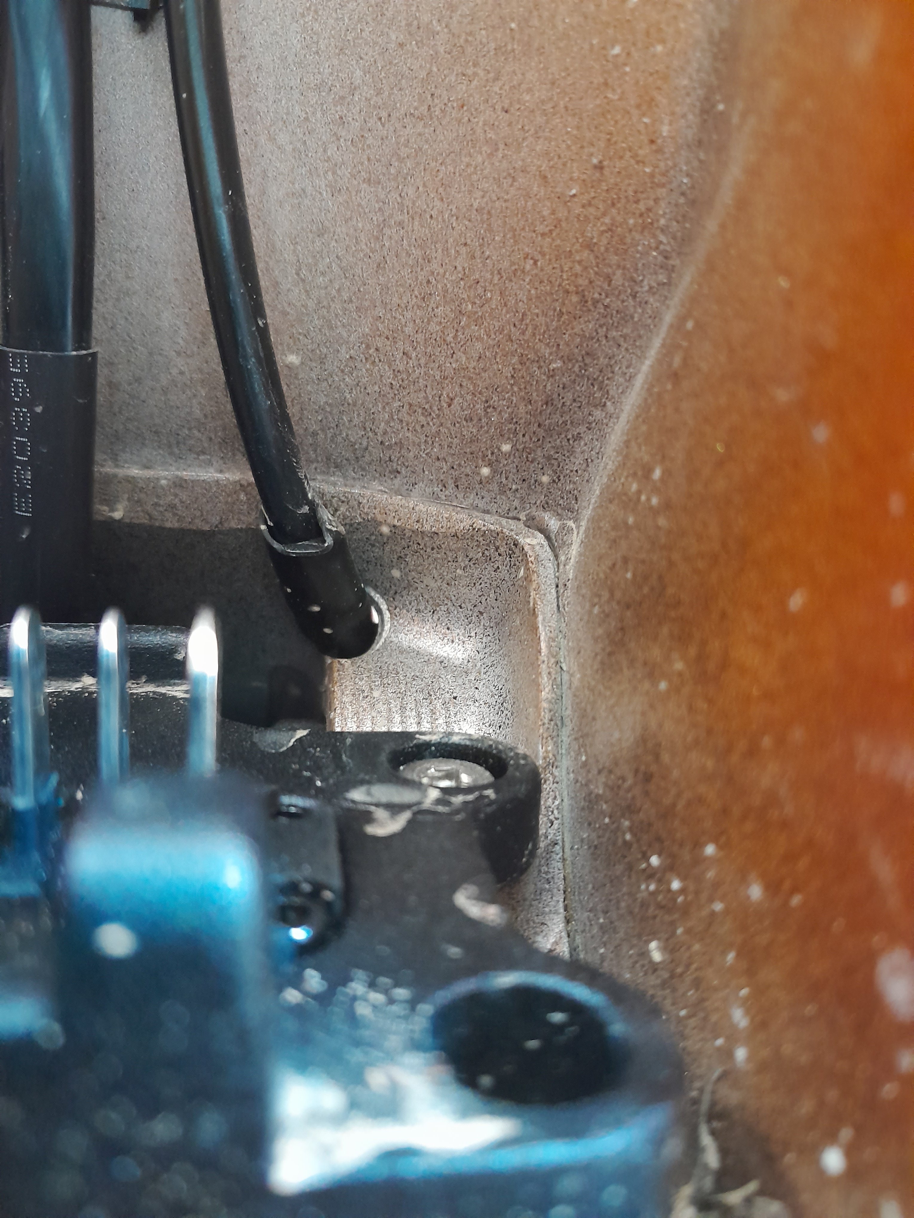

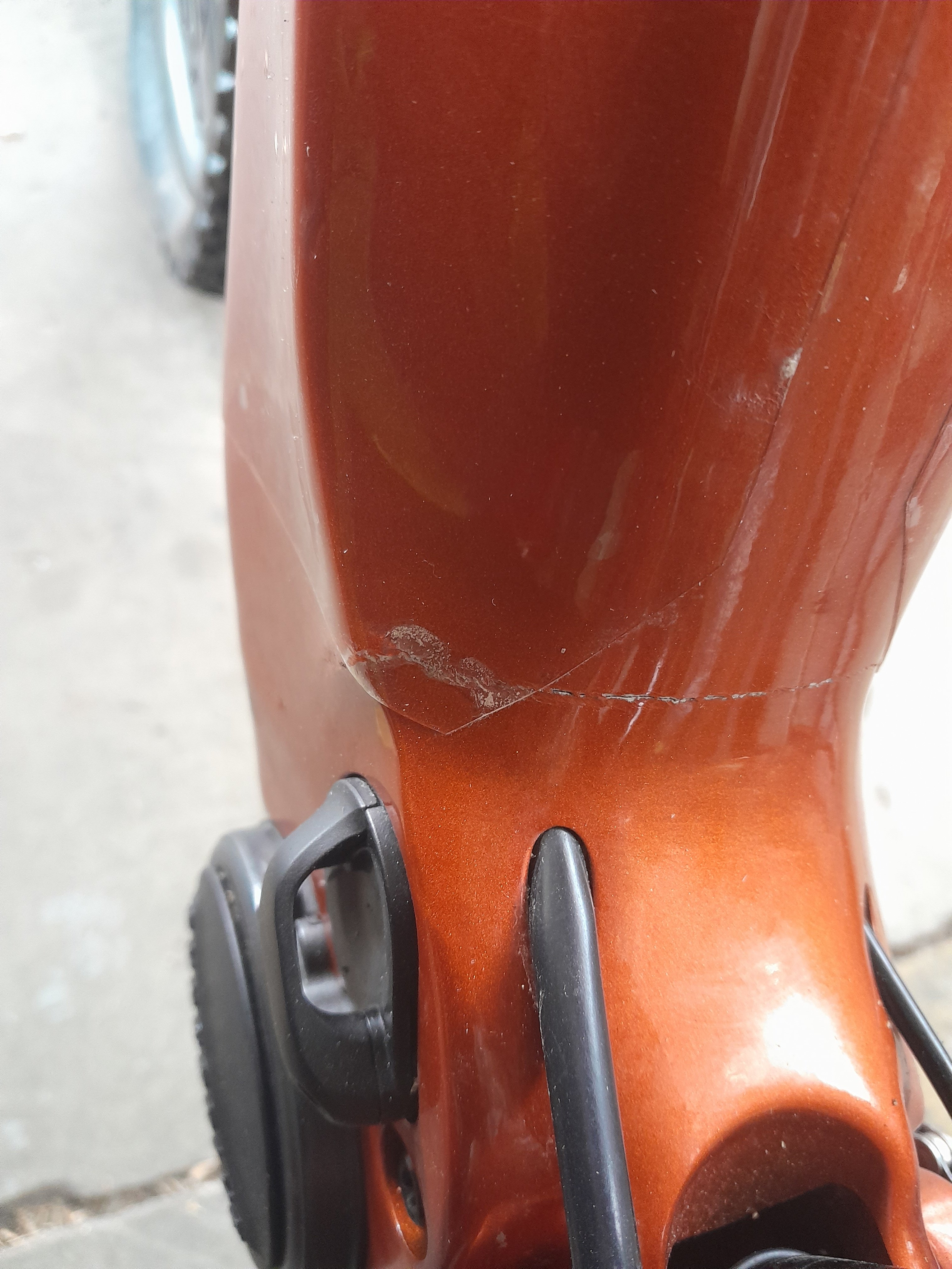

So it's supposed to just be the outer filler thats cracking and yet your pics clearly showing a matching crack inside the frame...hmm...are we saying theres filler inside the frame too..?
The filler would not break if the frame did not work too hard in this place ... It looks like a very dangerous defect. It's all about the user's life.
Yeah it seems very suspect. I guess a law suit when someone breaks their neck will sort it out. What's with this world right now? Corporations and Governments are literally getting away with murder.
It's just one or two guys saying it is 'Just the filler" isn't it? Pretty obvious from the start it was the frame cracking. Good to see Giant getting swaps made.

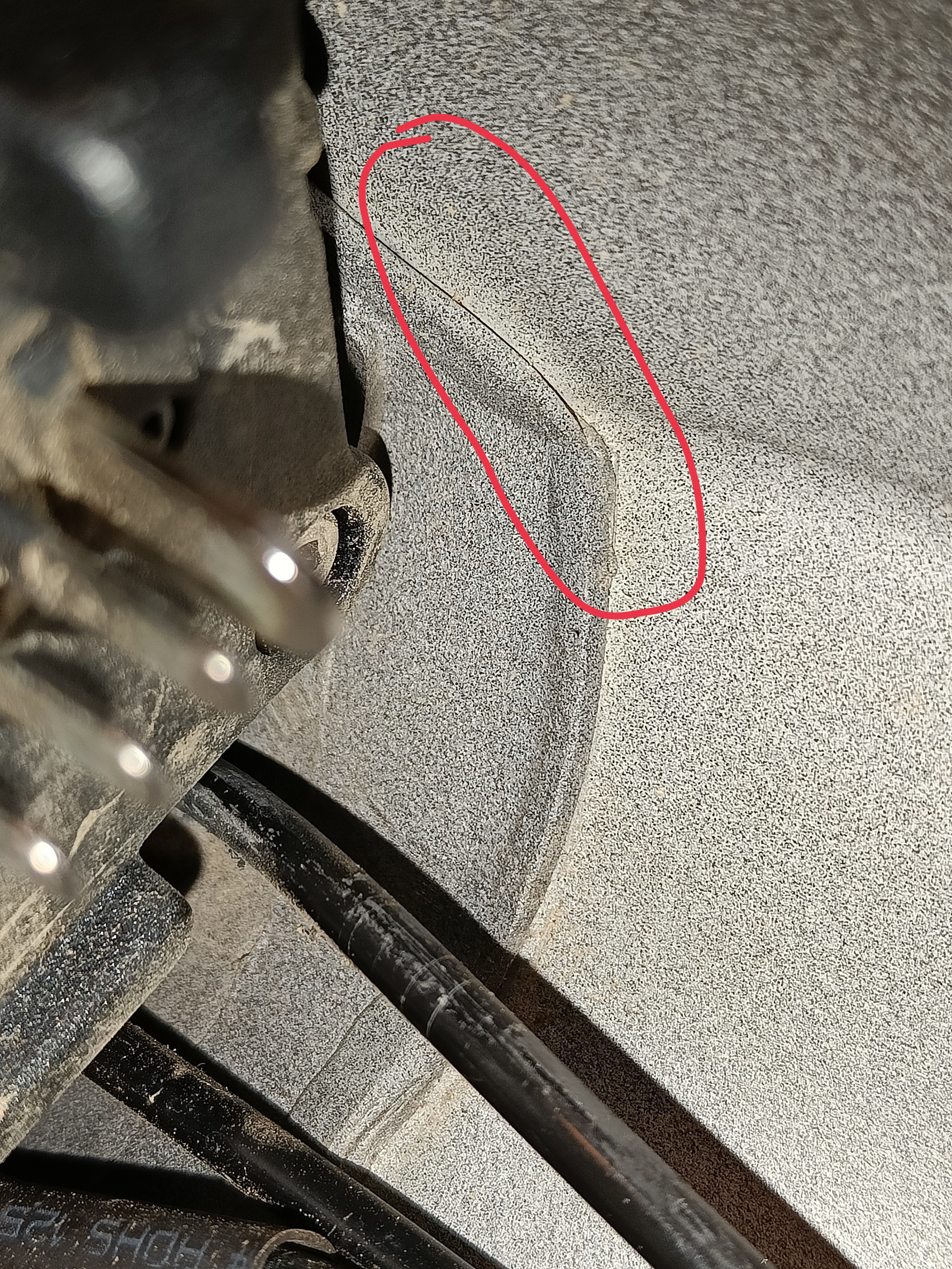

my frame has inside and outside crack ,i believe what i'm seeing.... and non of this in facebook and forum guys are professional or tell the truth ... if you want you can trust them but not me .

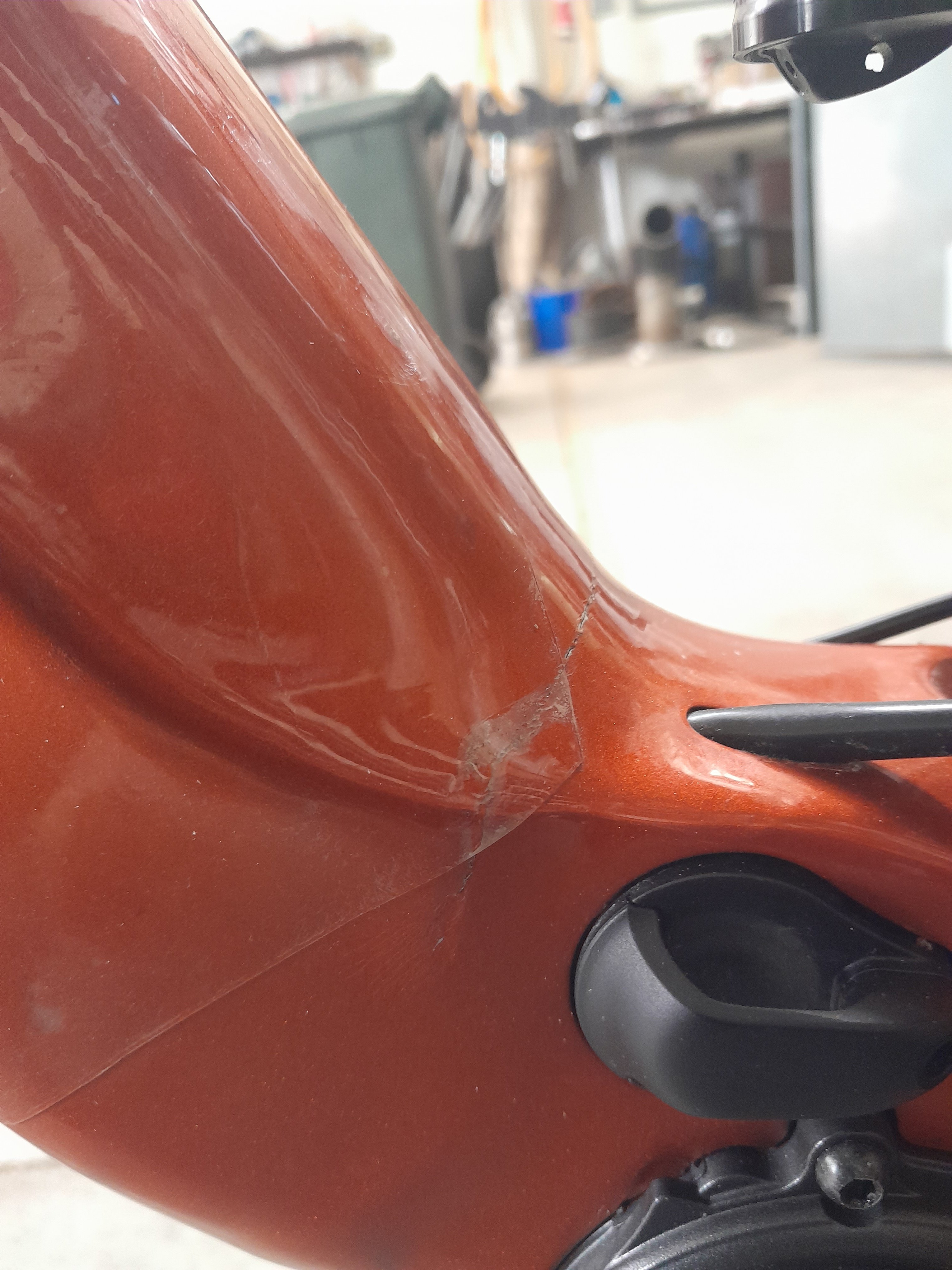

The history of this is that Giant announced a "new" welding technique...............and Giant make frames for a number of brands some of whom may have a greed to that construction method whilst others may have declined. We have seen frame failures in some other brands. The part of the frame in question here is where the down tube joins the bb section that houses the motor. Personally i do not believe there is a "new" welding process........or at least not a new process that would be applicable here. I suspect the join is bonded using a collar ( which is visible looking inside around the battery connector). Nothing wrong per se with bonding aluminium rather than welding it and if one of the sections is 7075 rather than 6000 series ally there are few other alternatives. So yes there would need to be a small amount of filler around the face to face part of that joint. The cracking of that filler does not mean any part of the ally tubing or motor frame is cracking but what it does mean is that the bond is not secure and untimately it will fail. So Giant are not replacing frames due to a cosmetic defect ( filler crack) , they are replacing them because the joint is starting to fail.
Ultimately believe a combination of the compression and torsional force on that joint make the bonding process the wrong choice of construction. It maybe cosmetically more pleasing but more probably an easier joint to make on the production line that was the reason for going for bonding rather than welding.

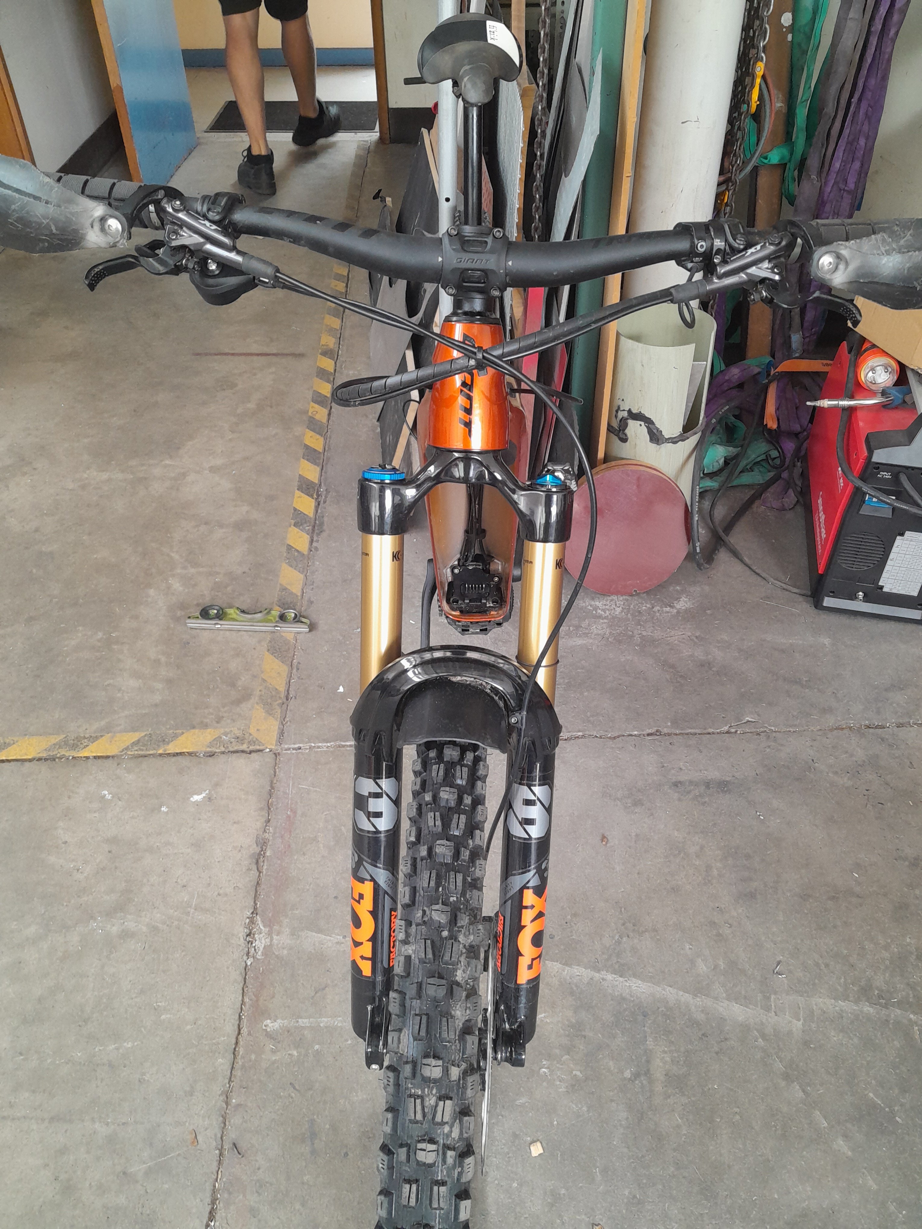

Here's my new giant trance e1, 1hour of use.
The frame is cracked through.
The frame is twisted about 4degrees.
However I fell off it to do the damage, between 5-10kmh. BUT I fell off because the wheel buckled going around a corner.
Pretty disappointed, had it for 3 days and only got the one 15km ride.
Never had a bike fail this easily, not even close.
