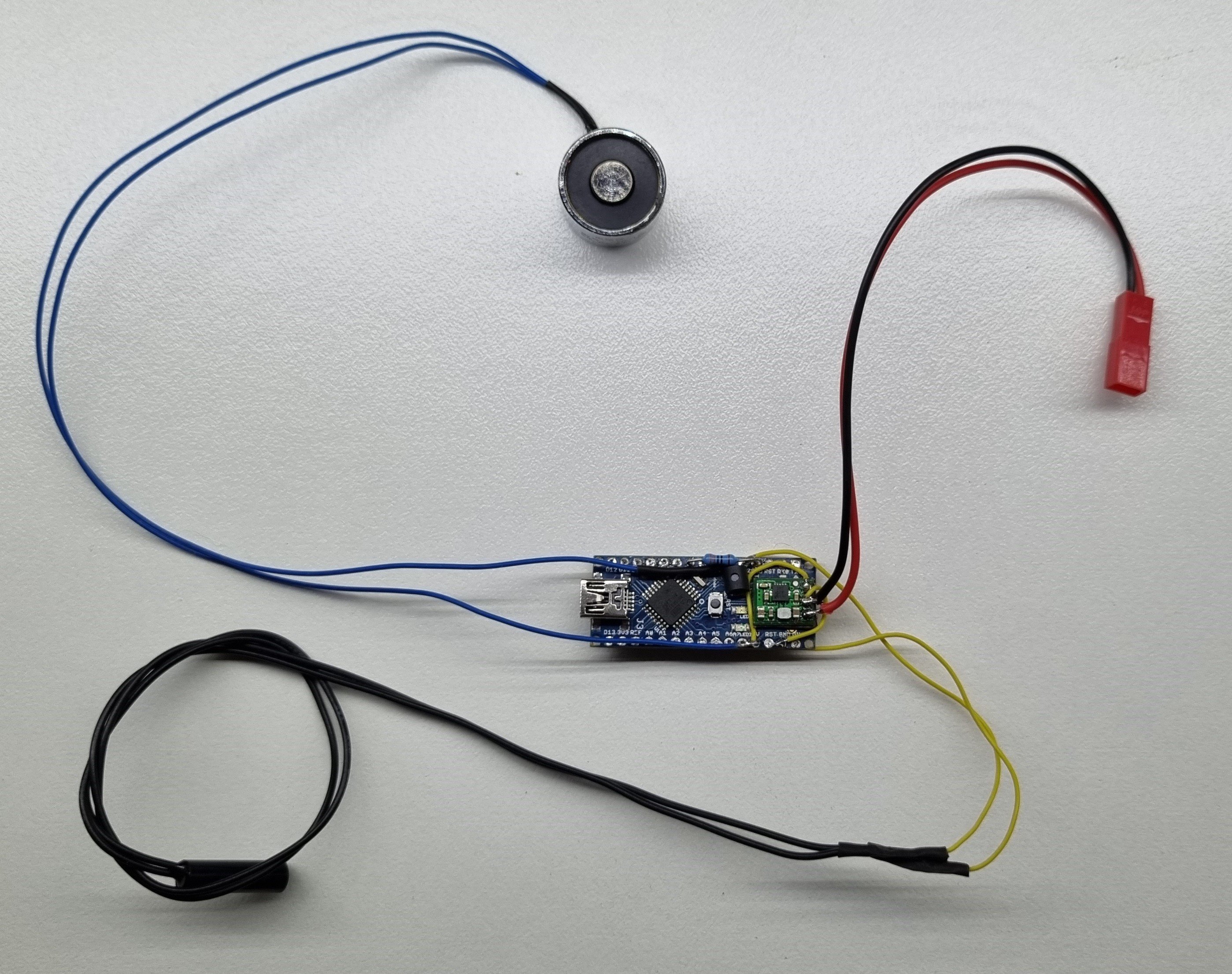

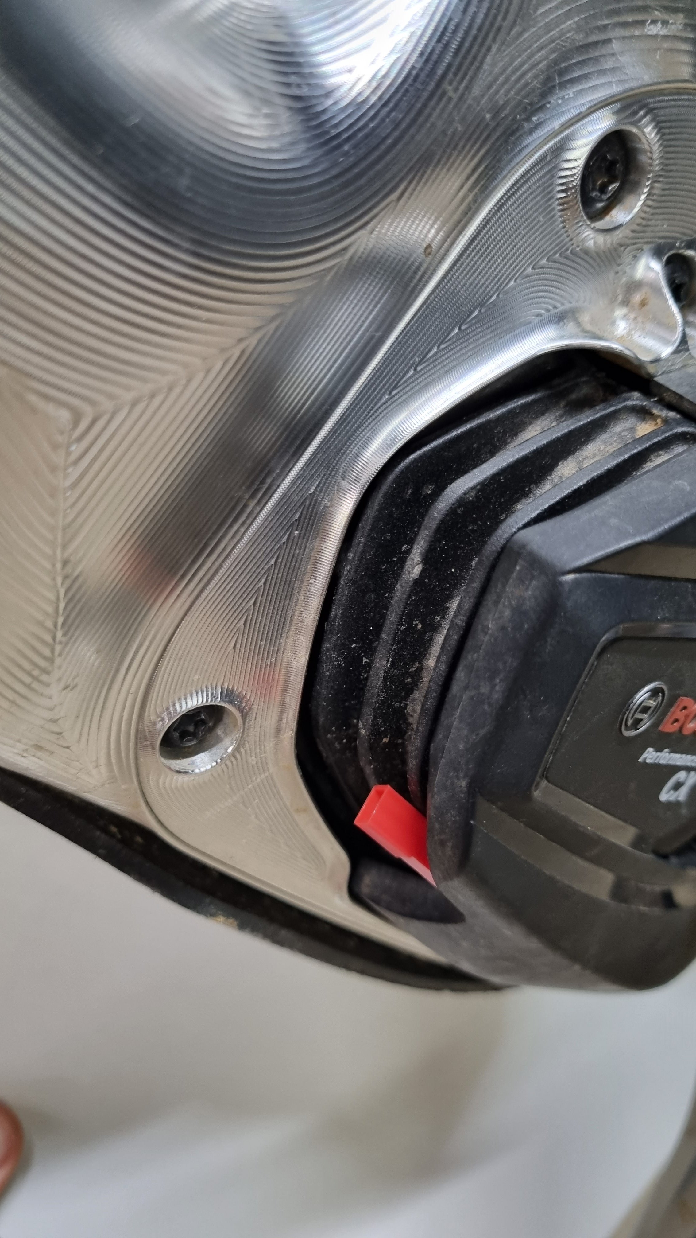

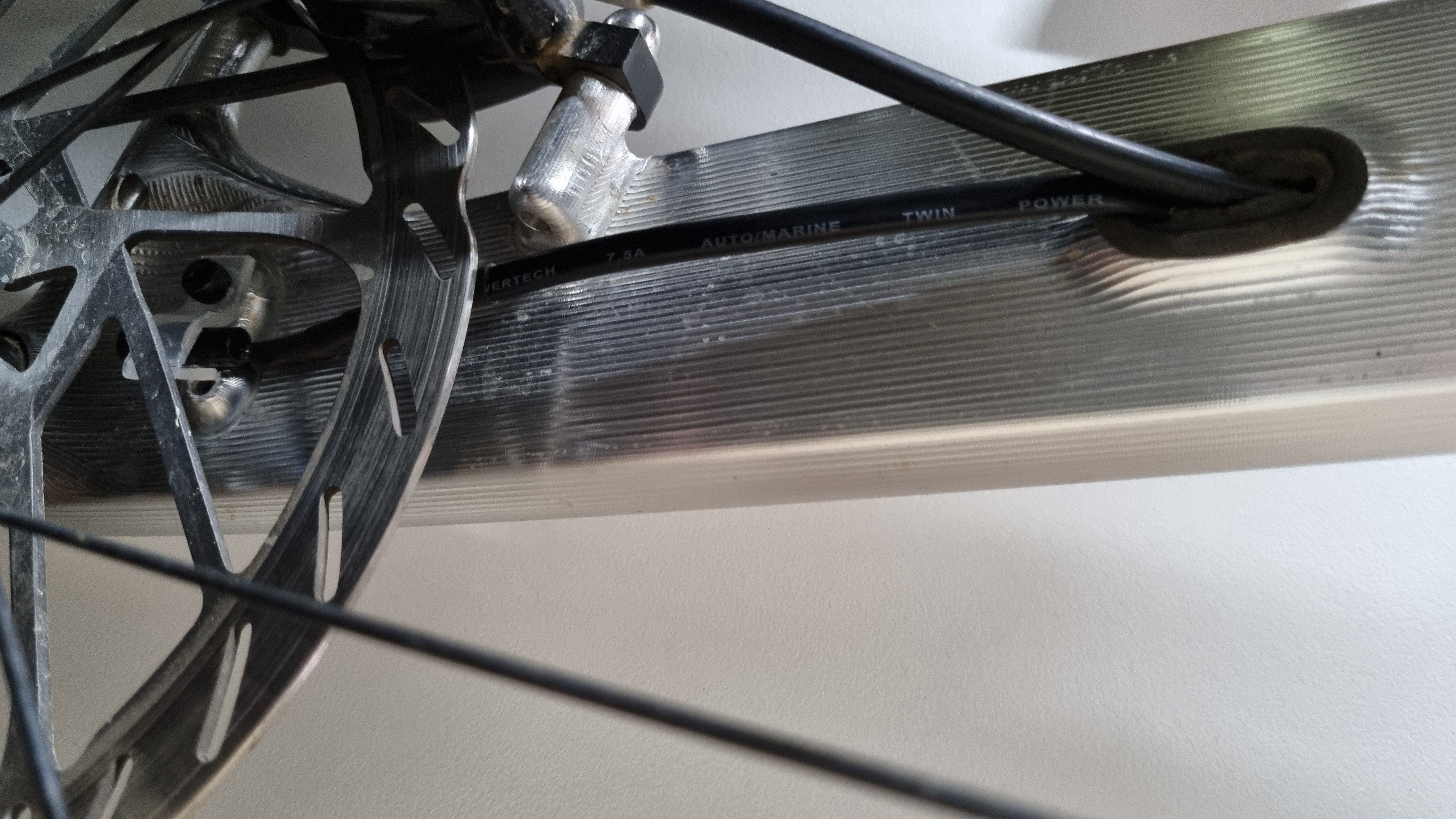

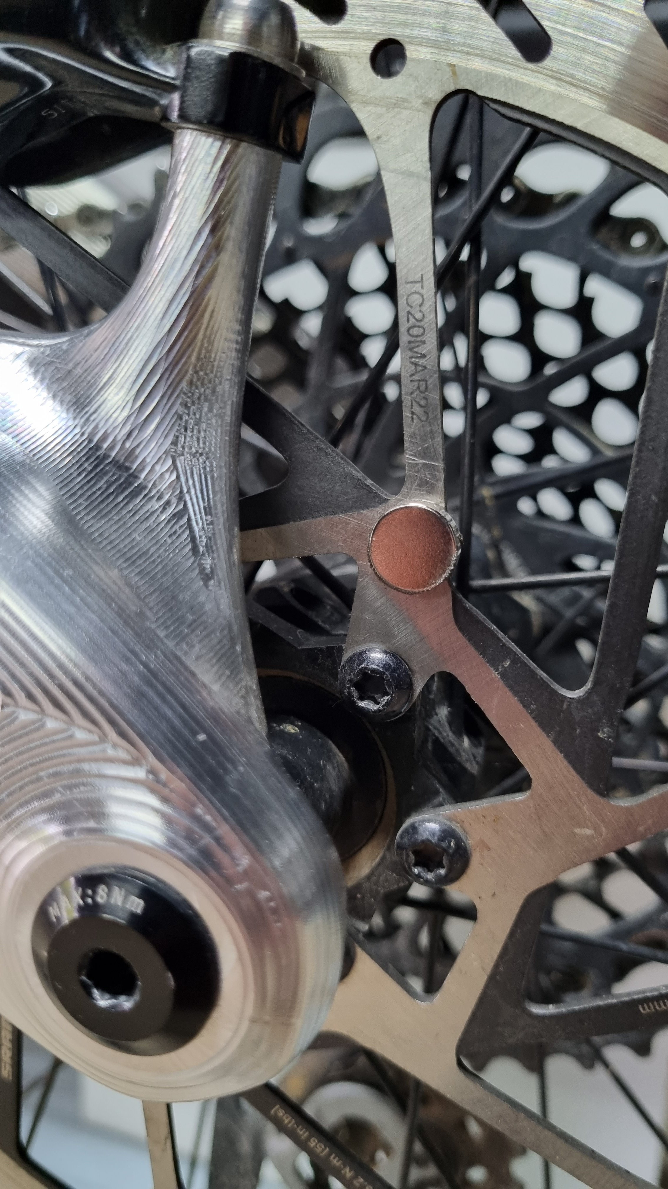

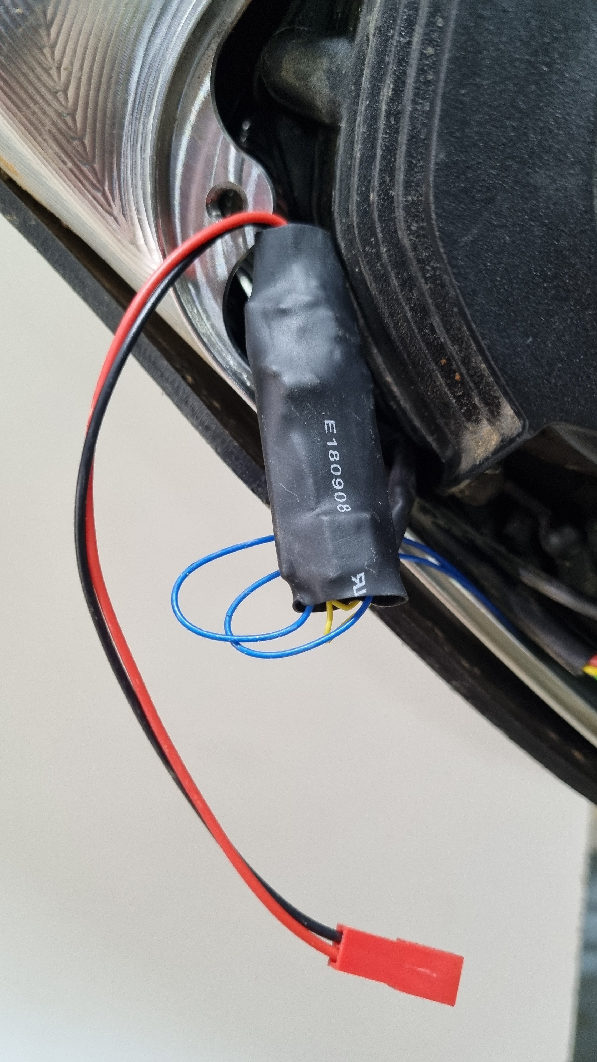

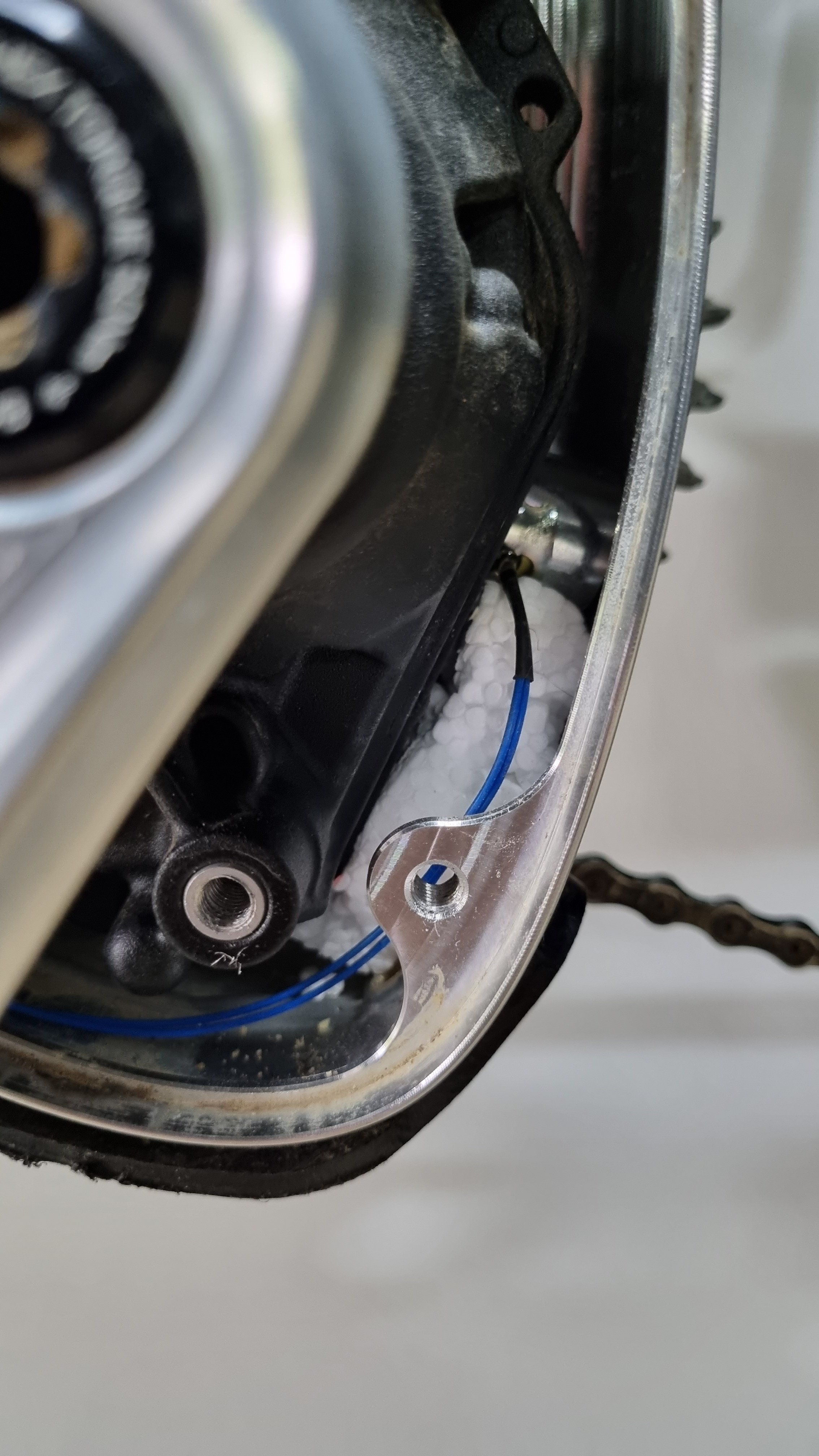

Finally gave up waiting for Eplus to get their unlocker done to suit the rim magnet. Instead, I built something quick and easy that works well, costs a fraction of the price, and should even work for standard setups without the rim magnet.
My build is based on an Ardunio microcontroller, reed switch and electromagnet. I removed the bike's rim magnet and instead placed a traditional magnet on the disc rotor. The Arduino then uses the reed switch to sense the true RPM of the wheel, delays the time between magnet passes by a fixed multiplier and then activates the electromagnet at the new interval accordingly. The electromagnet is positioned up against the motor case.
With ~100 lines of code, everything is working great. I've got the multiplier set to 1.4 (eg where true speed is 20kph, motor will be shown 20/1.4= 14.3kph), giving a new max assisted speed of 35kph. The multiplier could be set to anything, say 2 would give assist to 50kph.
The beauty of this setup is the simplicity: no interruption of sensors from the motor, reducing chance of detection. So long as you don't go crazy with the multiplier, it'd be very difficult for the motor to detect this manipulation, as there are so many real-world variables which will mask it; rider weight, gear ratio, terrain etc. Some things may give it away though. For example, if you use a large multiplier, you may reach a point where for a given cadence it's just not physically possible to be traveling so slowly. Also if you use location tracking through the Eplus app, it may compare wheel speed with GPS speed and flag a discrepancy.
I've run this for 60km so far without a hiccup. Granted it's not a long way, so time will tell how it goes in the long term. At the moment I'm powering this with a small lithium battery sitting externally on the motor. Next step will be to try to get some power from the internal battery to simplify further.
Some FAQ:
  • YES it will disrupt your total trip distance and odometer, but it's a simple multiplication to get the true figures. ie reported trip distance * chosen multiplier = true trip distance.
  • YES it should work on setups without the rim sensor. Instead of positioning the elctromagnet against the motor case, position it against the speed sensor.
Some photos attached of the setup on my Voima. If anyone's interested I can put together a tutorial so you can build your own.
20230119_160306.jpg 20230120_124119.jpg 20230120_124155.jpg 20230120_124226.jpg 20230120_130427.jpg 20230120_130607.jpg
Interesting. If it works for an extended period of time I’d be interested in one.
Well done.
If your code contains decent windowing(to replace signal conditioning) for the input signal, it will work good.
The difficult part is now to get it automotive compliant, but I doubt if all those commercially available are.
That's why many of them start to fail after 3-6months.
If restart problems start to occur, drop the next one completely in resin, an easy first improvement.

The code measures both the time between magnet passes and also the duration of the magnet pass itself, to ensure electromagnet activations mirror a standard magnet pass. Couple of other functions included to manage the ever-changing time between passes while keeping the longer duration electromagnet interval in check.
Again, it's the simplicity which makes it reliable. Sure, it's not going to catch up your actual KM when you stop moving like the commercial products do, but frankly I'd say that's a prime way for the motor to detect the device - who rolls for 15km without pedaling?
As for the physical reliability, you're right, certainly could be improved. For the moment I've just encased the Arduino in heatshrink. The Arduino itself was one I had laying around, so already ~5yrs old! Probably could paint on some liquid electrical tape as well before the heatshrink. The reed switch at the back wheel is already waterproof.
EDIT: One last point on power consumption. The device seems to consume ~60ma per hour of run time. I'm running it on a 300mah single cell lithium battery @ ~6grams, so should expect to get four hours use from it before a swap is needed. Probably could do with a bigger battery in the future.
... I'm running it on a 300mah single cell lithium battery @ ~6grams, so should expect to get four hours use from it before a swap is needed. Probably could do with a bigger battery in the future.

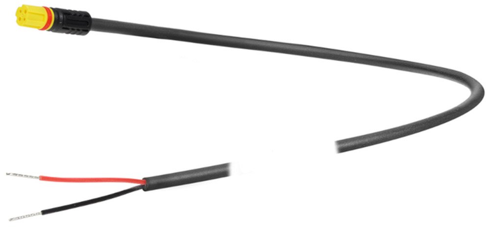

Do you have any info on the pins in these ports? Looks like they're four pin but I can't find any info about what is what within them.
The blue one is for a headlight and only uses 2 pins of the 4 holes. The red one is for the rear and both of those need to be turned on by a Bosch dealer. I just added a headlight on mine and had my local bike shop/Bosch dealer turn it on. They also have variable input voltage to those ports set by the dealer according to the lights requirements.

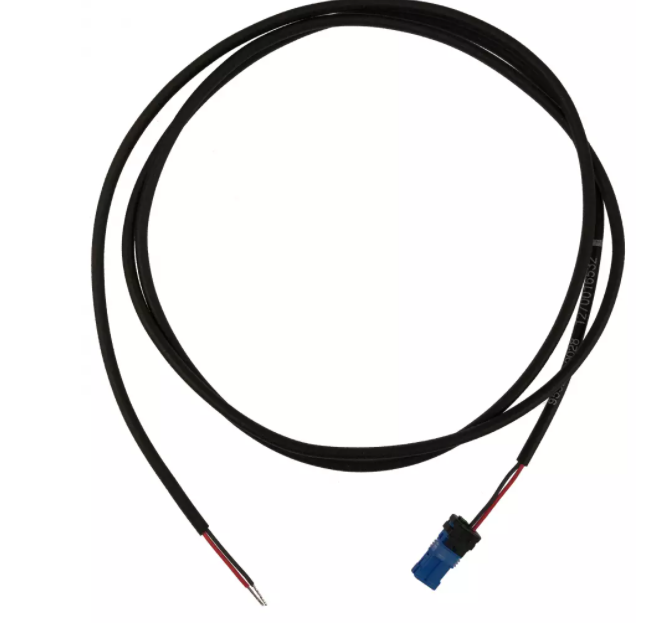

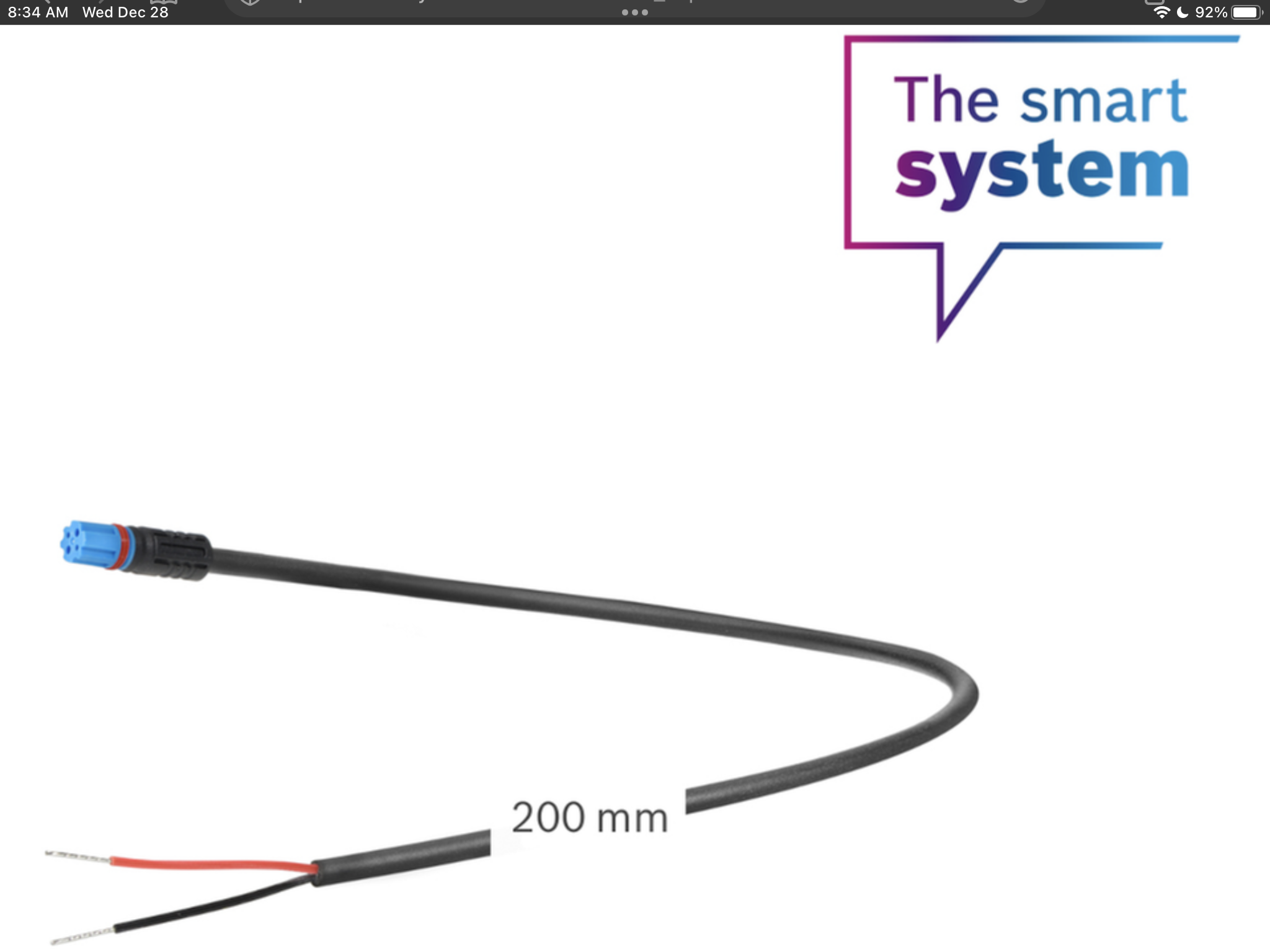

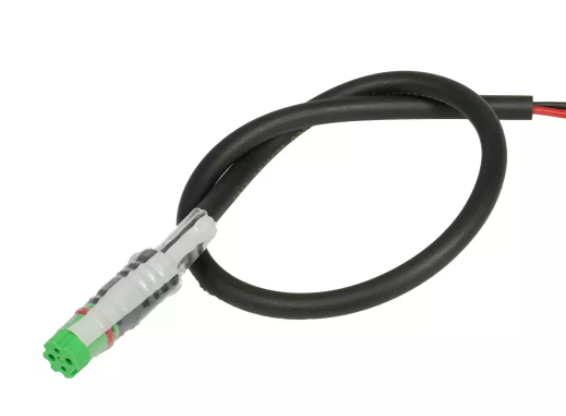

The auxiliary power cable is therefore available in two variants - once for
There is the "low power port" (green - light output) and "high power port" (yellow - additional current).
Both ports provide 1 ampere of current.
The only difference between the ports is the short-term maximum load.
The High Power Port (Yellow) can provide more amps for a few seconds.
The cables look something like this and cost about €10 ..

Thanks guys. I'm going to order one of these:
Bosch Additional Power Cable for Accessories - Smart System
Then get my dealer to enable the aux power port. This is a 12v output right? If so, quick switch around on the device to remove the 5v stepup voltage regulator I added and instead use the arduino's built in regulator. One less component!

But you dont have the rim magnet on your whyte e160?
That is where the problem is.
Hopefully someone comes around soon with a kit for that.
Some FAQ:
