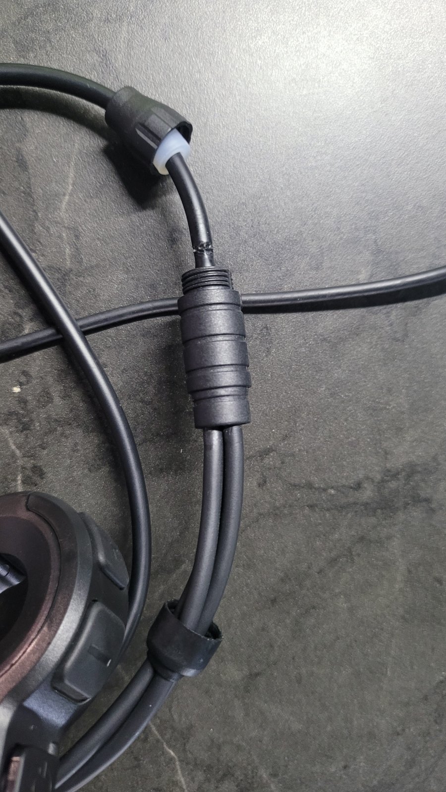

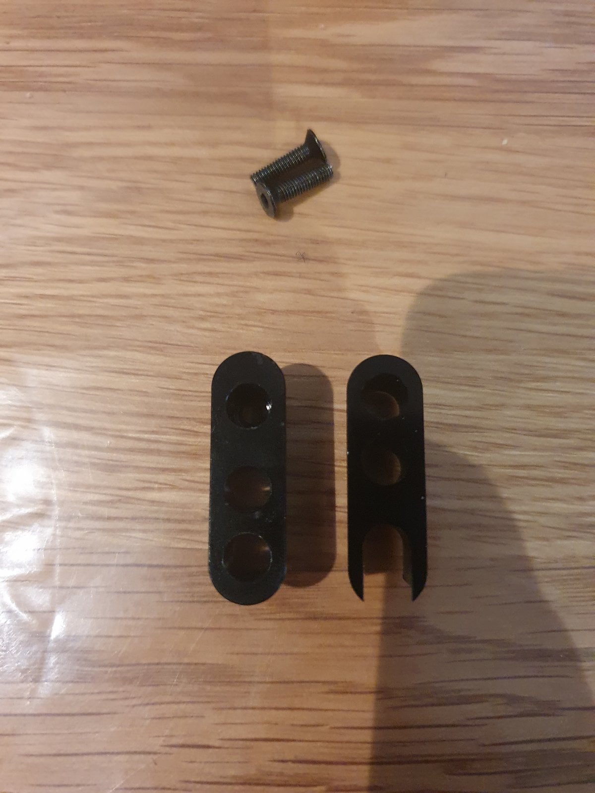

Hi, please help me to understand, how to route the 1t3 cable through the frame. Should I cut it or is there a way to disassemble it for routing?
? I've tried to unscrew, but the wires sit firmly. Thanks
Hi, please help me to understand, how to route the 1t3 cable through the frame. Should I cut it or is there a way to disassemble it for routing? View attachment 92085? I've tried to unscrew, but the wires sit firmly. Thanks
take out the aluminum insert from the frame, there is an opening on it that is cut so that you can insert the cable. and simply put it back in the frame.
Both are without a cut. Does anyone else has the same? So I have to cut by my own then if the 1t3 cable can't be disassembled.
no, i am building 2 bikes now, you have invalid insert. contact supplier to sent you a correct one. Or ask somebody in HW store to cut you bottom part...

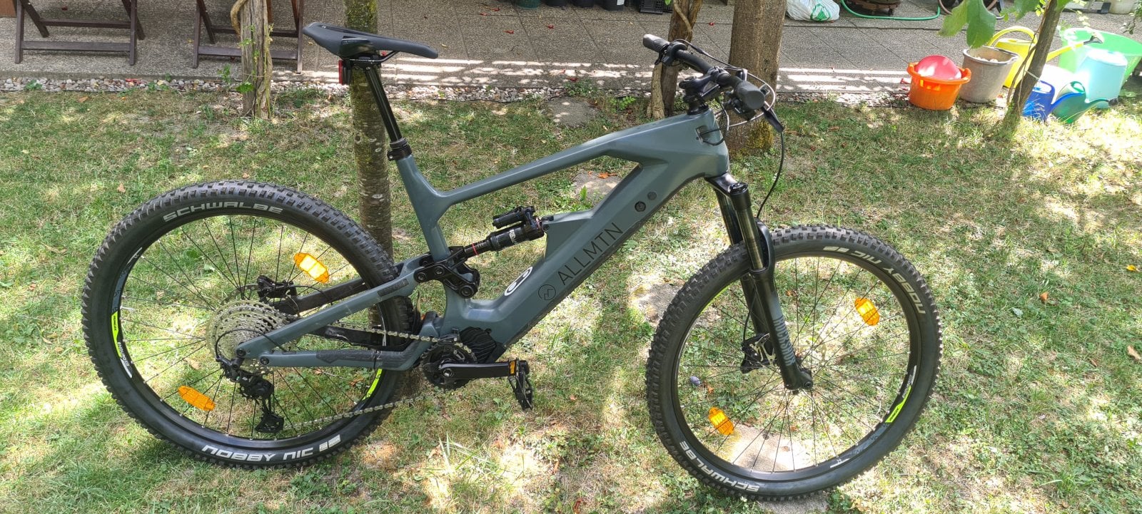

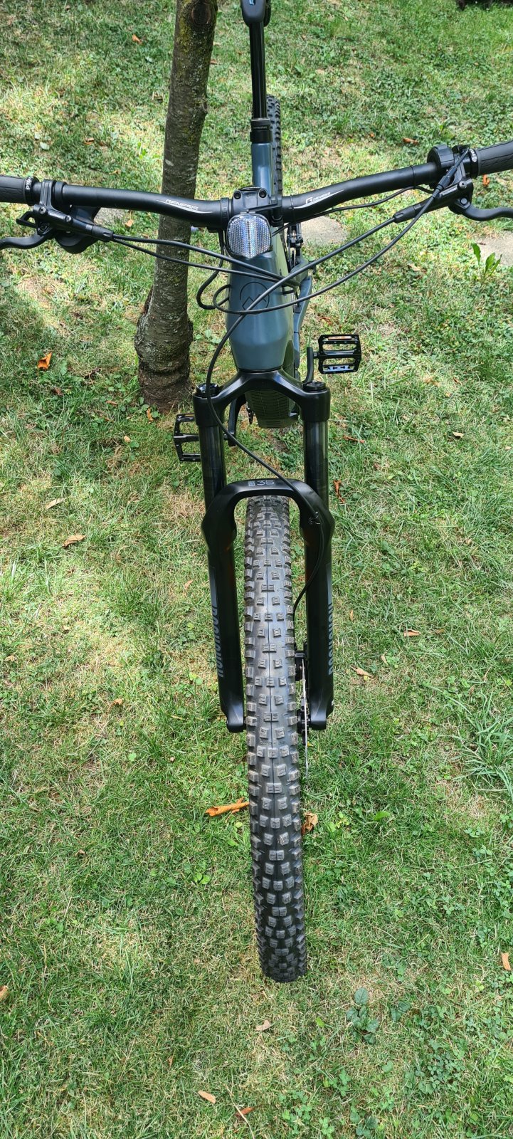

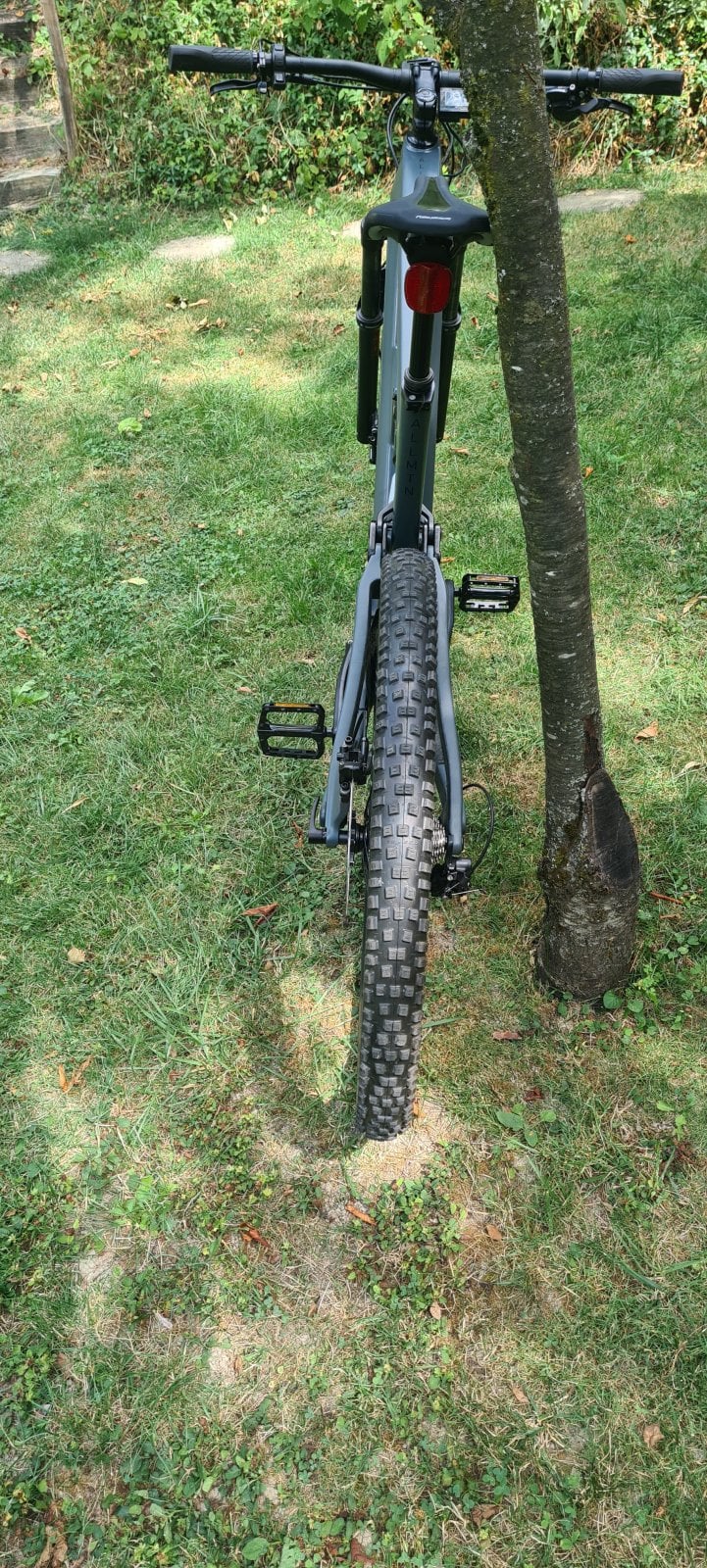

Hello everyone. unfortunately I decided to sell Dengfu. if someone is interested, it can be complete or in parts. send a message and let's make an agreement.
list of equipment on the bicycle.
Frame: Dengfu e10 XL
Motor Bafang M510
Battery:21700 Samsucells smart bms I have 2 pcs.
One: 52v 14s4p 20ah
Second: 48v 13s2p 10ah
Charger 48v and 52v depends on the battery
Fork: Rockshox 35 150mm
Shock: RockShox Super Deluxe Ultimate RCT Debon Air 210x55mm
Brakes: Shimano mt420 203 rotor
Tire Schwalbe Nobby Nic 29x2.6
Dropper 170mm
Rear derailleur shimano xt 12 spd
Cassette: shimano deore 12 spd
Shifter: shimano deore 12 spd
Cranks 170mm
Stem and handlebar 31.8 760mm
I have another M510 engine, besst tolls, Miranda cranks 160mm.... ask, everything can be found. I ship within the EU! payment is PayPal with buyer protection.

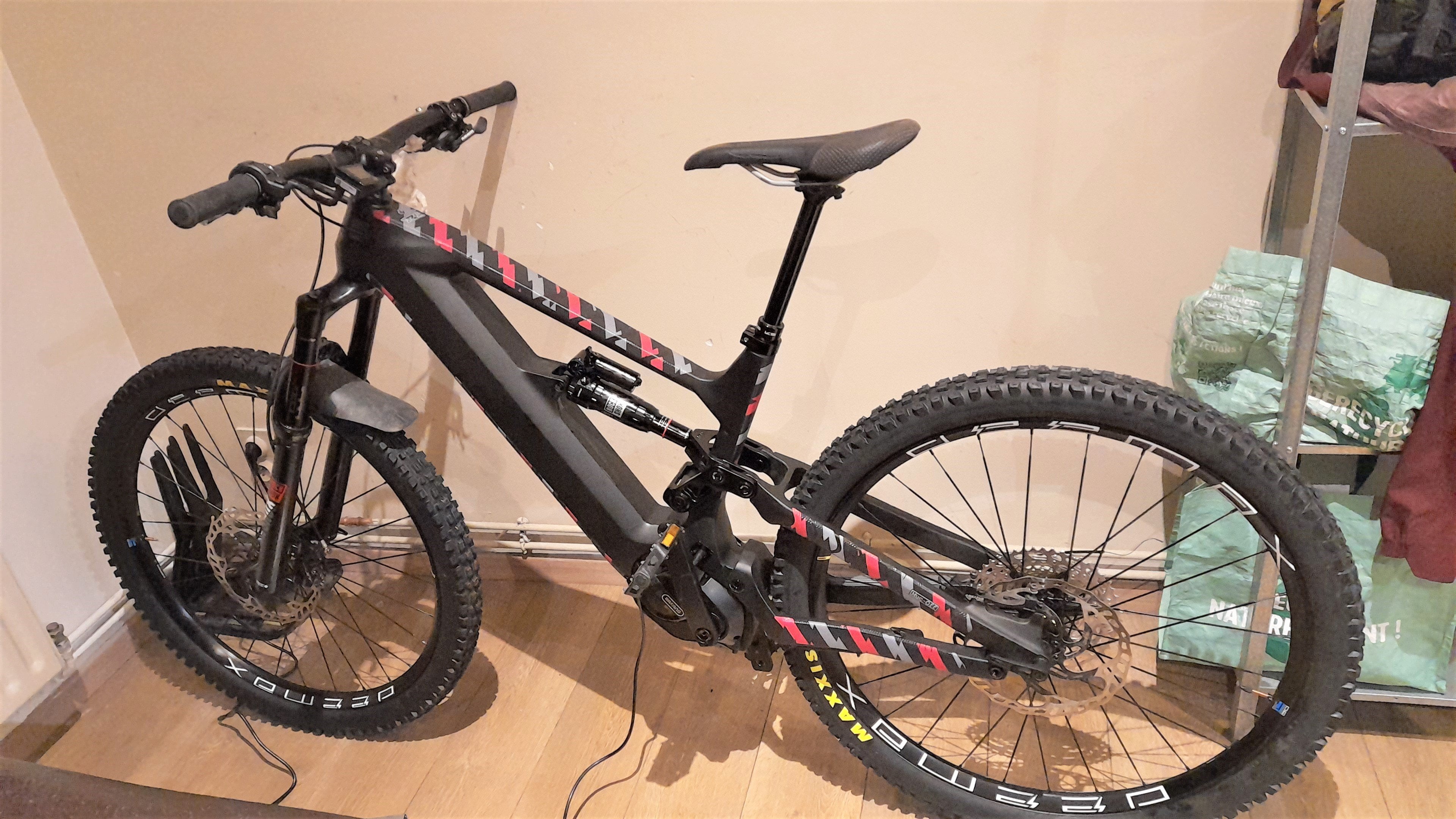

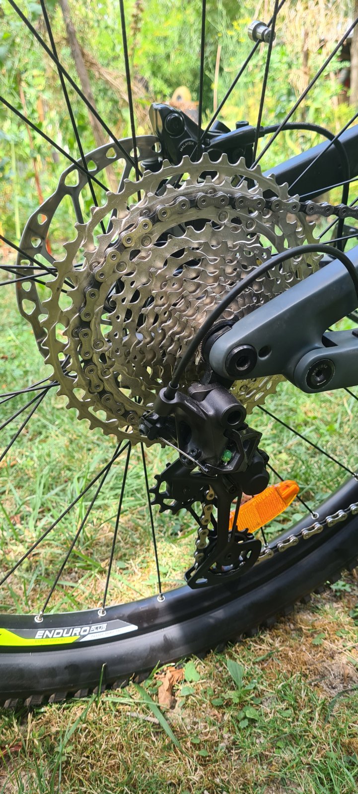

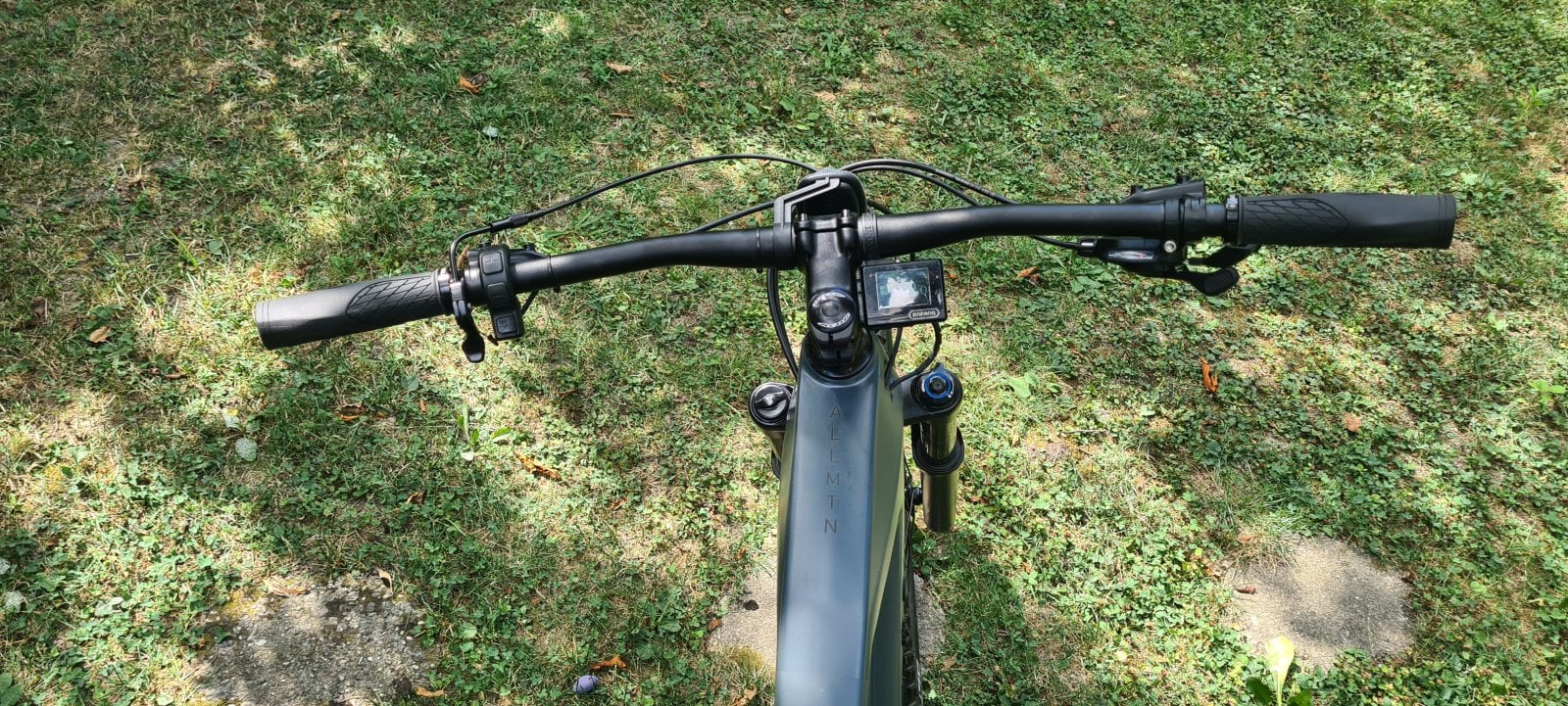

here are some pictures. the price for the bike is 3000 eur!
it would be best to send the bike in parts, because transporting the assembled bike is very expensive.
And it can also be sold in parts
Since private purchase no guarantee or returns

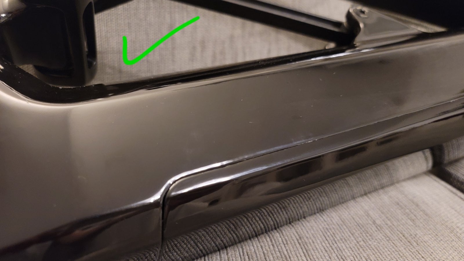

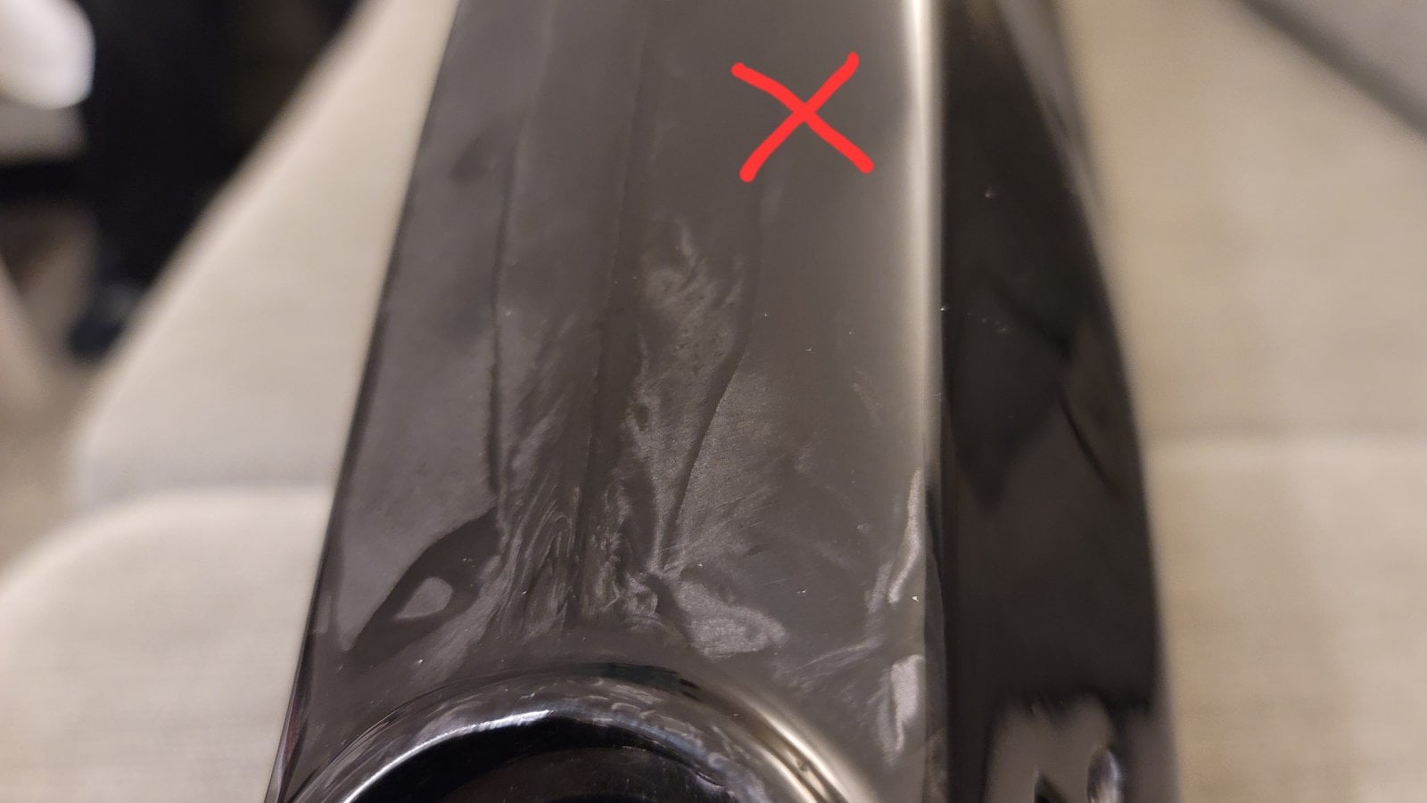

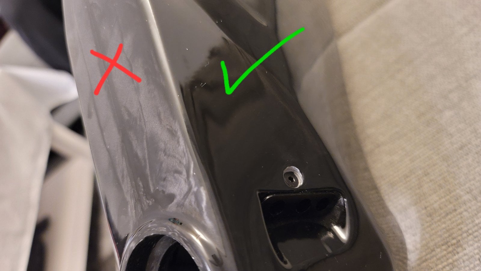

In some sides the lacquer is perfect, in others it is inhomogeneous.
Its hard to tell but it looks like 2 possible things looks like either boiling clear coat, wich happens if they don't let the first coat flash off and evaporate all the solvent before applying additional coats. Or they just cleared over the raw carbon without base coat paint or prep. You can fix it easily for under 50 bucks little bit of work but doable.

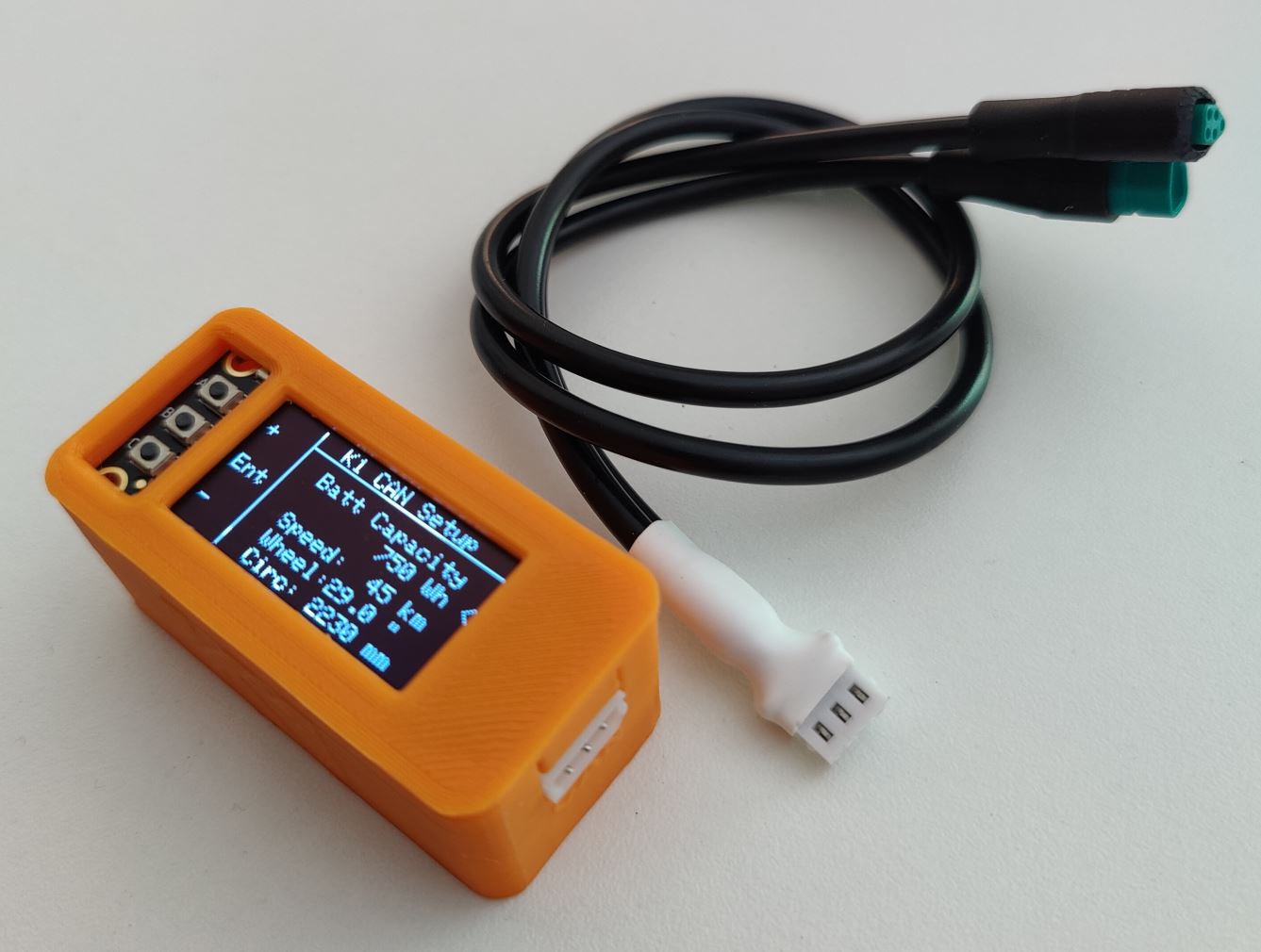

Hello ebikers.
K1 eBikes has designed small, portable and simple K1 CAN Monitor & Speed Unlocker - no need computer or mess with BESST. Works ONLY with Bafang motors with CAN bus (green connector to display with "house" shape 5 pin connector).
For more info check the following link:
https://endless-sphere.com/forums/viewtopic.php?f=31...
How to unlock speed:
https://youtu.be/6z3TzEqNWsQ
If you interested, send an email to [email protected], will answer any questions and will send user manual.
K1 CAN Monitor is determined for testing purpose only and is not waterproof.

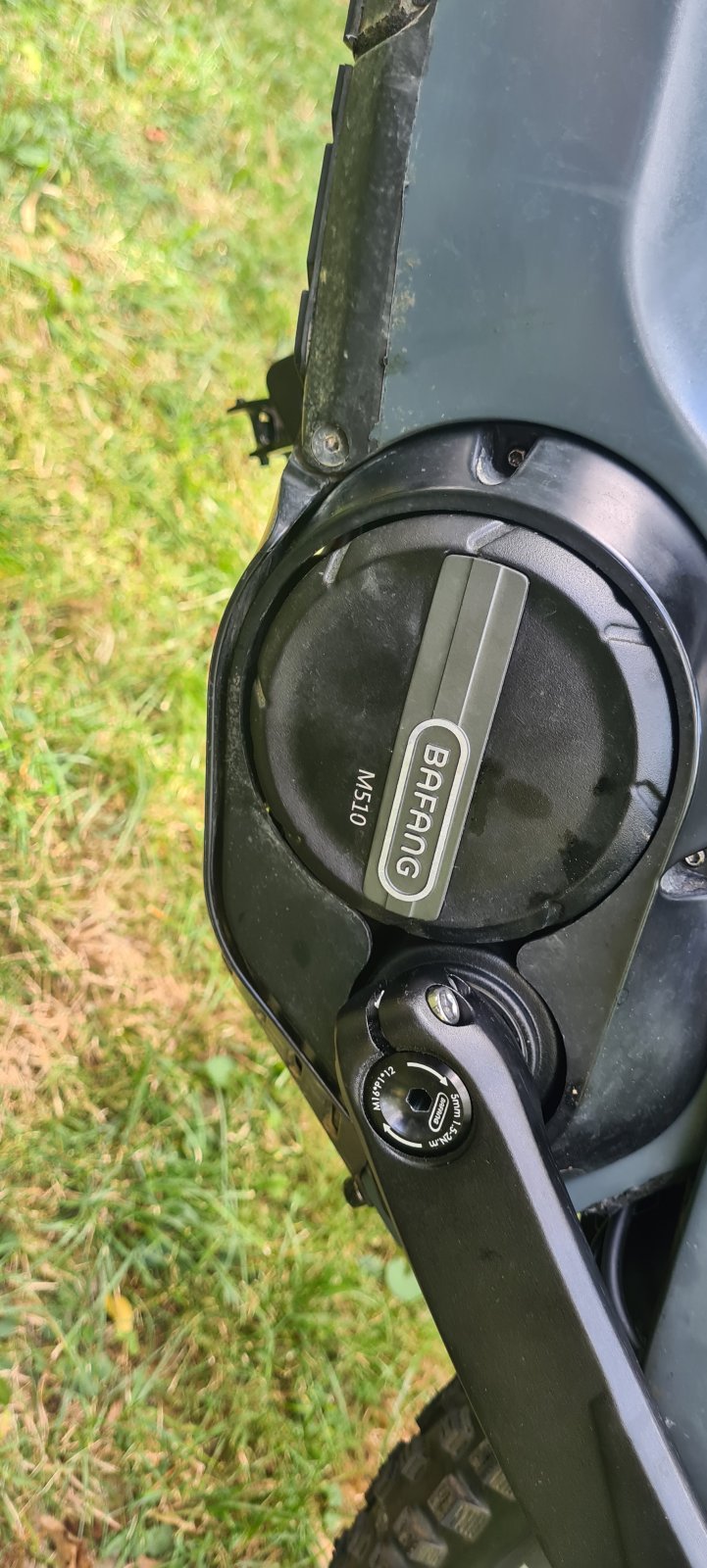

Hi, dos any one know if standard Bosch crank arms with the centre bolt fixing can be used on the Bafang M510, my motor is due shortly & i want shorter cranks , thanks in advance.
No. Only option I know is Miranda cranks for Bafang proprietary spline, available in 5mm steps from 150 to 170. Check FB Group Bafang M500/510/600 for discount code.

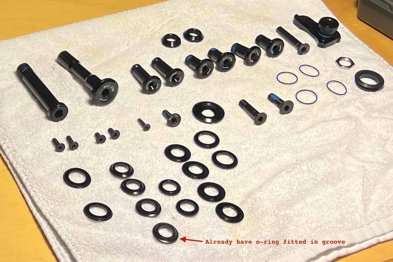

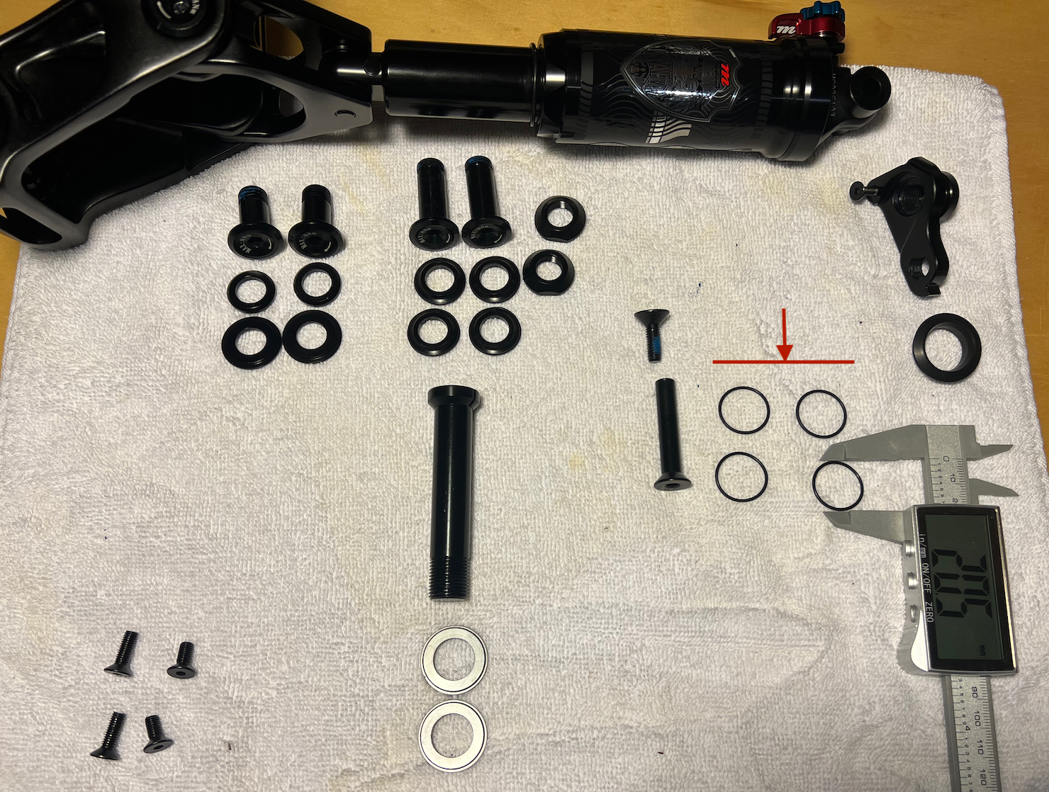

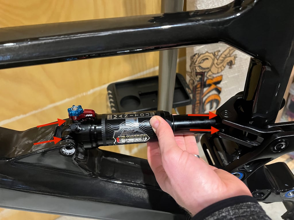

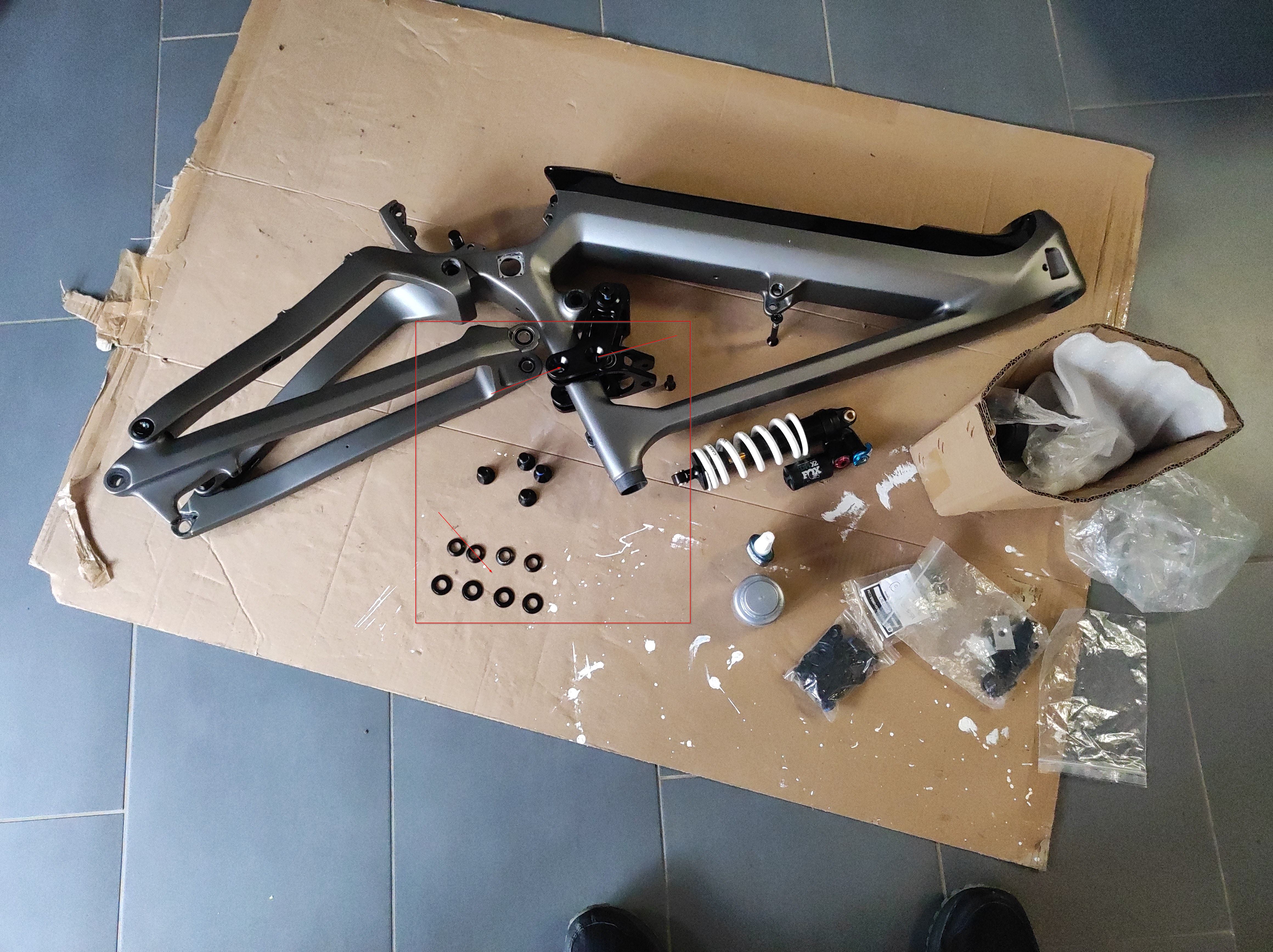

Assembling my E10 frame:

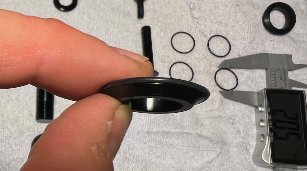

Does someone know where these four ~20mm o-rings should go?
My E10 frame came from Dengfu completely disassembled (it seems earlier frames came pre-assembled with a plastic rear shock spacer).
In addition to the five main frame pieces & shock mount, there's a little bag with three dozen bolts and washers etc. Many of them are subtly (but importantly!) different. Four washers already have o-rings fitted in a 1mm groove. No other washers have a similar groove (though many have a one-sided lip, which despite trying, will not reliably hold an o-ring).
Melody very kindly shared an assembly video with me taken in the Dengfu factory (showing assembly of a branded bike for the US market ;)) which has made it pretty easy to do a dry-run build, making sure I have all the right parts.
But... I have four rubber o-rings roughly 20mm in diameter that I do not see used in the assembly video???
My thoughts are:
1. These are spare o-rings in case the pre-fitted ones on the four washers are damaged. (unlikely I think)
2. These o-rings should go between the shock bushings and frame articulation points (see image below & red arrows) to protect the bushings from moisture.
3. They're intended for another articulation point????
Thanks for your help!
Hi djol, I have the same problem to receive a disassambled frame and not 100% sure with some parts. Would it be possible to share the video with me ?
BR and thx for your reply
Jens

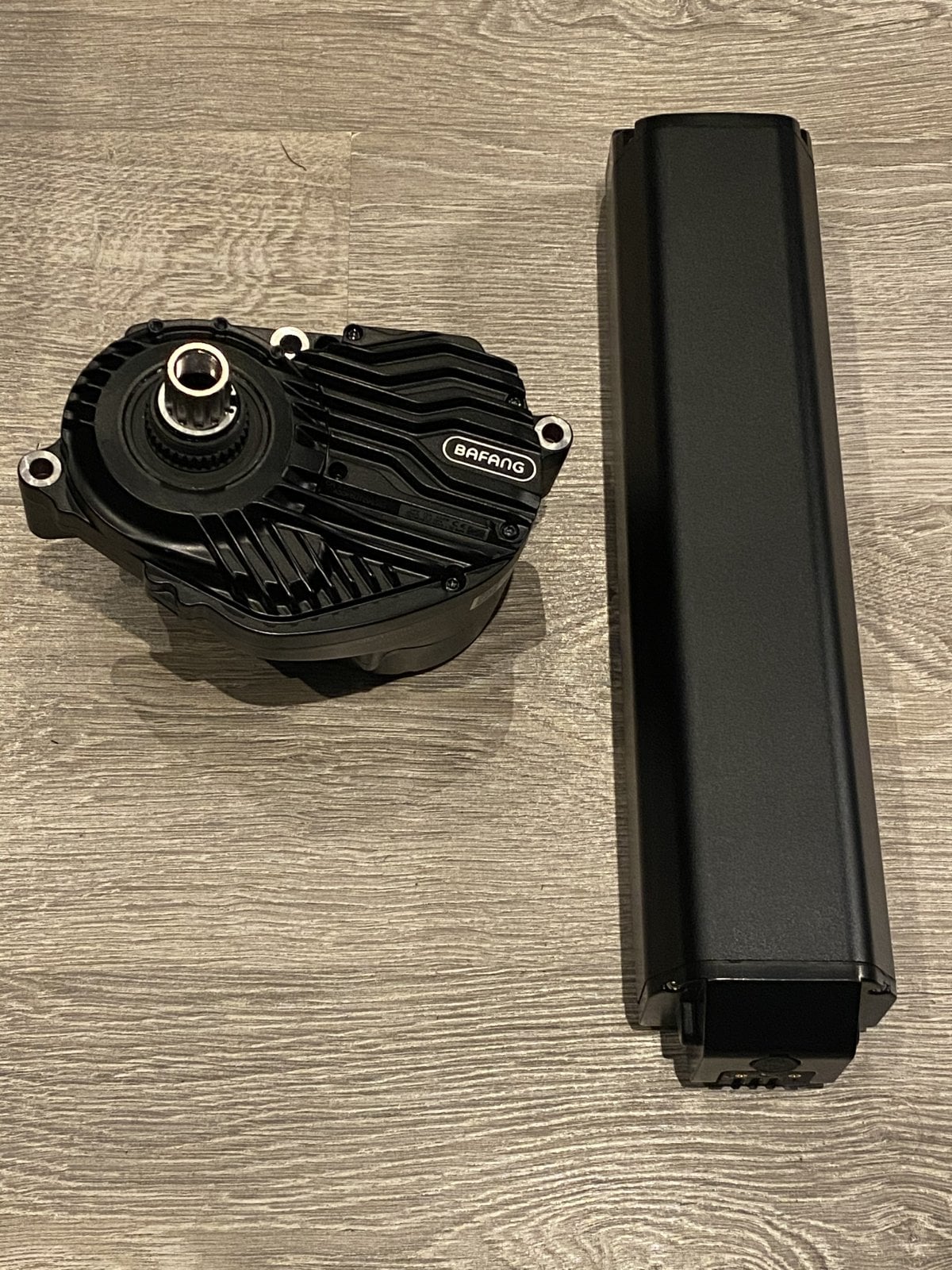

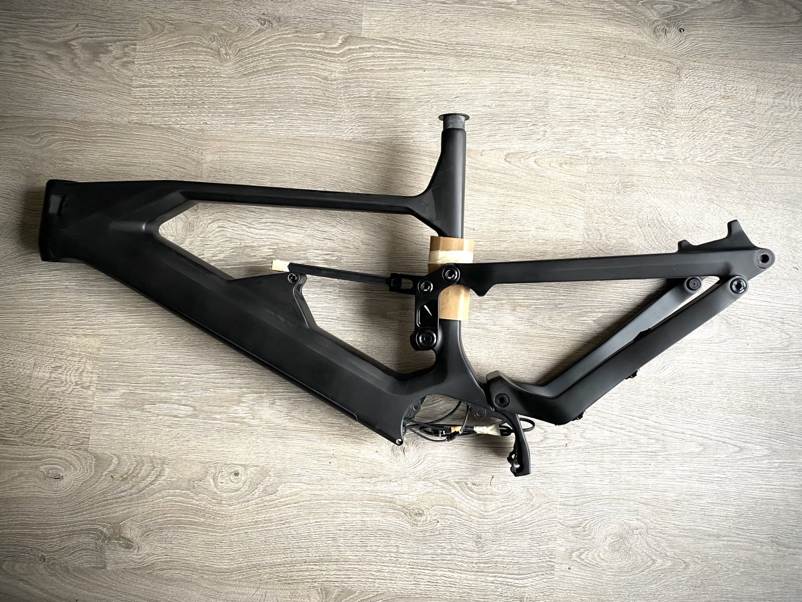

Motor and battery arrived a few weeks ago. Bafang M500, 95nm, 48v system with EU 250w rating. Battery is a 840Wh huge in tube battery.
Frame:
Full Carbon frame set with fairly (by China frame standards) modern geometry.
I ordered the XL, 510mm in reach. HA is 66 degree but I will run bigger fork and mullet, so likely end up around 64.5 ish.
The frame is from Dengfu. They even supply full leverage curve, anti squat, pedal kickback etc graphs and figures! No idea of accuracy, but at least they are included
Frame is called the Dengfu E10 and here is the link. For some reason its labelled as E11 on the charts, but the Dengfu E10 is the actual product.

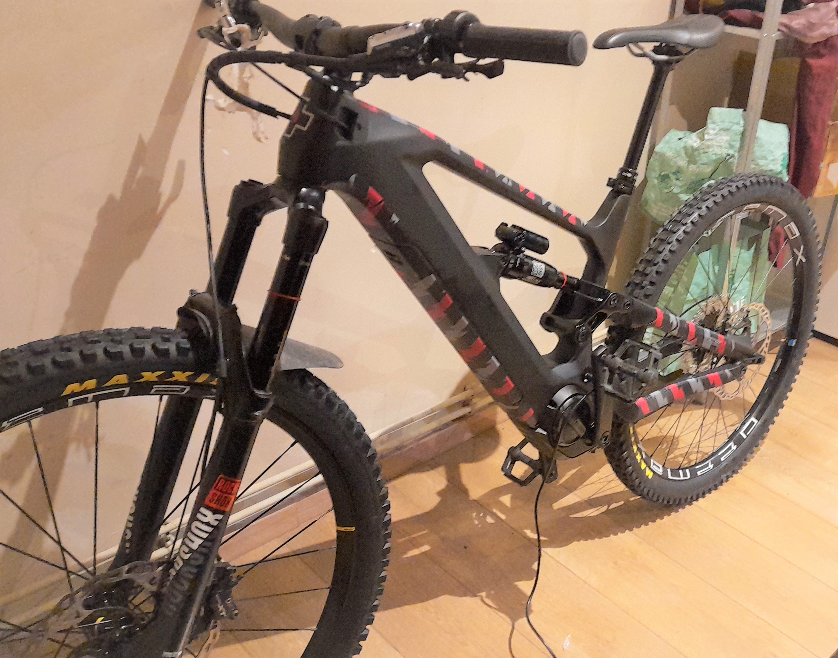

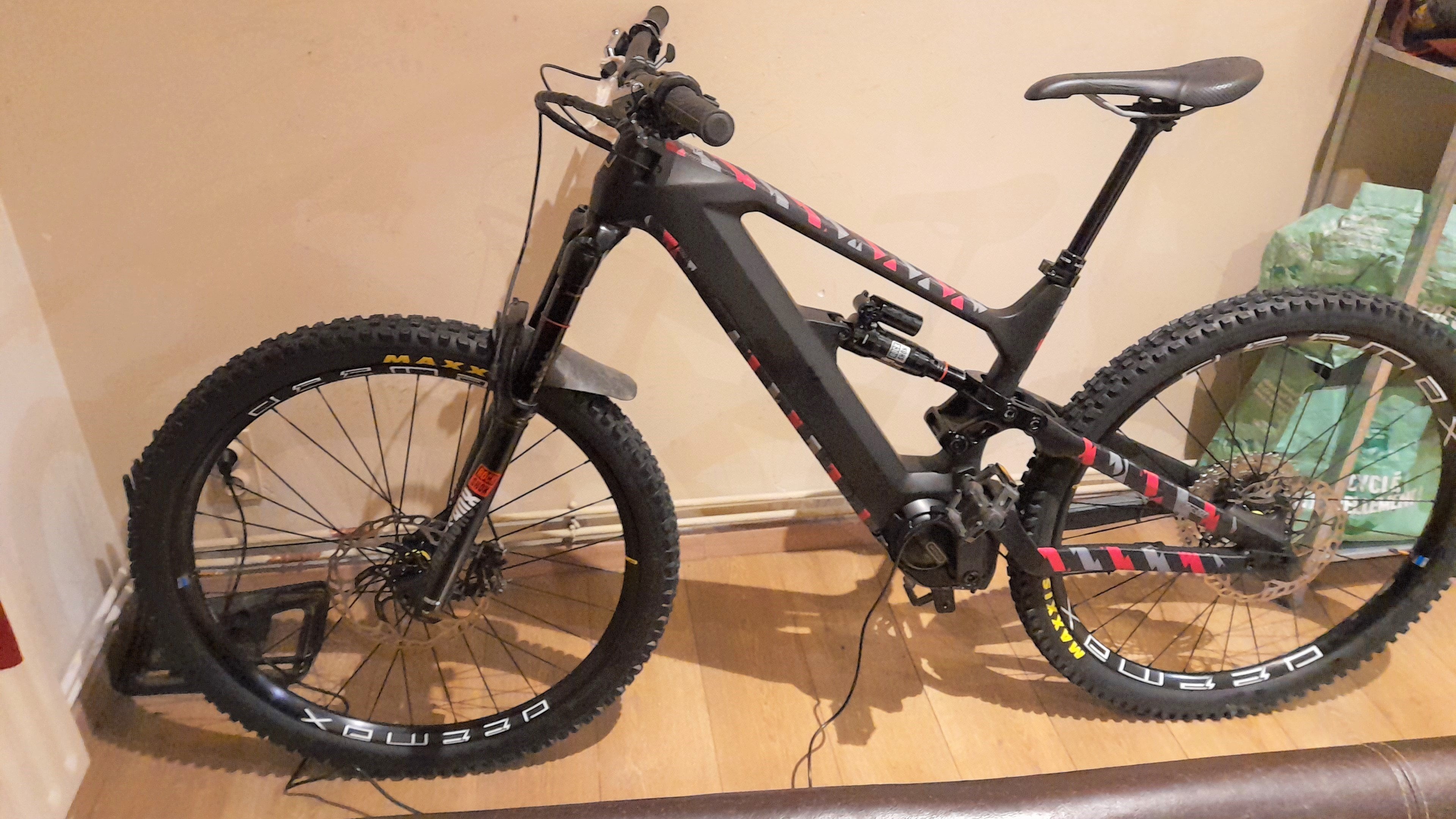

Dear E-Emtb community,
Inspired by Rob`s project (as I suspect the majority of us were), I also went and bought an E10, as my first E-MTB.
I hope to be able to try it this upcoming weekend, but for the meantime I will already share some photos of my build.
I would like to thank Rob and everyone that contributed and shared their projects and experience, without whom my project would fail miserably.
I am not much of Internet forum user, however should you have questions about my project, I will try my best to reply.
Cheers!
Iuri
