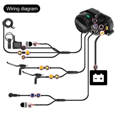

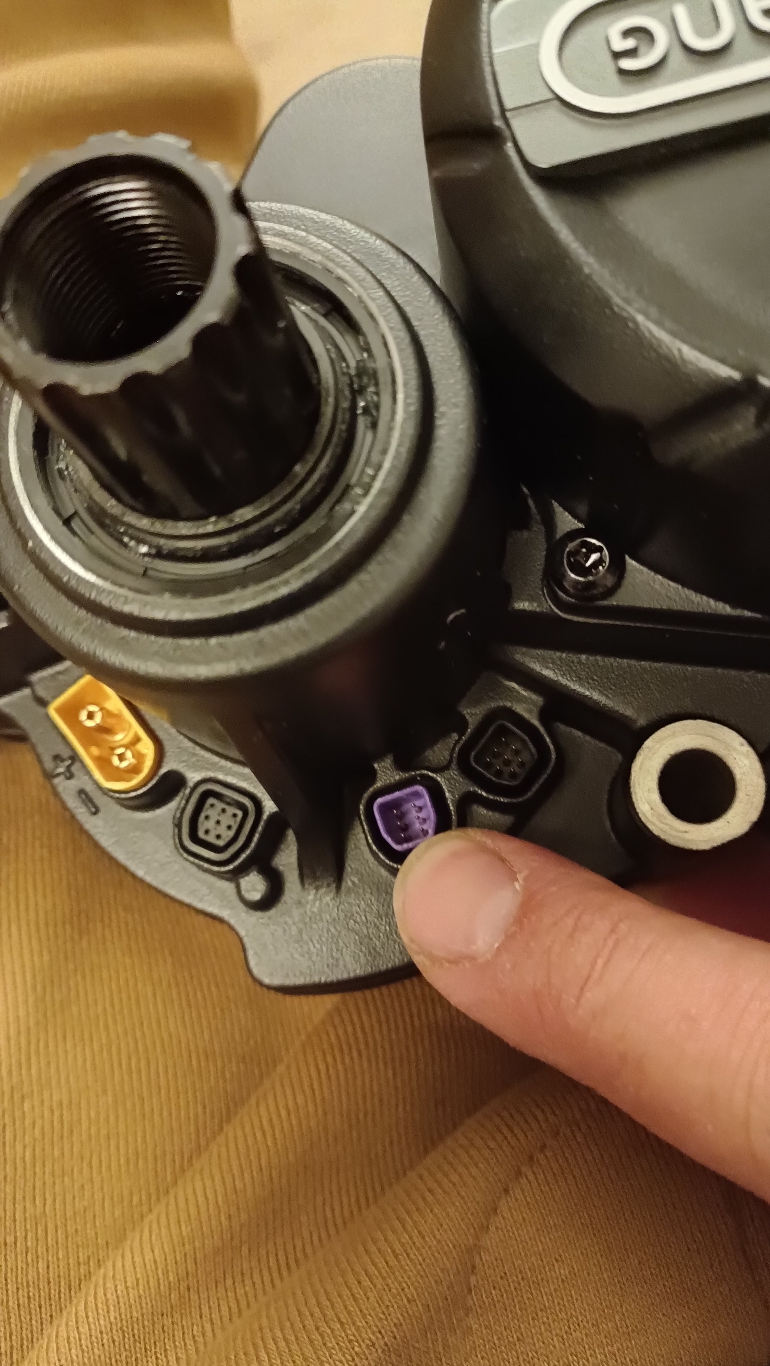

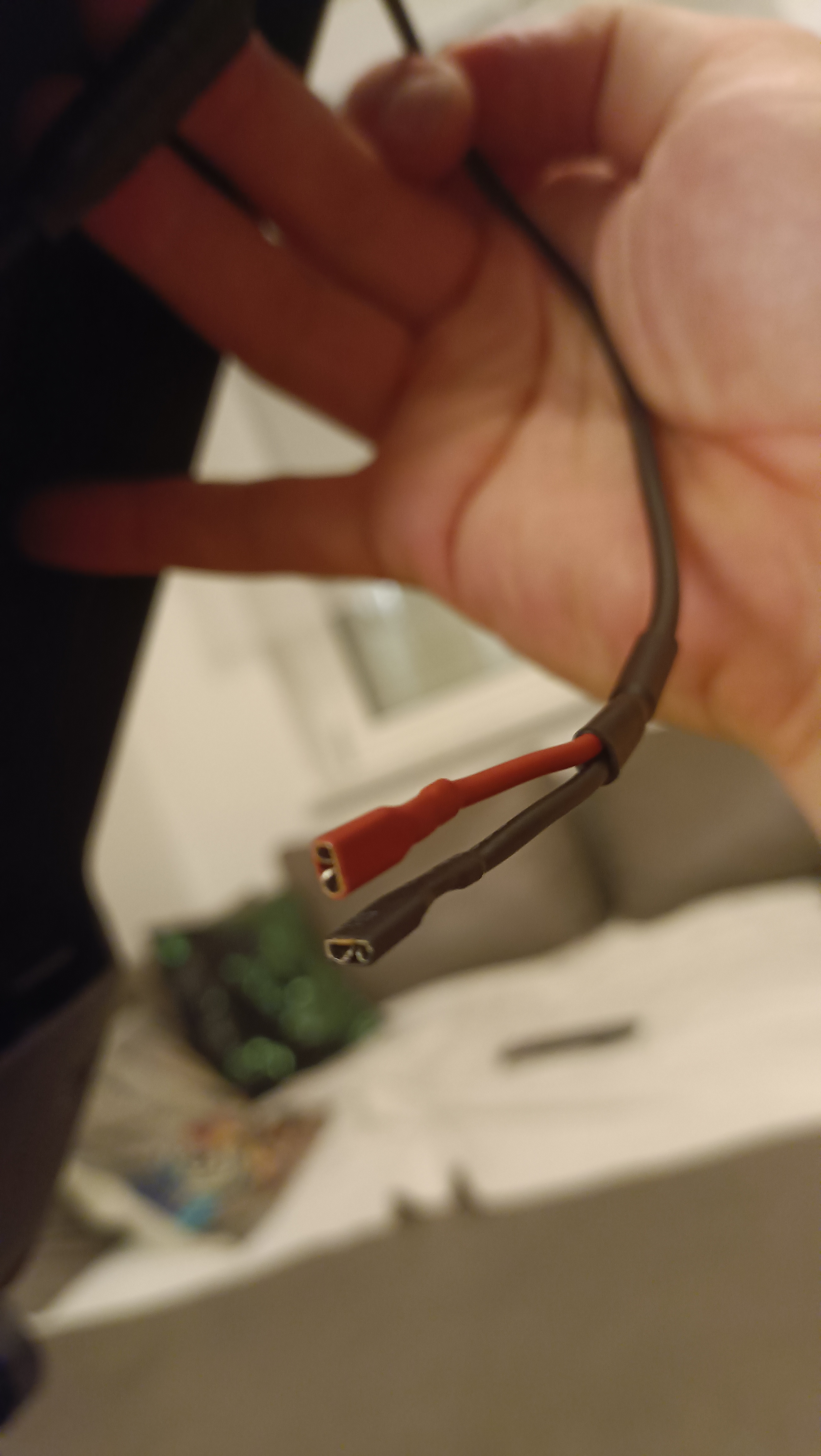

Hi
I am new here. Can any onybody help me.with the colour codes of the cables please? Attached.photos.
One port remains empt, correct?
And this other red an black is for Lights?
thx very mich. best wishes Max

Hi
View attachment 112270 View attachment 112271
this one is for light. if u dont use light so leave it. we only use 3 ports, 1 connect to battery, 1 for display and 1 for speed sensor.

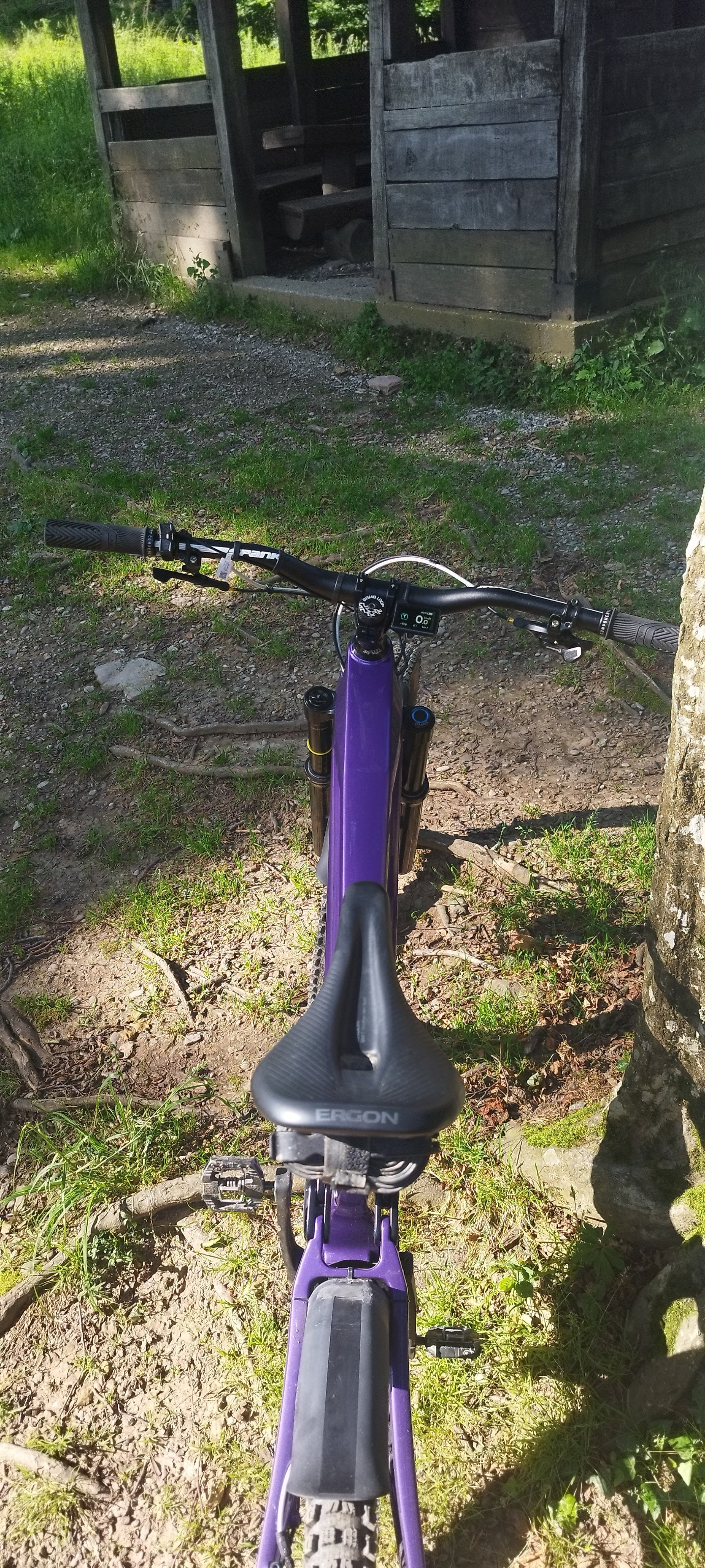

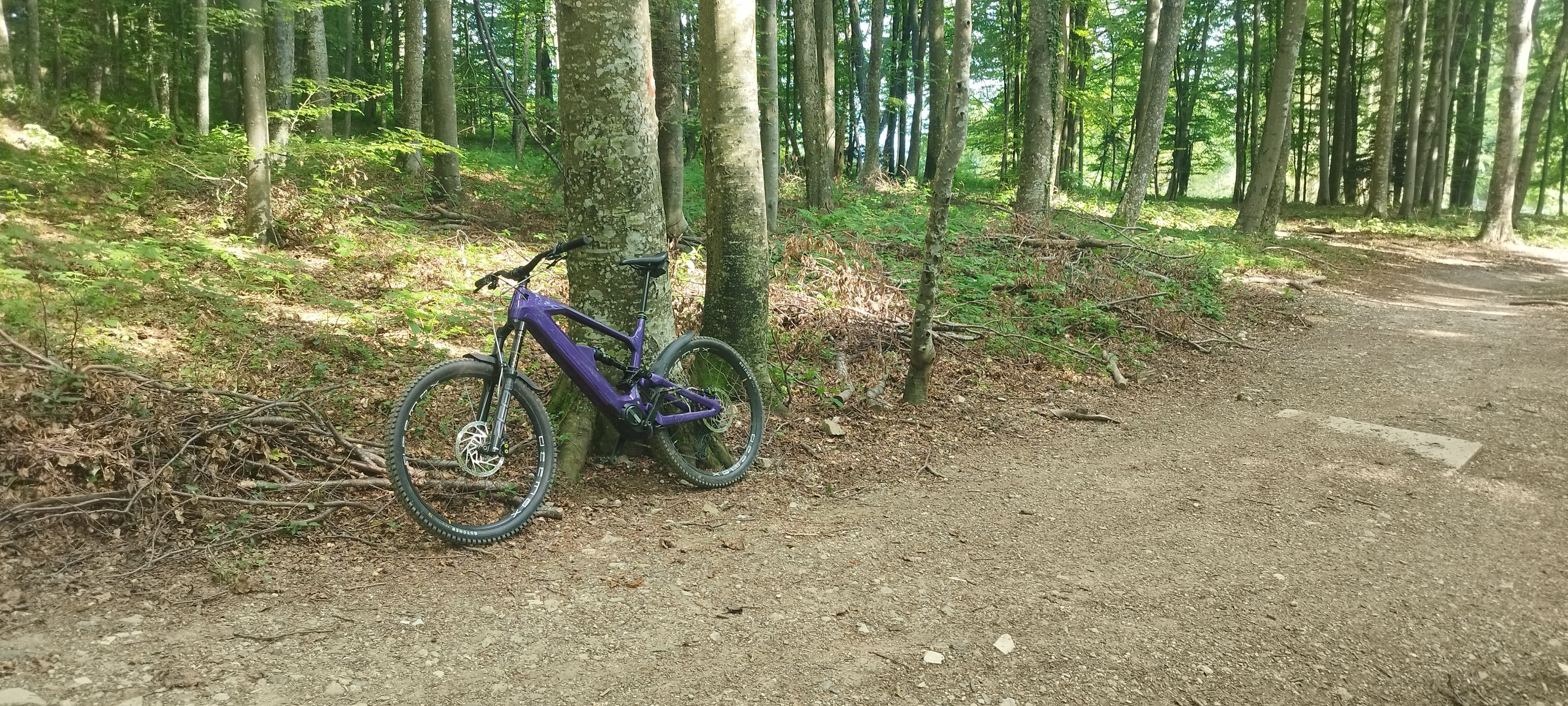

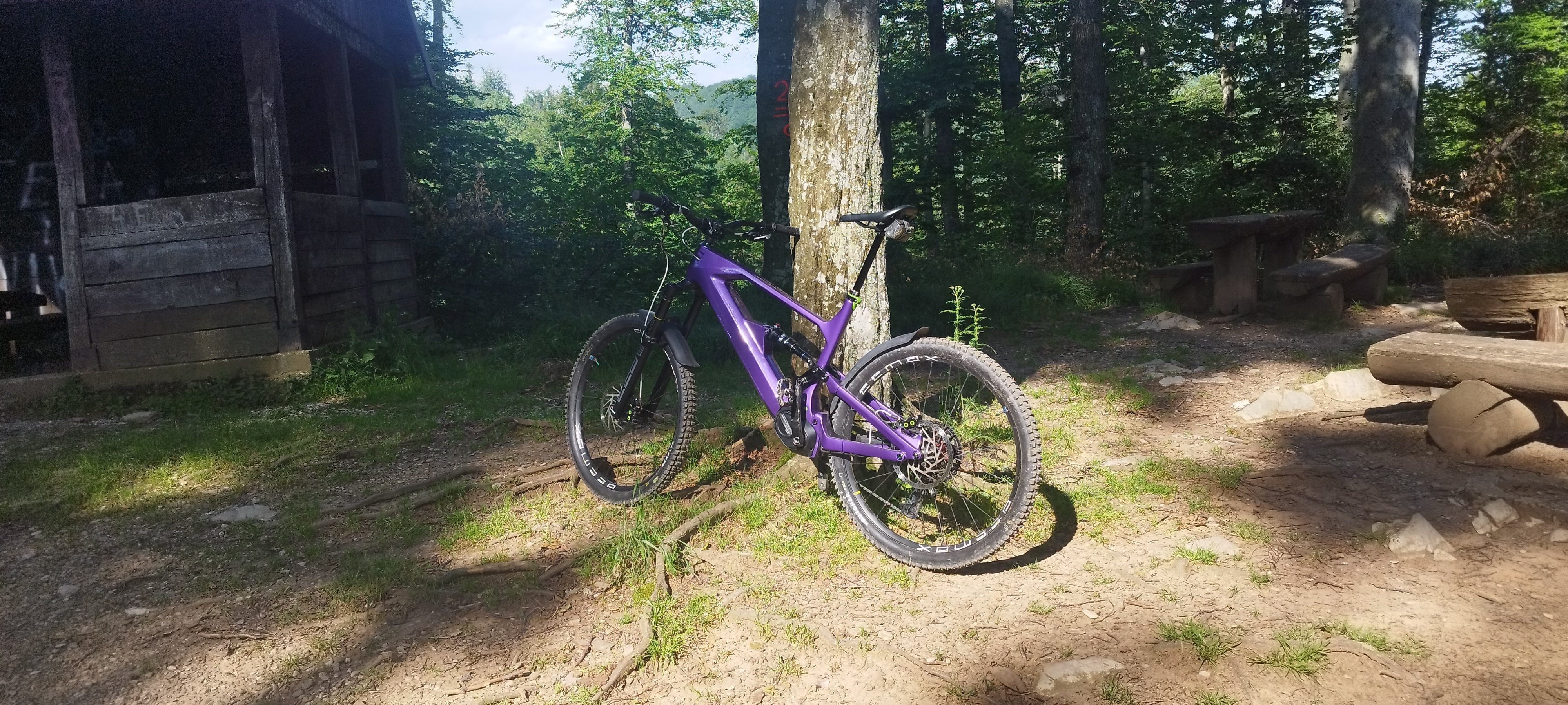

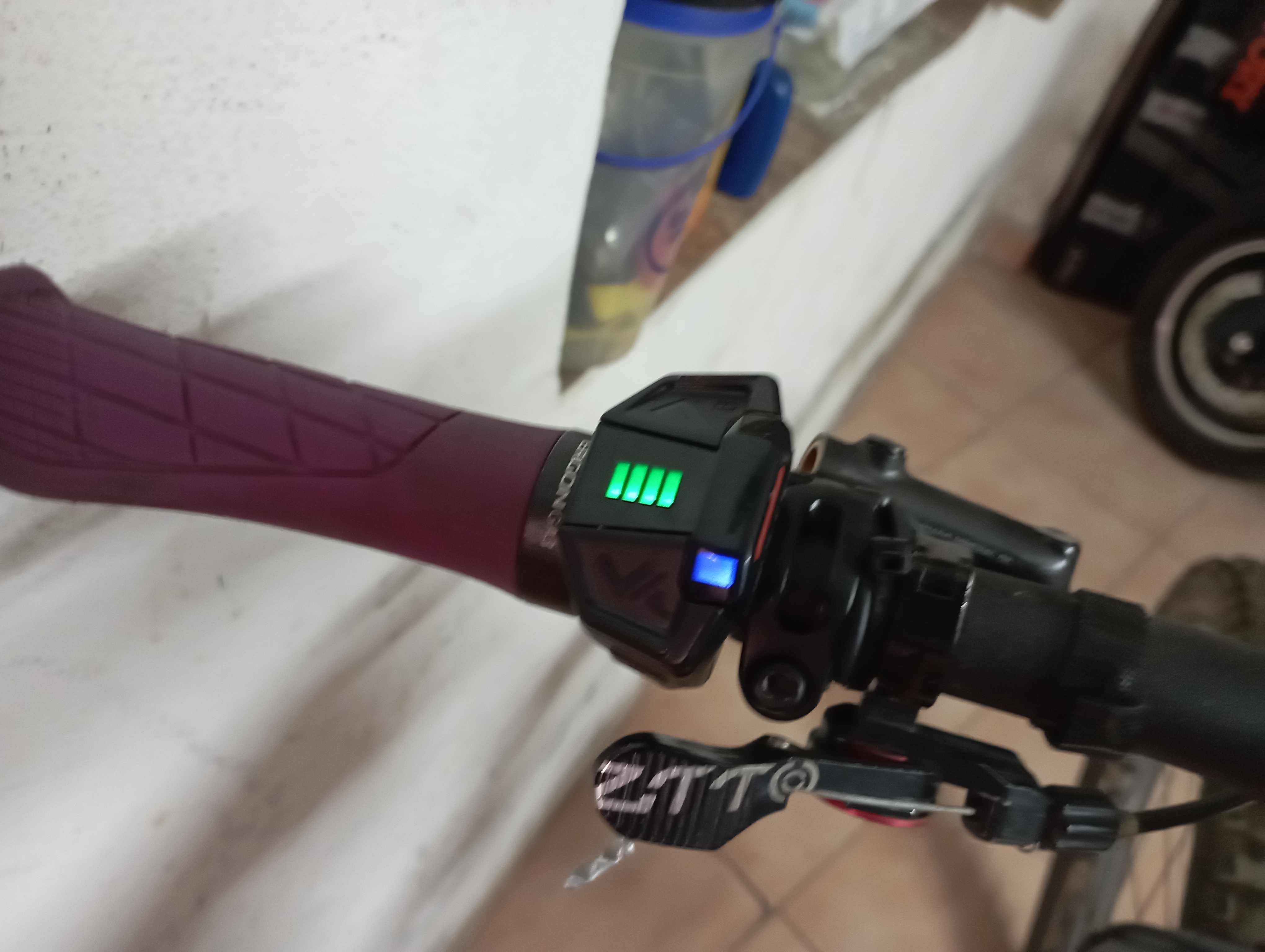

Hi everyone. new bike assembled. color dodge challenger plum crazy purple pearl metallic. the components are more or less visible. weight 23.5-24 kg. XL frame, M510 fc2, 36V. 🔋 800wh 36v, 22700 panasonic cells. today the first ride, 24km 1100 met altitude, passes 1-4, mostly 2 and 3 30% spent. consumption very good. bosch and giant motor would consume 40-50% on this route. very big improvement compared to FC 1. enough power, I can compare with bosch gen4 85nm and giant syncdrive pro 85nm. m510 gives more support at lower cadence, enough power for any uphill, no sudden power delivery like bosch and giant. bosch and giant are a bit smooth. while in my opinion the m510 has a more natural feel. all in all very good, I need to play with the engine settings a little more, I believe it can be adjusted even better. the whole bike price-quality ratio at the top of the offer.

Good to read your review. M510 FC 2.0 so far is the best M series Bafang ever made.
there is still room for engine improvement. let's hope that with a future upgrade the engine will be improved. I adjusted the settings a bit, it can be adjusted nicely.

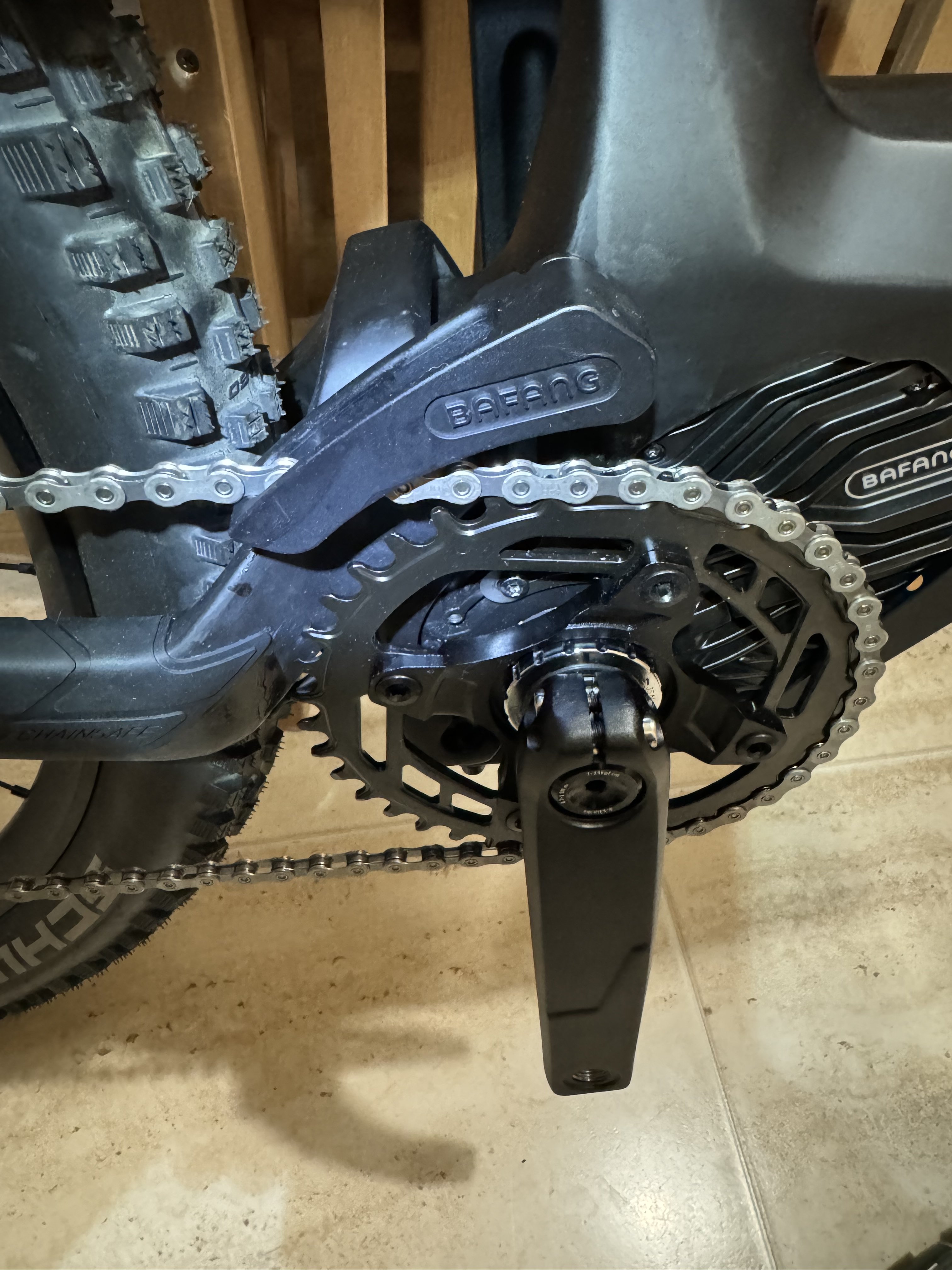

I have fully assembled my E10/M510 bike except for the shock, because the seller did not send the bushings (I will make a full thread about my purchasing experience soon) and the battery.
One thing that I'm observing is that the chain line seems to be quite suboptimal. It's like the provided Bafang spider or the chainring should have easily 6 mm more offset (towards the frame). I have a Deore 5100 11t-51t cassette, and the chain line currently goes through the 4th cog. I don't see how the transmission is going to perform well with the bigger cogs, particularly in the 51t one.
Can any one comment on this?
Greatly appreciated
dvng
May 21, 2021
94
41
Malaysia
Greatly appreciated
No issue, you will need the medium cage derailleueur and maybe a 118 links chain

I think mine with 36T front ring has either 118 or 120 links by memory. No need to worry about the offset, modern derailleurs are pretty good and will shift across no problem.

Thanks all for your input. I hope that all goes well in this front with that I have, as I went far beyond my former budget due to a horrible buying experience. If I find issues with shifting, I will explore adding spacers to offset the chainring to improve the chainline. I will report my findings.
