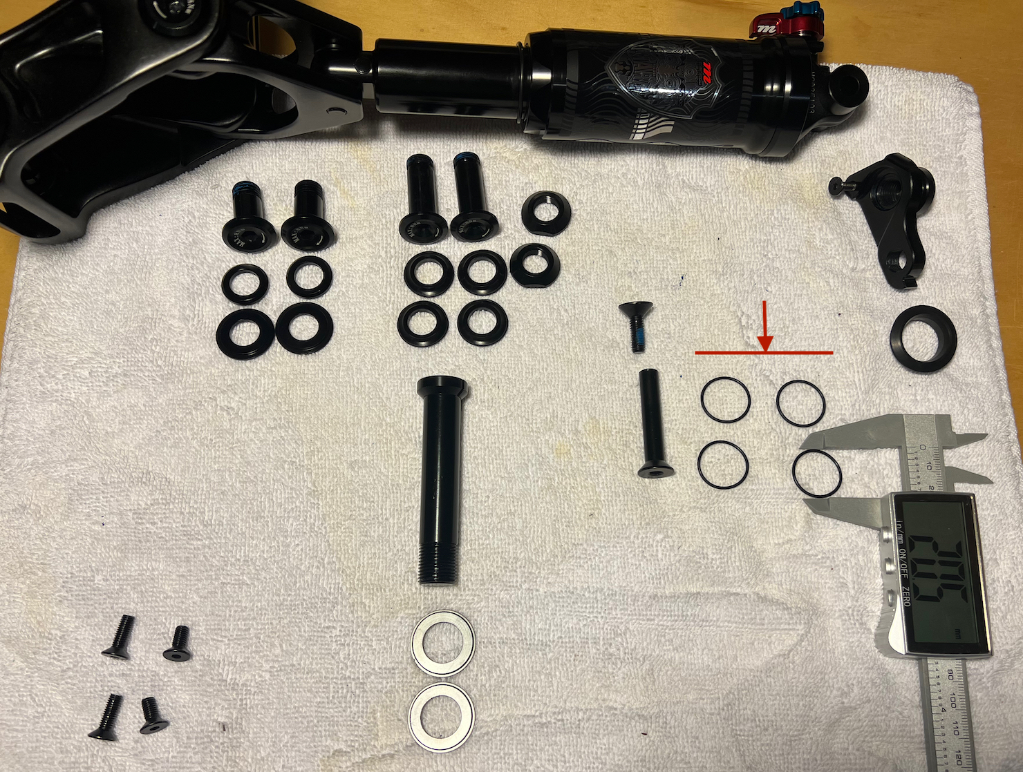

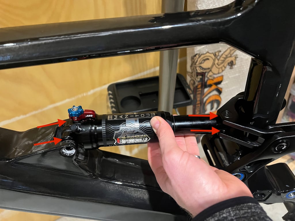

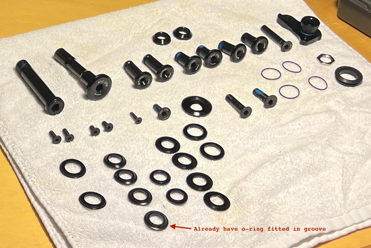

Assembling my E10 frame:
Does someone know where these four ~20mm o-rings should go?
My E10 frame came from Dengfu completely disassembled (it seems earlier frames came pre-assembled with a plastic rear shock spacer).
In addition to the five main frame pieces & shock mount, there's a little bag with three dozen bolts and washers etc. Many of them are subtly (but importantly!) different. Four washers already have o-rings fitted in a 1mm groove. No other washers have a similar groove (though many have a one-sided lip, which despite trying, will not reliably hold an o-ring).
Melody very kindly shared an assembly video with me taken in the Dengfu factory (showing assembly of a branded bike for the US market ;)) which has made it pretty easy to do a dry-run build, making sure I have all the right parts.
But... I have four rubber o-rings roughly 20mm in diameter that I do not see used in the assembly video???
My thoughts are:
1. These are spare o-rings in case the pre-fitted ones on the four washers are damaged. (unlikely I think)
2. These o-rings should go between the shock bushings and frame articulation points (see image below & red arrows) to protect the bushings from moisture.
3. They're intended for another articulation point????
Thanks for your help!
My thoughts are:

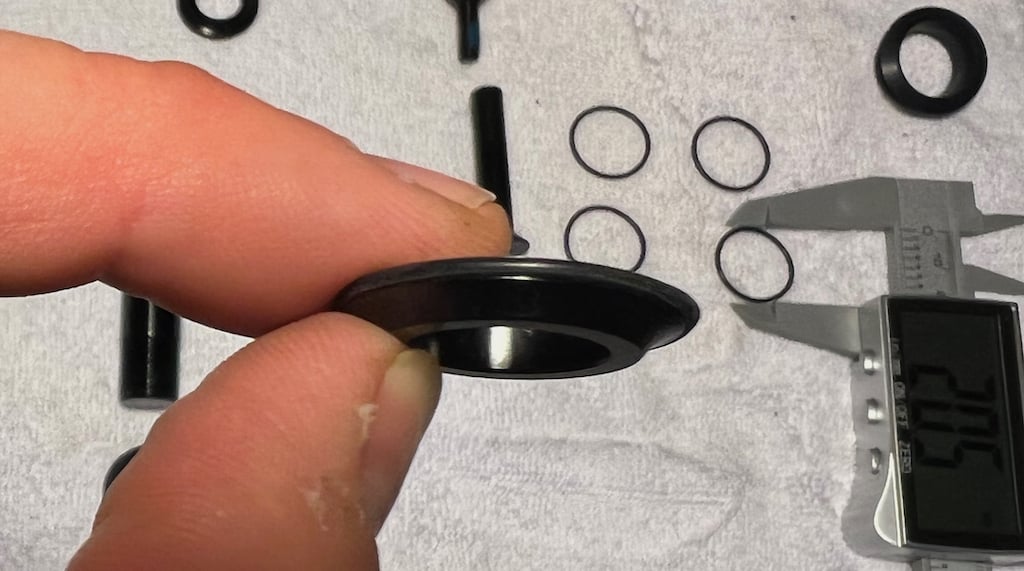

They go on the spacers that go between the joints for the seat stay and chain stay pivots.
The spacers have a machined groove to accept the o rings on thier outer circumferecne. Although, looking at the counter bore they go into, I very much doubt they would do anything.

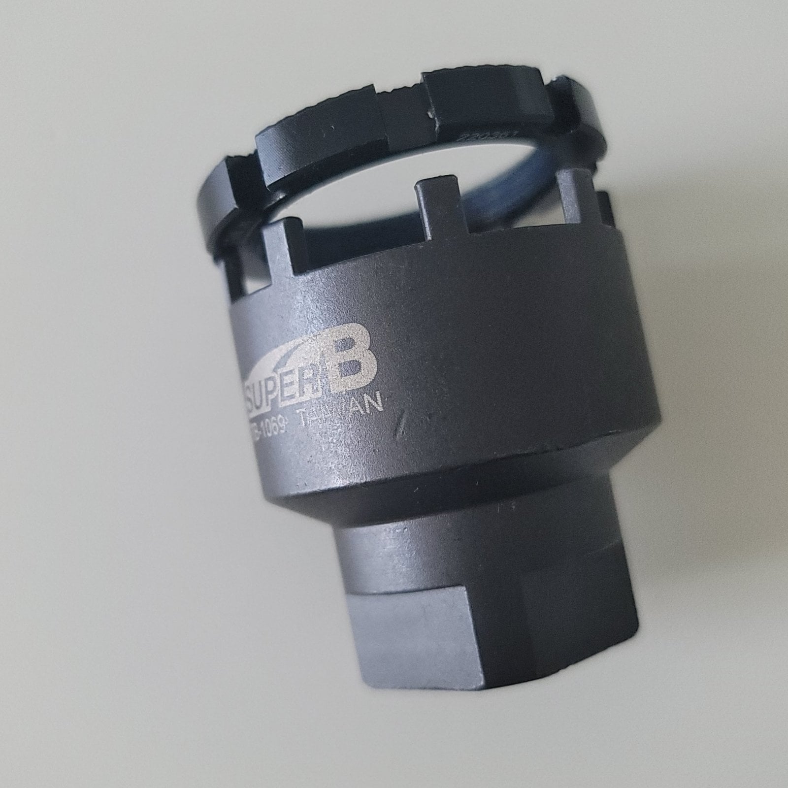

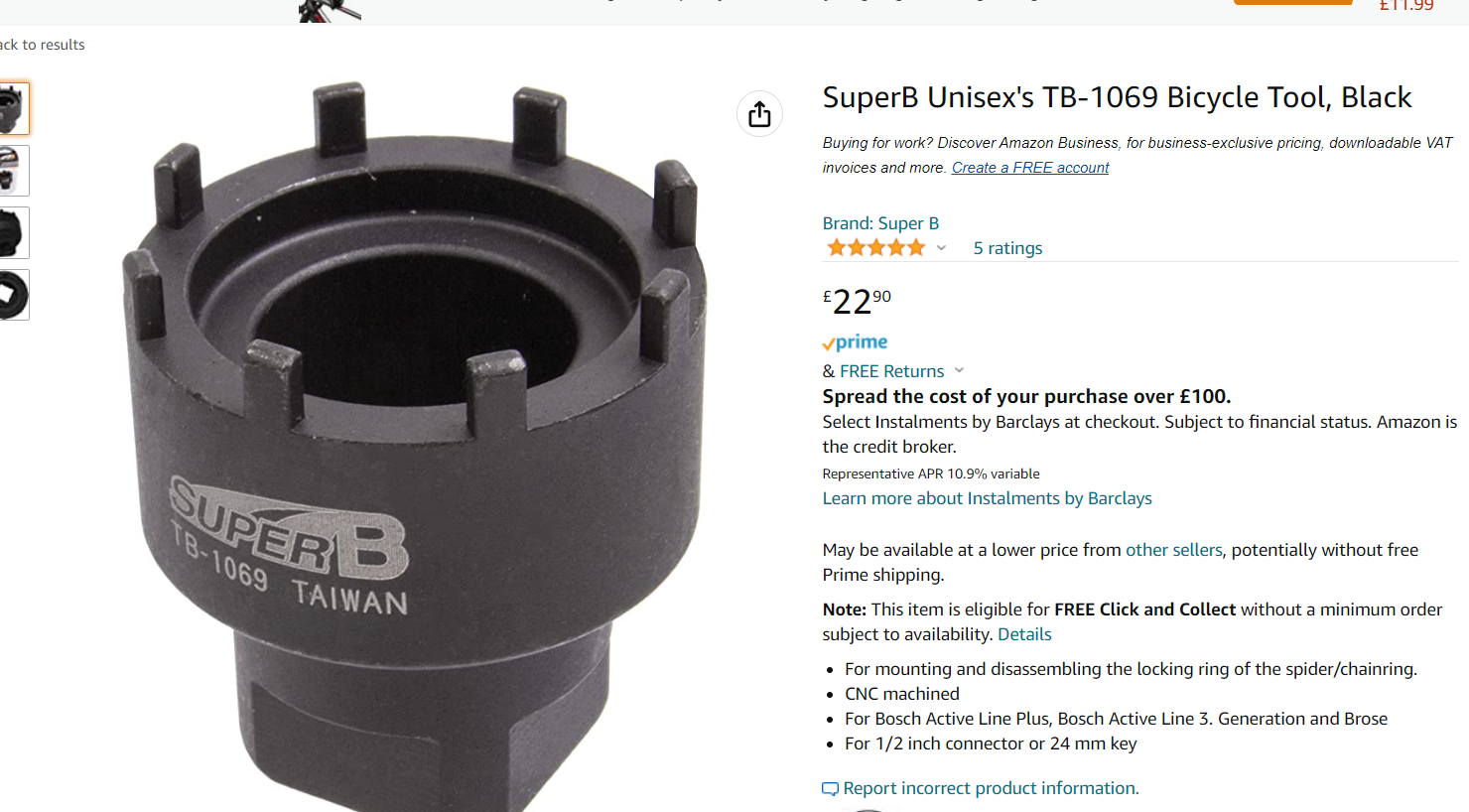

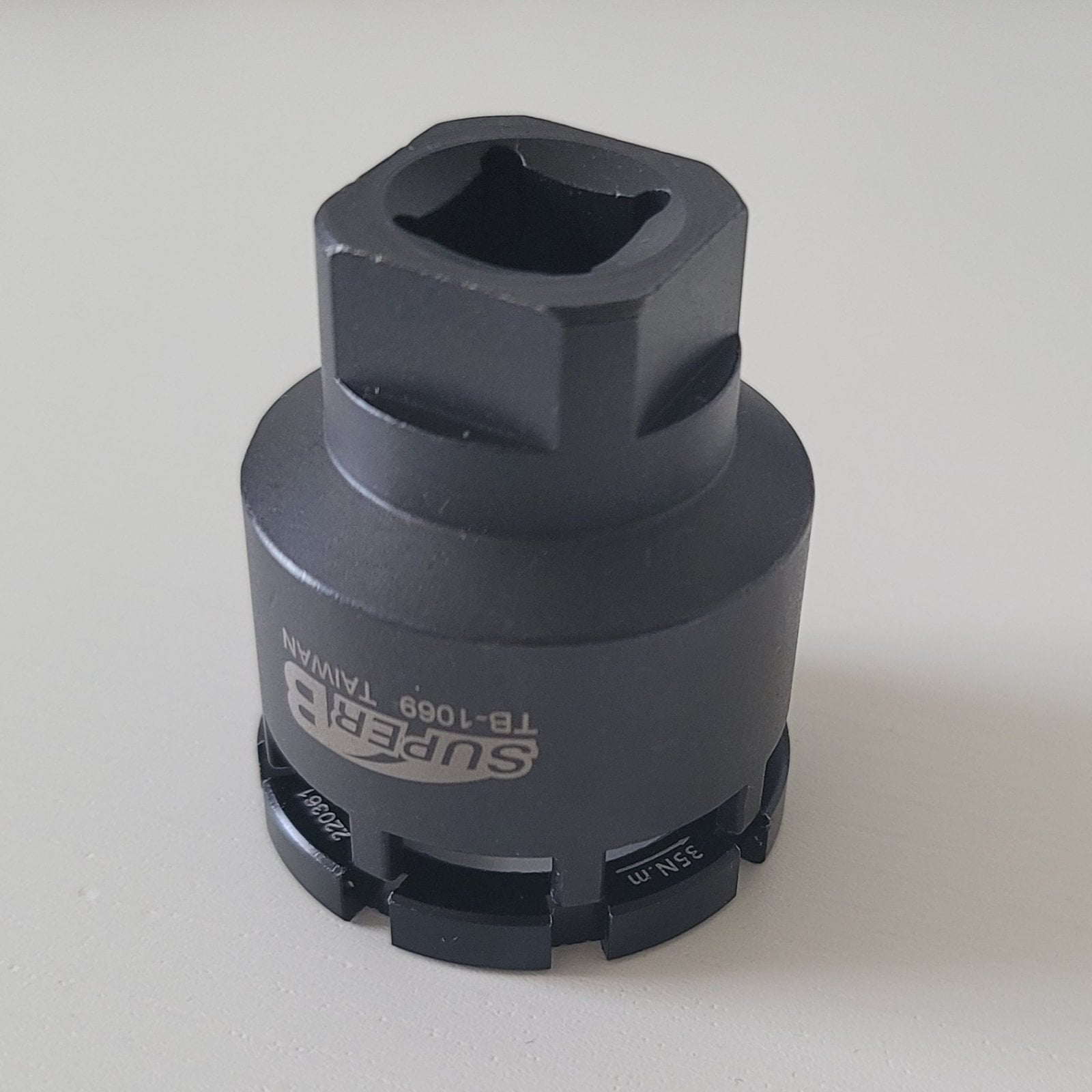

Anyone fitted one of these, is it the same tool as a BOSCH mid-drive?
The Bosch one seems to look right but I'd rather confirm that someone has used it before ordering. I'm using the old silver lockring from the M600 at the moment which works with the tool I already have, but I'd rather use the one supplied with the M510 below.
I think it fits and I ordered it still in shipping, in case you're not in a hurry I'll let you know after testing.

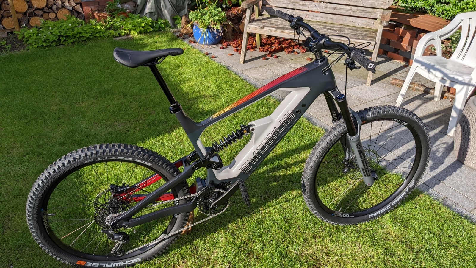

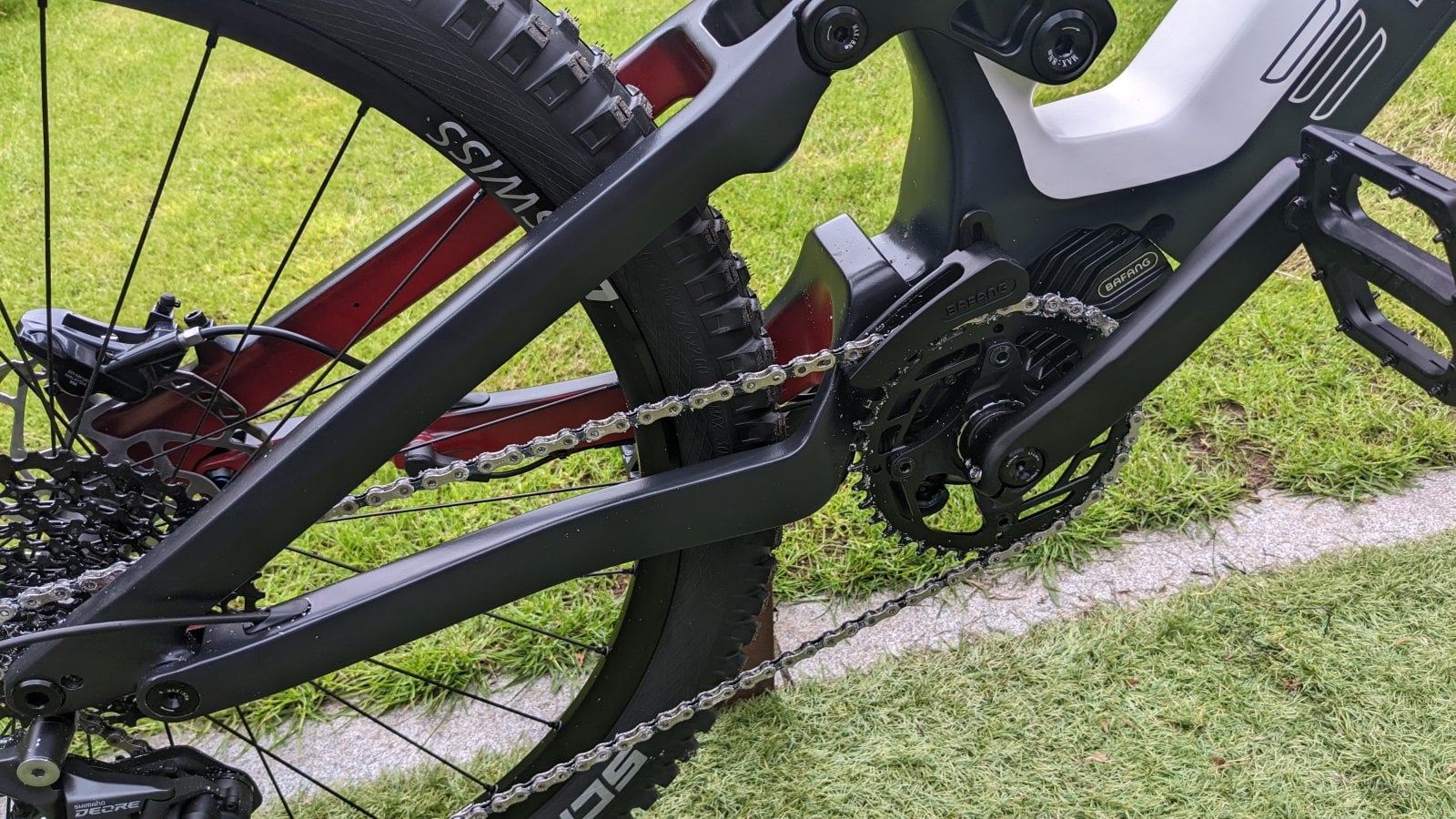

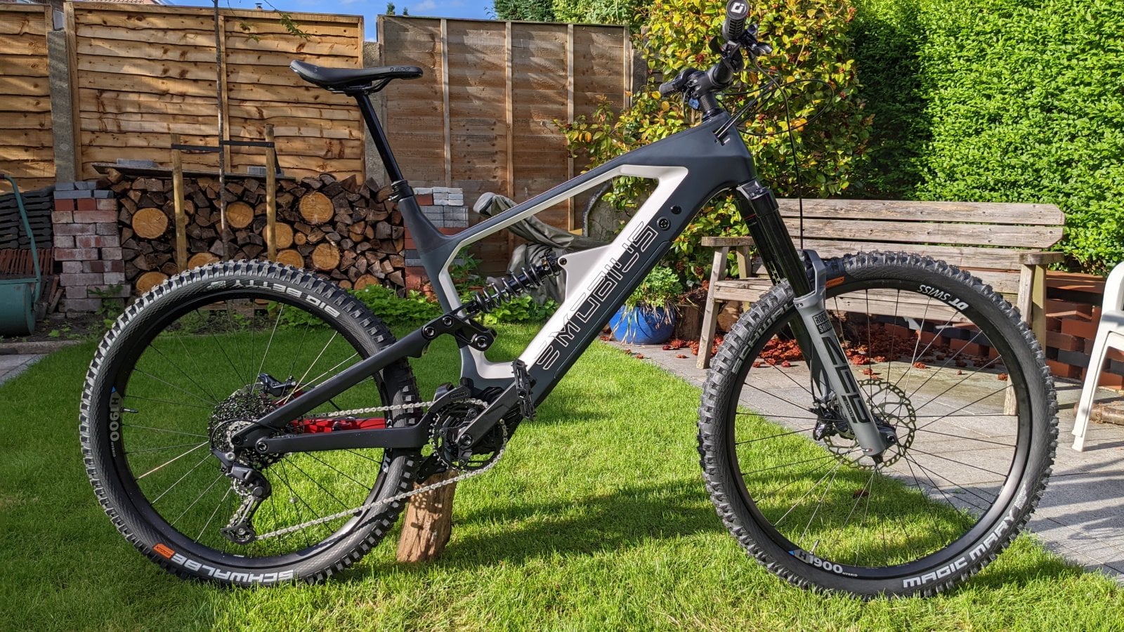

Finally finished and really pleased with set up. First time using a coil and I am converted! 216x63 Cane Creek with Progressive Valt coil. 170mm front travel. Being XL it is big but suits me (192cm and 98kg).
With a bit of care I also managed to fit the standard Bafang chain guard with no modification or rubbing. Just needs to go as far forward as possible.
Finally finished and really pleased with set up. First time using a coil and I am converted! 216x63 Cane Creek with Progressive Valt coil. 170mm front travel. Being XL it is big but suits me (192cm and 98kg). View attachment 89282View attachment 89280View attachment 89281
Nice Build! 😍
Is the motor M600 and what is the chainring size?
Nice Build! 😍
I went for the M500 to stay legal. It is definitely less powerful that a Bosch, but to be honest I want (and need) to feel like I have put some effort into a ride so the M500 is very natural and quiet and works for me.
The chainring is the standard one that comes with the motor - 34T I believe......

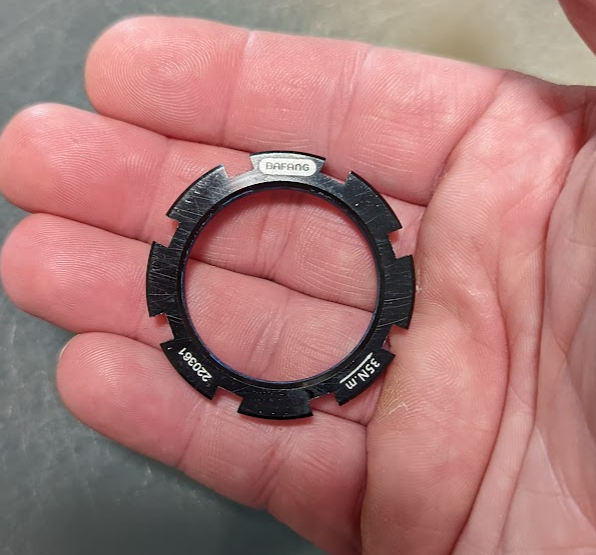

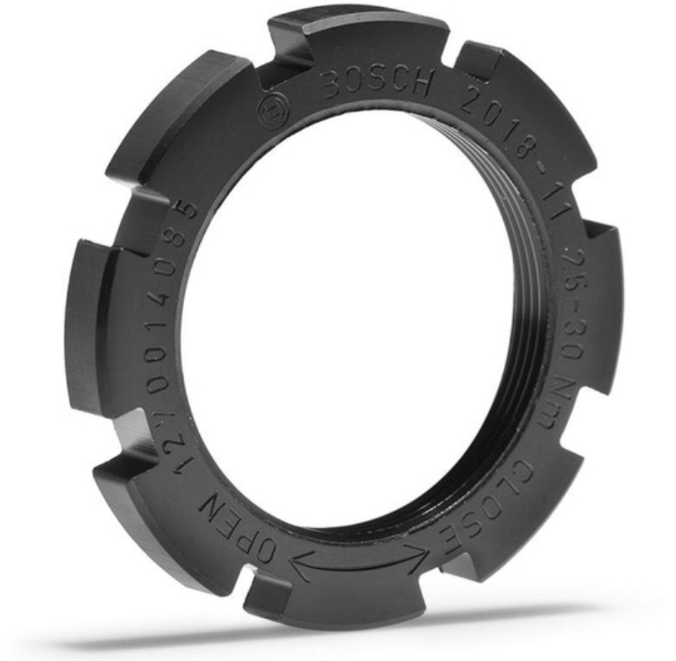

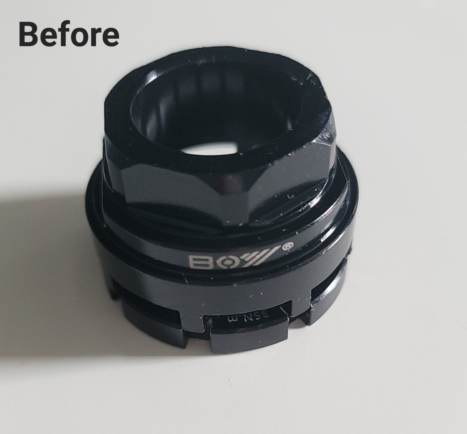

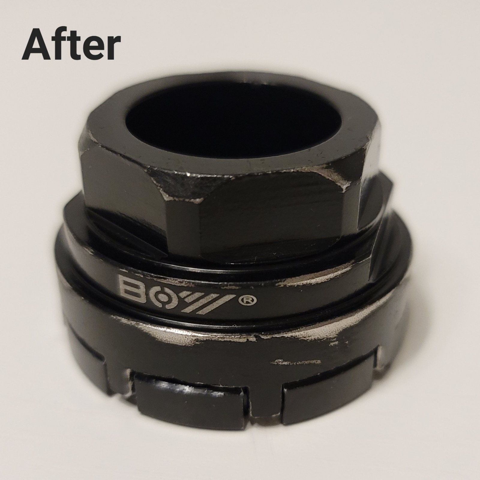

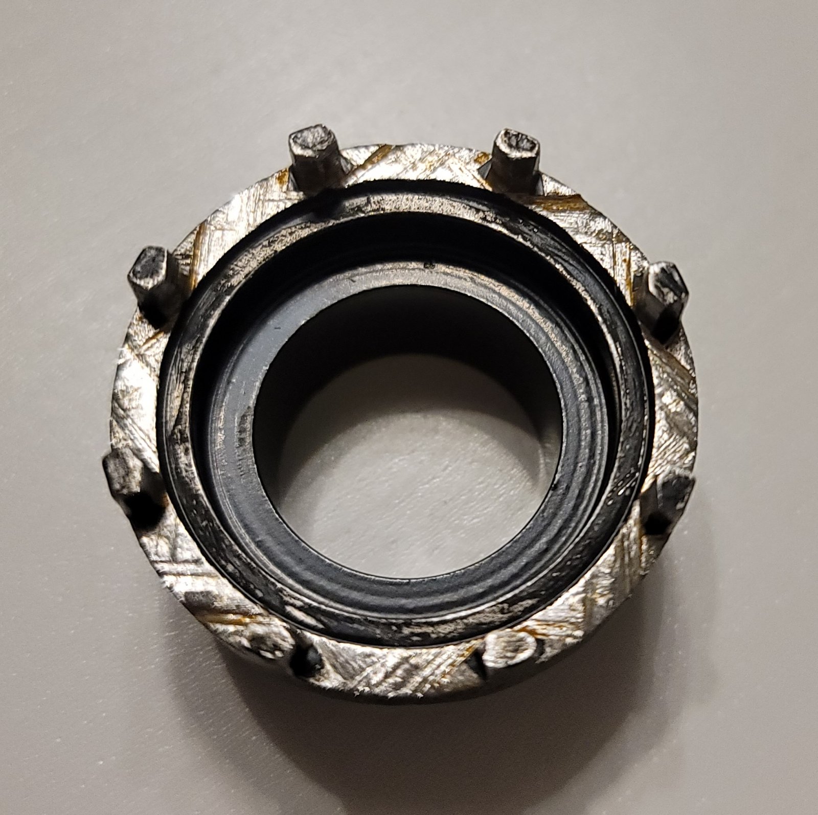

The tool is compatible with this lock ring from Bosch, but can we use this ring to tighten the chainring with Bafang M510 motor?
I'm looking for a solution because I don't have an extra old lock ring.
This is cheaper than the old Bafang lock ring and more available for sale.
